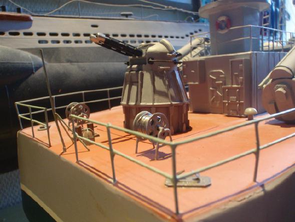

      Finished up both turrets by painting the railings and barrels black, on some of my archive pics they have a stainless steel tip, so i also added that.

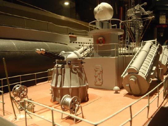

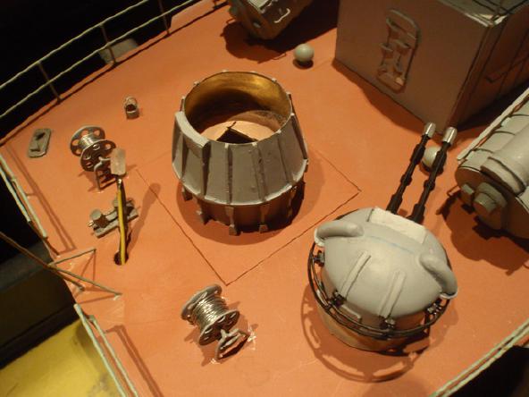

      This was the goal with the front turret, more scale-like, and i can remove it, to reach in for the powerswitch of my boat.
      By removing the rear turret i can reach in for the flatheadscrew, this keeps the deckpart closed, which conceils my rudder-servo.

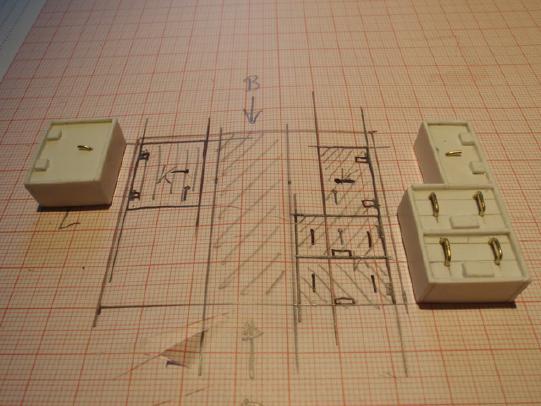

      At the back on the upperstructure are some wall-closetts present, made a drawing and started cutting styrene plate, the parts needed to build up the closetts.

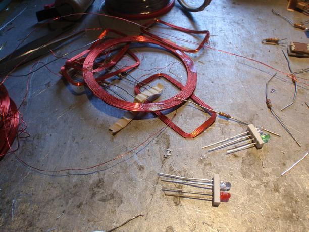

      I'll start with the beginning, got me some very thin magnetic-wire extracted from proximity readers (luckely part of my real live job) this would become the insulated cables for my lights.
      Next step was looking at the mast, in the past i had no intention to get some lights onto the mast, my luck was, i've builded up the mast from two brass tubes, the biggest one houses the radardrive, the smaller one was empty, i was wondering if the smaller one could house my lightcables, in the next update i'll enjoy you guys with some more hair raising fun.

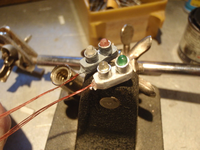

              Finally some time to update about the lights on the radarmast, i tried to discard my lower rightleg at work, don't try this at home, today a check-up at the hospital, i'll survive, or i'll build myself a brand new bionic leg.
              I managed to squeeze two 3 mm leds into this piece of sandwiched styrene, this was my start.
              It has to be placed at this position, this was a dryfitt to see if the size was right.

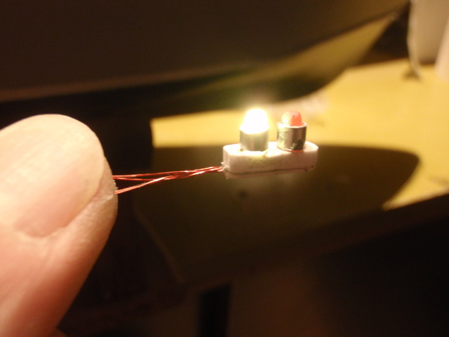

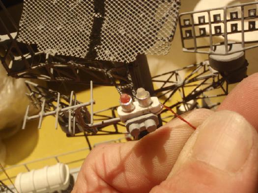

              The birth of number two, at this point i had two sets, one white/red and one white/green, time to get the mast of my model.
              I Always try to make my components in such way that they can be taken apart, same story for my radarmast, i studied the inside, the smaller tube inside the mast could be used for my wires, first drill some holes into the mast.

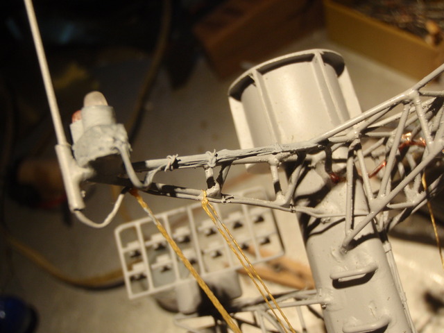

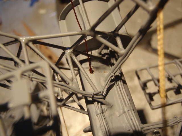

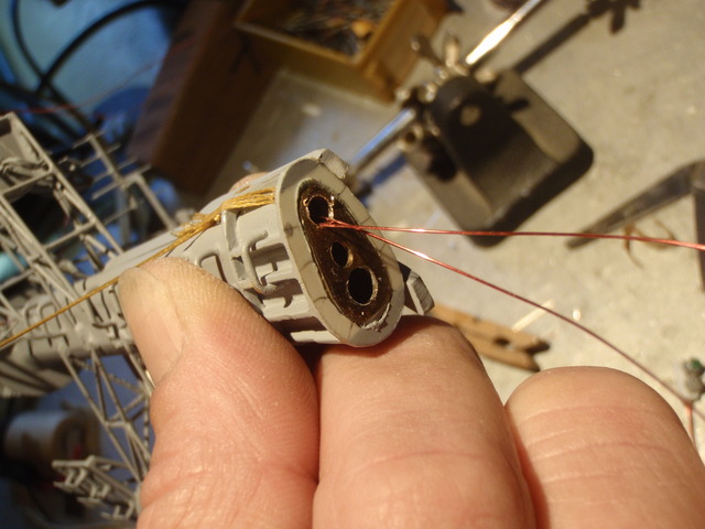

                          With my leg resting on a chair i can continue my posting, first i drilled a 1 mm hole at both sides into the mast, and managed to get some wires in, pictures
                          This was a bit tricky, by using a mini-drill i managed to make those holes, allready got one pulling-wire inside.
                          By repeating this on the other side i managed to get in both pulling-wires.

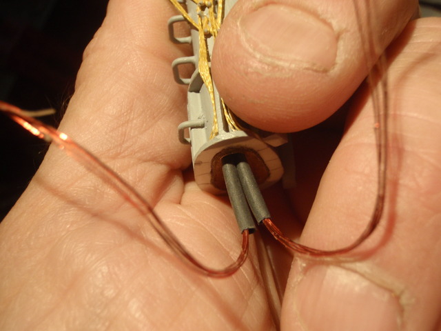

                          Getting all four wires in took some efforts, used some other small gauge wire to bind it to the mast, i must say, after each step i tested the leds if they still where in working order.
                          Slapped some paint on the wires and glued down the drilled hole inside the mast.
                          Last thing todo was, adding some shrinkhose at the base against shaving, my only insulation on those tiny wires is varnish, don't like a shortcircuit at the base of my mast.
                          Tested again all leds, at that point everything was in working order, untill Murphy came around the corner, to be continued.
