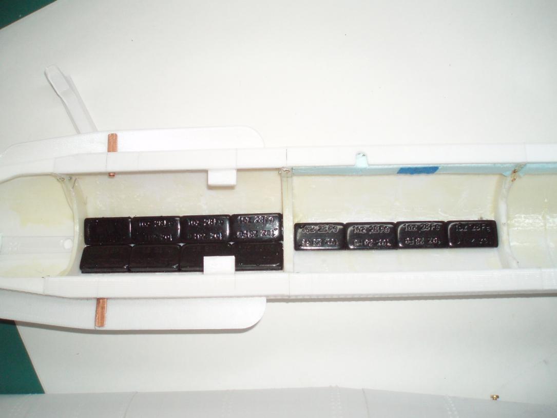

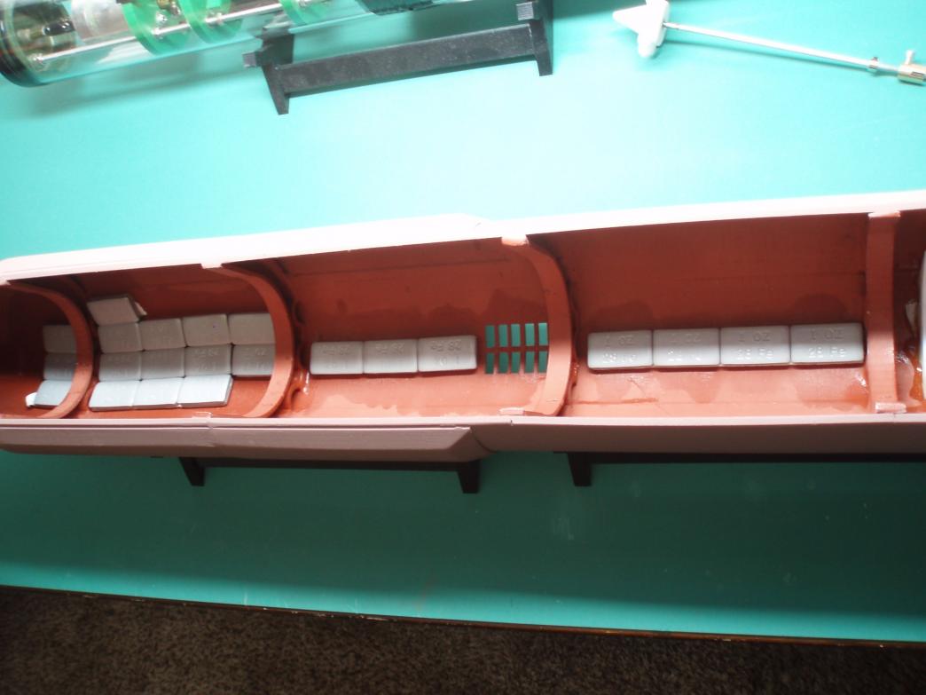

                          • 389
                          I buy a box of self-adhesive (foam tape) wheel weights from NAPA. They come in strips with each 1/4 ounce segment marked for cutting. Expensive at almost $100 USD, but you can ballast out a bunch of boats with one box. Once you kill the tape (one time use), you can RTV them in place. IIRC it takes 3 whole strips to equal 1 pound. Each strip is about 1 foot long. One box is more than enough to ballast out a 1/48 scale OTW Oberon class, or similar. I have also used lead .36 caliber black powder pistol balls, smashed flat with a hammer, to trim out 1/96 scale modern nuke hulls. RTV'd in place.
                            I have 15 3D Printed subs, and this is what works for me!

                            These are wheel weights from Amazon, and if I have an order to make with Bob at Nautilus I have hime throw in some of the weights that he sells.
                            So far, I have had no issues with them coming off.
