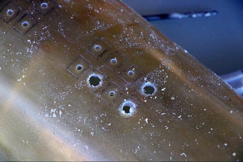

    I have just recently learned what not to do on fiberglass hull, do not use a drill bit that is too big.

    Although I will be able to finish the limber hole with in the scribing lines, there was a lot of separating of the laminated layers. This is my first travel into glassed hulls. All my prior subs have been plastic. What a different game this is! Here I tried three holes with a larger bit. Not happy with what was going on I went for a much smaller hole. I will try my coping saw on this to see if it will cut out the area O.K. If not, I will put in a few more small drill holes inside the limber hole. No matter what I end up doing there will be a need for filing to finish.
    To add to the conversation, what do you do to remove fibers that stick out? Do I use an X-Acto knife and cut the hairs?

      You coat the 'hairs' with CA, which stiffens them, then file away.
        I find that sandpaper from the back side works well to get the majority of them addressed as well...

                Old school way. Drill and file. Of course not as many on some other boats. Think these took about 2 hours.
