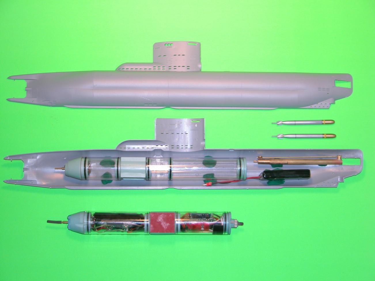

        The 1:72 Type XXIII with the revised system looks like a winner. It's fully armed and perfectly suited for a pool. It's likely to be very affordable as these things go. There are even two first rate kits available, as well as good references. Heck, the Wiz is even on record as liking this sub.
        What else could you ask for? Maybe a fittings kit? If only one would magically appear...

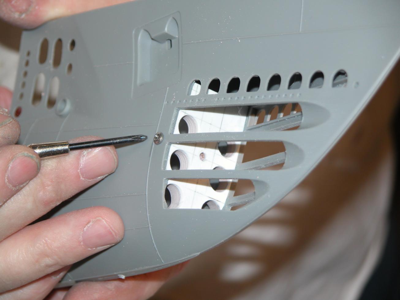

                Scott,

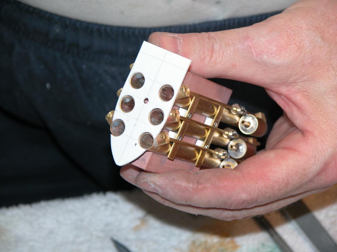

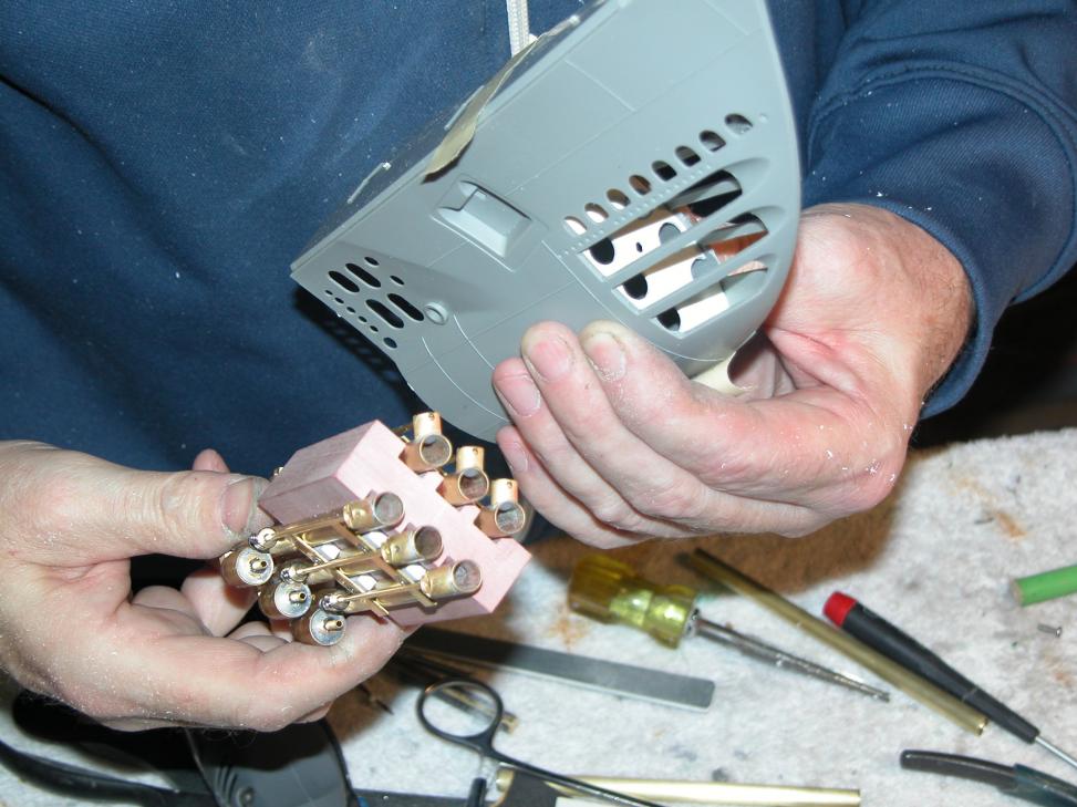

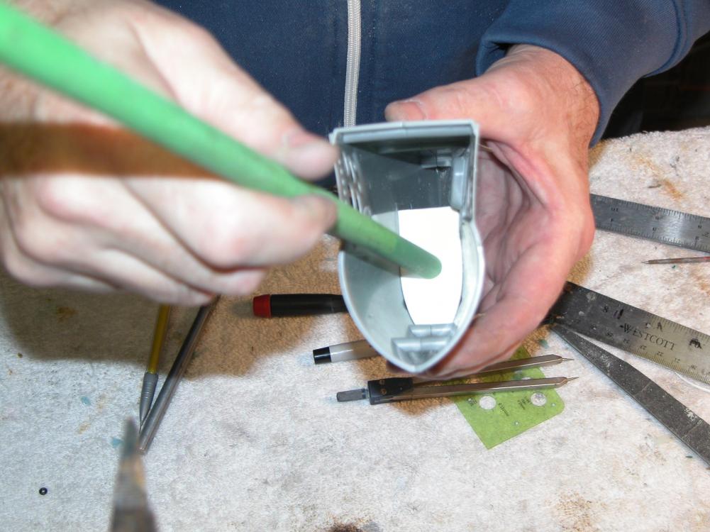

                A well presented and thought out mounting system -- but one that involves a lot of tooling for specific installations. Below are shots of how I'm integrating the tubes into a Revell 1/72 GATO kit:
ID:	58309Click image for larger version

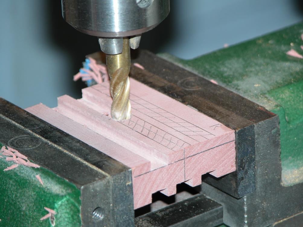

                  • 13998
                  #53

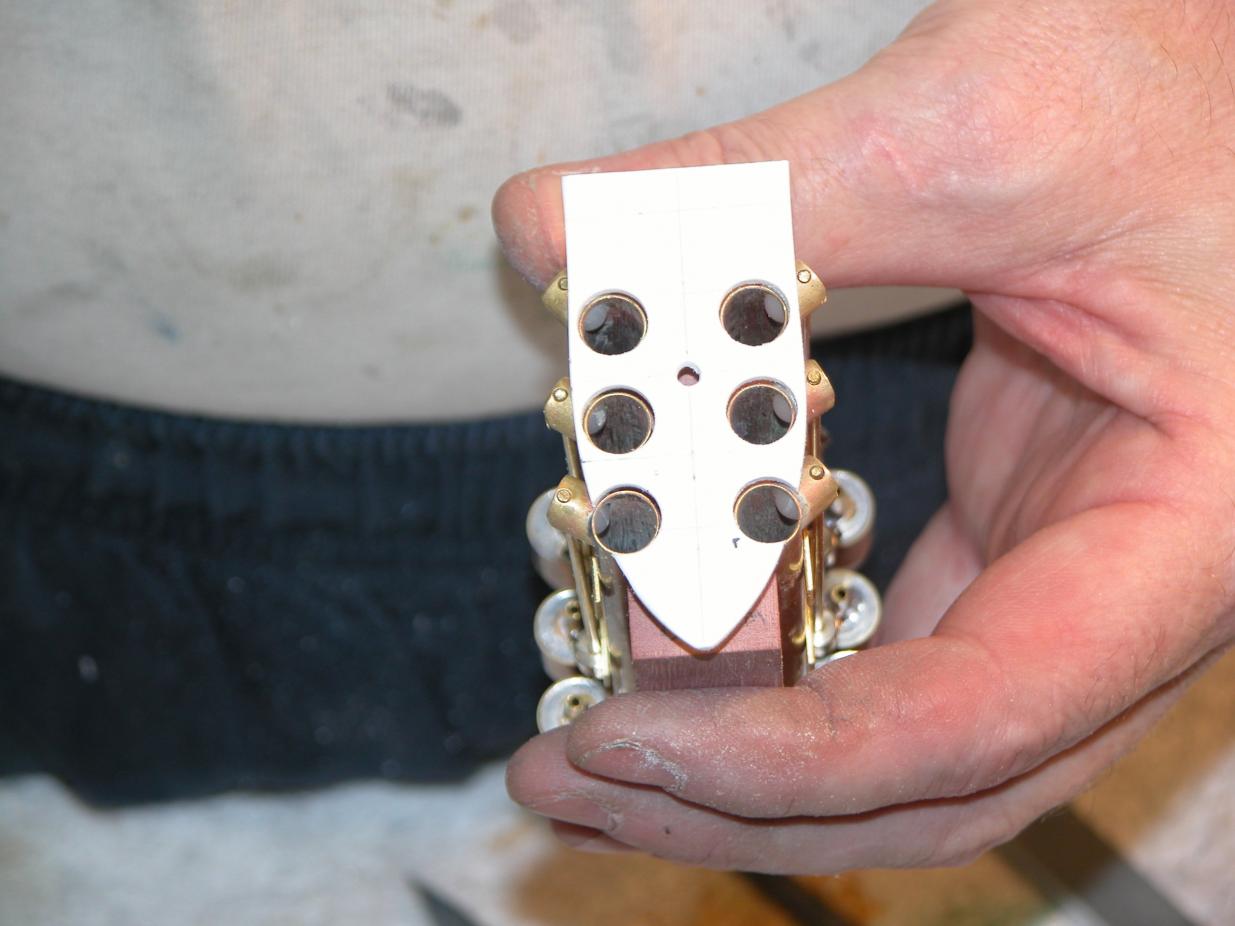

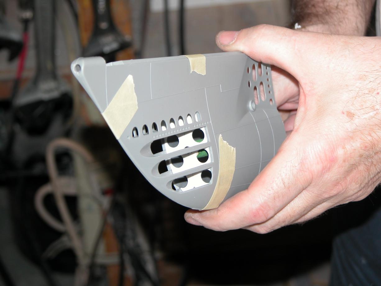

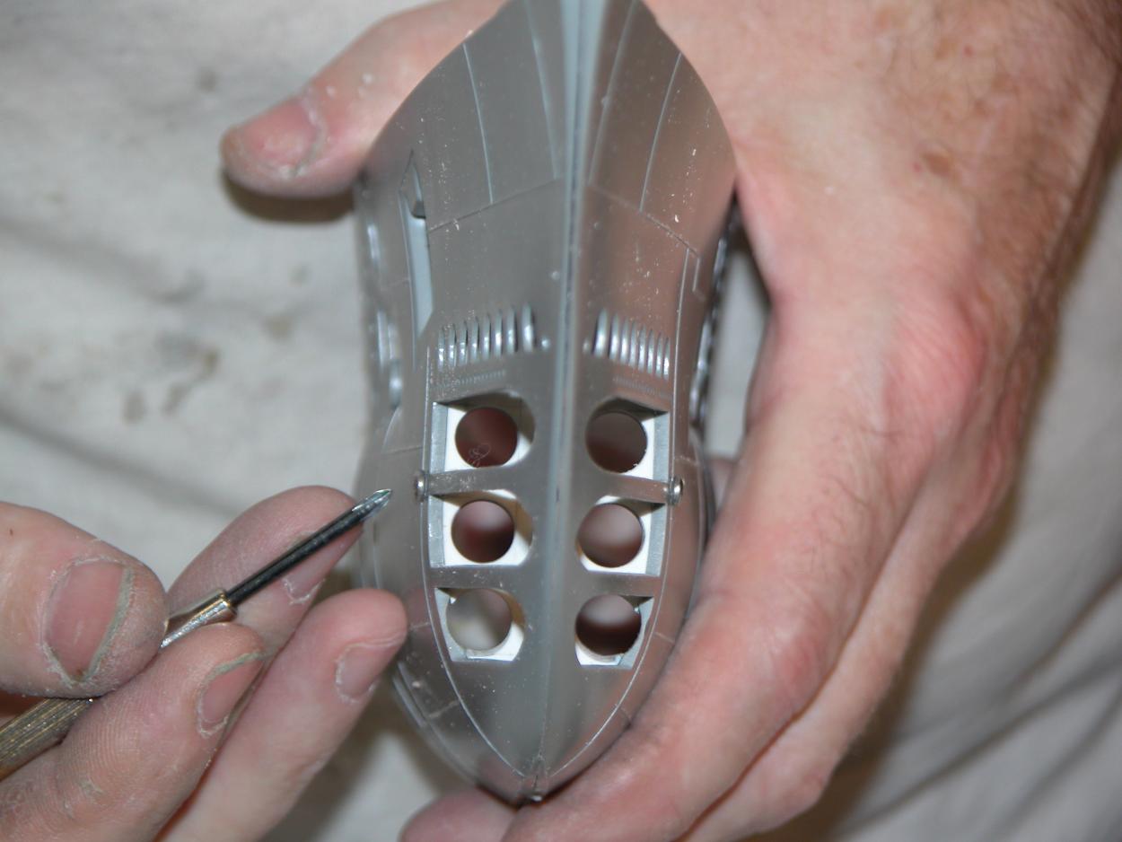

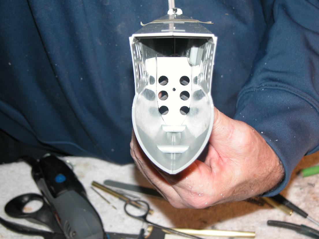

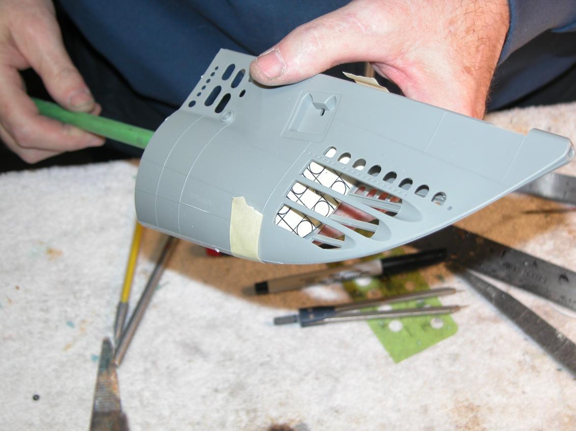

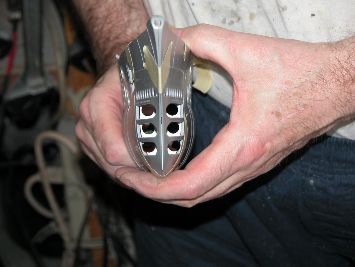

                  More shots of the GATO installation:
ID:	58311Click image for larger version
ID:	58312Click image for larger version
ID:	58313Click image for larger version
ID:	58314Click image for larger version
ID:	58315Click image for larger version
ID:	58316Click image for larger version
ID:	58317Click image for larger version
ID:	58318Click image for larger version
ID:	58319Click image for larger version
ID:	58320Click image for larger version
ID:	58321Click image for larger version

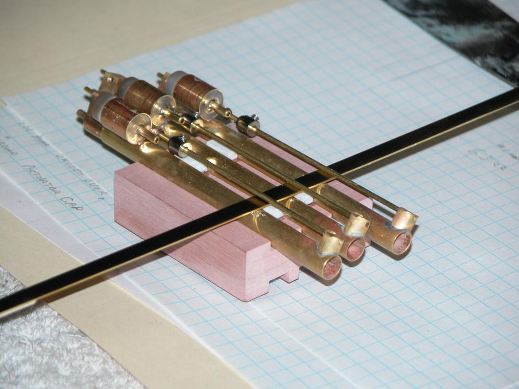

                        I know nothing about 1.1 torpedo’s so excuse my lack of knowledge but do real torpedo’s spin like a bullet to remain true or is this something that you have done to help your 1:72 scale torpedo’s?
                        I see where your fins are going to cause them to spin.
                        I’m going to have to get some cash together for my Gato’s torpedo’s.
                          • 13998
                          #57
                          Only one full-scale mobile (self-propelled) torpedo I know of was spin stabilized. It was developed by a citizen near the beginning of the 20th century and never saw production nor testing by the Navy. Reportedly he lit it off in the street during a 4th of July parade to much wonderment, surprise, and horror to his neighbors.
                          No, all mobile torpedoes that have gone into naval service sit still about their roll axis and relay on a low c.g. and high b.c. to stay upright. Most are kept on course by a combination of depth/angle sensing and heading sensing devices working appropriate control surface actuators.
                          I was a Torpedoman for over 20 years, so I think you can take the above to the bank.
                          As my weapons are dumb and have their c.g and c.b. at centerline, I spin them to stabilize them. That simple.
