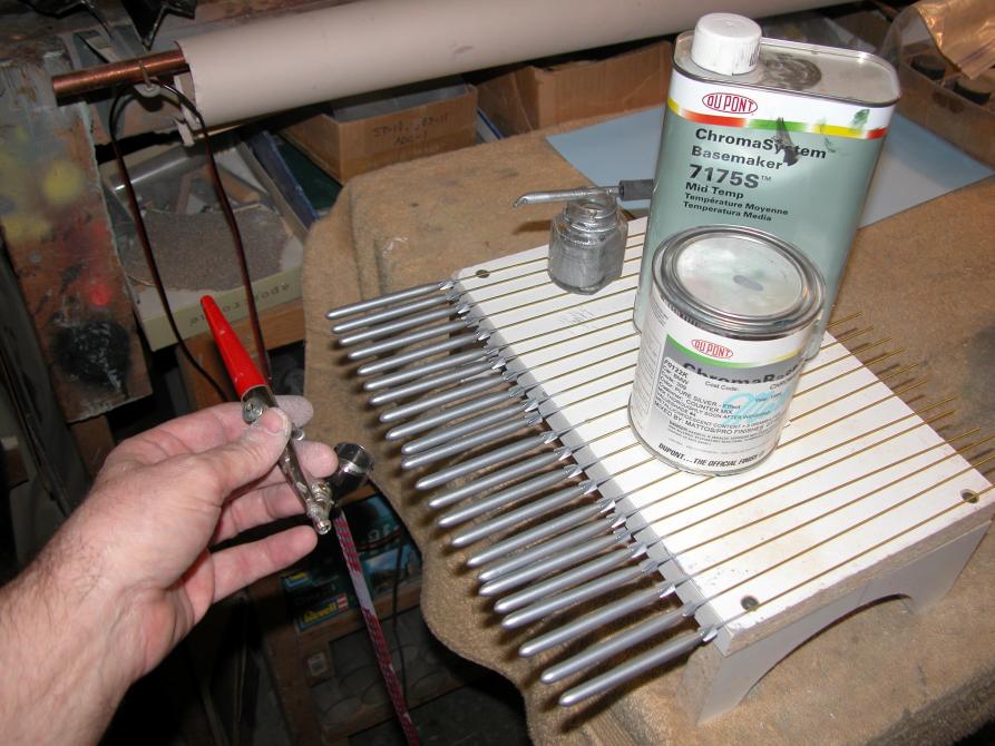

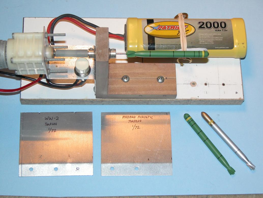

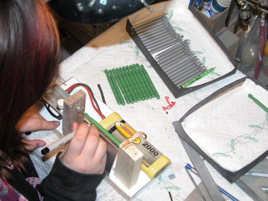

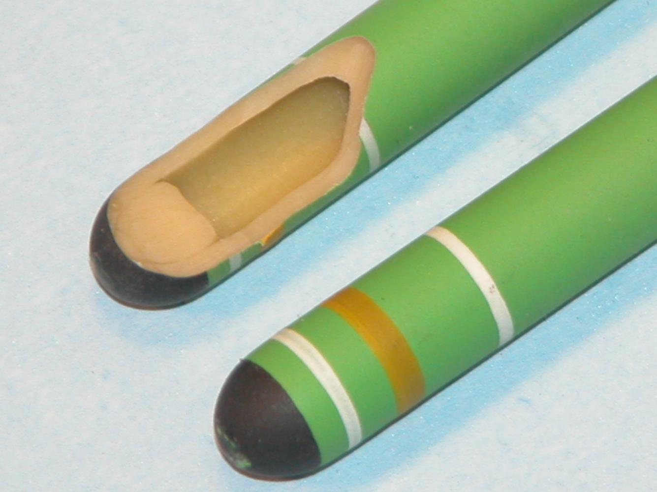

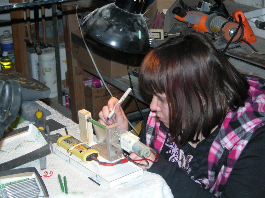

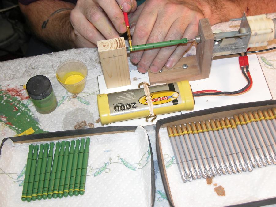

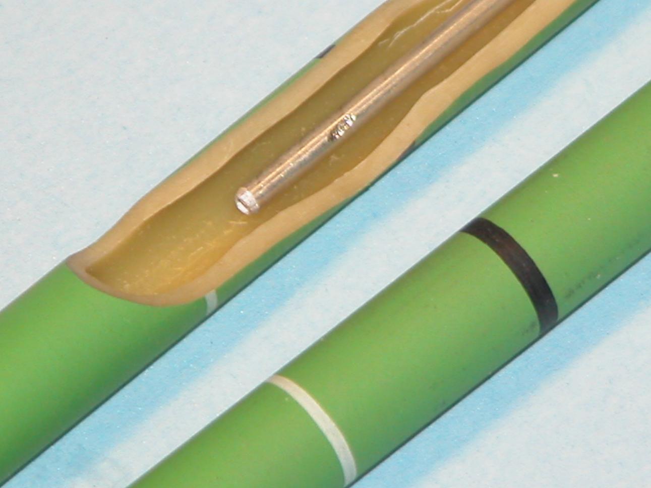

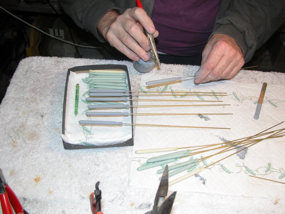

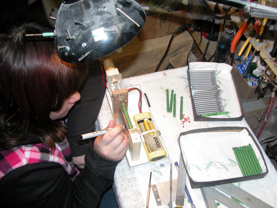

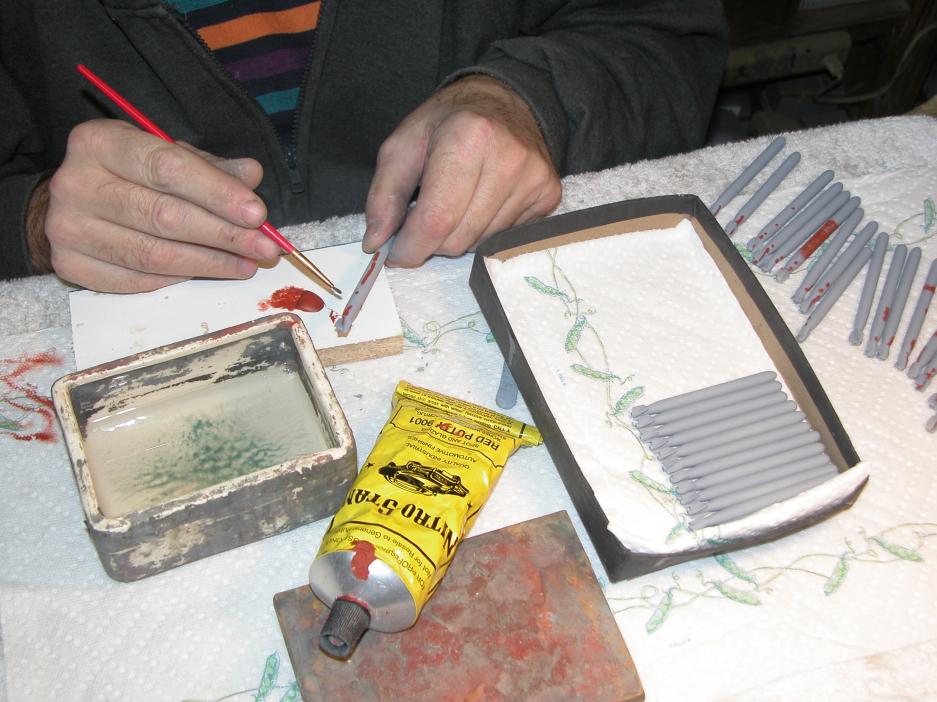

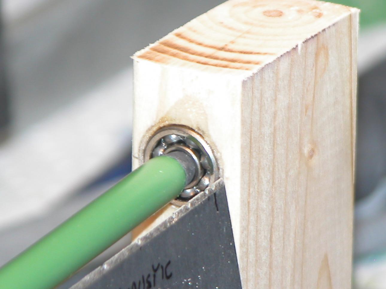

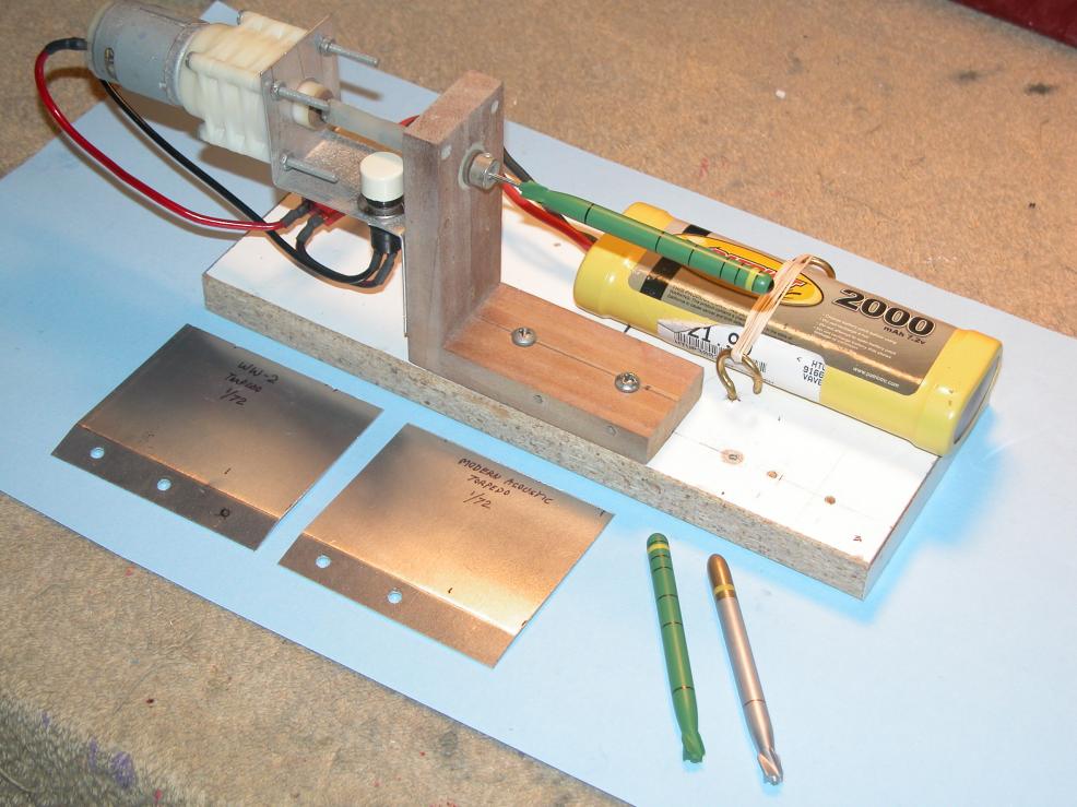

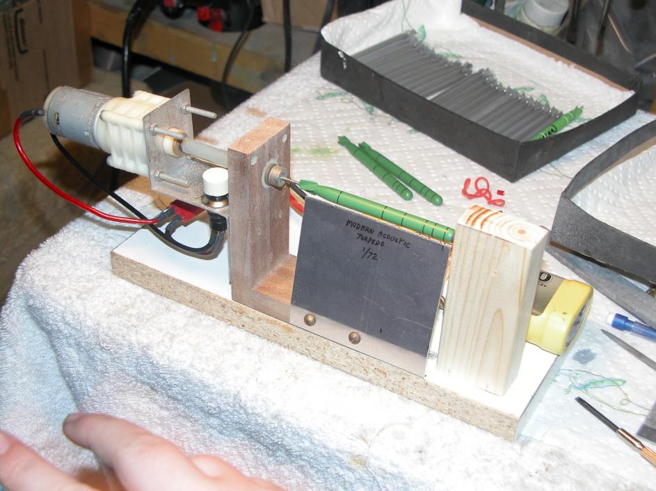

        Today's torpedo work:

          You'd have been one of those buggers sending kiddies up chimneys in Dickens time!!
            • 13951
            #35
            Child labor laws?! ... What child labor laws?

              They get paid room and board , clothing , allowance, education, Christmas and summers off, full heath and dental care and any thing else they whine enough about , sounds good too me , you hiring?
              In my day we lived in a crack in the road and got up befor dawn too sweep the road with our tounges ...

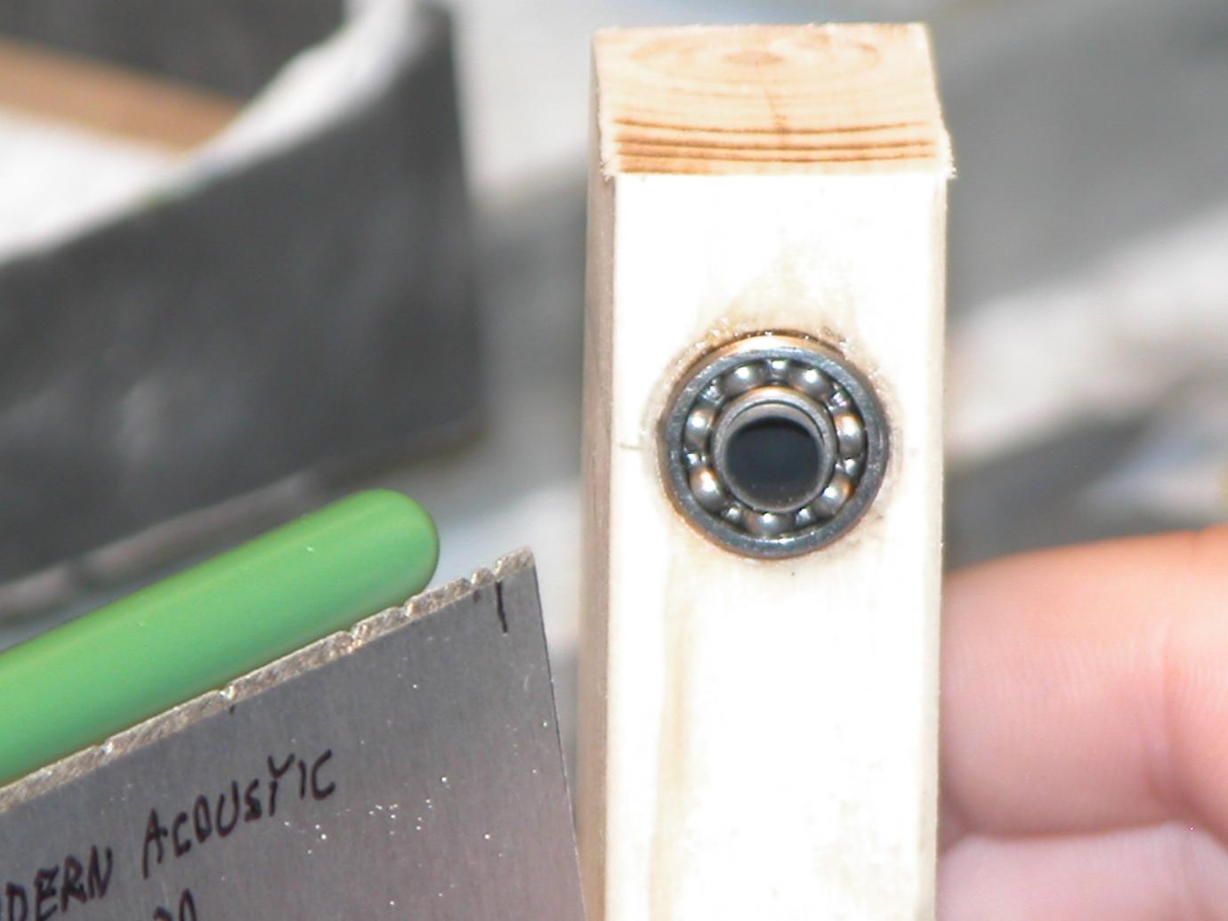

              Nice use of the aristocraft planetary gear stack and bearing , you are smarter than the average bear!!!
                Rick
                That's right, Tor! Kids are a natural resource to be exploited and eventually consumed. Bout time I got a little back-up around here.
                The Industrial Age is alive and well in my sweat-shop ... er, I meant ... household.
                You like my little torpedo marking and painting gizmo? Only thing Rose actually likes doing in the shop is marking and painting torpedoes.

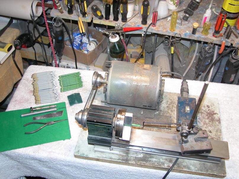

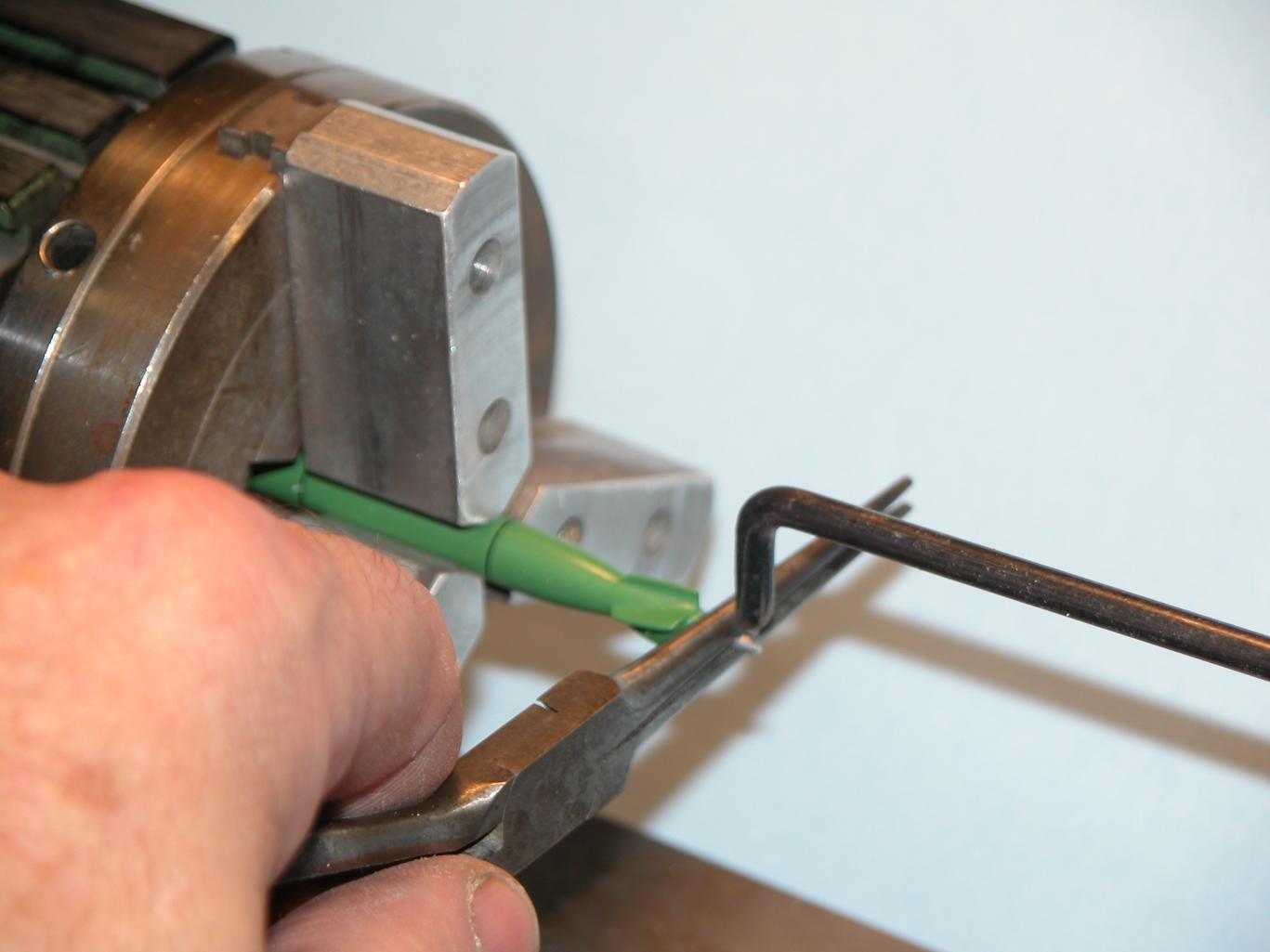

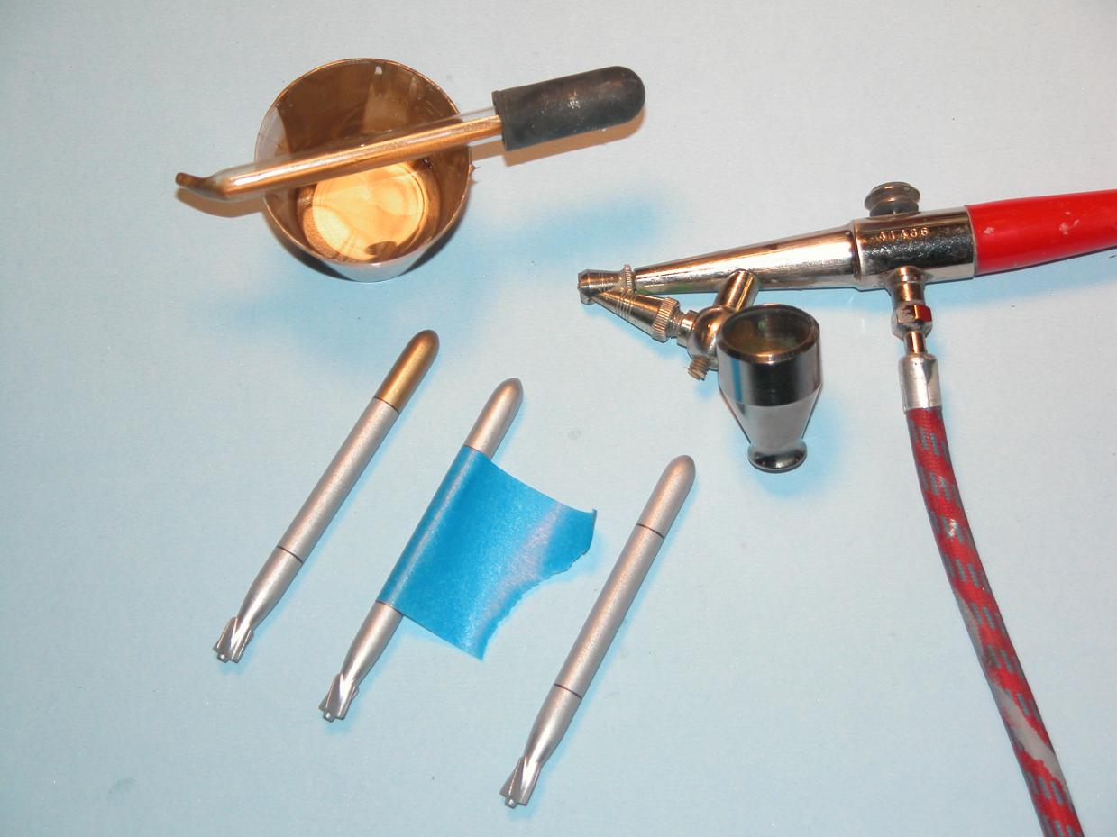

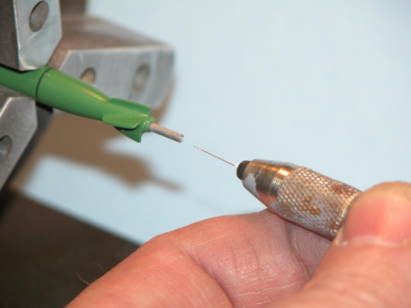

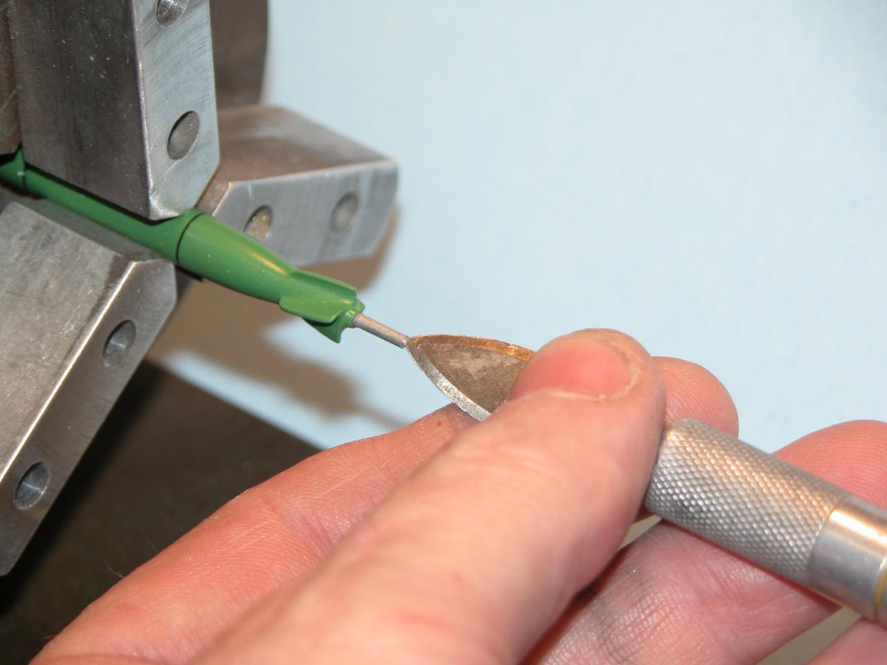

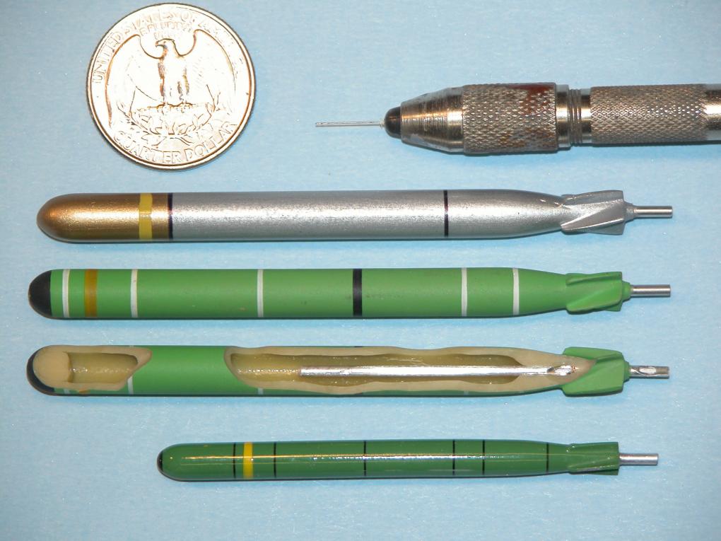

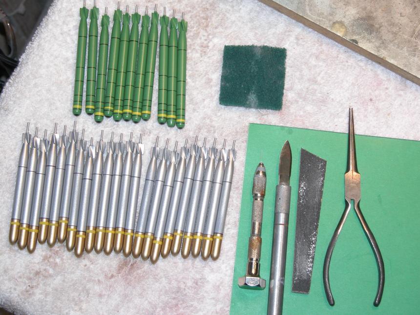

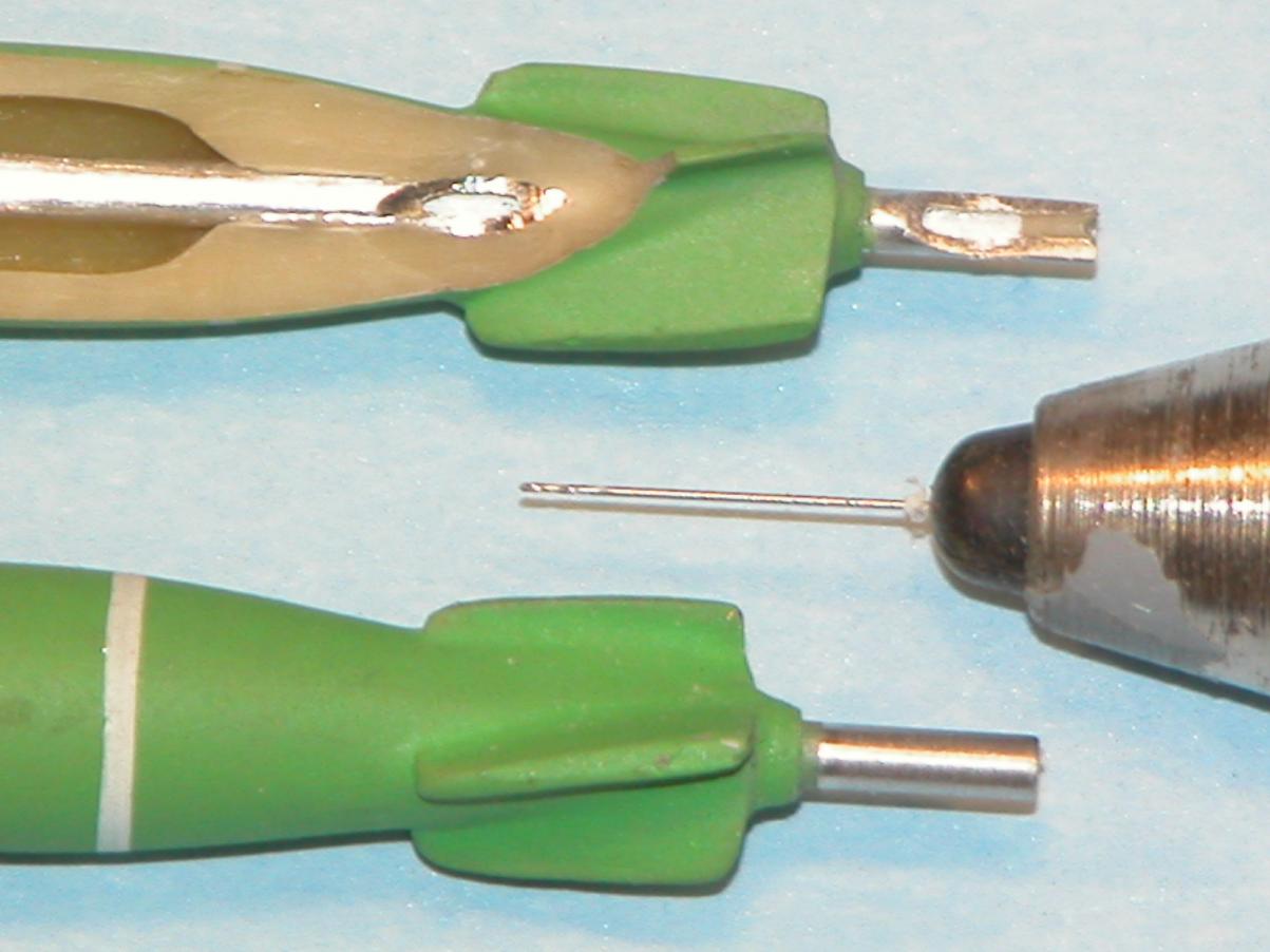

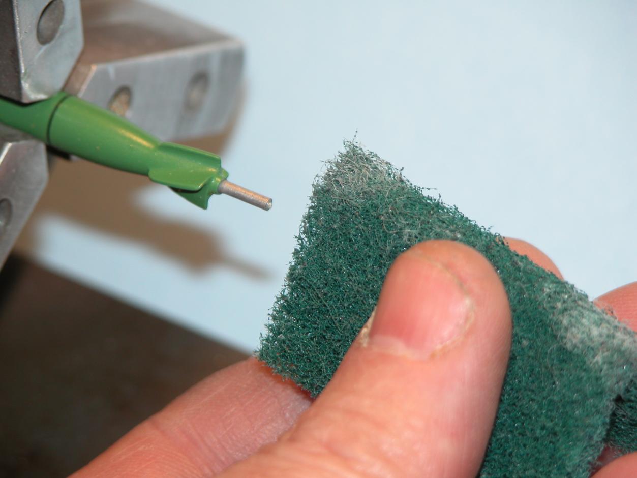

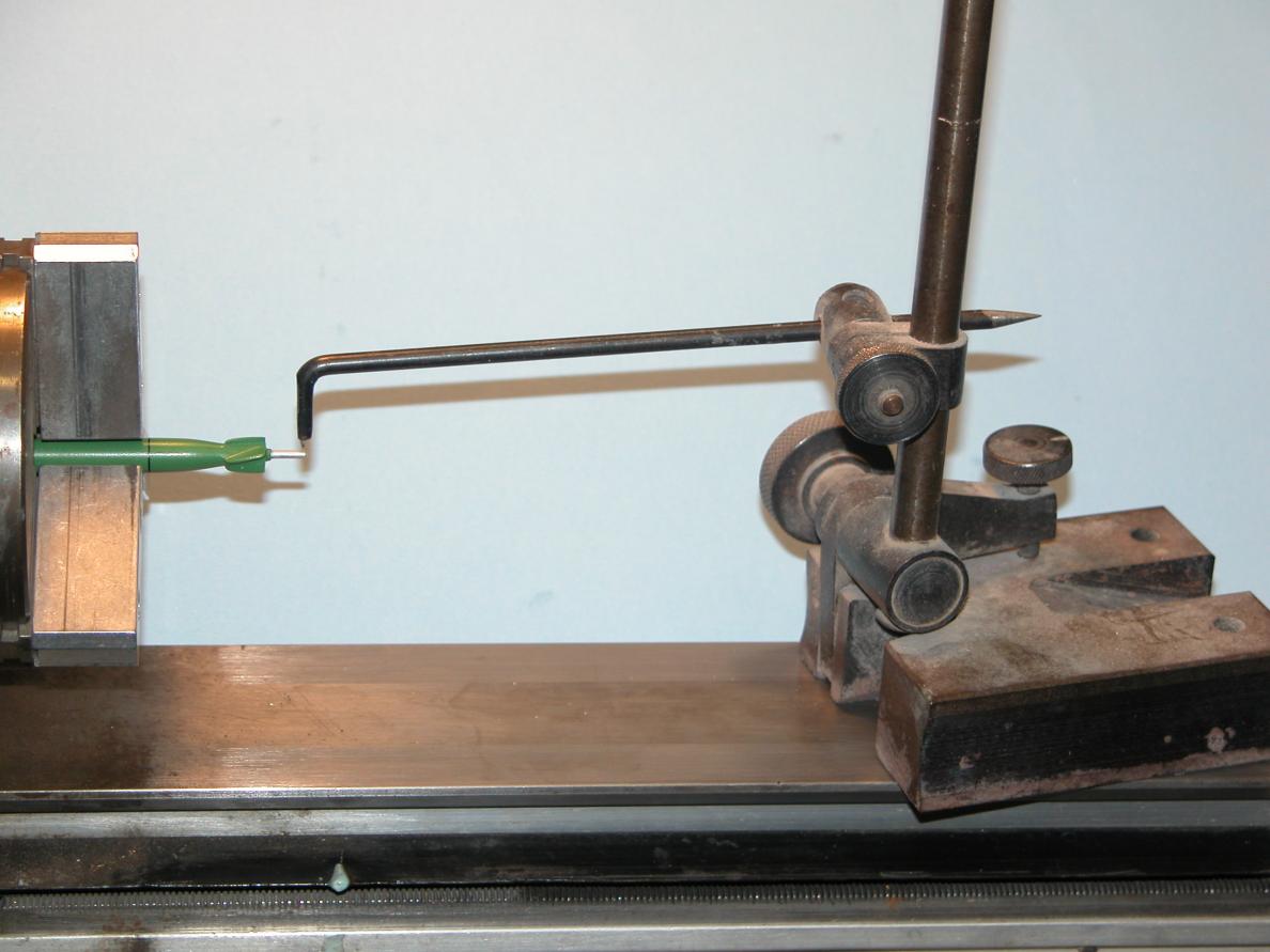

                  Some shots of how I finish off production of a torpedo; the several steps required to center and punch out the nozzles.

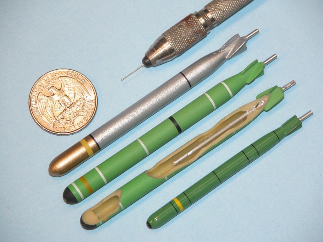

                      For something completely different... The tail fins on the torpedoes do not live up to the Wizard's high standards of accuracy--they are twisted sisters [Couldn't resist]. One assumes this is for stability during the torpedo's run, since the Wizard would need a practical reason to deviate from his cherished devotion to scale accuracy. Operating under the assumption that both straight and twisted fins were tested, what benefits did twisting deliver and were there any performance penalties?

                        OK, smart-ass, you drew me out on the fins crack. Nice work, you should get into the roach-control business.
                        Of course I deviated from 'scale'. Without the weapon spinning in the water, the trajectory is all over the place. So, sue me!

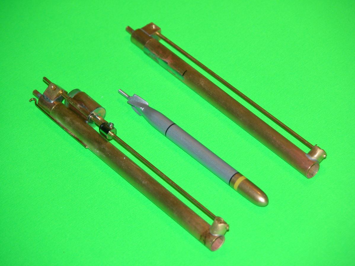

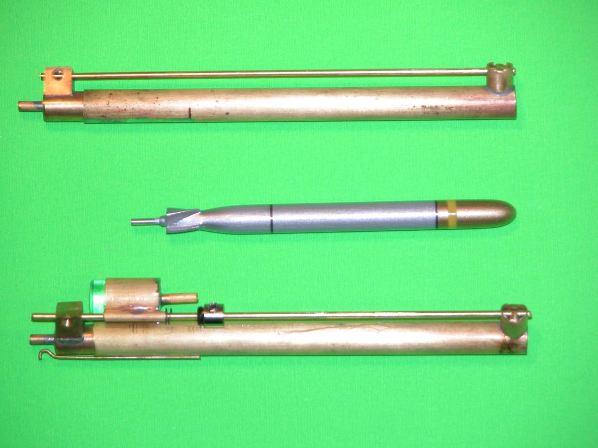

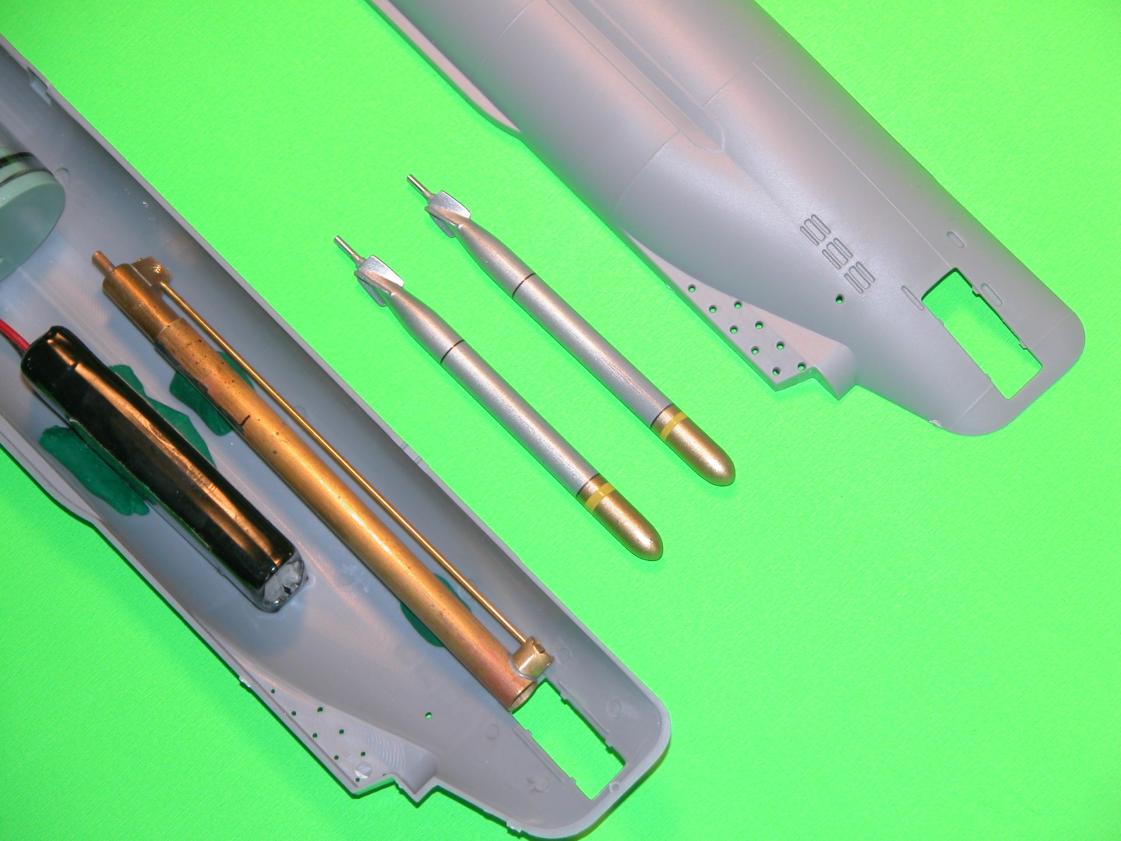

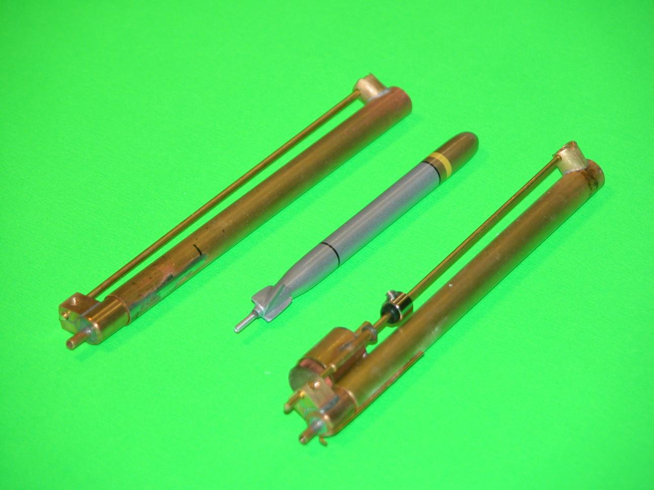

                            The Wizard and I have come up with another angle for the torpedo system. If you are only going to use one or two torpedo tubes, then you could operate the system without the controller, the manifold and the gas solenoid valve. Only the torpedo charge of gas pushes the torpedo out, so all that is required is the breach-block to be activated to allow the torpedo to escape. This is a mechanical operation that can easily be operated with a mini servo. By using a three position toggle switch on the transmitter, the servo can discharge two tubes. i.e. Left = #1 fire, center = off, Right = #2 fire.
                            1 x LAUNCHER 120.00 (less Solenoid Valve)
                            3 x TORPEDOES included with Launcher
                            1 x MECHANICAL VALVE 50.00
                            $170.00
                            We hope to have some photos shortly - stay tuned!

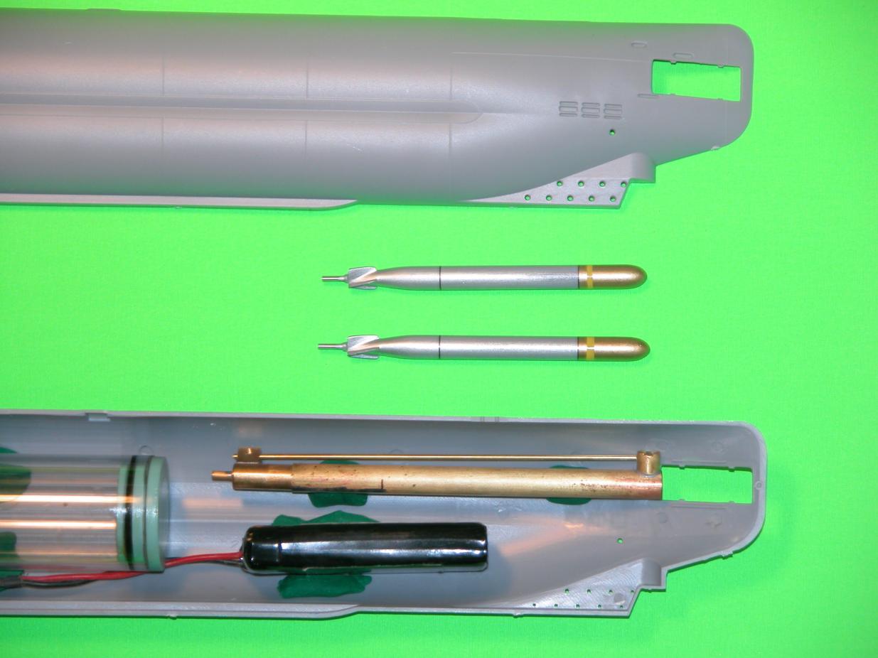

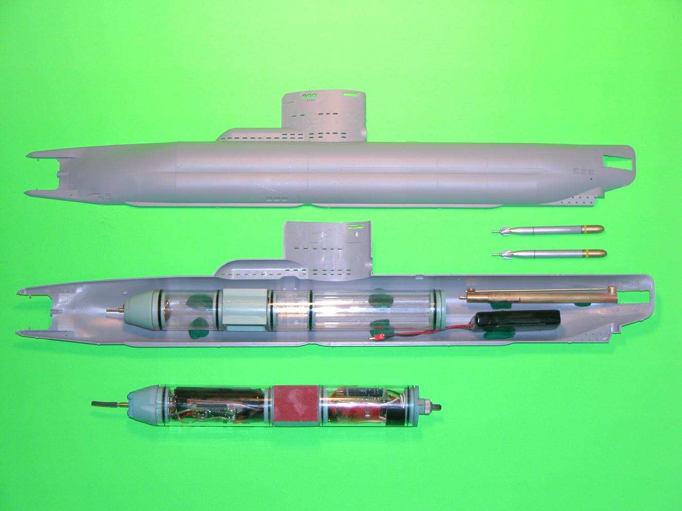

                              Food for thought:

                                I like it. K.I.S.S.
                                Too bad you can make them in 1/144 scale.
