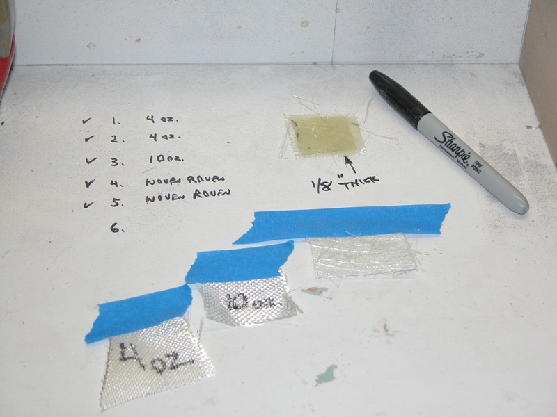

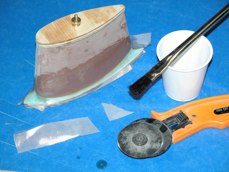

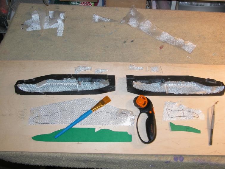

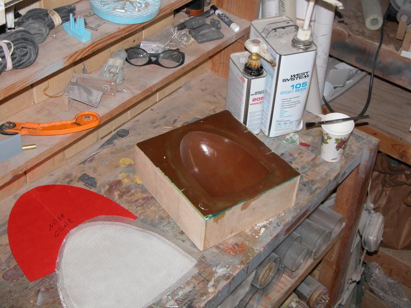

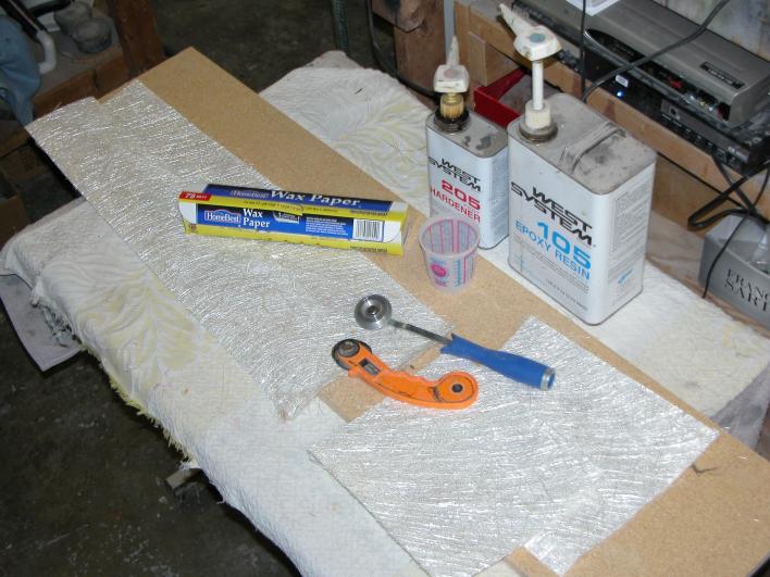

        Is glass cloth fiberglass cloth? Will this pictured below be correct? What 2 part epoxy resin do you guys recommend?
          • 13982
          That will work, but is a tad heavy for this job. Cut it into 1/2" squares to make lay-down an easy matter. Ideally you would use 2-4 ounce cloth (per square yard). Best laminating resin is West System.
