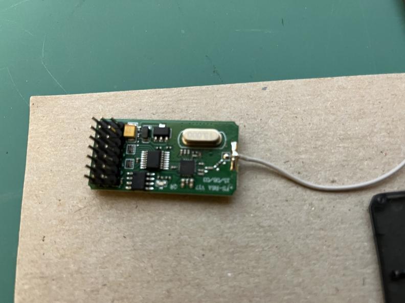

    cheapsub. Thank you photo and the link and your input!
    My 4 channel 2.4 MHz Radio came with (6) RX (receivers) just like the photos below!
    Click image for larger version  Name:	NAUTILUS 3.jpg Views:	0 Size:	39.4 KB ID:	169203Click image for larger version  Name:	NAUTILUS 4.jpg Views:	0 Size:	47.6 KB ID:	169204
    Click image for larger version  Name:	NAUTILUS 5.jpg Views:	0 Size:	54.3 KB ID:	169205Click image for larger version  Name:	NAUTILUS 6.jpg Views:	0 Size:	78.8 KB ID:	169206
    They do NOT have the button adaptor on the receivers. My new coaxial cable will be soldered in the same way at the receiver as per top photo.I was hoping David M. might chime in on this! For now I am going to do the antenna tip (no brass tubing) the same way that Davids photo shows.
    I think we have beet this subject matter enough, and I need to get going on it! We will know if I am right or wrong by testing!!!

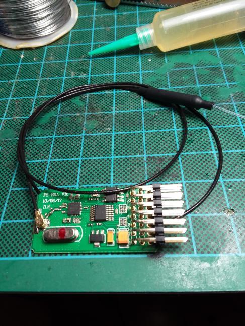

  • cheapsub
    replied
    Remove the tube, do as Dave did, to keep the antenna upright.
    This is what I have.
    up to more than meter long.
    Sorry is from China
    if you are nuts like me , always could add a button on the rx, side way pins too.
    Click image for larger version  Name:	20201202_232155.jpg Views:	0 Size:	76.4 KB ID:	169201

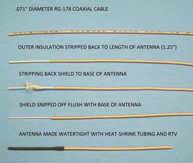

    replied
    The photo below shows how my 2.4 MHz receiver antenna is set up.
    The below photo shows how David M. explained how to do the coaxial cable for the 2.4 MHz antenna.
    My question would be? Is there any reason I need to solder a 3/16" piece of tubing to my new antenna install, or can I just follow what David M. has laid out?
    "Firemen can stand the heat."

    replied
    Rob,
    RG178 is RG178 is RG178.
    Bob has in stock ready to go with IP adaptor (s/b on the RX board).
    Hi Ed,
    Thanks for chiming in!
    My receivers do not have that IP adaptor, They are soldered. So I could not use the ones that Bob has. But it sounds like the RG178 coaxial cable I have coming will work!
    Thanks again for the advice Ed!
