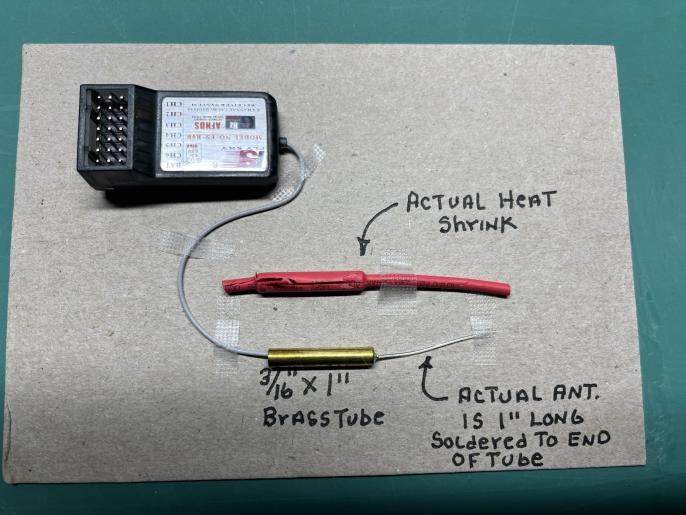

                        The photo below shows how my 2.4 MHz receiver antenna is set up.
                        The below photo shows how David M. explained how to do the coaxial cable for the 2.4 MHz antenna.
                        My question would be? Is there any reason I need to solder a 3/16" piece of tubing to my new antenna install, or can I just follow what David M. has laid out?

                          #57
                          Remove the tube, do as Dave did, to keep the antenna upright.

                            cheapsub. Thank you photo and the link and your input!
                            My 4 channel 2.4 MHz Radio came with (6) RX (receivers) just like the photos below!
                            Click image for larger version  Name:	NAUTILUS 3.jpg Views:	0 Size:	39.4 KB ID:	169203Click image for larger version  Name:	NAUTILUS 4.jpg Views:	0 Size:	47.6 KB ID:	169204
                            Click image for larger version  Name:	NAUTILUS 5.jpg Views:	0 Size:	54.3 KB ID:	169205Click image for larger version  Name:	NAUTILUS 6.jpg Views:	0 Size:	78.8 KB ID:	169206
                            They do NOT have the button adaptor on the receivers. My new coaxial cable will be soldered in the same way at the receiver as per top photo.I was hoping David M. might chime in on this! For now I am going to do the antenna tip (no brass tubing) the same way that Davids photo shows.
                            I think we have beet this subject matter enough, and I need to get going on it! We will know if I am right or wrong by testing!!!

                              #59
                              Hi Rob,
                              Out of curiosity, is the brass tube glued to the antenna? I wonder what its purpose is.
                              Nate
