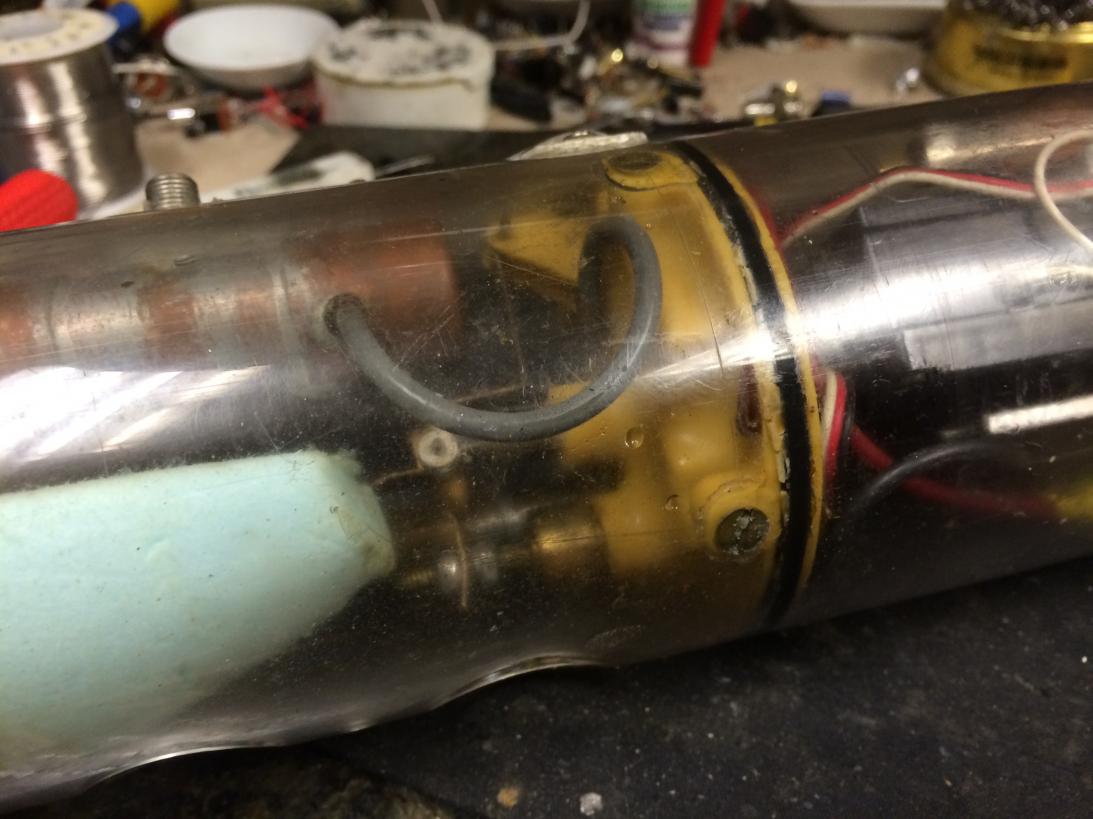

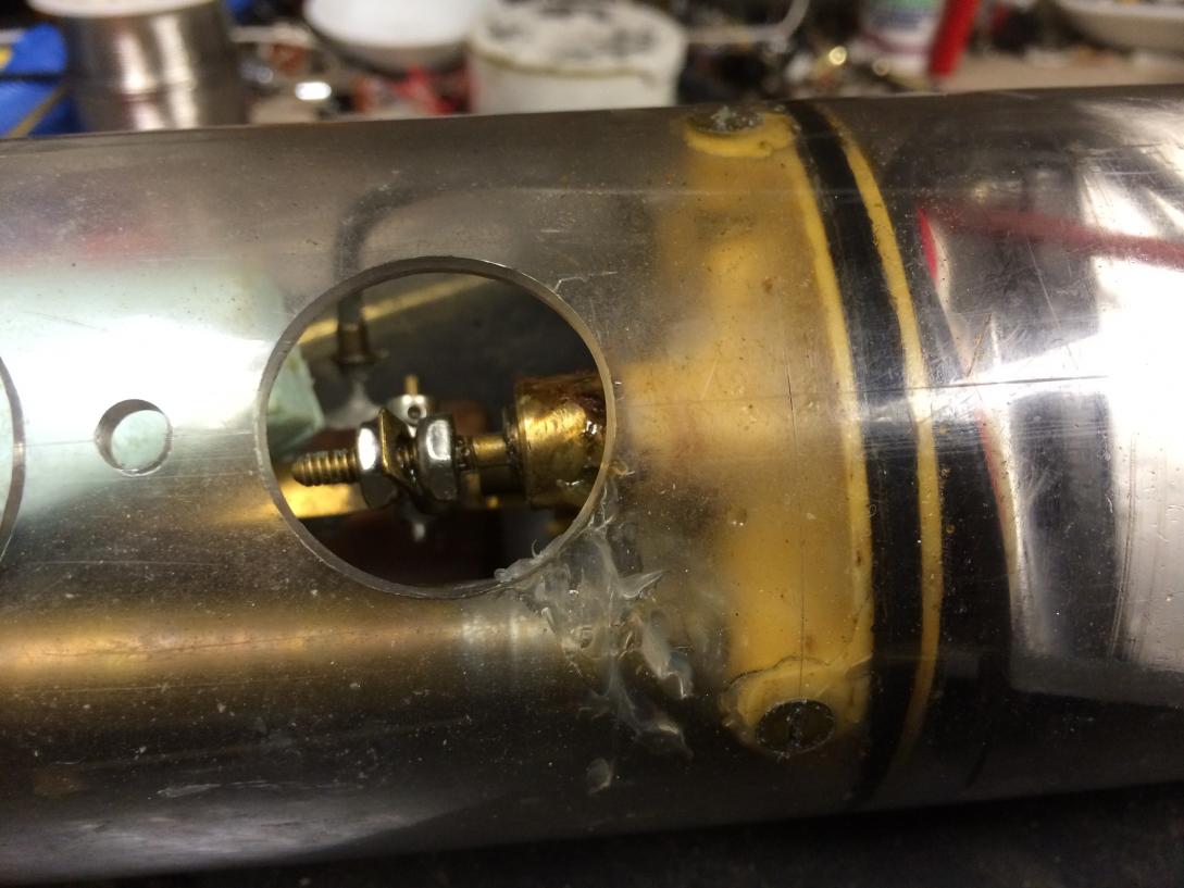

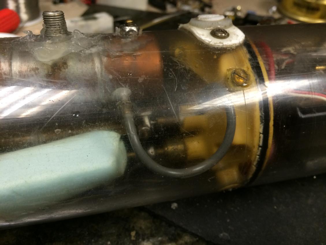

                            Well I went to the marina today.
                            And the sub was acting weird. It was like the trim was off. WAY off.
                            And after a little while I took the sub out of the water, just as it started running weird and riding low in the water.
                            Yup you guessed it. WTC was flooded, about 25%.
                            Ahh, back to the drawing board !! LoL.
                              #44
                              What happened?
                              Someone left a hatch open?
                              • Ronin055
                                • Feb 2014
                                • 40
                                #45
                                I think it was the scale screen door that I installed. ;)
                                Ya. I just got the electronics dried out, and the super good news is that everything is still functional.
                                Still Ive go the model torn appart and sitting in front of a fan for the evening.
                                Tomorrow evening Ill do another bubble test in the tub to see if I can spot any leaks. After all the runs Ive had, I guess I got a little complacent. I have an idea what happened, but there is an investigation to be conducted still before I render any results and conclusions.
