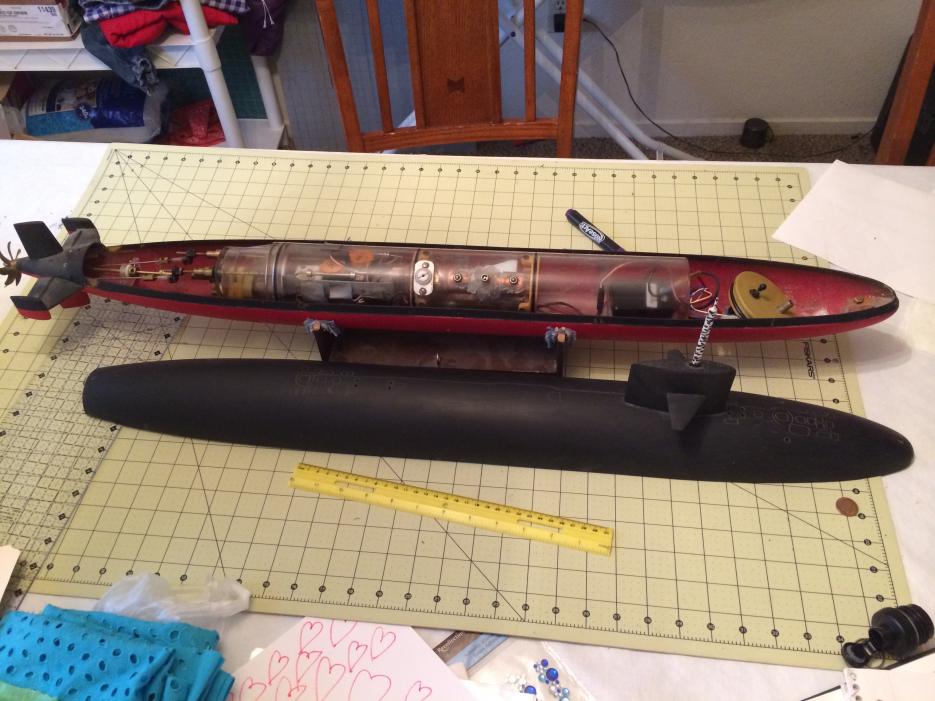

    My pal at the local hobby shop, received a single car garage full of hobby supplies when a close friend of his passed away. Flash forward two years, and my Friend makes a gift of an old Submarine from Bills inventory, to me. His conditions? You must take care of it, repair it, and use it.
    So the guy who only started flying a year ago. Who owns two planes, one RC sail boat, and RC car from the late 80s and an RC tank that shoots bbs, ya that guy, gets a submarine.

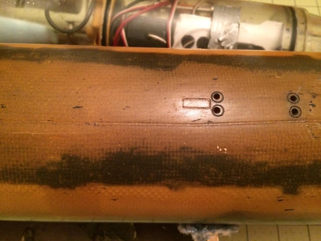

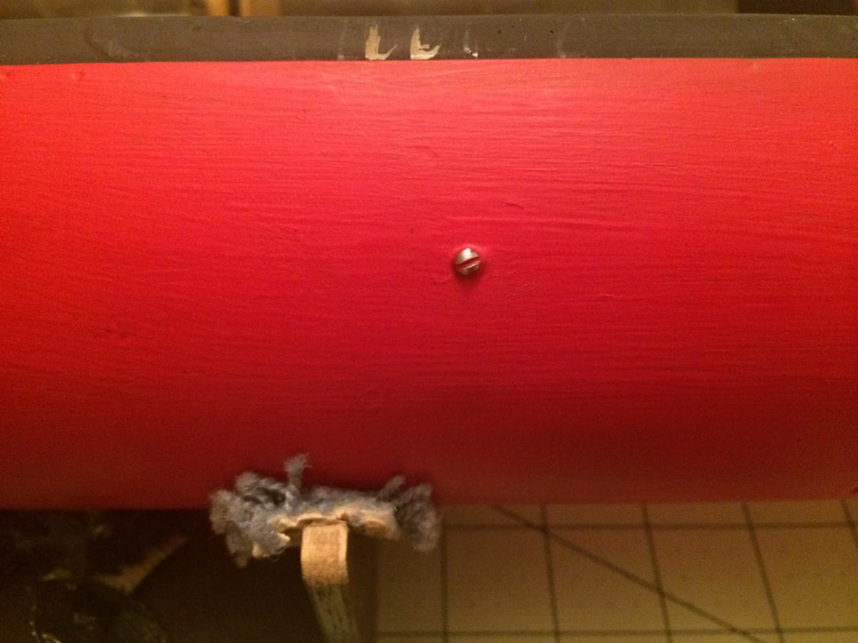

    And the quest for knowledge and assistance begins. I thought it was a Los Angles class, 688i. I was quickly set straight. It is a Sturgeon class. A model made by Mat Thor somewhere between 1991 and 1998. It has an older style Gas system in it, with older style electronics complete with a first gen Sub-Saver. The outside was brush painted with what appears to be laytex enamal house paint, with a house sized brush. Screws are set into the hull from the outside, holding bulkheads in place inside. There are no markings nor detail of any kind safe the camo job on the periscope mast.

    Here are some pics of the sub when I got her.

    Good sized boat, Ronin055! Very cool acquisition!!
    She's a little "rough" but should clean up to be a real looker!
    Stay on the radar screen with your refit!! Would like to see her as you progress!!

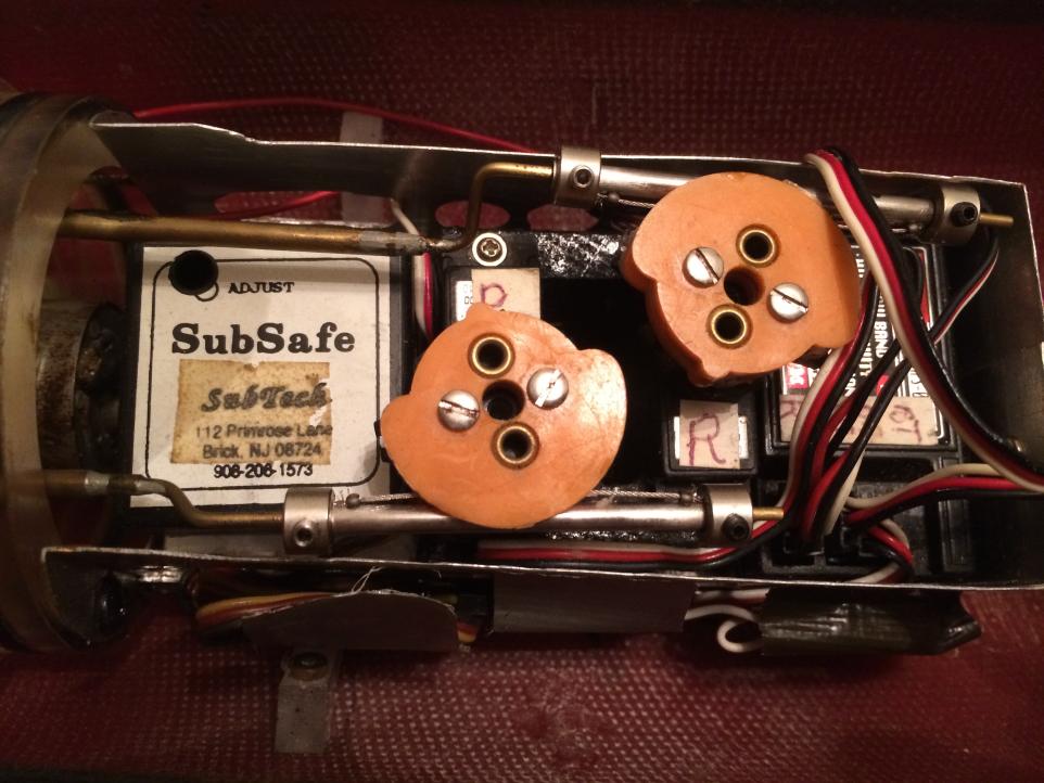

          So, my next step when I got it was to strip the sub down mechanically and see what worked and what didn't. I hooked in a 2.4 Ghz system and tested the electronics for functionality. Everything seemed to work just fine. So I took the WTC into the bathroom and did a submerge test. Unfortunately I got bubbles. Shortly I was able to get the necessary equiopment and seal the WTC correctly. Oil, Grease, and silicone was all it took. The next submersion went pretty smooth. No bubbles. Also we were able to get a radio system for the sub.

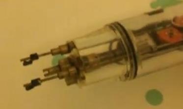

                Interesting clear motor end cap.
                Do you know its manufacture?

                    Ya, the 2.4ghz system was only for initial testing. Digging around at my friends shop, we were able to turn up a radio system that would work. I had to tear appart the electronics suite and cut out some of the original bay housing, but I was satisfied with the results and able to get it all together.
                    As to the clear end cap, Ya I have no idea where that came from.

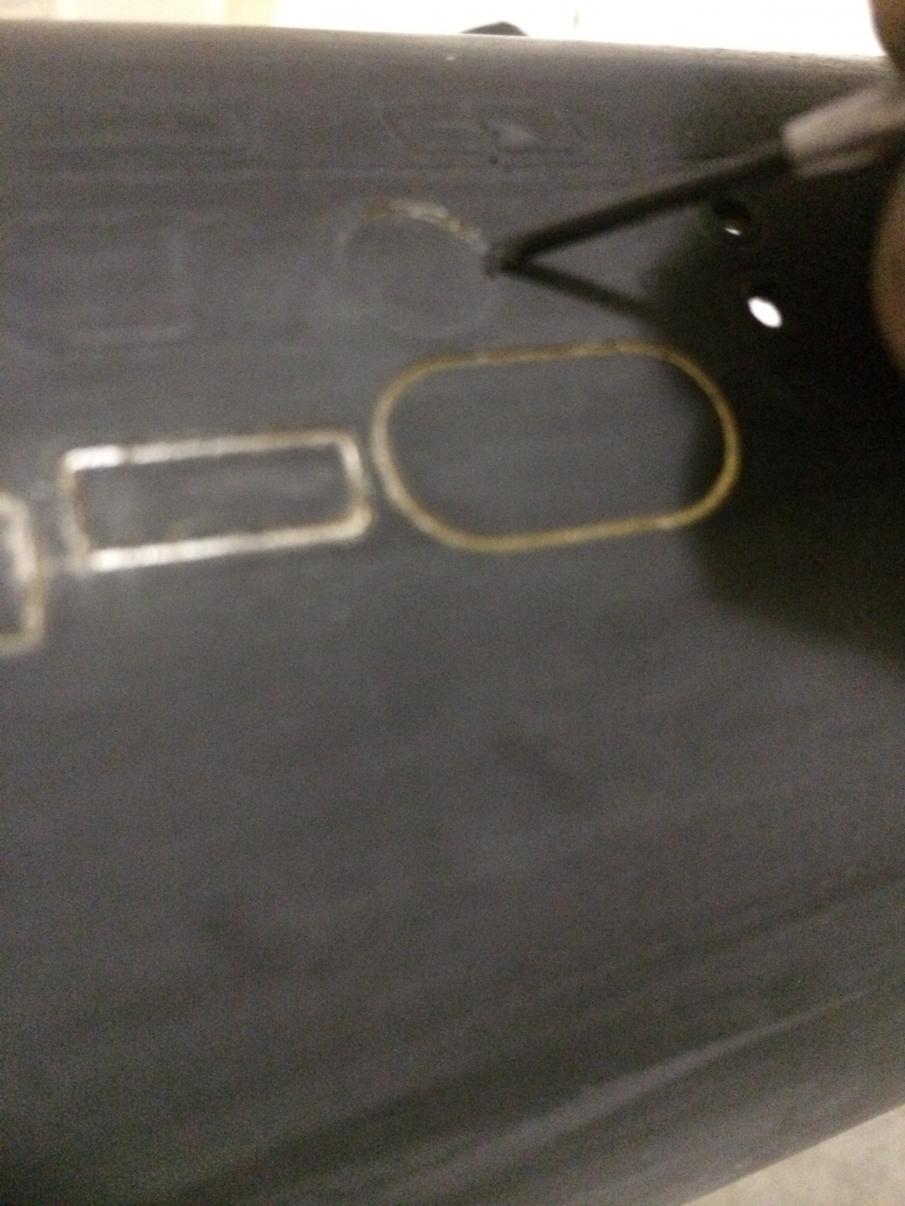

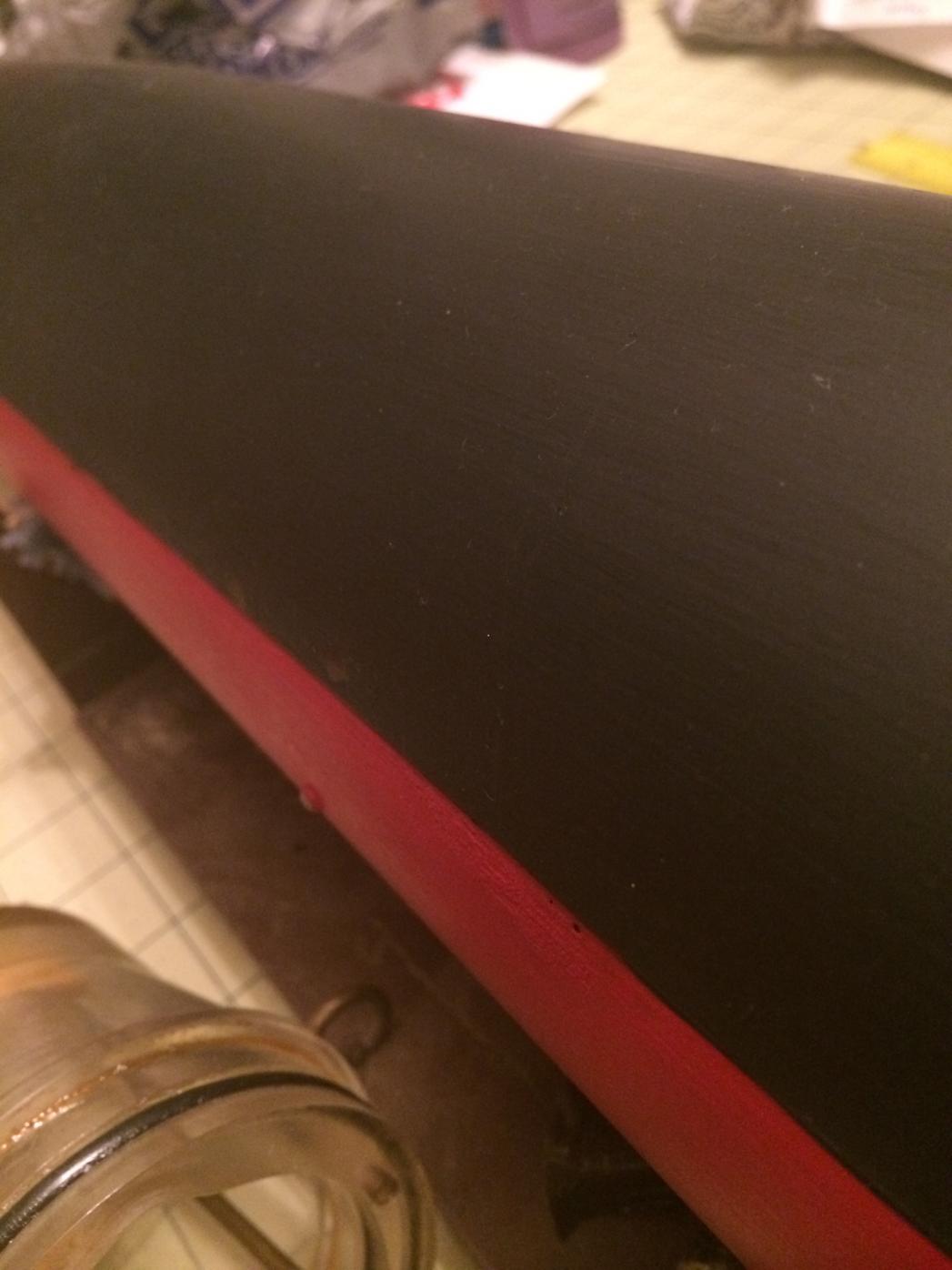

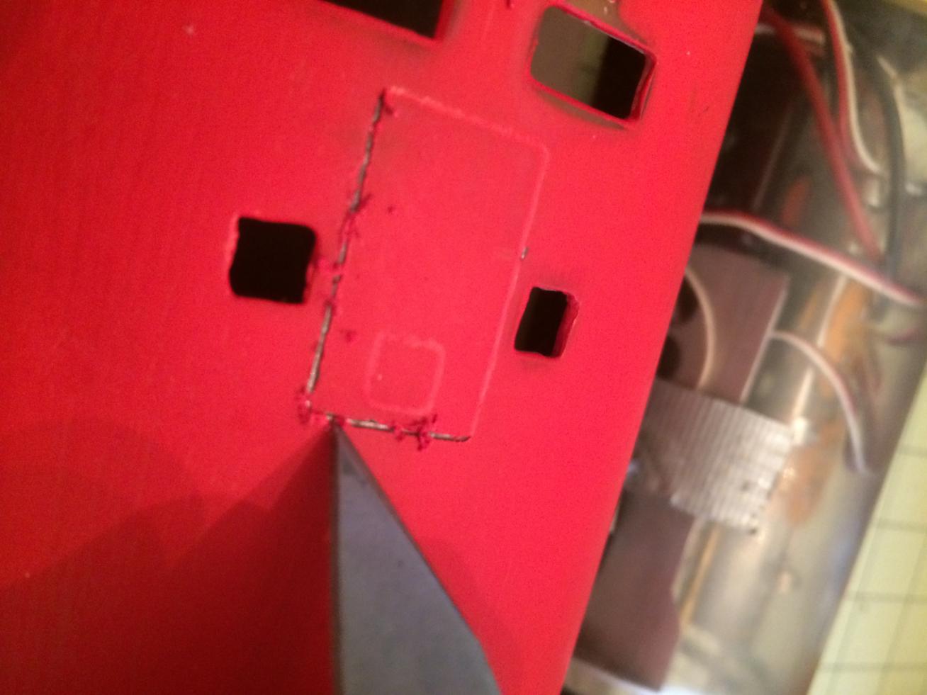

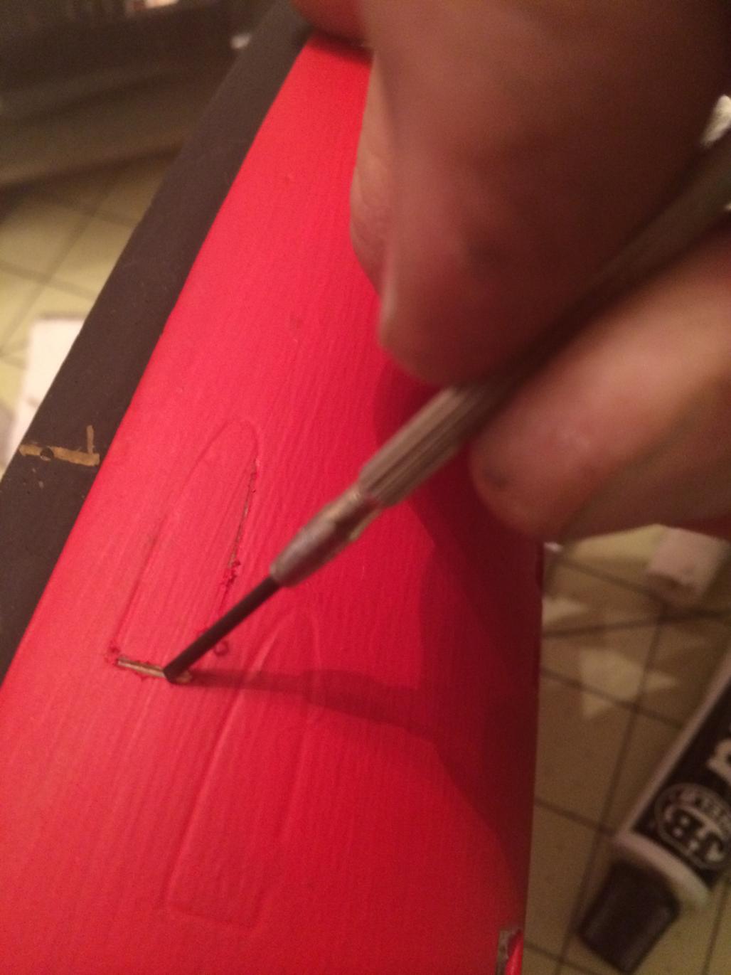

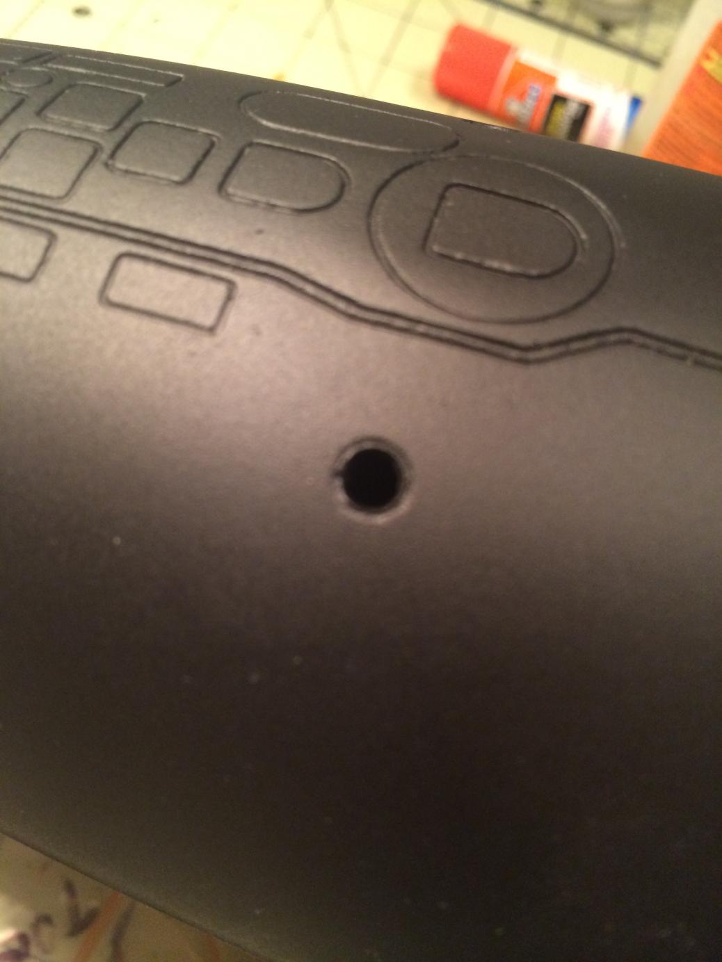

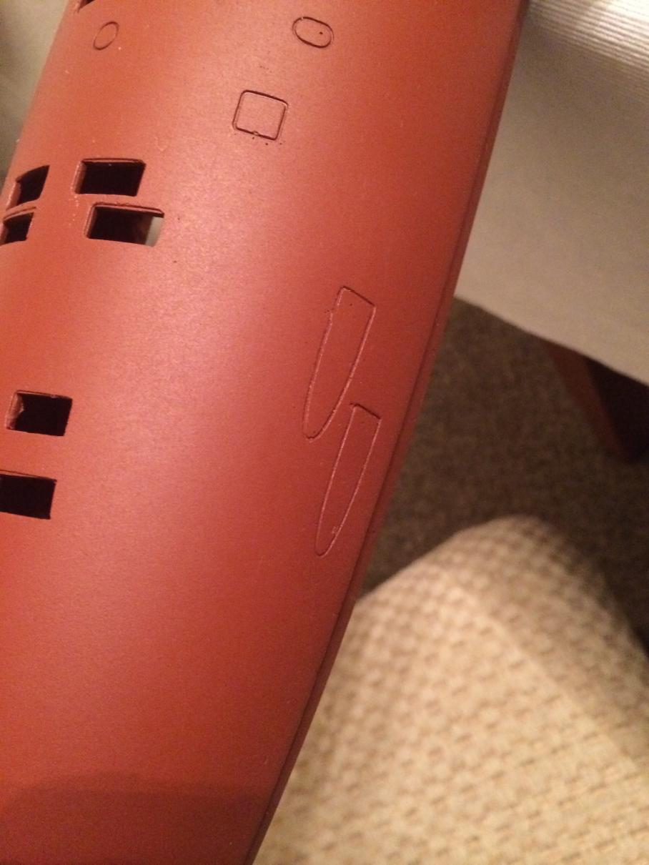

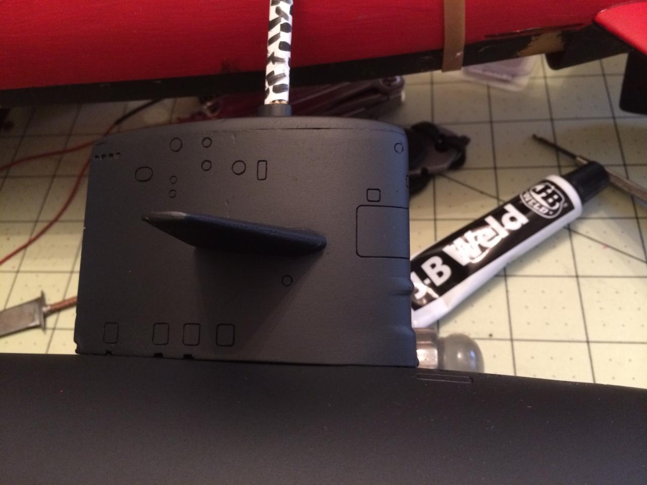

                    In the mean time, while this drama ensued, I got restless and stripped the hull. I mean I didn't start out to strip the hull. I actually was just trying to take some paint out of the swamped detailing on the hull. Then I had some 400 grit wet dry, and I was wet sanding in the kitchen sink, when, well I went through the paint. So I started chipping away with my finger nail. Then I discovered that the nylon "pampered chef" pot scraper that my wife has, could scrape off paint, without marking the surface of the sub. Awesome !! SO ya, that ended up with the sub being totally stripped down over a two or three day period. Thats when I discovered all the super cool detailing on my Thor Design hull.
                    Some primer and some paint later, and the hull was looking pretty good.

                      Lookin' good, Ronin055!
                      Very nice scribed-in details!
                      Can't imagine what was up with the latex paint job!??
                      Unnecessary carnage!! Hah!!
                      Watching with great interest! Keep 'er going!!

                        Ya the Laytex kinda burried the whole thing. I did find out though that a ThorDesign hull will stand up to Oven cleaner for paint removal. No problem at all.

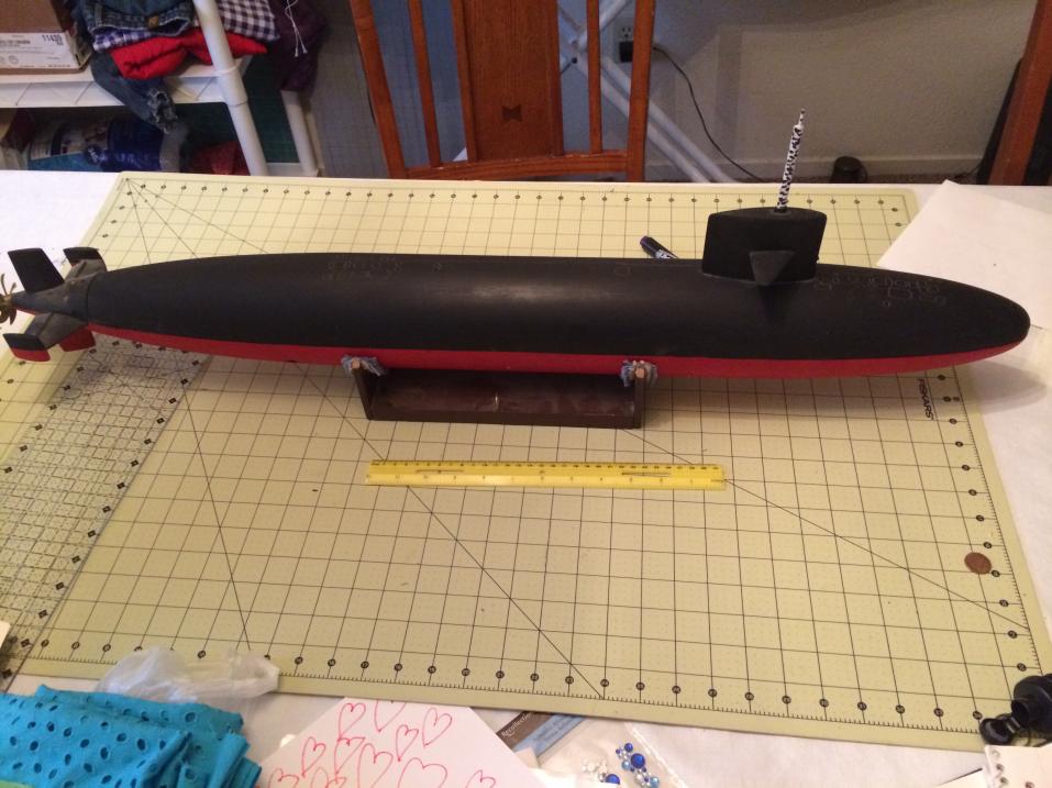

                        Well I recieved the Propel can adapter no worries, and was able to try the sub out in the tub with full function for dive and rise.
                        My son was at the controls once more as we tested her out.

                          Wow! Congrats!!
                          She looks like a "keeper"!!
                          Nice!!!

                            But then one safty or another kicked in full bore and blew 100% of my gas. It corked to the surface and all ballast controls were frozen. Literally. I took it out of the water and there was ice on the controls. SO ya, that restricter is going in the line asap. But I didnt want to wait for that mod to get her in the water. Now though Ive got to figure out what safty blew. I think I'm going to remove the Sub-Safe since I have the fail-safe inline with the receiver. I kinda think the sub safe blew, because the ballast control stuck on full blow, even after I de-iced the controls. And I couldnt get the dive function to work at all. It was like the servo locked out. But then when I got it home, everything functioned perfectly normal on the kitchen table.
