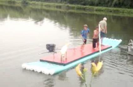

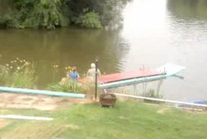

                  #38
                  Here is the maiden voyage!
                    #39

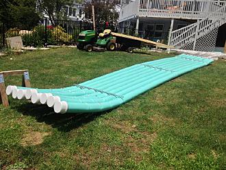

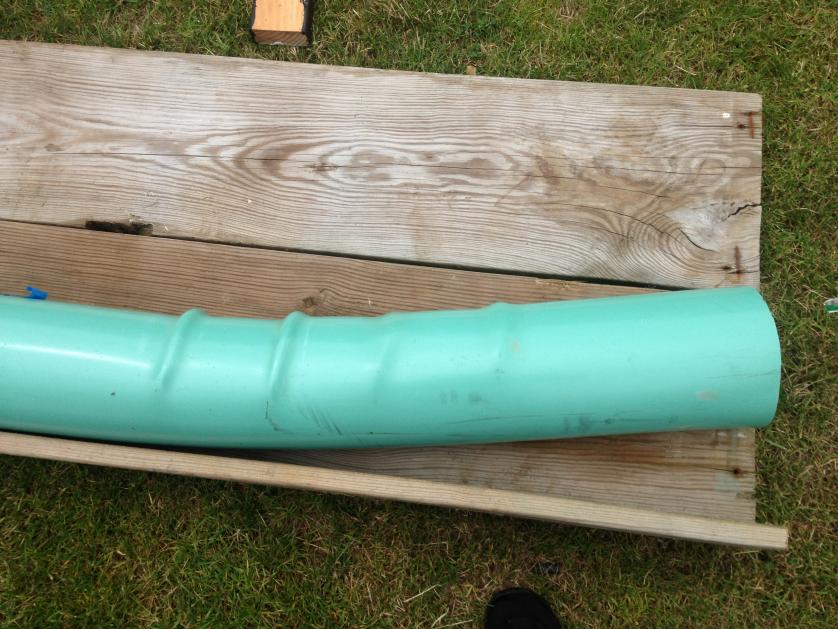

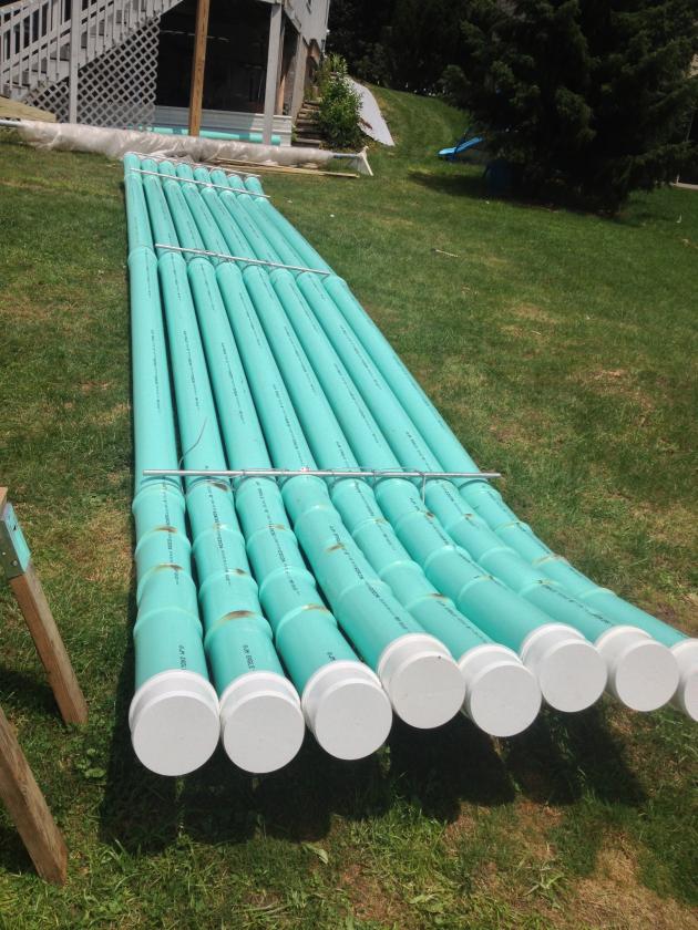

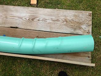

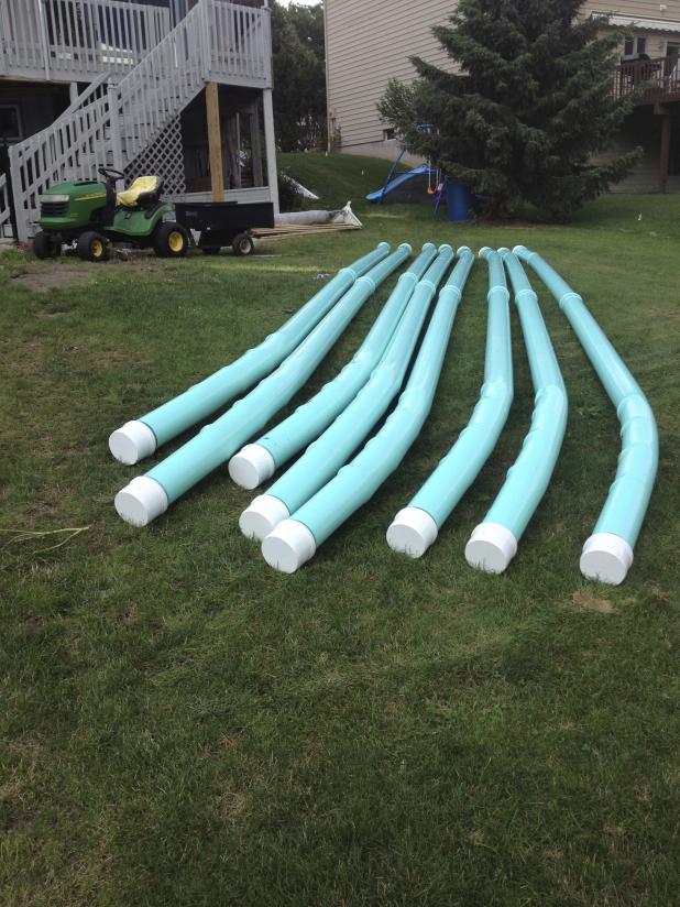

                            My latest update on my raft projects

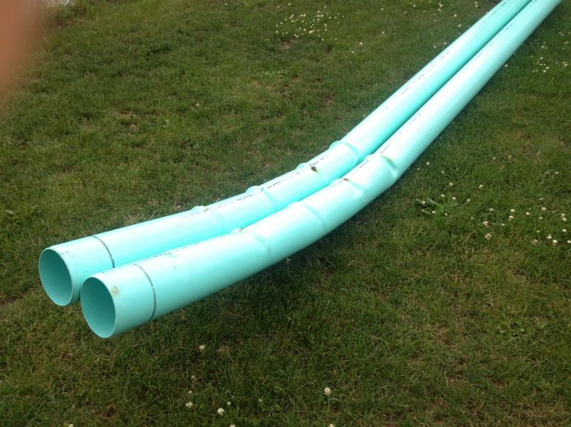

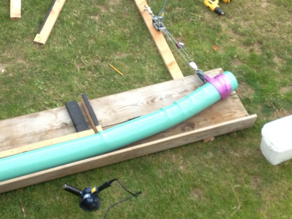

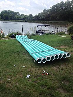

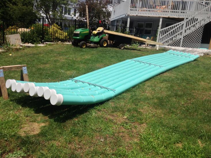

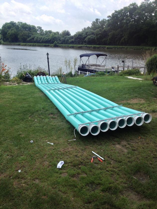

                            After reasonable success with our 14' 4" pipe raft, I decided to do the real Chinese River Raft at 28' long.
                            I bought a special snake coil to go inside the pipes so I could bend them without buckling them, but it was not as good as I hoped and I abandoned the idea for a small hot air gun.
                            The result is here---
                            Several bends in the bow section
                            Bending the pipes using hot air
                            The finished bend, raising the bow about 18"

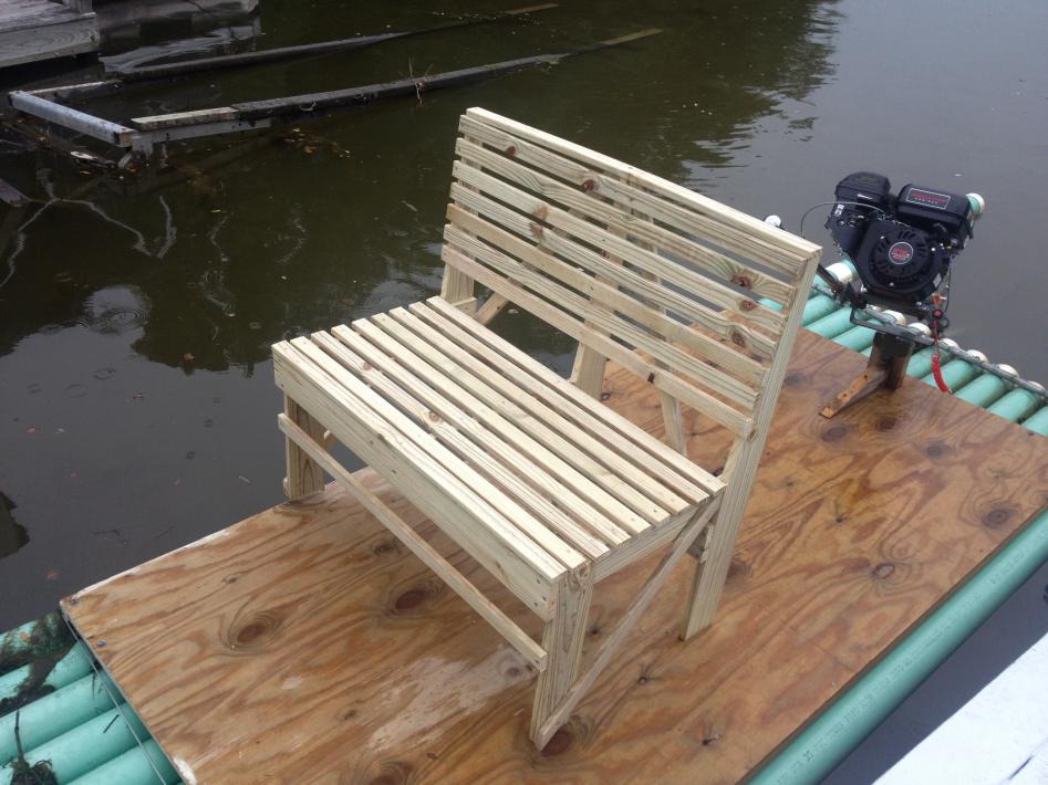

                            The chairs --Click image for larger version
                            More to come ----
