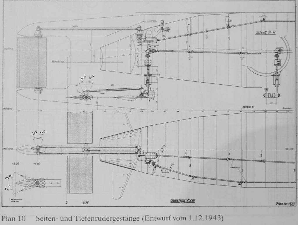

    Yours is the first XXIII model I've ever heard of having a porpoising problem.. It seems unlikely that the cause of the problem is due to the hydrodynamic form of the XXIII model itself. It has always been referred to as a well running model by its owners. I've even seen small 1/72 scale versions running with out porpoising while submerged.
    Only thing I can add is that your stern dive plane throw of 40° to 50° is rather aggressive compared to the real boat. As you can see in the diagram below, apparently, 26° was the throw on the full-size boat. With 25° on the rudder.
    How about this test for the pitch controller (angle keeper). Disconnect the angle keeper from the stern planes and lock the stern plane pushrod into a neutral position, leveling the planes. Run the boat that way and see if there is a noticeable decrease in the porpoising phenomenon. If so, I would think something is not right with the angle keeper device.
    The hull itself is a sound design, so it must be some sort of control related issue.. It would be disappointing to find that this boat doesn't perform as well as the 32nd Parallel model. All that work and with such a nice scale propeller that you made, there has got to be a solution!
