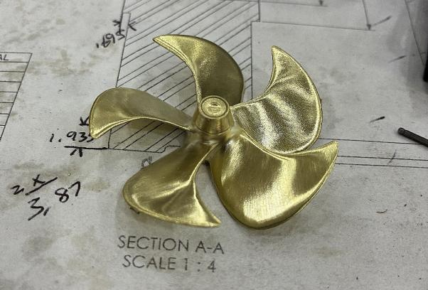

      Suffren still progressing well. Getting ready to paint.

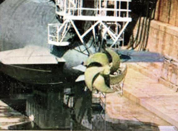

      Mean time getting long lead time items for the Rubis class SSN (SNA) either will be Perle or Améthyste
      STL files in 1/64 (same scale as Suffren) ready.
      Keith Benders prop arriving next week.
      Click image for larger version  Name:	Rubis Ketih Bender prop  6 12 26 B .jpg Views:	0 Size:	44.0 KB ID:	195731 Click image for larger version  Name:	rubis prop real.jpg Views:	0 Size:	53.6 KB ID:	195732 Click image for larger version  Name:	a.jpg Views:	0 Size:	91.7 KB ID:	195733 Suffren

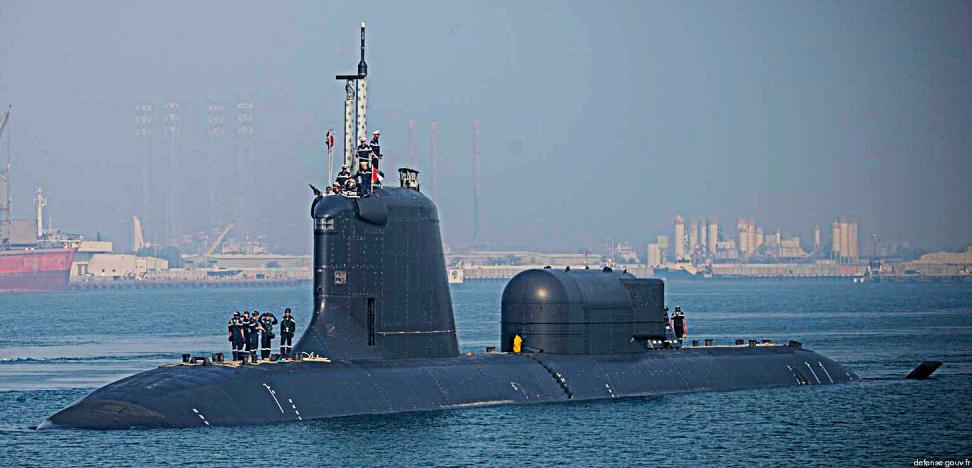

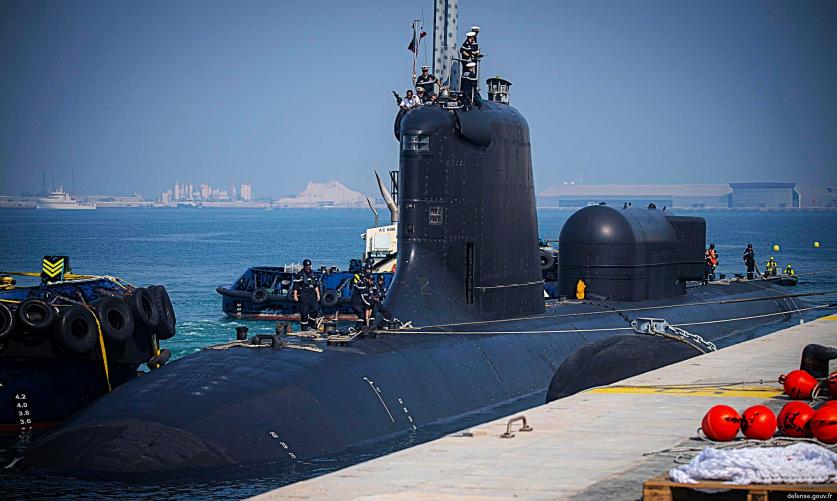

            New work photos of a Suffren class SNA. Great busy shots. Downloads state S635 which is Suffren's hull number herself, so likely this boat is Suffren. I am going to change the casing sail color to add some more blue tint now based on these photos. Suffren model approaching completion. Blue looks practically like the same shade on late war USN F6F Hellcats F4U Corsairs, etc.
            Click image for larger version  Name:	S-635-Suffren-22.jpg Views:	0 Size:	60.0 KB ID:	197129
            Click image for larger version  Name:	S-635-Suffren-21.jpg Views:	0 Size:	58.0 KB ID:	197130

              #126
              Your pictures have and x-tail.

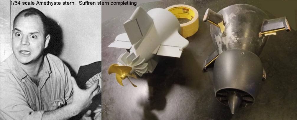

                #127
                Yes, the Suffren has an' 'X tail'. The photos above are related to the Rubis class project parallel and behind the Suffren construction. doing both sametime with the
                Suffren about 85% complete. The Améthyste is 5% (stern) to set up control surfaces on her only. I have been having health issues and sorry for lack of posts related to Suffren.
                Yes there is a X stern on Suffren Dah. You Hockey puck! lol.
                Click image for larger version  Name:	difference 2.jpg Views:	0 Size:	50.0 KB ID:	197133

                  #128
                  Steve,
                  As far as I know, the "Marine Nationale" has used only black paint since the 1960s.
                  The last submarine to be painted in shades of green was the Narval class vessel, which was repainted black following its refit.
                  The photo appears to have undergone poor post-processing to me.
                  cheers

                    Originally posted by Akula54
                    Steve,
                    cheers
                    I think you are right. I agree, its just some blue tint added post processing. I wil stick to my planed blacks.
