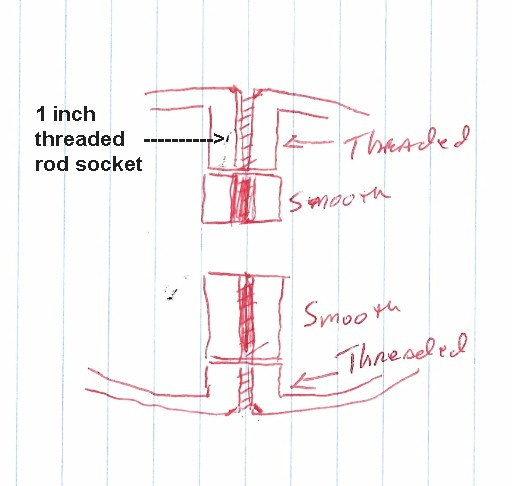

    I've never considered such a linkage to make a traditional type yoke work two opposed, skewed operating shafts in unison. Well done, sir. I'll steal this arrangement some day.
    Thanks David. Steal away if it will work in a particular situation. I wanted a reality check (Big Thanks) to see if I was doing tin a coherent way solving the engineering problem or I was ful of ****..lol
      • 14010
      #107
      Hey!... every good solution is usually preceded by an array of bat-**** stupid 'solutions' that failed to pan out in the real world.
      Here's a variance on your 'universal' fittings between the yoke stems and operating shafts: Substitute the traditional universal joint with a short length of stiff flexible tube. The tube has next to zero radial back-lash, yet flexes between two skewed shafts during rotation.

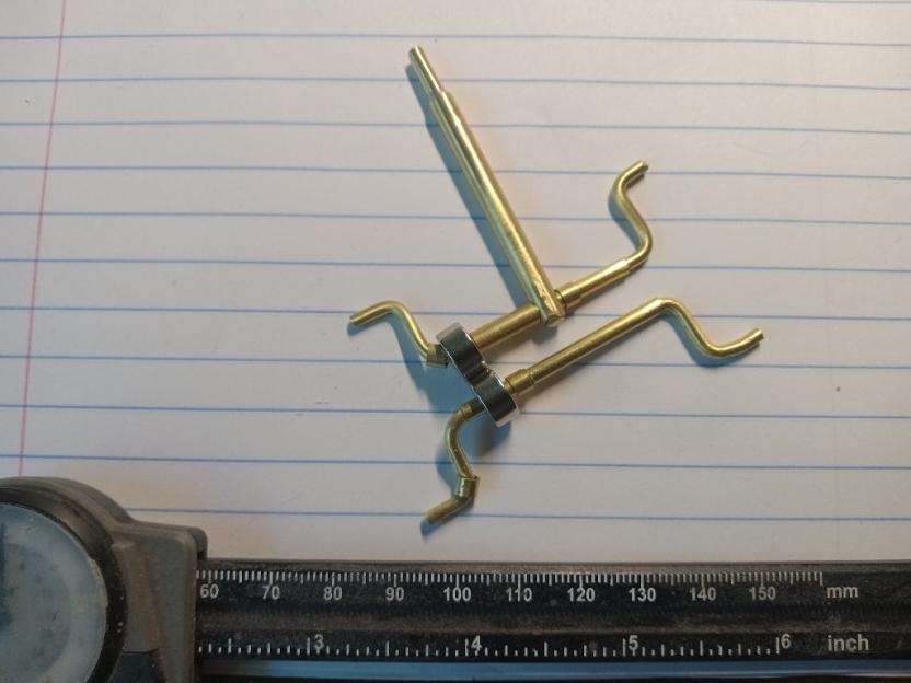

                            Update: I've been in shop doing overly too much thinking on my X stern arrangement. Tried three or four different ways to facilitate the same thing. All worked but some cleaner and easier than others. I think I have it all dialed in now exactly what I like. Since the Pump Jet pivots side to side it handles the rudder functions with its shape and thrust vectoring. The stern planes in my arrangement because of the swivel jet only needs to move together creating up and down forces
                            Final arrangement will have one servo arm instead of two (as seen below). Two magnets now will click securely the two cross arms together, one magnet each on each cross arm. In an earlier version a connecting rod was used connecting the two cross arms, but it caused too much binding and alignment issues.
                            But drilling a whole into two magnets & slipping each magnet down the rod connecting that way will make the system run smooth and easy. The magnets are smooth & cylinder shaped so they stay connected but roll against each other with little to no friction maintaining a precise connection and spacing between.
                            In the back on pump jet shaft is a thin wide washer. It acts as a spacer, so the prop blades don't have any 'slop' fore and aft, and acts as a floating swinging side to side thrust block.

                              Final design for Suffrens X stern linkages. Will solder together today. Donut silver magnets roll and move freely on arms. Larger concentric diameter brass tubing will act as guard rails to keep arm and magnets aligned in relation to each other. The surrounding metal is brass and non-magnetic, so the arms won't impede the is rolling wheel magnets moving freely. After some adjusting and tinkering finalized on this. No slop simplest. Be sure to rotate one wheel opposite so they attract instead of repelling...lol
