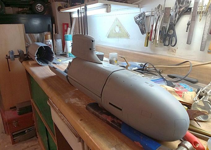

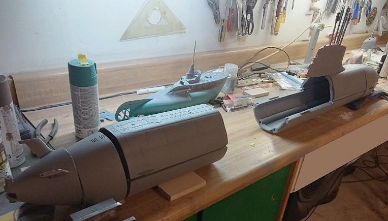

    Assembling fitting hull sections printed today. Starting to look more like a very cool looking French Submarine now. lol.
    Click image for larger version  Name:	assembly-1.jpg Views:	0 Size:	55.5 KB ID:	190382
    Click image for larger version  Name:	assembly-2.jpg Views:	0 Size:	49.6 KB ID:	190383
    Click image for larger version  Name:	assembly-3.jpg Views:	0 Size:	49.4 KB ID:	190384

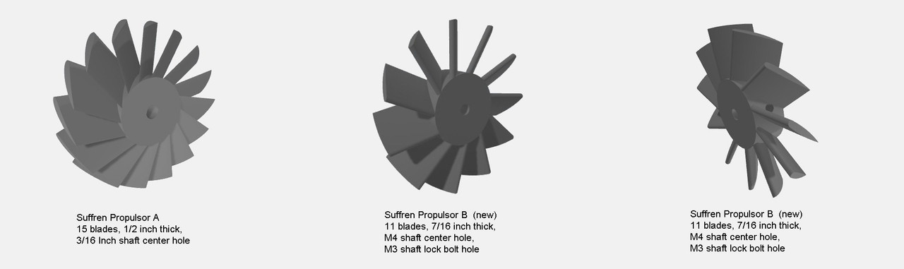

    Making modifications again to the pump jet propulsor. I have a 15-blade version and having a 11-blade version (prime number) designed for comparative testing. Both modified to a special coupling design I made adapting existing off the shelf parts for easy change and replacement of parts in the confined space an still allow easy access such as thrust bearings, thrust block, prop shaft. Sounds like I am threading the needle to fine. But wishing this done in timely fashion before file sharing program free trial ends.

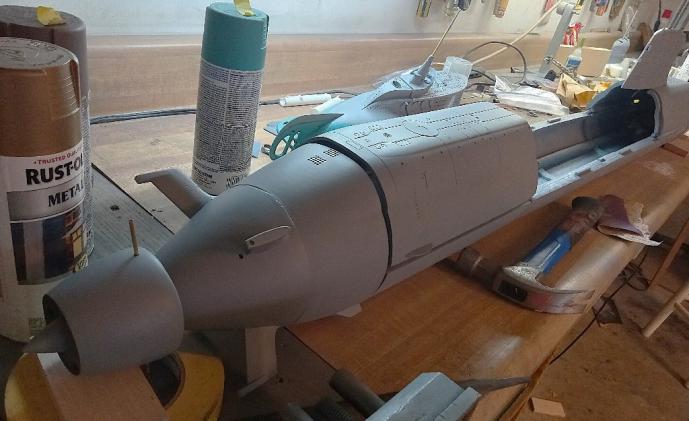

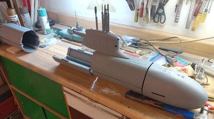

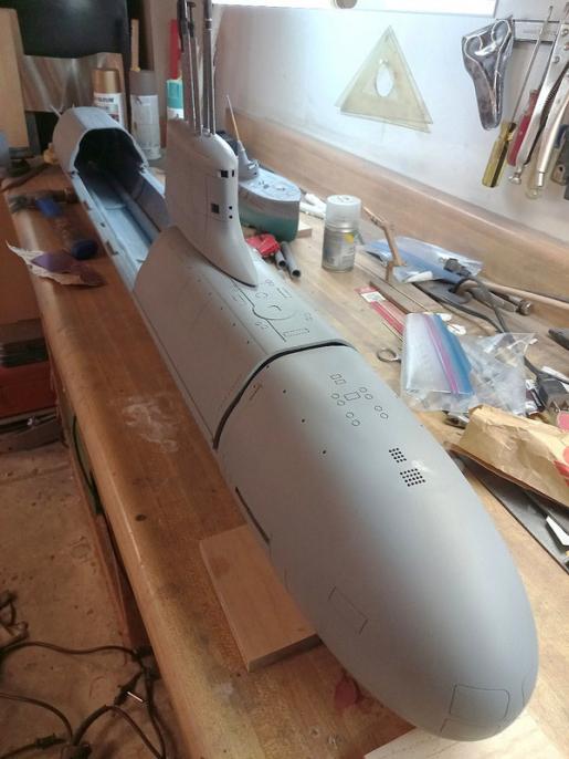

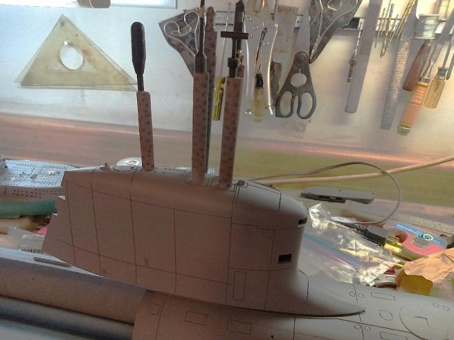

      #62

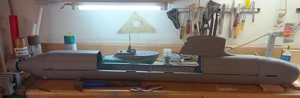

      All the bottom sections printed sanded primed and the tongue and grove interlocking system by Randy Sanders works excellent. A little snug (perfect) and gently hammered with a hammer and wood block into place. Last two top sections printing now. Each section on average took almost 75% of a bottle of resin (Any Cubic resin gray 1kg bottle each) (ABS) .
      Thrust bearings arrived today. trial fit of pump et working well, turns smooth and easy. Created a few special tools for easy assembly and disassembly of all the washers' spacers thrust bearings propulsor and clearances.
      Long day in the shop. Tired. Printer down in garage working through the night. I think an ice-cold beer would be nice and a long nap. More tomorrow.
      broadside phot shows bottom sections test fitted together. 1/4-inch diameter epoxy 4-foot-long stringers will slide through aligned hles and stiffen the whole hull up well. very strong already.

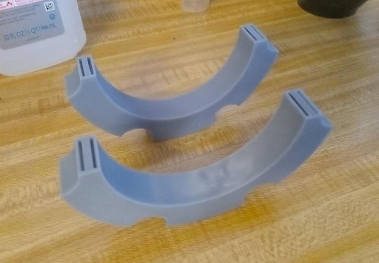

      Printed dive module frames
      Click image for larger version  Name:	assmembly-8.jpg Views:	0 Size:	46.5 KB ID:	190457

        Hi,
        She's a beauty !!!
        Great job !

          In parallel, working on the Suffern pump jet. the swivel pivot part works perfectly. But I am having some issues with propulsor vibration and doing a bit of re-design so the pump jet's shaft is solid on both ends of the shaft working smoothly, working to get the propulsor as balanced and centered in the shroud with as little blade tip clearance as
          possible. Using a modified Raboesch prop shaft and seal with its bearings.
          Redesigning the propulsor itself, from 17 blades, down to 15, and now in final iteration reducing in latest design to 11 blades.
          The issue is making sure the shaft is solid to the rotating pivoting shroud, The Raboesch shaft should do it I hope. tinkering with it now. have stuff gathered over the years and bashing something clean sold and simple, I hope. If nothing else its fun figuring out a problem sweltering in a hot garage..lol.

            #65

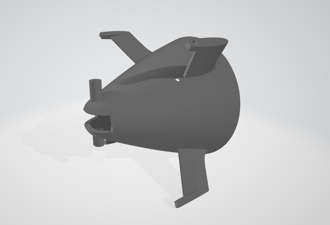

            New redesigned Suffern model propulsor. Nothing wrong with previous 15 blader, but refinements for ease of building having worked with parts in the shop. This is a model interpretation, so expect Real Life is a lot different. If I knew what the real one looked like I would not share it here anyway for the sake of our French allies.
            I am sure the real one is a million times more sophisticated, but my little one here should push the water well enough at the pond. Bob Martin hinted from his experience, the fewer number of blades to a certain extent the better model wise for thrust.. Also reduced overall diameter by 1 mm, and 11 blades now (a primary number)

              #66
              Will definitely move water. An ogival blade shape on the outer blade edges together with some cupping may also improve performance. Pumpjets also often have raked blades like a truncated scimitar prop, a,though I believe that is more related to stealth than efficiency.

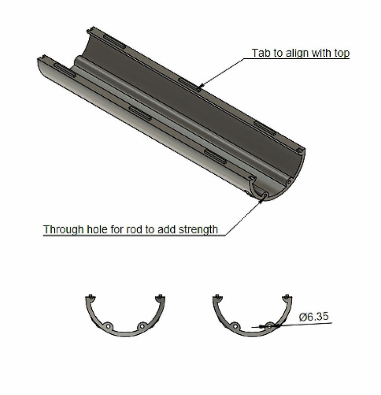

                        I have an electronic question please from anyone here that knows a lot more than I do i'm sure.
                        Designed in my printed Suffern hull sections 6.35 mm diameter tunnels or tubes in my hull sections for inserting 5 mm rods for longitudinal strength.
                        I hope to use four 5 mm epoxy rods or stainless-steel rods for this.
                        If I use steel will these interfere with radio reception to and from receiver and transmitter? Steel maybe be cheaper, but will it be a hindrance t radio reception? What about Epoxy rods?

                          • 1638
                          #72
                          Everything which is metal can give problems with receiving signal, in your chase i would go with Carbon rods, strenghtwise they are good enough.
                          • Akula54
                            • 48
                            #73
                            If I have to use rods for the hull, I agree with Manfred about using carbon rods.
                              • 911
                              #74
                              Agree, Thank you. I originally planned with carbon rods, but before purchasing them had second thoughts if I was over thinking. I'll use Carbon fiber rods or epoxy rods,

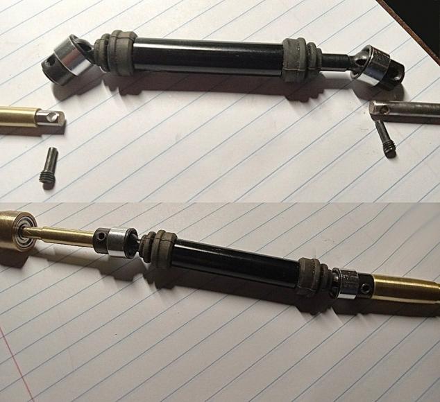

                                #75
                                Time to unclutter the bench top getting out of hand..lol. I did some careful machining and drilled 3 mm holes for locking pins through the 5 mm steel drive shafts. Coupled up the flexible drive shaft to facilitate the swivel pump jet.
                                The shafts are over long deliberately. They will be cut down to length when the dive module is all positioned in the hull. the drive shaft just aft f the dive module will have brace supports t the hull too. n or two frames.
