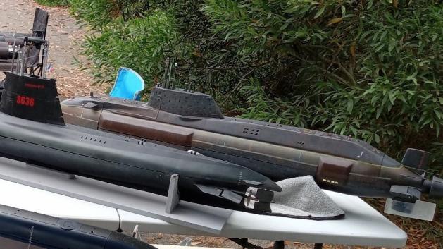

        I was prompted when at the ideal for running San Fransico Sub Regatta where a friend brought his beautiful Astute class HMS Artful in 1/72 scale. He complained it turned like a pig, even after making and adding a transparent slipper addition to the rudder below on the cruciform stern.
        At the same time interestingly Bb Martin has a video of his Trafalgar class with a pump et in 1/64 too (same cale as my future Suffern).. That model Bob demonstrated had excellent turning in the pond surfaced and submerged. The models are of similar size / shapes in their hulls and surface area for their rudder's stern planes too.
        The vectoring pump jet was an idea I wanted to test out. But Bob's Trafalgar suggests a lot about turning ability maybe more about the center o gravity, the rudder area, combined importantly the length of the rudder's moment arm from the boats center of gravity / buoyancy, despite the big 'lamp shade' on the back.

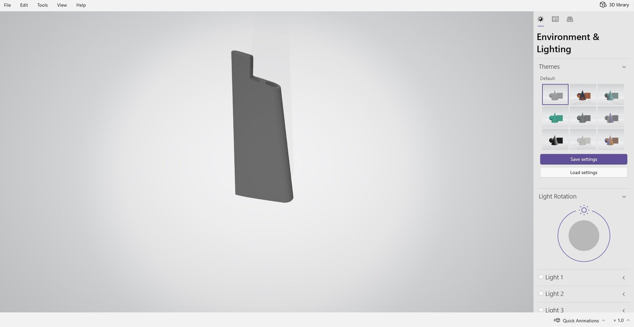

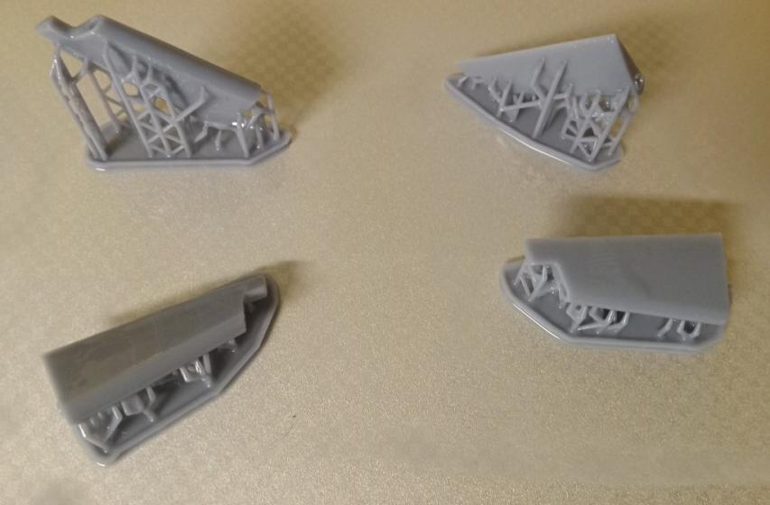

              Slowly by trial and error learning to 3 d print the Suffren parts. Tech support really sucks, and you tube videos are worse. 'Oh, it's so easy!' **** them. The issue now is exposure times. The manufacturers seem all way off. Seems 3 d printing is as much an art as it is a science. I was hoping more on science. Local Freind and sub builder Jeff Apts is being of great assistance. we are dialing it in.
              On test rudder 3 , managed t print 2 of 4 rudders sliced. At least after 3 months got some indication the printer and slicer program actually works. Before this total darkness. It's a start.

                    Is the change in the shape of the control surfaces intended to improve the model's maneuverability?
                    The chord seems to be constant, although narrow, in this photo.​

                      With any new resin printer and with any change of resin (type and manufacturer) it’s necessary to run a calibration print to check the correct exposure times for the best results. You usually only need to run two or three of these before you have the right settings dialled in on your slicer.

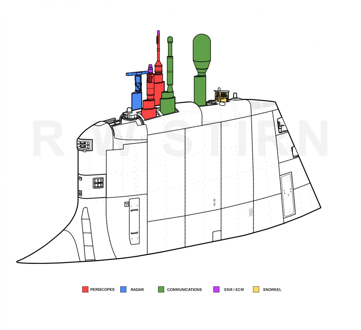

                          Also, great looking work so far!
                          Here's a better quality version of that image, even if you've completed the masts...
                          Sail and Masts of Suffren SSN [R W STIRN]
                            • 979

                            Still struggling with the damn printer. Successful RERF exposure test. then took the best sample and loaded those exposure settings and it failed for 5th time. Ready to give up.
                            Wonderful stl files ready, slicer ready. Printer seems to wrk. But.........doesnt produce anything useful...5 piles if useless resin flash slicer parts.

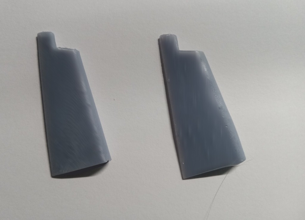

                              Break through success finally. Proceeding with other parts. The rudder shapes I'm aware of and adjusting. Easy fix sanding. I will later after I see how the whole model looks. Thank you
