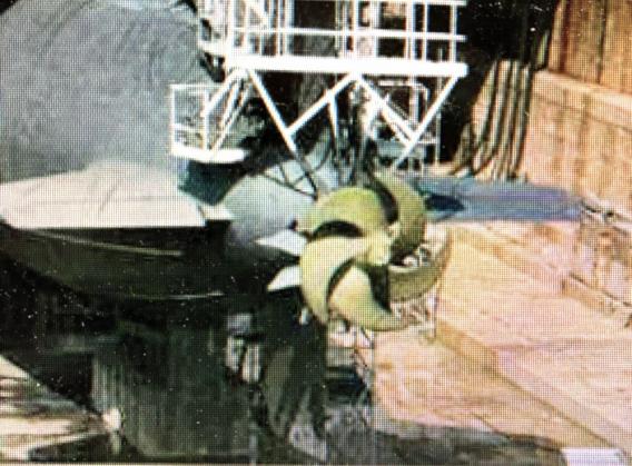

    Keith Bender RUBIS Prop
    Click image for larger version  Name:	rubis prop real.jpg Views:	0 Size:	53.6 KB ID:	195773

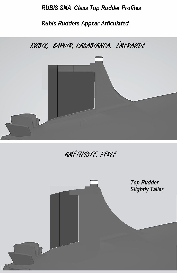

    variance in rubis tops rudders
Name:	rubis class top rudder profiles.jpg
    Click image for larger version  Name:	rubis rudders photo.jpg Views:	100 Size:	43.2 KB ID:	195793

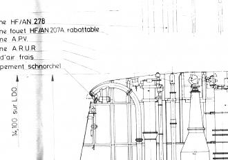

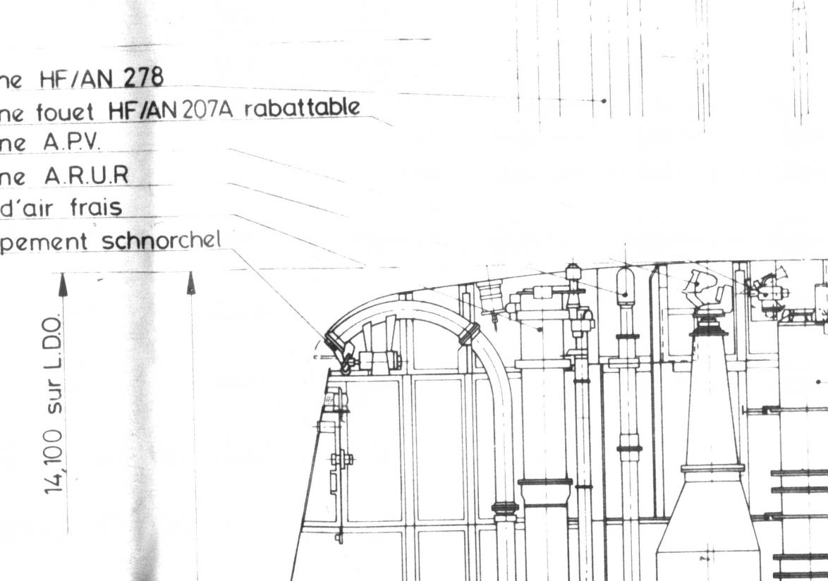

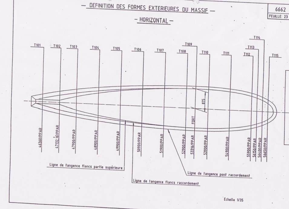

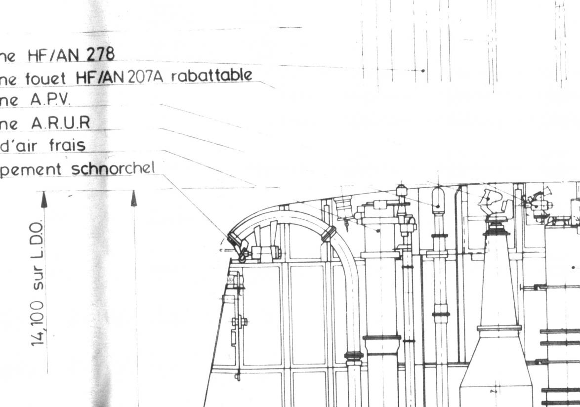

      If you are still interested, i can purchase some drawings with right design/form of the Amethyste class.
      Click image for larger version  Name:	schnorch.jpg Views:	0 Size:	85.0 KB ID:	195809
      Click image for larger version  Name:	Capture d’écran 2024-02-20 191114.jpg Views:	0 Size:	48.0 KB ID:	195811
      Click image for larger version  Name:	massif amethyste.jpg Views:	0 Size:	59.7 KB ID:	195812

        • 981
        Thank you for the drawing. The sail is already completed (printed) and happy with accuracy, unless you spotted something inaccurate, I missed. If so, can you share, please.
        My drawing is close but not accurate enough to be definitive to me. Can you post here from your drawing the stern and its rudder and horizontal plane shapes please?
        Your drawing is a big help on the masts. Merci.

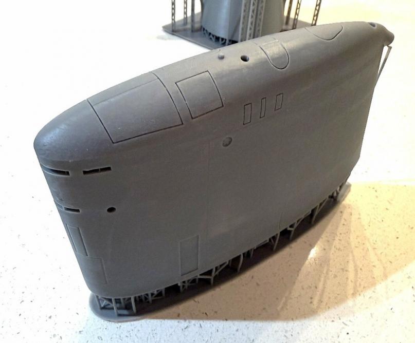

          • 981

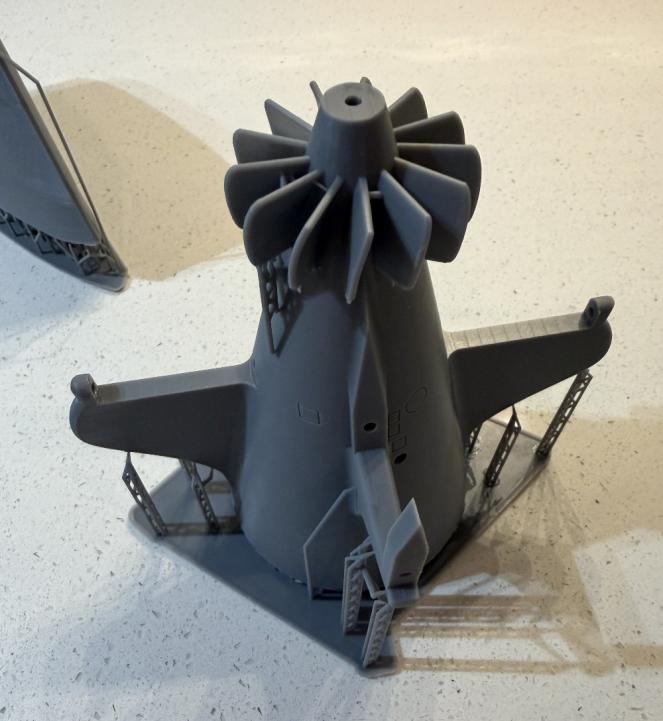

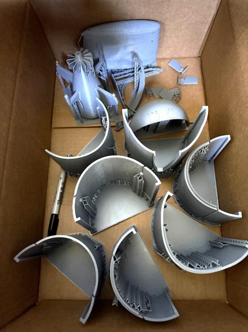

          Printing of all the Rubis parts should be completed by Monday June 22. 2026. Will be placed in a box separate from Suffren parts work till Suffren is done. I am having extra Suffren dive module supports printed too & will have the outer circumference using my bench disk sander cut down to fit the smaller Rubis hull. I will use U stern plane connectors for the Rubis for the stern planes and rudders. I am using parts refurnished from old subs model no longer in service. (from my old Skip Asay Albacore). A few parts
          remaining printing now to be done by Monday
          .Click image for larger version  Name:	rubis parts.jpg Views:	0 Size:	47.2 KB ID:	195884
            • 981
            All parts printed and set aside , in wings as Suffren finishes. Some new masts being made. Really a generational leap in technology between the Rubis 1980s and Suffrens 2025-2030.
Name:	Rubis parts box.jpg

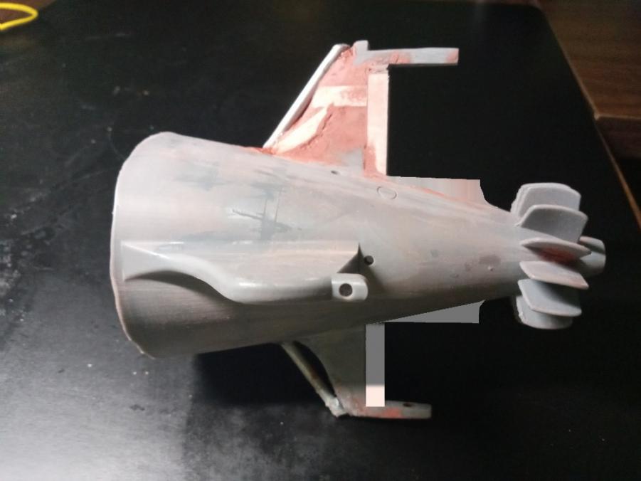

              Doing some preliminary changes to the Rubis class so rudders match the Amythyste and Perle top rudders.
              Cutting new rudder holes, so rudder and stern plane control rods off set for clearance internally. Aligning with brass tubing as a fixture to keep everything aligned and new brass tubing ridder holes lined up and CA glued & puttied. So straight to the new pivot axis's points.
              Upper profile changed to match Perle's upper rudder, this rudder is taller and narrower chord. Rudder silhouette is rounder on top also Use styrene solid stock to block out and shape.
              Some touch ups to the sail lower rear, building up with styrene and Bondo putty.
              Click image for larger version  Name:	Rudder cut 1.jpg Views:	0 Size:	38.0 KB ID:	196061
              Click image for larger version  Name:	rudder cut 2.jpg Views:	0 Size:	94.1 KB ID:	196062
              Click image for larger version  Name:	sail rubis putty.jpg Views:	0 Size:	38.6 KB ID:	196063

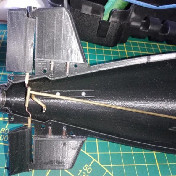

                  Making corrections from stl file. The Randy Sanders STL file is correct for the first 4 boats in class. But last two - Perle and Amythiste rudders are different. Chose Perle because me and Keith Bender agreed Perle easier to spell...lol. Thanks, I got this.
                  Below shows your build with different rudder shape which I an changing to approx.
Name:	akulas Rubis rudder.jpg

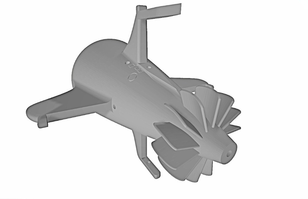

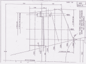

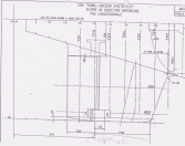

                    As I mentioned in a private message, I have drawings that can help you create a model with more accurate shapes.
                    The printed model made by Minialand is right in form, but he took liberties with the technical solutions that I do not agree with. Too bad.
Name:	Capture d'écran 2026-07-02 233458.png
ID:	196070 Click image for larger version
Name:	lower rudder.png

                      Merci beaucoup. Cela tombe à point nommé.
                      (Thank you very much. This is timely.)
                        • 981
                        Using the drawings above. Aluminum tubing leqding edges - simple and works. Vertical rudder holes also shifted back 5 mm.
                        Click image for larger version  Name:	amy 1.jpg Views:	0 Size:	41.9 KB ID:	196128
                        Click image for larger version  Name:	amy 2.jpg Views:	0 Size:	42.1 KB ID:	196129

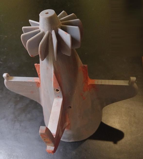

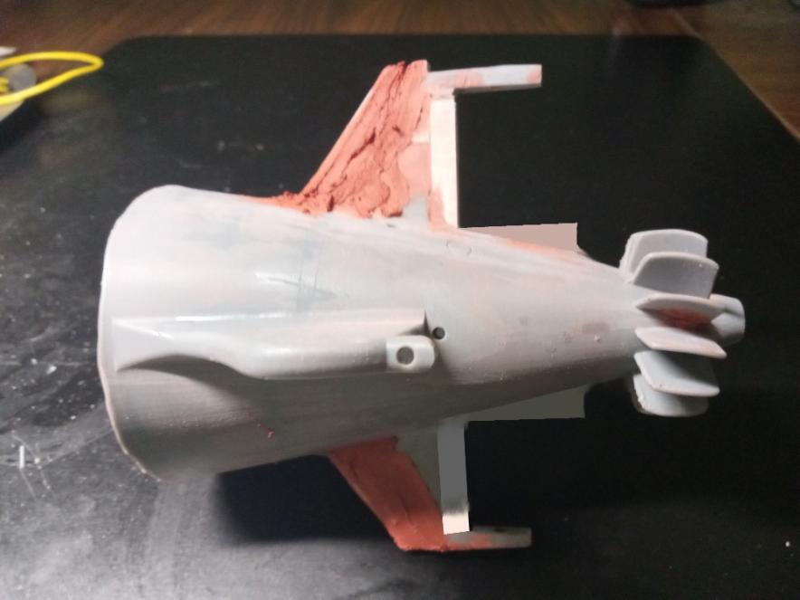

                              Stern filets added. Will reshape horizontal plane fillet leading edge too soon. Fun stuff.
                              . Click image for larger version
Name:	stern sanding 1.jpg
Name:	stern sanding 2.jpg
