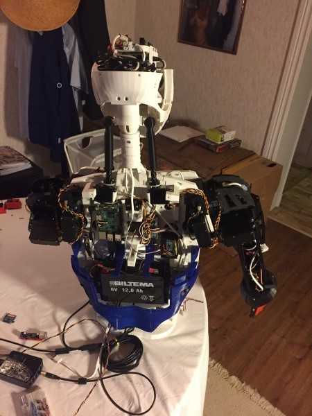

                ARDUINO at it's best!
ID:	175099 Click image for larger version
                There is a significant amount of code writing to do. But when completed, Arduino is the way to go! You just have to take it one step at a time.
