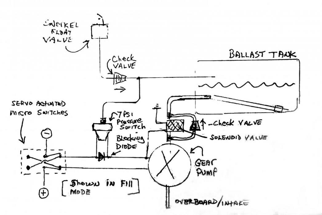

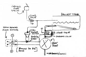

              I'm hoping this thread is still viewable, sadly Bob passed away last Sunday, he was a very nice guy ! Onto my problem, my pump controller has flooded the electronics and I'm assuming will be U/S, given that OTW ones will ne longer be available, what alternatives might there be on the market for a sensor probe tank ? Newbie so be gentle LOL ! Paul.

                If you need more volume an alternative approach is to cap the hole that vents the air into the dry space, ignore the sensor, then use a snorkel vent to use the full volume of the tank, and just use a simple bidirectional esc to control the pump.

                        Thanks all I guess the functionality I would have liked was some form of stop mechanism at the tank full limit as the air bleed hole above that level is what caused me to lose the submarine !

                          I would just convert it to a vented ballast with an air hose, pipe the displaced air to the surface via a conning tower snorkel and trim the submarine with slightly positive buoyancy when submerged.

                            Thanks I'm going to do just that, I have ordered a snorkel I can conceal from Bob. How easy is it to drill and tap acrylic tube as I can only get to one side of the tank face so don't have the luxury of a nut on a pass through fitting ? For snorkel vent.
