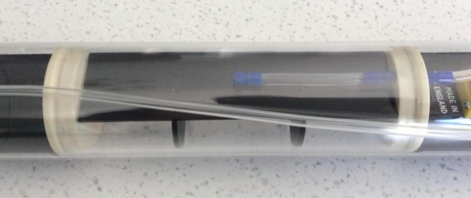

          • 2642
          A horizontal baffle like the R&R system tank pictured would reduce this problem, but would mean slicing open the tank, which will be tricky as they're solvent welded together.

          Ultimately with the OTW system you do have to accept some limits as a consequence of having an exposed water surface and venting/compressing air into the dry spaces as the tank fills.

            Aren't OTW tanks baffled as they come? All of mine are, I have 3, all different sizes. Each has 3 baffles in the MBT.

              Same, except I have 2
                • 2642
                They have vertical baffles, which slow the movement of water down but don't eliminate it. If you're filling your ballast tank whilst diving at an incline, then the problem will be exacerbated as the filling pipe is mounted in the forward bulkhead of the tank.
