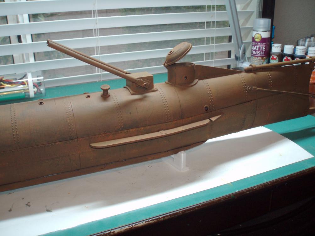

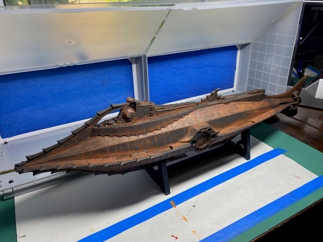

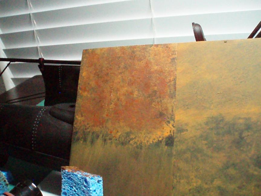

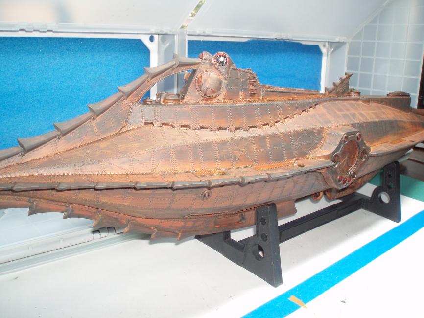

      Just seen your post! Sorry, I am so late in responding! Your words are so kind and FAR to generous. I have so much more to learn about this hobby and the ins and outs about the finishing techniques that are involved. My joy in the building and the mechanics of sub building. A lot of people enjoy making there boats look like they have been at sea for years, and I truly respect those that can achieve this look and with such realistic results. I like the look of before the effect of the elements.
ID:	160634Click image for larger version
ID:	160635Click image for larger version
      I have made attempts to do a more realistic look on several of my boats. It is certainly a learning process of which I need to spend a GREAT deal more time to achieve. For now I just enjoy the hobby for what it is!
      Thanks again Randy,

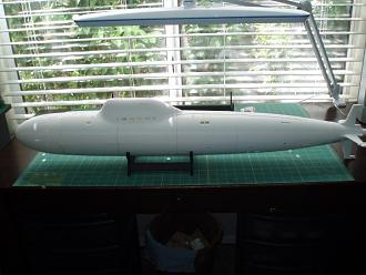

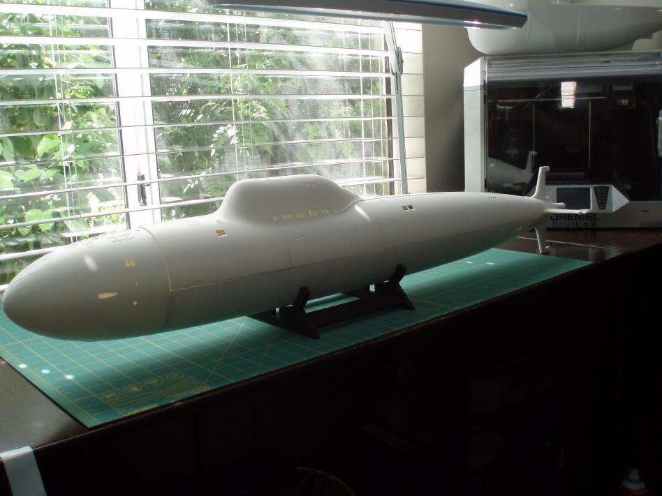

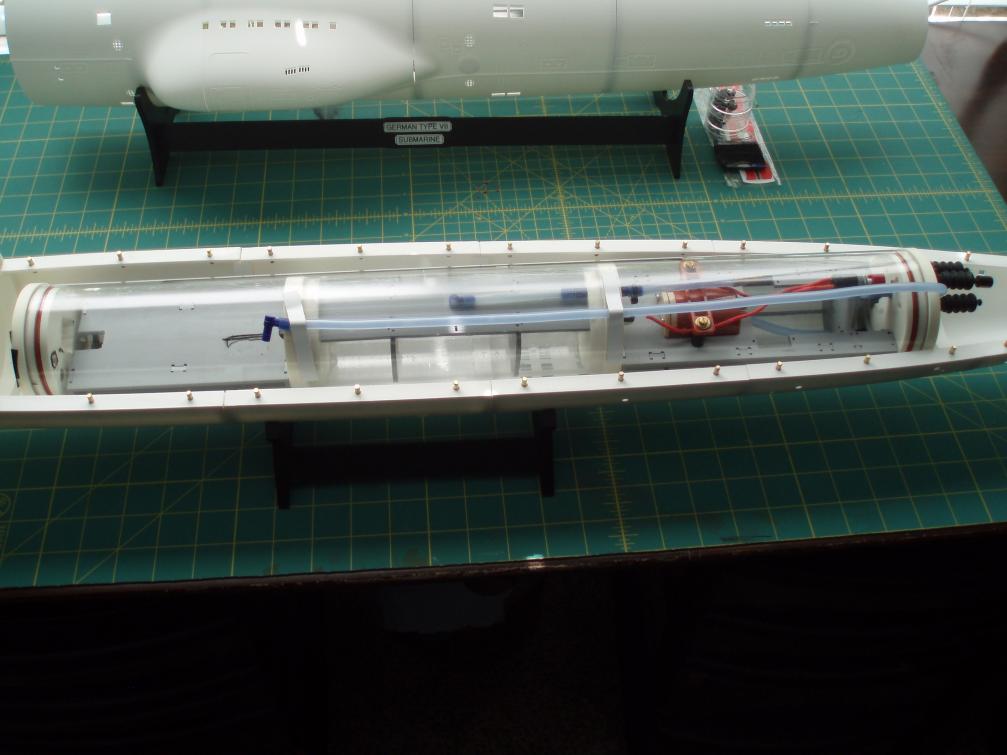

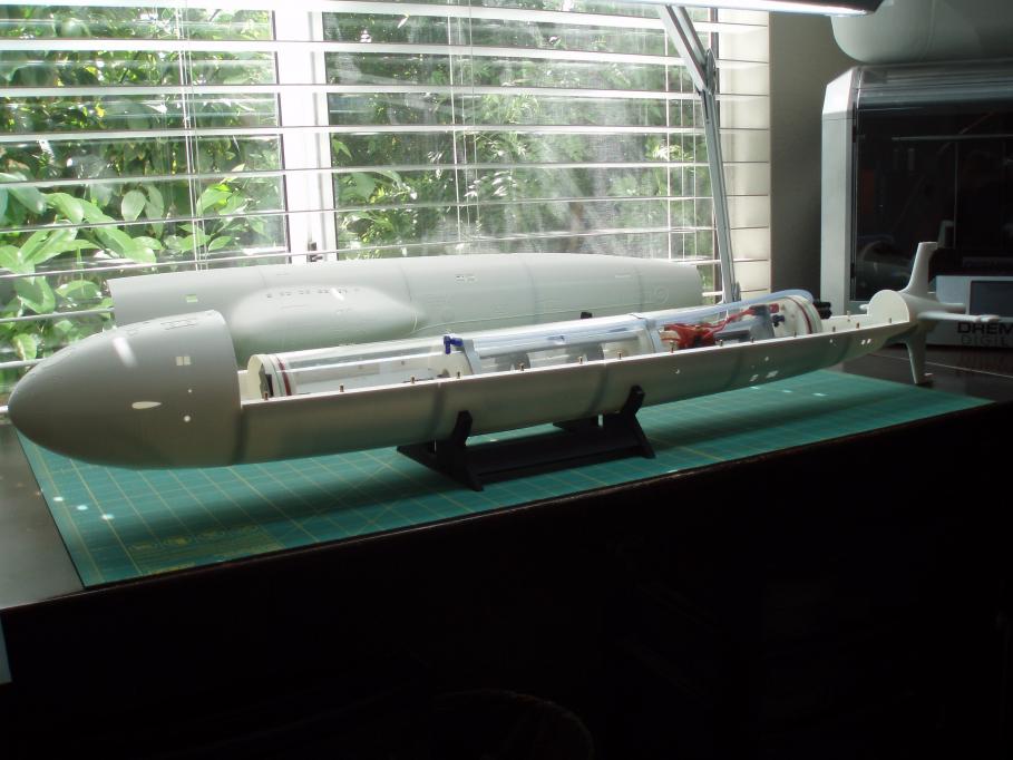

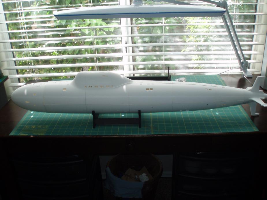

        Just when I thought I was done with the ALFA builds, well I am back onto the 1;72 scale that was also part of this blog!
Name:	ALFA BUILD 4.jpg
ID:	161392Click image for larger version
Name:	ALFA BUILD 3.jpg
        Well, this is going to be a big leap! As I stated on this blog about the 1:72 Alfa, I was going to scratch build a WTC (SD) for this boat. I have what might be another one of my big under thought goofy idea!

        I have stripped out my original 80mm WTC that was supposed to be for the Arkmodel Type VII boat. I am going to take it from a dual shaft system and convert it into a single shaft WTC. If I can make the conversion from dual to a single, I think the ballast system and the overall WTC will be a good fit for the 1:72 scale Alfa! "Another Experiment"

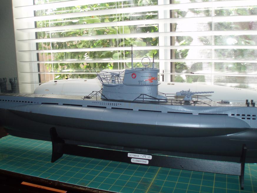

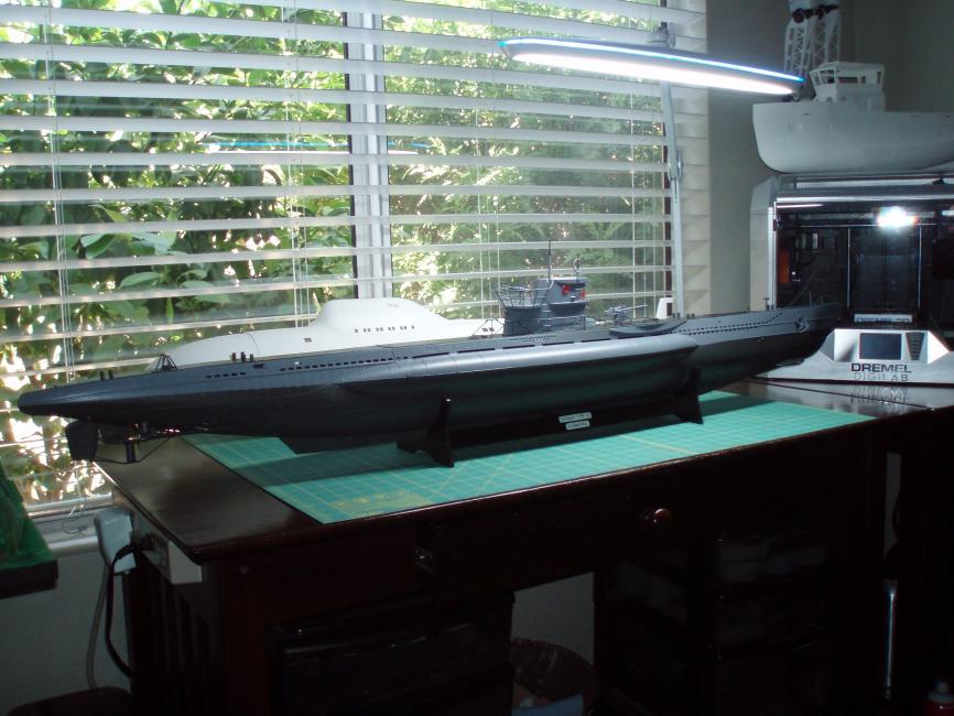

Name:	ARKMODEL FINISHED 3.jpg
ID:	161515Click image for larger version
Name:	ARKMODEL FINISHED 4.jpg
                              I set the Type VII as a static model only! It was a good build for me, but I made some mistakes on the 80mm WTC, and please understand, these mistakes where my fault NOT the product! The boat turned out to be a great build so I gave it a paint scheme of the early U-552 and added it to my static model collection.
