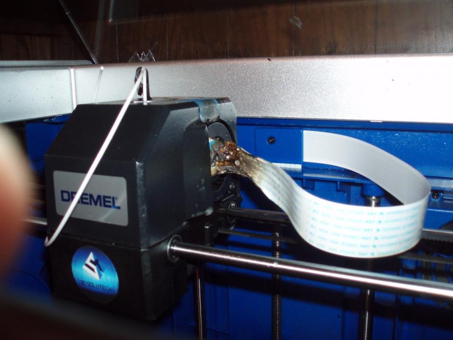

      Not sure what cause it, but the entire extruder, hot head, and the main board are cooked! It also took out the main PCBA touch screen! There was smoke from the extruder area! Just glad I was here to catch it!! This is an 8 year old printer, with thousands of hours on it. I estimated the parts would be approximately $500.00 for those that I know are gone! If it where a newer printer I might spend the money and try to make the repairs!

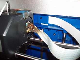

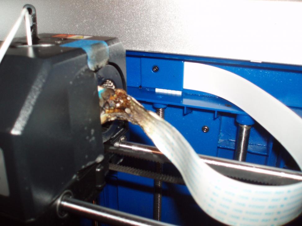

          Not really sure of all the damage! When I first plugged it back in and powered it I got smoke around the extruder, and no light on at the PCAB touch screen! I took it all apart and found the extruder board cooked and the wiring to the auto leveler was burned. When i pulled the touch screen assembly out, there was also signs of high heat.
          I am not going to waste anymore time or big bucks on my old 8 year Dremel 3D40, even the bearings on all the X Y Z rails are worn out! It was a great work horse! But is is time to REPLACE it!!

                  I’d say 9 years of constant use is a good run for that machine. It will be interesting to see what else you discover when you take it apart. Were there any sign that the head got bound up some how? After seeing the ribbon cable roasted, I wonder from the constant flexing of it maybe created a break or short circuit? Any way, I’ll wait to hear your final damage report.

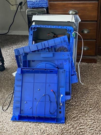

                        Update on my 9 year OLD Dremel 3D40 3D Printer!
Name:	Old Dremel.jpg
                        I stripped out all the motors, and anything else that may be of use! The old cabinet is in the recycle!
                        I did purchase another Dremel after considerable research! It's there new Dremel 3D40 Flex Digilab printer! It is PLA ONLY, and that has always been my preference! It does come with some upgrades in software and the flex plates for easy print removal! I am looking forward to it.
                        "Firemen can stand the heat"

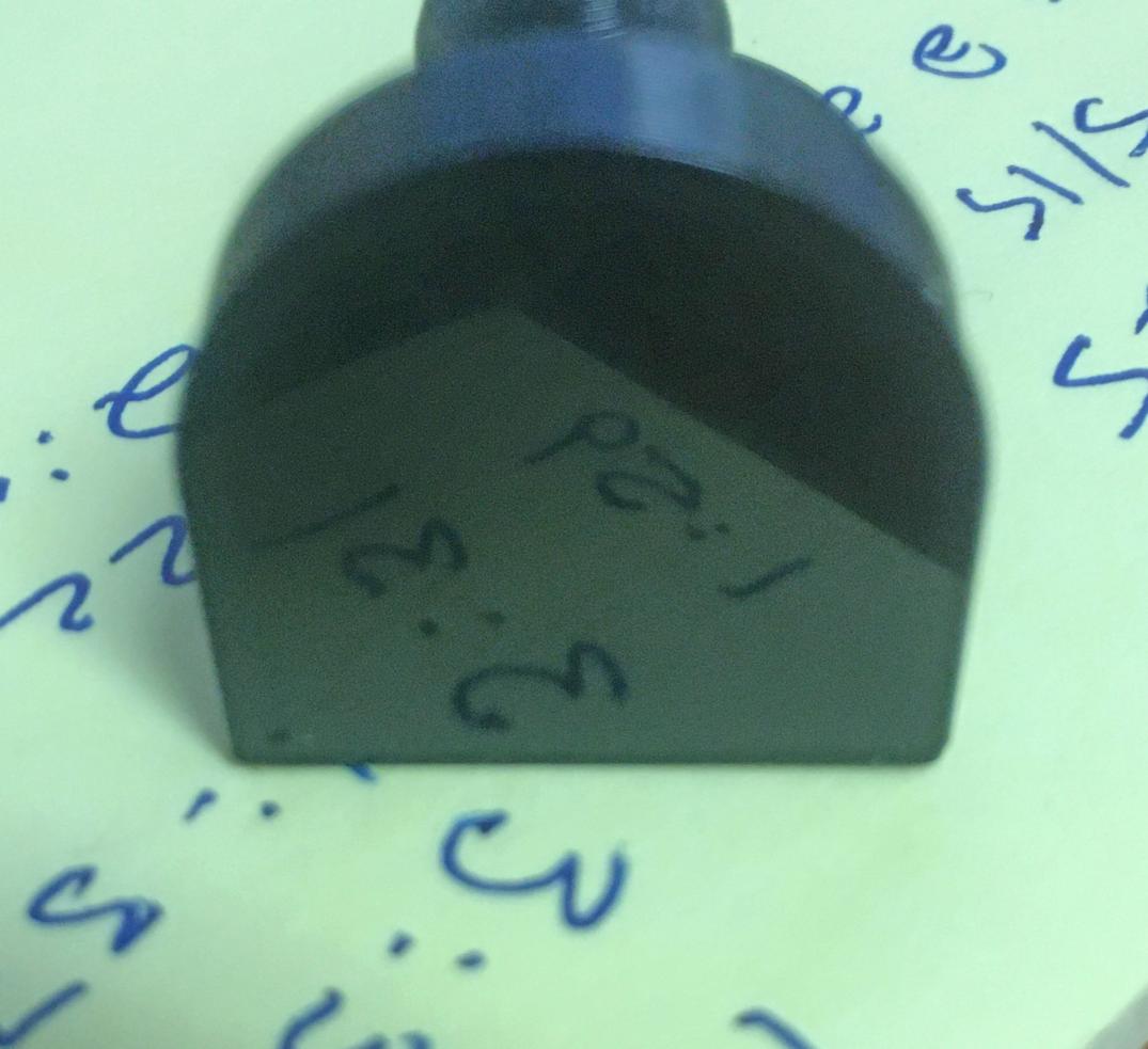

                              Between the magnetic / flexible build plate and the GeckoTek build surface, they work to impart a surface finish that I have yet to see from any FDM 3D printer at any price surpass. Here's an example of the obsidian, mirror-like finish obtainable with the GeckoTek as the base on a 1" part. This combination is used to create press-fit, virtually seam-free printed parts.
