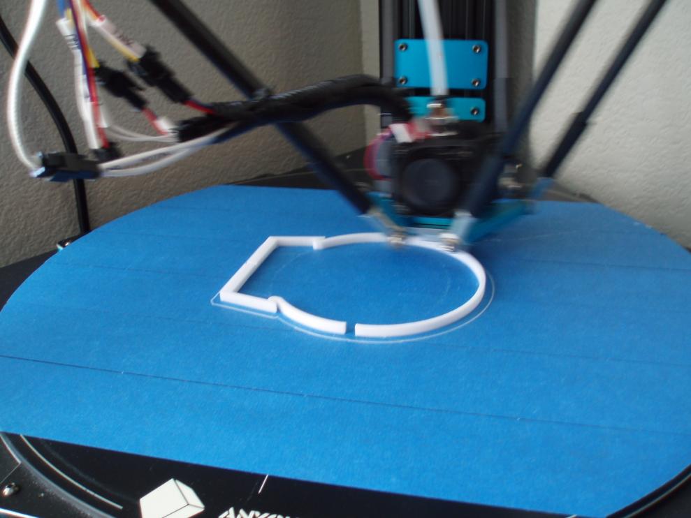

    I have been using 2" wide Scotch original blue #2090 printers tape on my Dremel 3D40 right on top of the glass plate. It works better for than the provided pad that came with the printer. The 3D40 does not have a heated bed. Heat could have an effect on the sticking power of the tape itself.
    Click image for larger version  Name:	P3190002.jpg Views:	24 Size:	61.5 KB ID:	146838Click image for larger version  Name:	P1040002.jpg Views:	23 Size:	65.9 KB ID:	146839
    I also use the same tape on my big Predator printer. Works great for me on both machines. The Predator has a heated bed, and there seems to be no problem with the tape!! A side note: If I need to wipe down the tape, I use a very little denatured alcohol on a clean cloth, wipe it and let it dry before use.

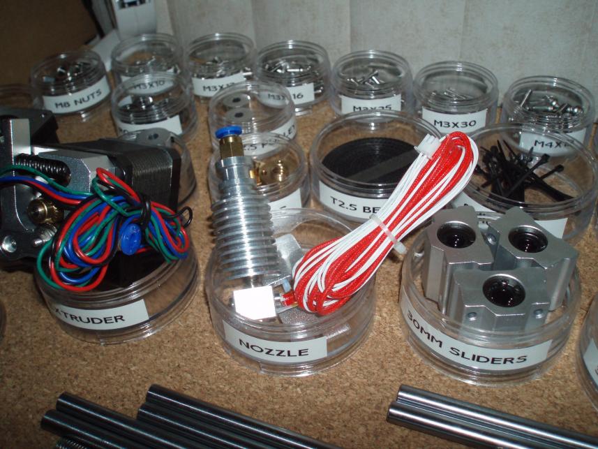

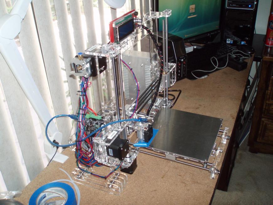

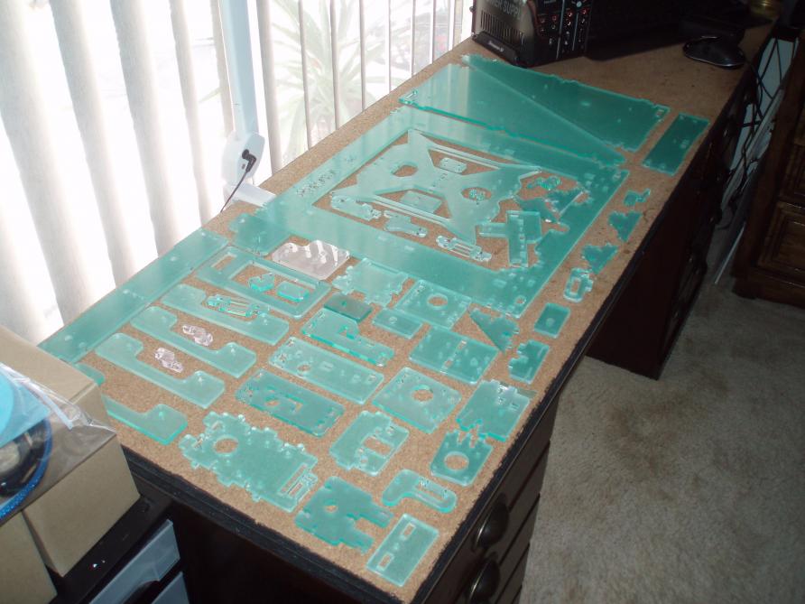

            Mike, its not perfect (and nothing really is) but I have used it on every machine that I have ever build from day one (10 to 12 years)
            I will post up a couple photos of my very first machines!

              This was one of the first 3D Printer kits to come out! Made in China (of course) It was called a Sunhokey! It was one of the starters.
              It took some time to build, and to download the programs required! And SLOW! It took forever. We have come a long ways in 10 years. At the time painters tape was recommended for the build plate, they even sent a sample roll with the kit! It was fun to build, and it really helped in understand how 3D printers worked, because of the clear plastic structure that showed all the working components in action..
