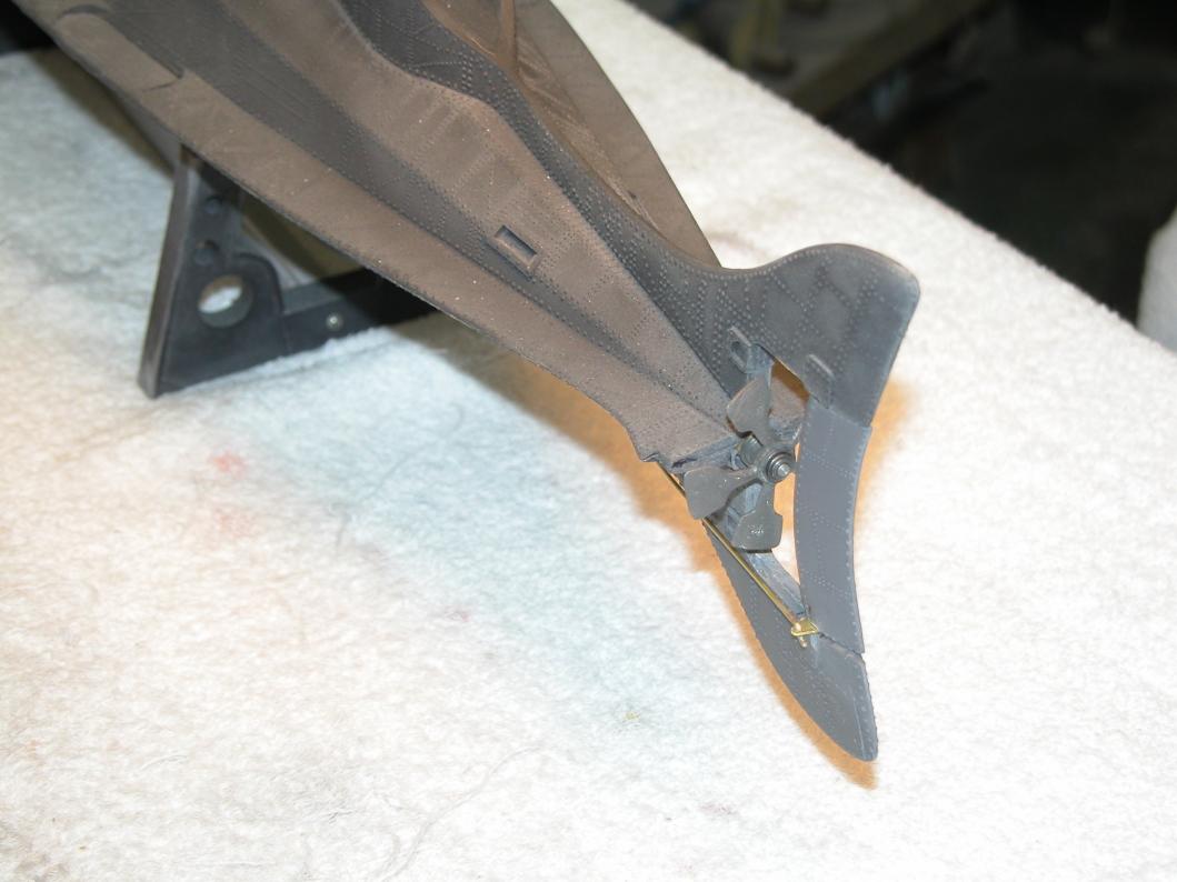

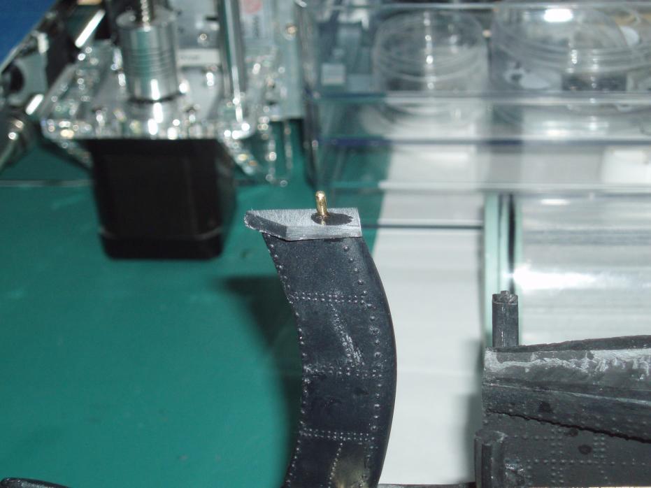

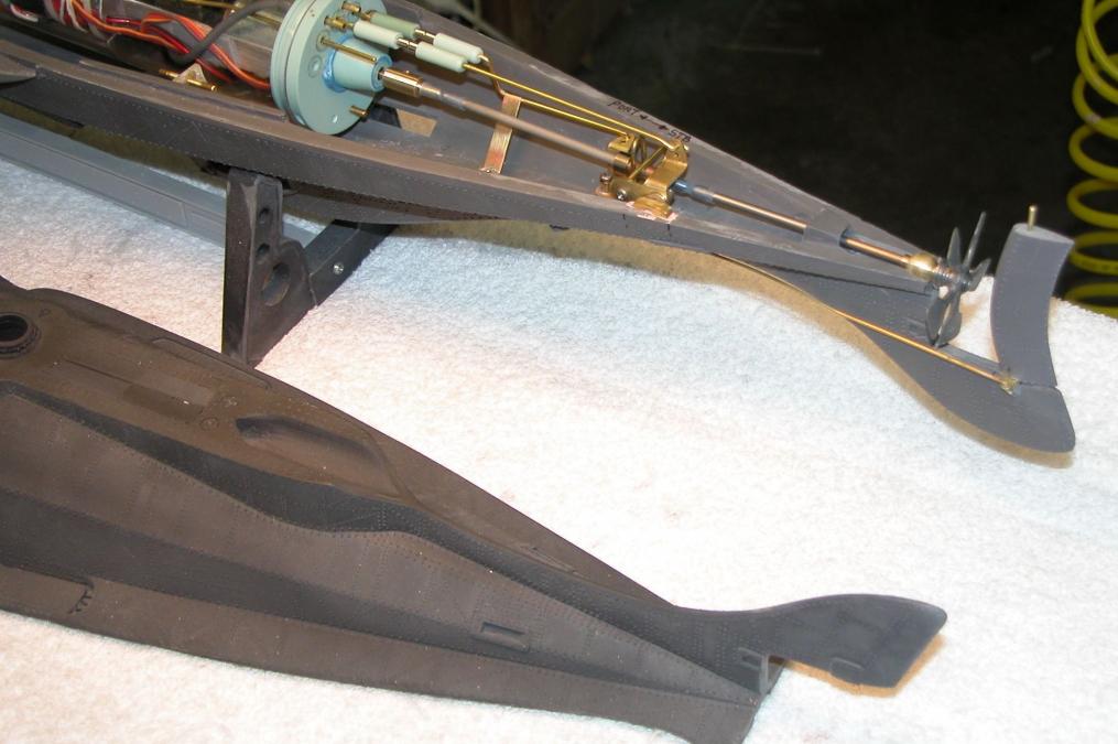

    This is really no big deal, but it was something I ran into on stern with the rudder!
    I had to add an additional 3/16" of material to the rudder top to fill in a gap between the top of the rudder and the fin attachment! I will shape this piece to make it fit properly!

      I had to do the same thing on the two I assembled. No biggie.
        #48
        Hi David!
        I thought it might have been I missed something during assembly! But none the less, that bright piece of brass was just glaring at me every time I looked at it! Like you just had to do something with it!:-)
        "Firemen can stand the heat"

          Pretty sure that issue is an artifact of the casting process and not in the design of the masters. The tails warped away from each other, spreading that gap. If you look at that section carefully from the side, I bet you’ll see the horizontal lines of the rudder opening are not parallel, but rather angled away from each other. You can fix it by heating both and bringing back to the proper position. Would have saved messing around with the rudder extension, though that is equally viable as a solution.

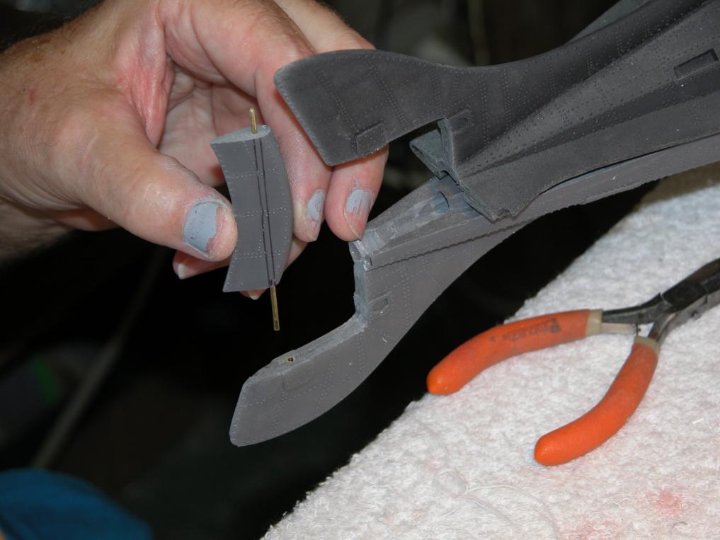

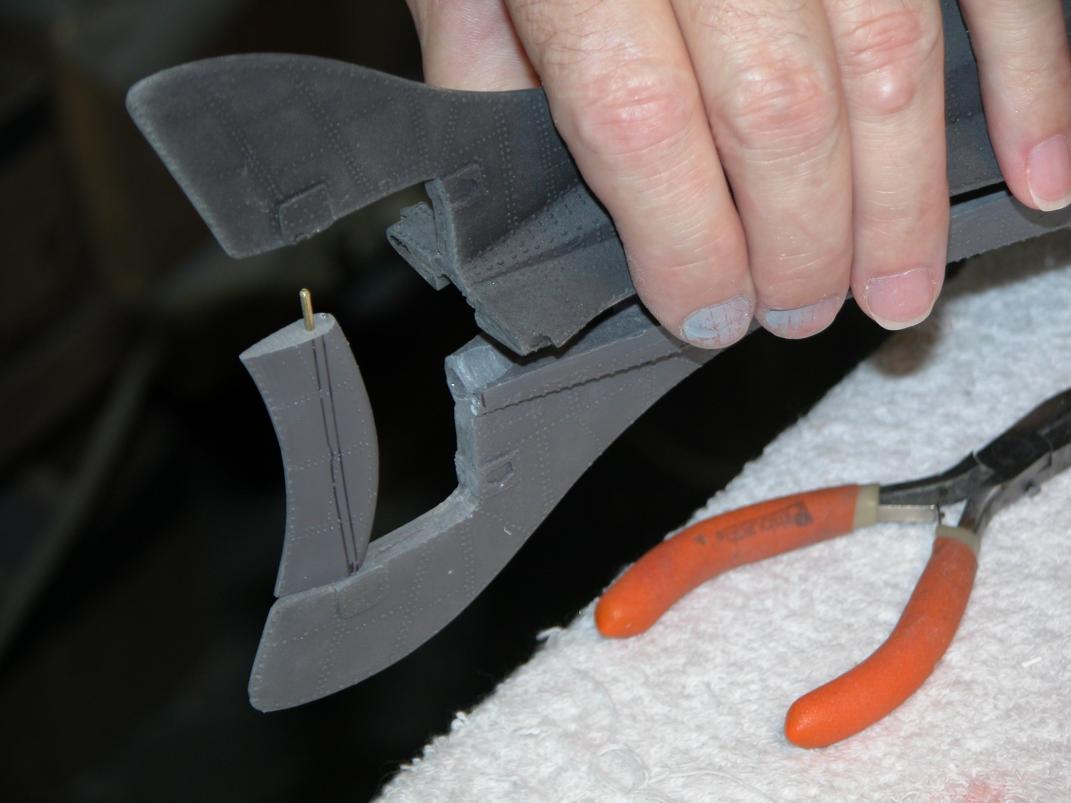

            Trouble is, resin has a memory. You apply heat and stress the structure to the desired shape and hold the pressure till the part cools and it retains the desired shape -- but only as long as the ambient temperature does not rise substantially. However, take it to the lake -- the work sits under the hot summer sun for a few minutes -- and the structure returns to its original (disfigured) shape. The permanent fix is to break/cut off the upper vertical stabilizer (shark-fin), reposition it and bond with a GRP reinforcing at the union.

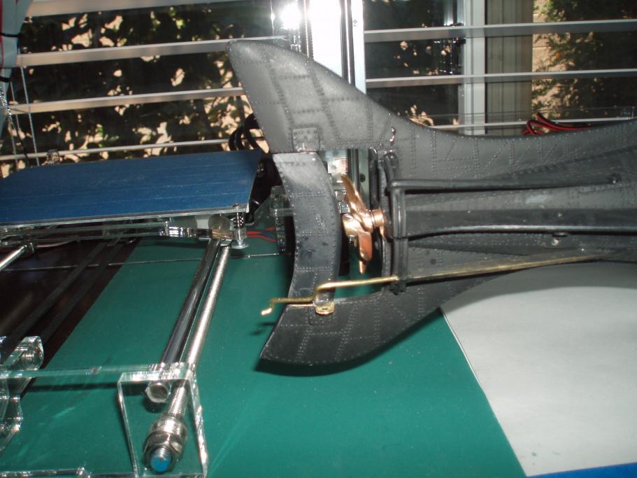

              No problem! Just part of this wonderful hobby! Patience and perseverance!!
              The piece I added to the top took care of the of the gap! Appreciate the input from Bob & David!

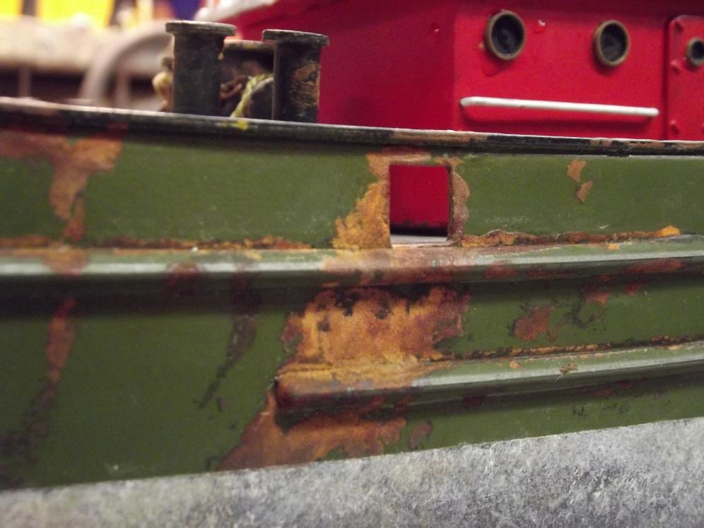

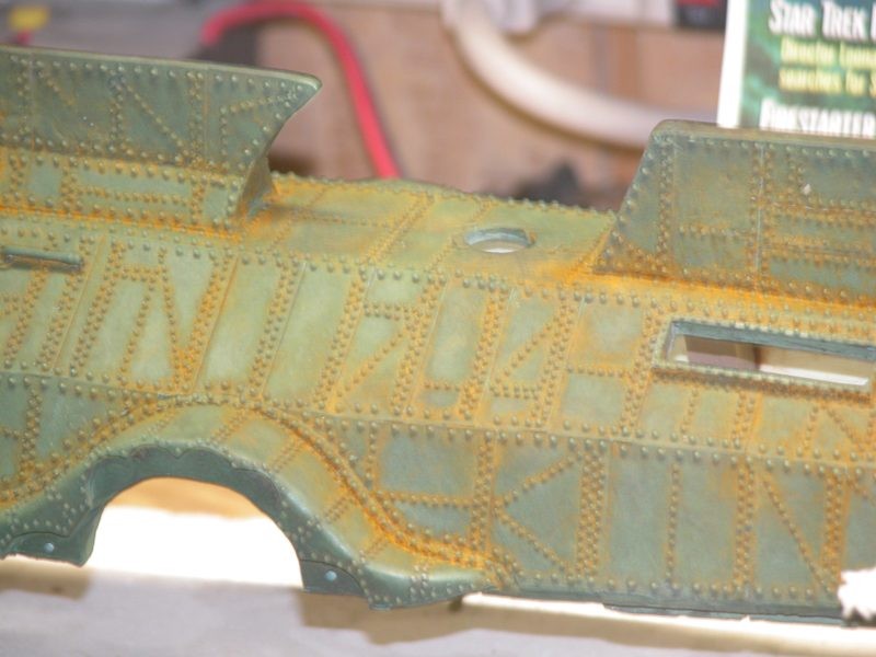

                    #54

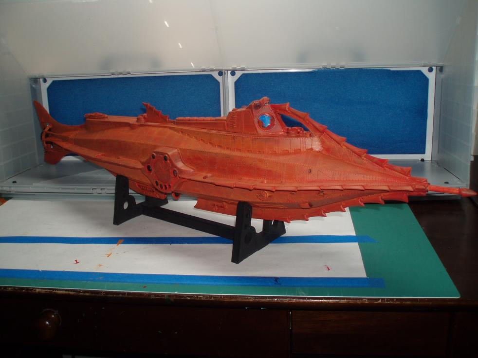

                    Originally posted by rwtdiver
                    I started the exterior finish work on my Nautilus today! At this point I have just about achieved the orange rust color!
                    I am using all Acrylic matte finishes, and applying with a brush. Tomorrow I will apply a wash of a combination dark brown with some added black to tone it down a little. After that some going over the seams and other areas where rust would collect using a smaller detail brush! After the paints cure out I will coat with dead flat clear coats to finish it off! Then it's off to the SD and the electronics!

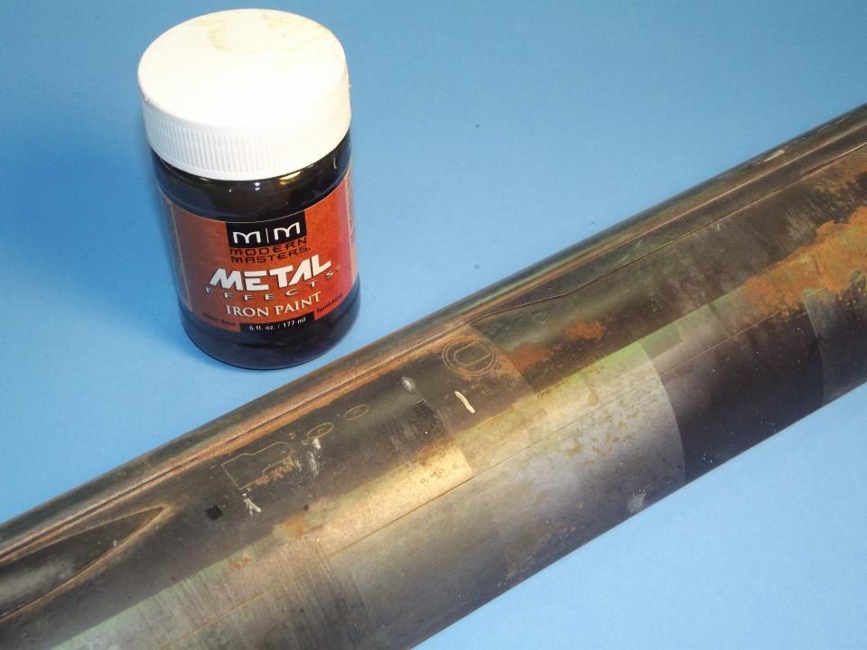

                    Look over the miniatures in the film. How much running rust do you see (discounting the full scale above-waterline set piece)? And rust patches?
                    Less is more when it comes to weathering -- always emulate the look of the prototype. Research is everything.

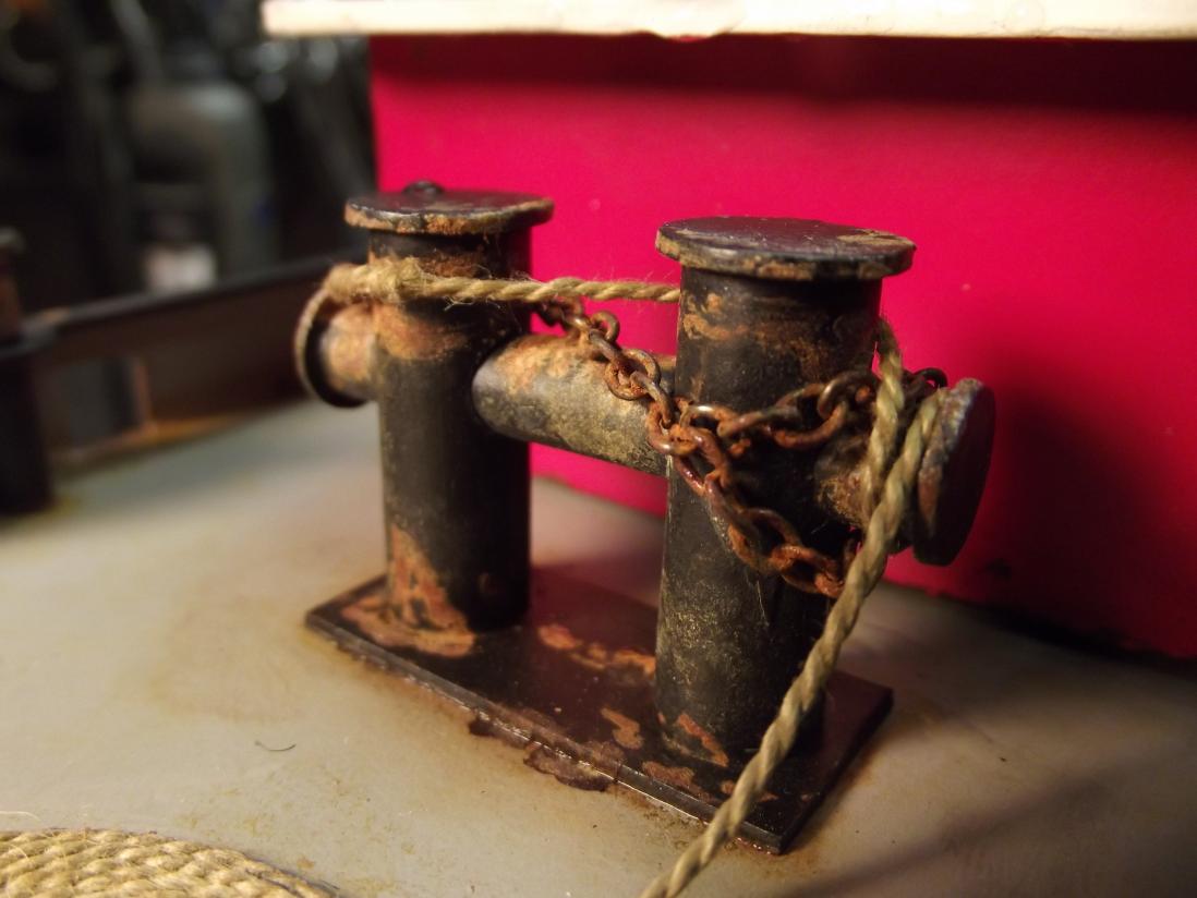

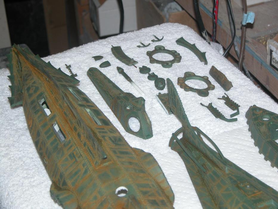

                    Consider 'real' rust, applied as a wash. Such as...

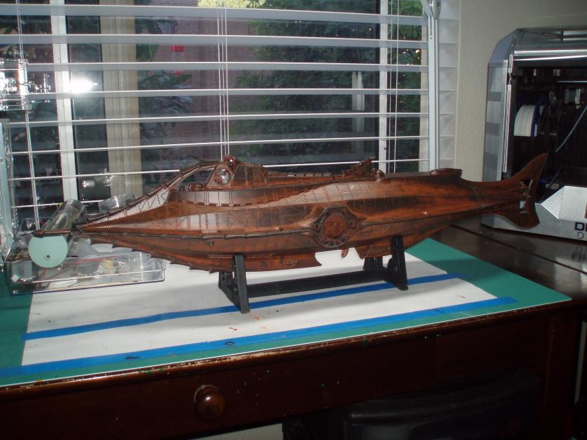

                        #56

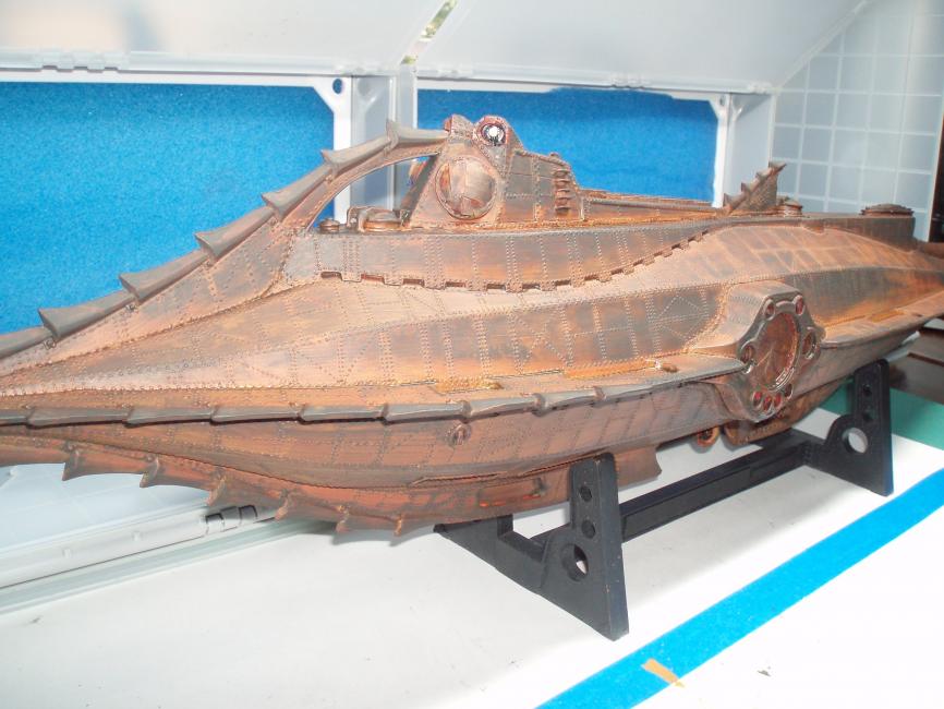

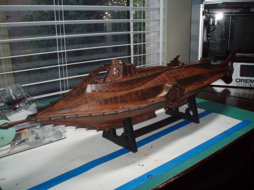

                        The finish process is now complete! Photo below first wash!!
ID:	150472Click image for larger version

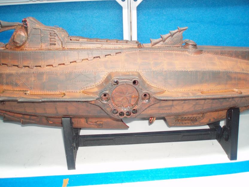

                        The photos below is the finish product, except for clear coat!!
ID:	150474Click image for larger version
                        To achieve the look I was after, I used 4 different water base acrylic colors to get the effect! The next part of the finish will be a matte clear coat! Now we move onto the electronic component wiring in the SD, and finish up the lighting system!

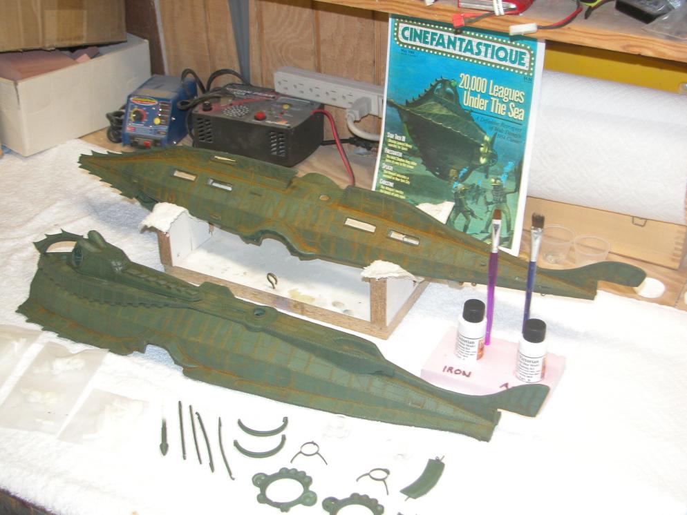

                          #57

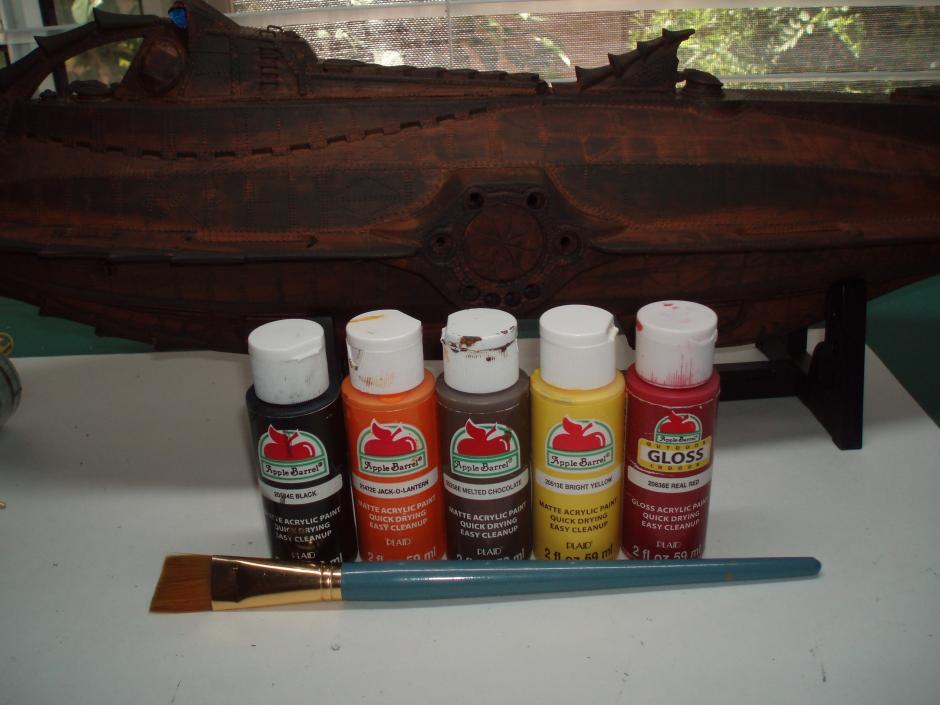

                          In this photo is the acrylic water base colors that I used to achieve the final look that I was after! The colors where applied and then I would spray water and brush the colors out by diluting with water!

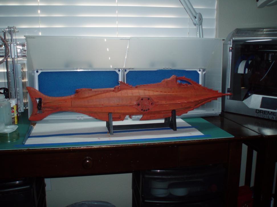

                                #60
                                At this point the final finish is complete! Yesterday I applied 3 light coats of clear coat, and it has now cured for 24 hours!
                                Next step will be to finish up the lighting around the salon area! I am still waiting on the new lens kit that I ordered from Nautilus Drydocks, but when they arrive that will complete the exterior of the boat! The only item I have left to complete is the wiring connections and the SD itself! After that we will be "Water Bound" This will be my very first fully operational (DIVING) submarine that I built!
