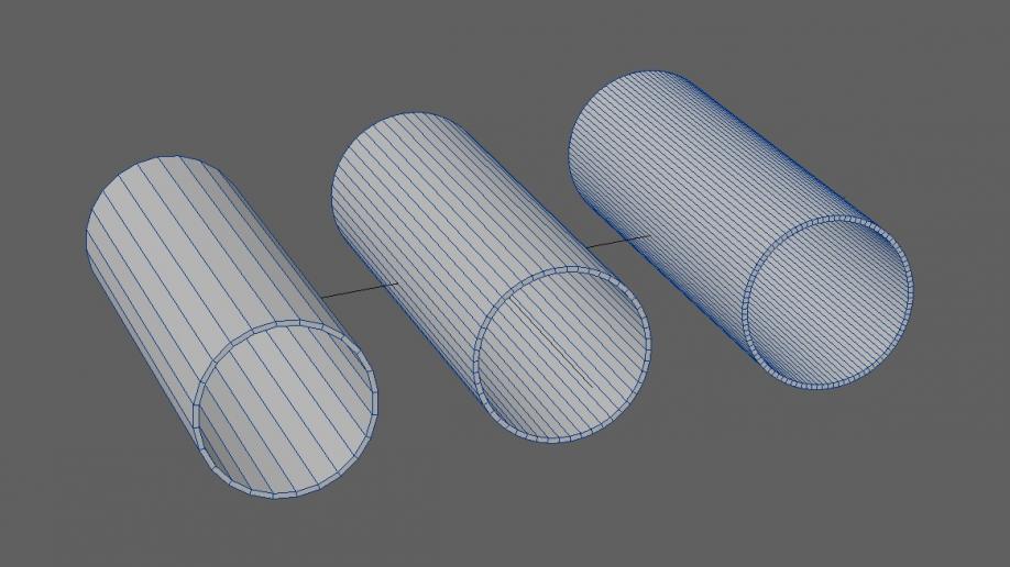

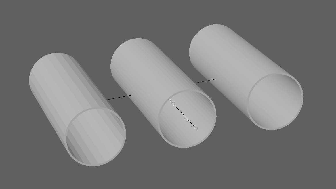

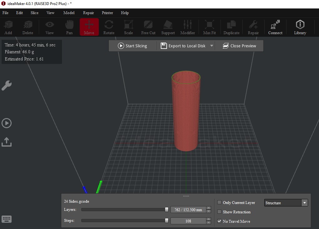

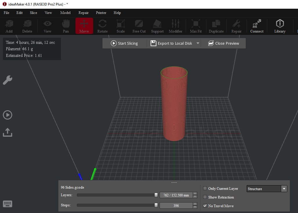

                      For anyone following along that wants to learn about mesh / object resolution related to slicing and ultimately sweet-looking prints that require less effort to prepare for priming, I've attached a few examples.
                      All are tubes, 3mm thick, 100mm in diameter, and 152mm in length. The first tube has 24 sides, the second, 48, and the third 96. Note the amount of faceting (visible sides) in each of the first two pics.

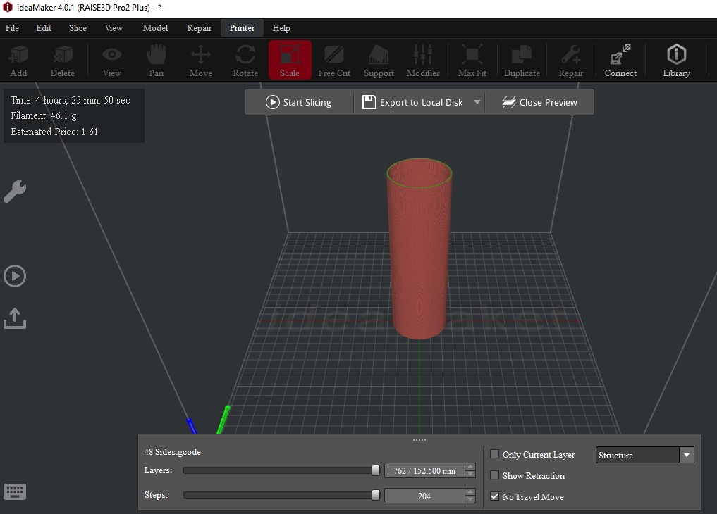

                      The second three pics show the results of each individual tube after it's been sliced for 3D printing. The slicer setting are the same for each (15% infill / .2mm layer height)
                      In this example, I'm using ideaMaker. It's free and available here: ideaMaker All Versions | Download 3D Printer Software | Raise3D
                      The 24-sided tube will take 4 hours 45 minutes to print. The 48-sided tub will take 4:25, and the 96 sided tube will take 4:26. This is an important point. A 3D printer moves in short, straight line segments (a circle can be thought of as a series of interconnected straight lines.) The more sides, the faster the printer can print, so it's a win all around. Adding more sides can actually improve your print time (in this case) and produce a nicer-looking part with less prep required for priming. The trick is to find the sweet spot that yields the smoothest prints in the least amount of time.
                      The important takeaway here is: Modeling affects print time and quality of the print. A slicer takes the model code (stl is but one) and converts it to gcode (CNC-style machine commands.) A slicer cannot alter the geometry, it just "slices" it into layers to be printed on top of each other.
                      For fun, (you don't need a 3D printer to experiment) download ideaMaker and then head over to Thingverse and download this: RC submarine Mystic class DSRV by Ewolve - Thingiverse
                      Carl has done an excellent job of setting this up for printing. (Only the propeller needs Supports added.)
                      With iM open, go to File/Load/Import Model and load one of the files. Once it's loaded, go to Slice/Start Slice and choose the Standard template setting. Once the model is sliced, slide the Layers handle in the Previewer on the bottom to see how the printer will create the model.
                      Experiment and have fun!
                      CC
