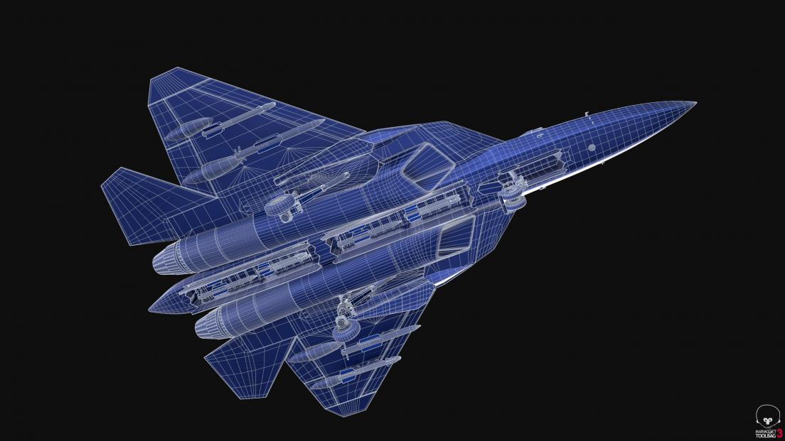

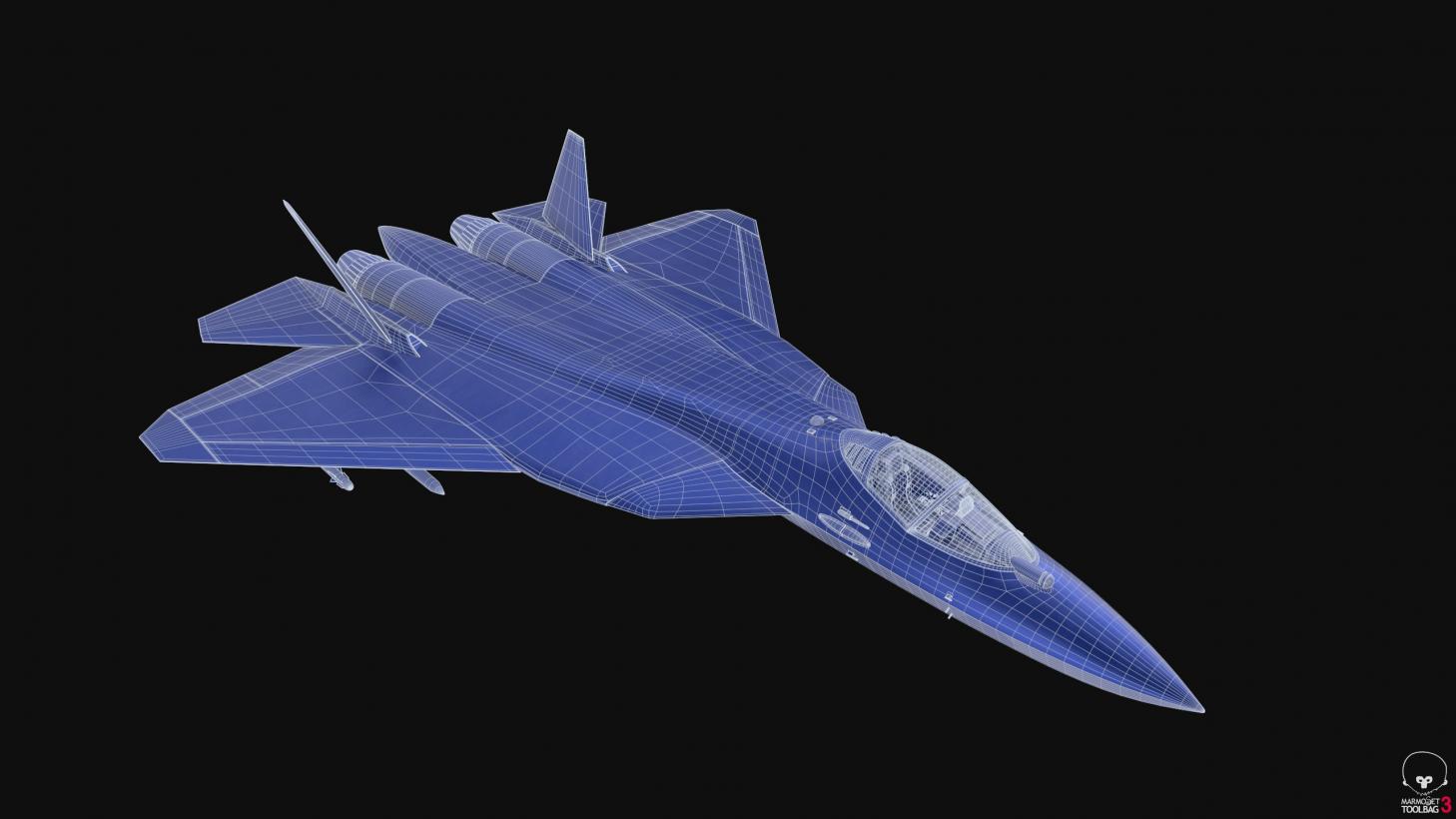

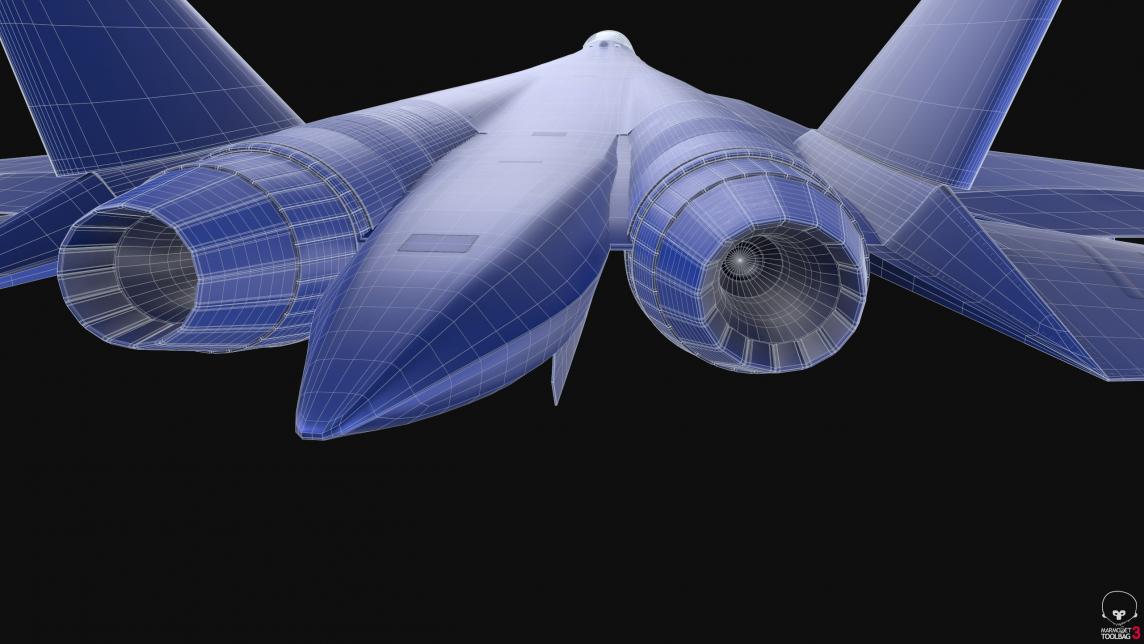

                  During this holiday where I'm stuck inside, I'm working on a submarine at the moment and have multiple versions, borrowing parts from a master to save time as I modify each version. One is for a static display model and the others will be optimized for 3D printing.
                  For software. I use Lightwave3D. It was the first commercial software for "regular" folks, introduced 25 years ago on the Amiga. It has been used on numerous award-winning movies and TV shows since it is also an animation program. I have access to plenty of high-end CAD software like SolidWorks and ProE, but can create faster with just as much accuracy using Lightwave. Plus, I can texture, light and animate with a degree of realism that CAD programs can't touch.

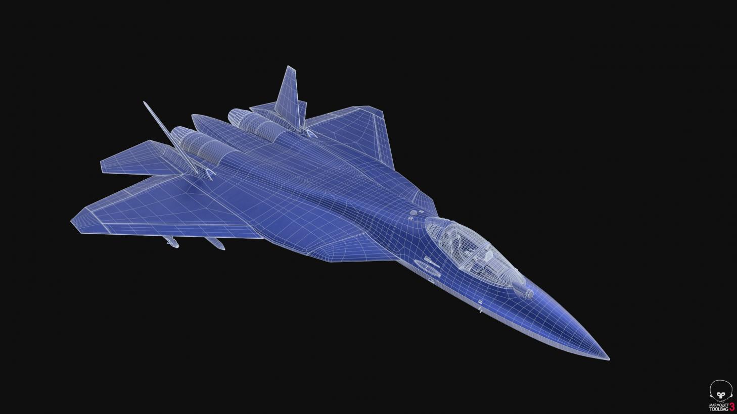

                  I've attached a couple of wire renders from an artist who is much better than I when it comes to sub-D modeling (where the mesh is manipulated like a piece of clay to get smooth, rounded faces with a minimal number of polys.) Notice how the polys (all quads) flow in uniform directions, which blend and contribute to the overall organic shape. STLs use triangles (3-sided polys) which are nothing more than sub-divided quads (four-sided polys.) I model in quads and then turn the mesh into triangles before outputting as an STL for 3D printing.
                  If you have any modeling questions, chime in, and I'll offer suggestions if possible.
                  Click image for larger version  Name:	SU-57 Tail.jpg Views:	0 Size:	68.2 KB ID:	146188

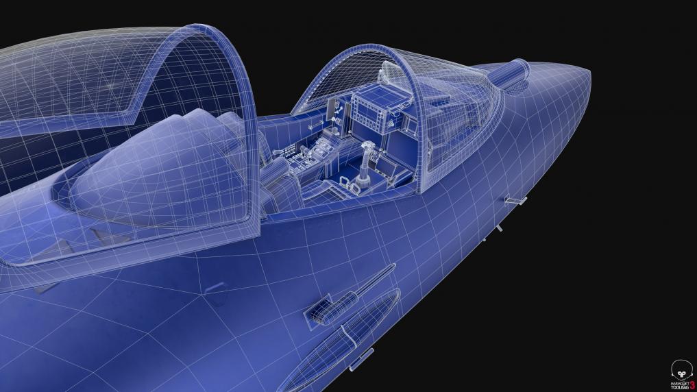

                      Click image for larger version  Name:	SU-57 Cockpit.jpg Views:	0 Size:	70.1 KB ID:	146202

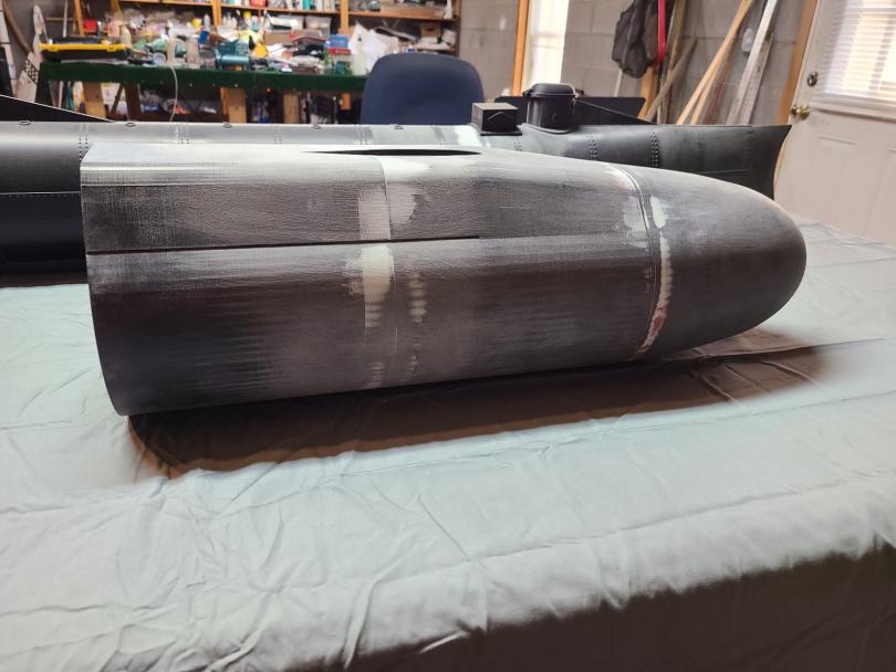

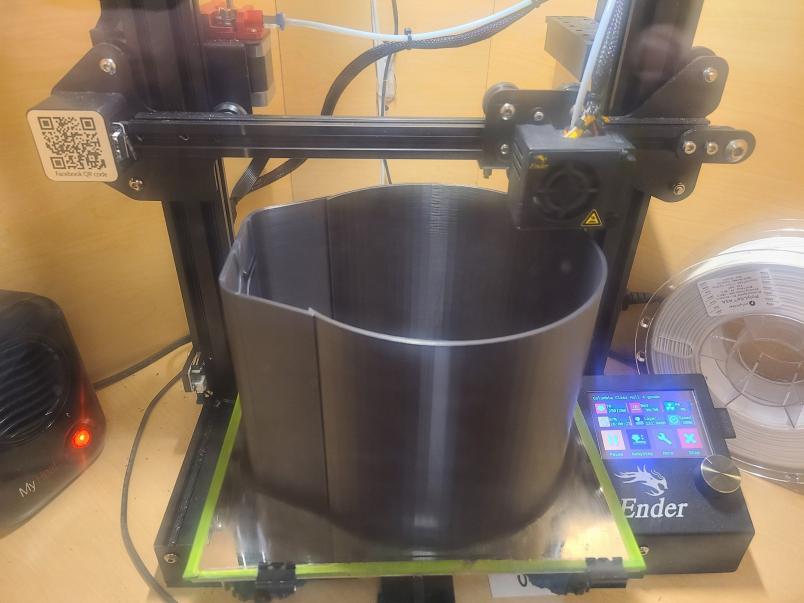

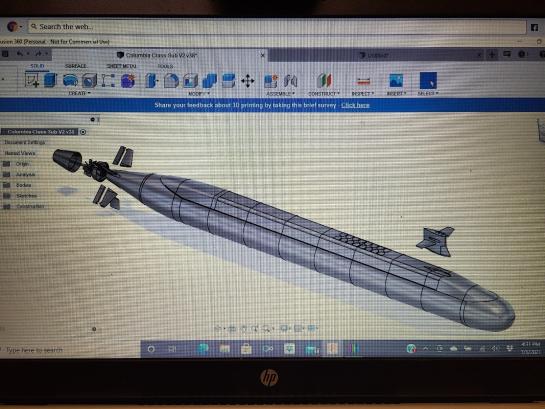

                          My first full on Fusion 360 project. Took me about 5 days and 2 versions but is now printing very nicely on my Ender 3 Pro using ASA filament. It's my take on a 1/72nd scale Columbia class. Will be 93" long with just over a 7" beam. I sat down and forced myself to learn what I did. At times it was very frustrating but I kept going. Also had some help along the way. I use Simplify 3D for my slicing software. My printer has been bullet proof aside from an issue where the wire inside the insulation of the power cable to the bed heater fatigued and broke. Took me two weeks to figure that one out but it is back up and running full bore. I just bought an Ender 5 Plus and will be bringing it online soon. Much bigger build volume so I could easily do a 1/48th Ohio now if I want but it will first be printing a large Seehund for a buddy of mine.
                          Click image for larger version  Name:	20210106_163144_copy_1612x1209.jpg Views:	0 Size:	42.0 KB ID:	146446
                          Click image for larger version  Name:	20210106_163207_copy_1612x1209.jpg Views:	0 Size:	51.9 KB ID:	146447
                          Click image for larger version  Name:	20210106_163248_copy_1612x1209.jpg Views:	0 Size:	55.5 KB ID:	146448

                            Your Ender 3 Pro looks like it really does some great printing. Another big Columbia class boat! I spent $150.00 about 8 years ago on Simplify 3D slicing software, that was the best $150.00 I have ever spent!
                            Great software.

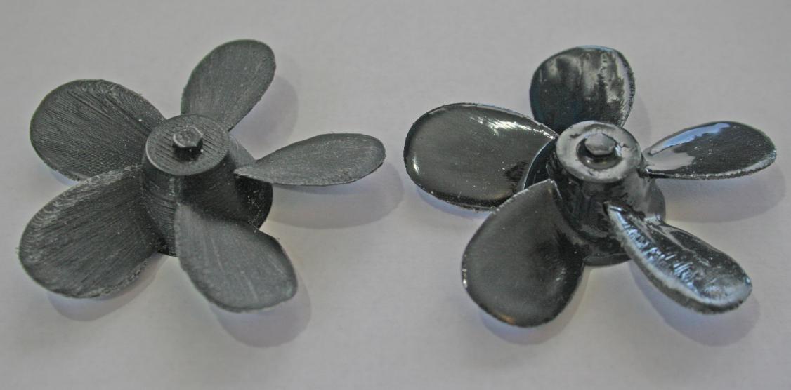

                                The Ender 5 is a nice machine, and your current Columbia print looks like a lot of fun. My only suggestion for improvement would be to increase the side count on the hull to minimize the faceting. It looks like you've got around 48 sides @ 3-4 mm thickness; I like to use 120 sides which drastically reduces the amount of post-sanding required. The size of this model would need a lot of laborious sanding!
                                I finally used some XTC-3D epoxy coating last week and highly recommend it. A couple of very thin coats will completely fill in FDM layer lines, (but isn't going to fix broad, visible faceting.) After that, very light sanding preps the surface for primer.
                                I've attached a freshly-printed and coated screw for comparison:

                                I look forward to seeing your finished result!
