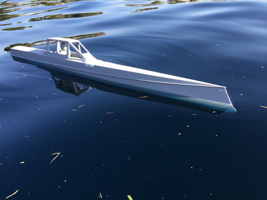

    I have been using Duramic PLA plus from Amazon. I have a raw part in direct sunlight and one immersed in water. 5 months later, I see no water ingress or warping or cracking. Been testing this drug smuggling boat for some time in raw PLA with no issues either. All Duramic….
