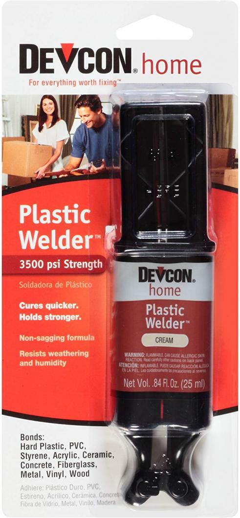

                • Racer
                  • Jun 2010
                  • 3
                  I have used CA which works well.
                  But for the ultimate in strength, I use this.
                  You need a jack hammer to take something apart if you use this stuff.
                    Reading the label I saw "Resists weathering and humidity" which in our environment it needs the definitive waterproof. However, I went to the site and here are more specs:
                    • Bonds: Hard Plastic, Styrene, PVC, Acrylic, Ceramic, Concrete, Fiberglass, Metal, Vinyl, Wood
                    • Tensile Strength: 3500 psi
                    • Color: Cream
                    • Waterproof
                    • Handling Time: 4-5 Minutes
                    • Set Time: 10-15 Minutes
                    • Cure Time: 24 Hours
                    • Temperature Range: -40°F to 200°F
                    http://www.itwconsumer.com/devcon-pr...C%2025%20ml-23
                    Very cool tip! Thank you.
