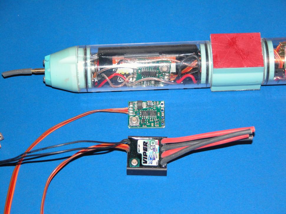

    replied
    Aft is the battery, Lipo-Guard and nano ESC. Forward is the ADF and receiver.

  • secrtwpn
    replied
    Thx for the pix. They help alot. Also, which electronics do you put in the fore and aft WTC?.
    THx
    Farlan
