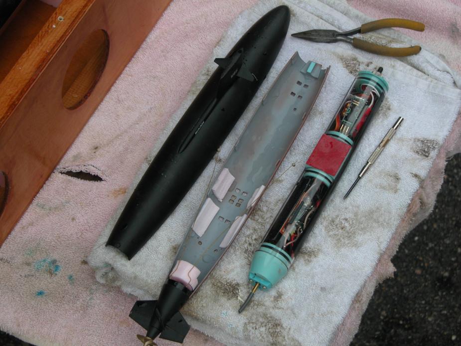

Three specific chores are addressed here: removal of the bow piece from the lower hull and bonding it to the upper hull half; filling up the gap between the two hull halves when joined; and re-contouring the bow employing the screeding technique.
First, I identified the gape between upper and lower hull by loosely holding them together, I then placed masking tape on both halve so that the edge of each (one on the upper half, and the other on the lower half of the hull) would meet. The hull halves were taken apart and thick formula CA applied to the area inboard (sticky side) of the tape and atop the hull flange/edge. I then sprinkled on baking soda to build up and harden the fill. This repeated till top and bottom hull halve had their edges built up, eliminating the gap when the hull halves are assembled together.
Once the longitudinal hull gap was tightened, I chopped off the forward bow from the lower hull and bonded that piece to the upper hull. The forward edge of the internal foreword SubDriver back-stop formed the radial flange that captures the upper hull, holding it down on the lower hull when the two halves are assembled.
I then employed the fittings kit provided screeding tool to re-contoured the bow of the model to more closely match that of the prototype -- the kits bow being much too blunt. Evercoats Metal Glaze filler was the build-up material of choice here. About five layers of filler and I had a new nose on the submarine, changing the entire character of the display!

I said:
- I've had a few minor problems with the tail end. The prop tube was slipping, so I dabbed a bit of CA on it and let it dry. That thickened the shaft and solved the problem.
You put the CA on both the forward end of the propeller shaft and the SD motor shaft, Mike?
I said:
- The Sub-driver is a bit tight in the saddles and needs a little sanding to loosen it up a bit.
It's supposed to be tight between the two back-stops. Or are you talking about the foam in the upper and lower hull halves?
I said:
- I also placed a drop of oil on the prop shaft and that stopped it binding.
Good.
- I said:I'd pushed the foam in the cone back a little too far and it was also tight on the shaft, slowing it up.
What did you do to fix the binding?
- I said:Having trouble getting a good turn on the rudder. Its as if the servo isn't operating at full throw. I don't know how to fix that.
As delivered I mounted the rudder servo magnet (you can't see it under the red, opaque, G-10 lid) very, very close to the servos center of rotation which severely restricts rudder throw. The fix is to make up another servo bell-crank with the magnet a bit further out -- center of magnet, about 1/4" from servo center of rotation -- giving you more moment arm, which translates to more rudder throw.
The fix is to pop the G-10 lid off the servo box, replace the servo bell crank, and using silicon RTV glue stick the lid back in place. The servo will produce a much tighter turning radius. I gave it to you this way so you would not over-control the damned thing, Mike, and slam it into a wall ... I've seen how you drive (even Big Dave is a better sub driver than you).
I said:
- Those damned magnets keep coming off the push rods. You (David) glued them on with CA & Baking Soda, but I think CA has no flex and gives a very brittle joint, especially to a smooth surface like those magnets have.
Good observations, and you're right. We need to come up with a better means of securing the little magnets to the pushrods. Also ... I did it this way just to **** you off!
- I said:I am going to try a dab of contact adhesive as this has some elasticity.
How about epoxy glue? Yeah, we have to come up with a producton-friendly fix for this. Maybe a cast resin/metal magnet holder?
I said:
- On my Xcraft, I glued on magnets to a push-rod then placed some heat shrink tube over the ros & magnet and shrank it. That worked. I don't know if I can do that here.
No, we need the flat face of the magnet up close against the top of the servo box G-10 lid.
I said:
- Other than that, she's a winner!
Very good, How's the run time; how long can you run it till Kevin's delightful little LiPo Guard kicks in and shuts down the show?
I trust that at the end of the day you put the SD to bed opened up so it can dry out overnight. How long does it take you battery charger to bang up that 800 mAh battery, anyway?
Any water getting into the SD, Mike?
I said: No.
Good man! Keep up the good work and keep those *****es and complaints coming in. Useful stuff!
