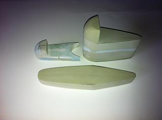

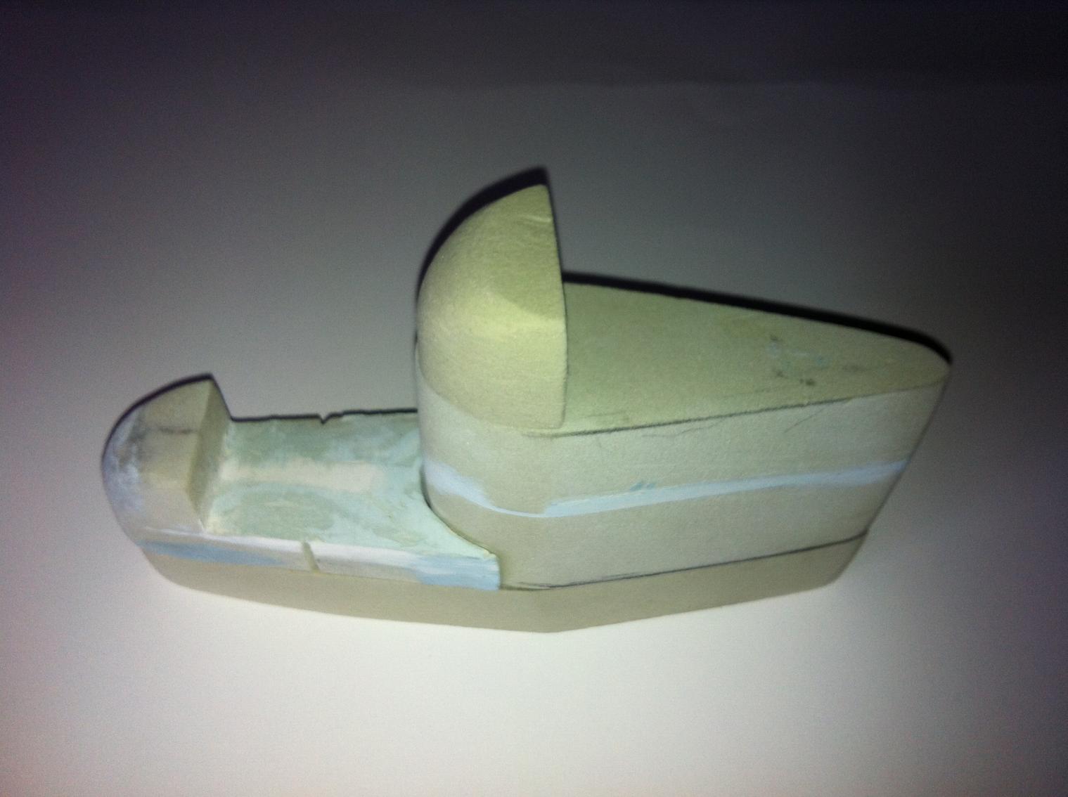

                  Here are the plugs for the conning tower, made from Renshape
                  Note the dome piece on top, this is so the tower can be altered to the Cab Style with the three little portholes.

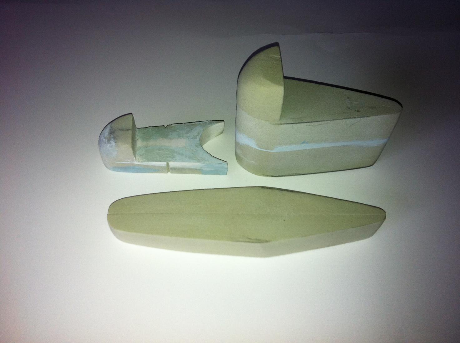

                  Next job is to prime them with sealer and a good coat of wax.

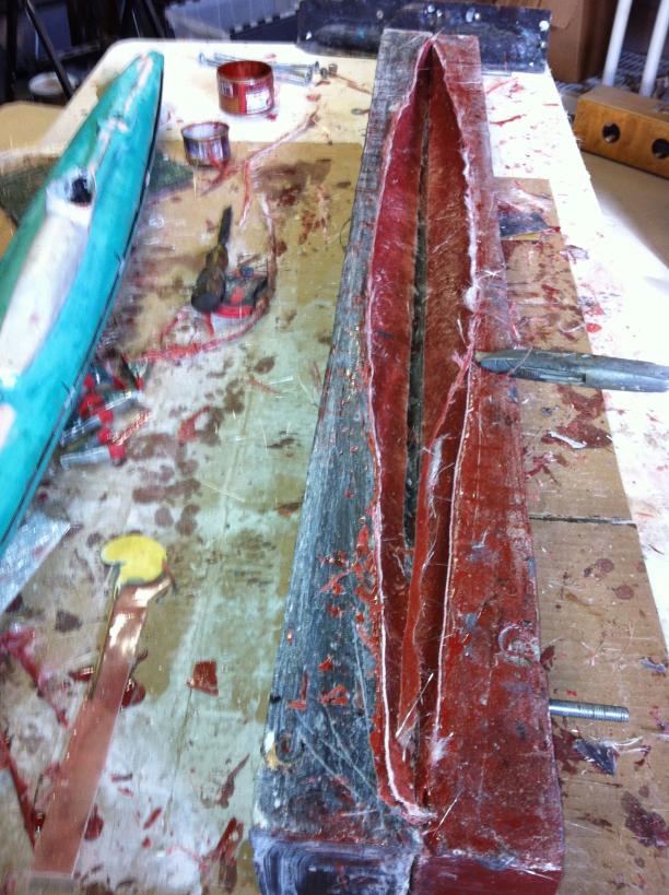

                        I have now bolted the two halves of the mold together after laying up the chopped strand on each side. I found this to be much easier to to than trying to get cloth to conform to compound angles. Using the side of the concrete mold, I ran a knife along the edge to trim up the excess. A nice waterline cut!

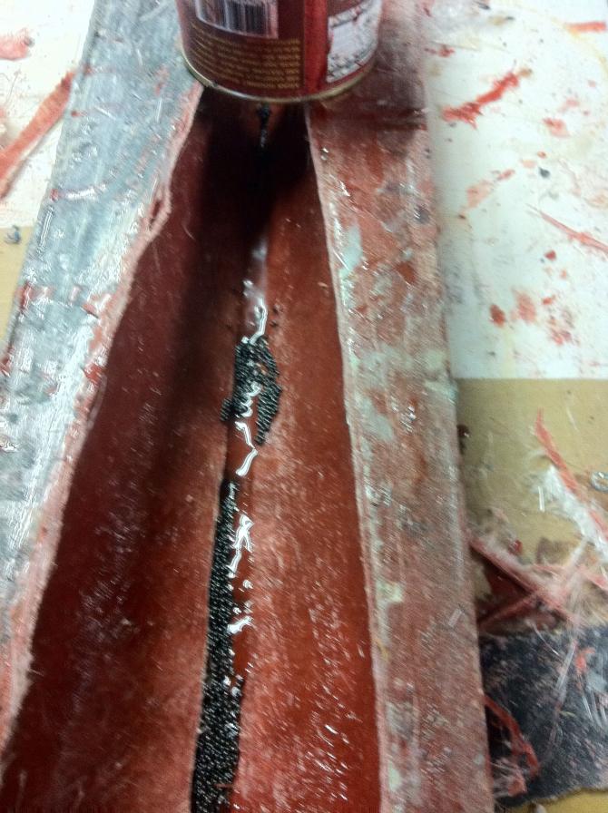

                        Next, I laid a thin piece of wire all along the keel and extended it into the body of the boat. I doubt this keel will ever come adrift now. I mixed up more resin and poured it into the keel area, then poured lead shot into it. Some stuck to the side of the keel and I swilled it all down using a paint brush dipped in lacquer thinner.

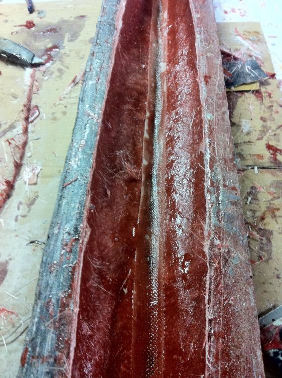

                        Finally, I laid a strip of fiberglass ribbon over the keel area to glue both sides together. I wetted it out with lacquer thinner to get resin from the keel to flow into the ribbon.

                          What does the wire in the keel do? Is it for wear purpose.
                          How about a piece of weed trimmer line for this purpose.
                          It might not corrode like wire and is very tuff.

                            I used titanium wire. It's a reinforcing bar, as found in concrete. I usually use a bit of scrap brass push-rod, or whatever is lying around. It won't corrode, being encapsulated in epoxy.
                            I've found the best way to get the fibers to lay flat is to dip an acid paint brush in lacquer thinner, and wet out the chopped strand slightly. It helps the epoxy underneath soak into the chopped strand. I found this a very easy process - at last. The matt also conformed easier to sharp angles.
