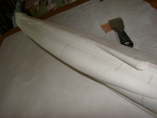

      The plug takes shape. Final sanding and shaping comes next.

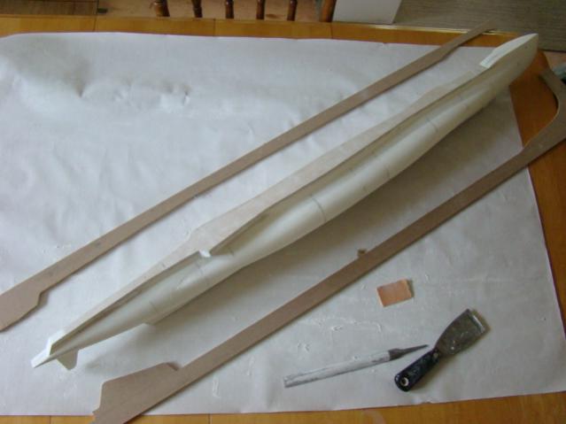

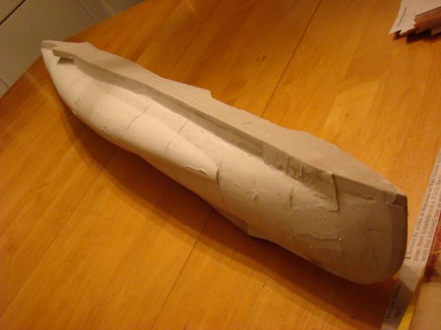

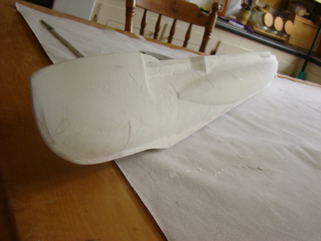

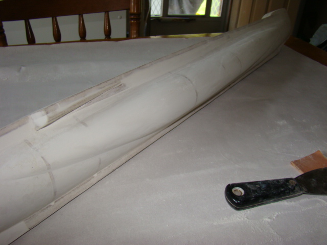

                        The Plug progresses.

                        We're one step closer. Next, to make the molds.
