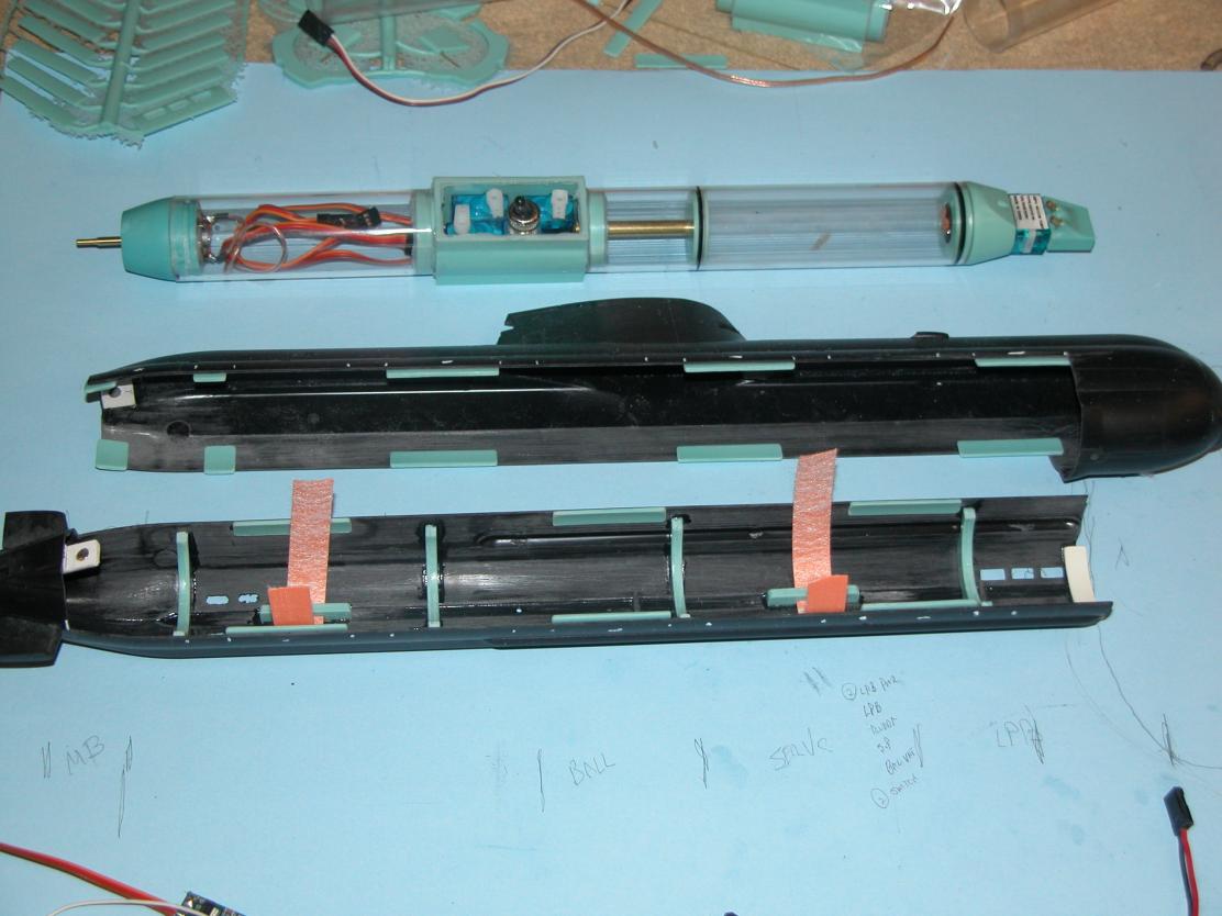

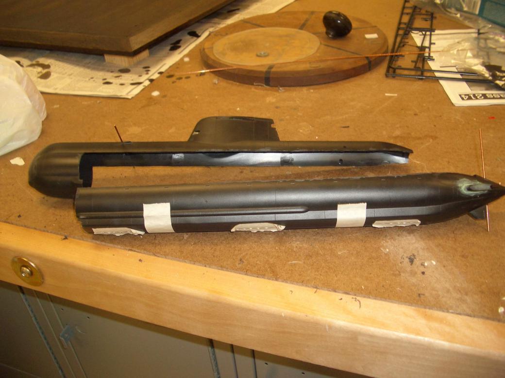

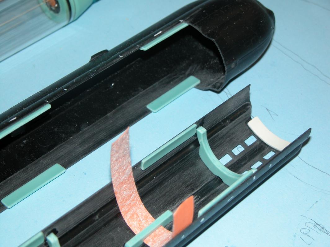

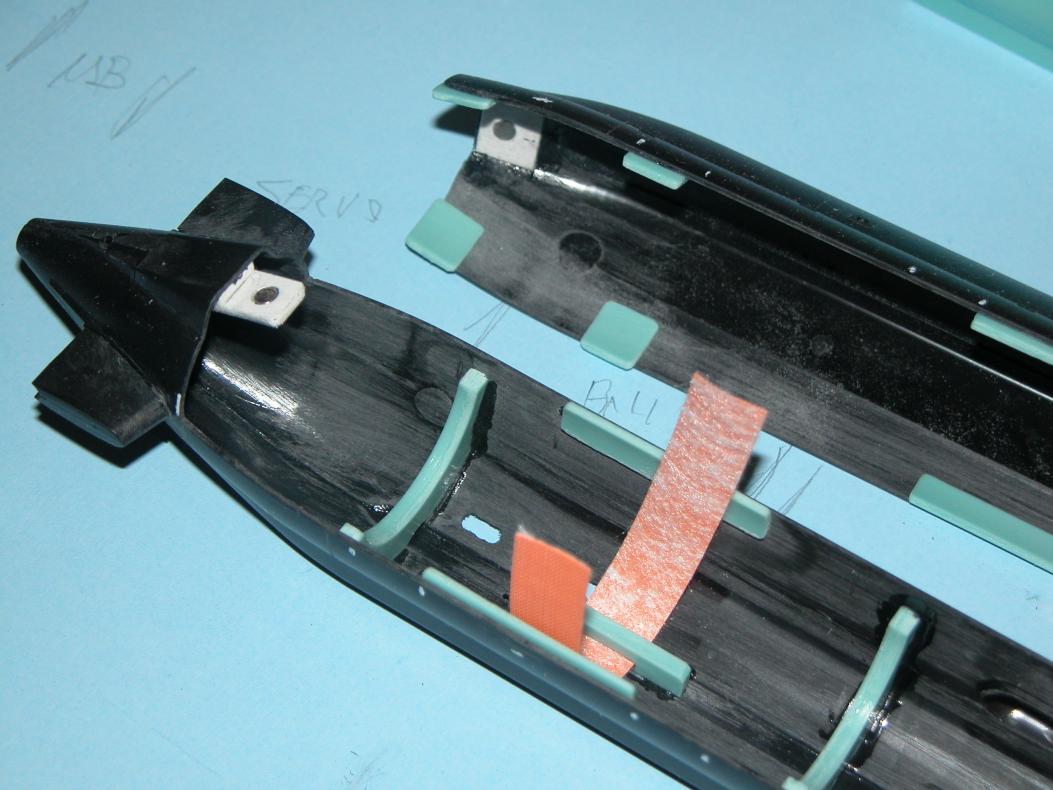

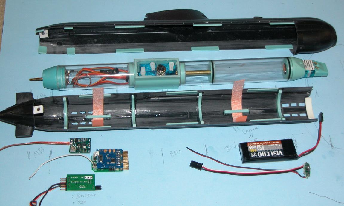

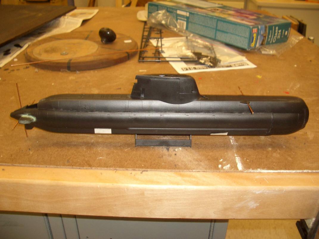

    I'm building a 1:144 Revell U-214. I'd like to make it into an RC sub. I've already sorted out the hull separation and made the cuts.
    The two photos show the hull after it was cut at what looks to be the waterline.
    The copper rod shows where the control axes should go. Controls will probably work a lot like those on the 1:144 Trumpeter Kilo. The way I separated the hull, there ought to be plenty of room for the forward dive plane linkages.

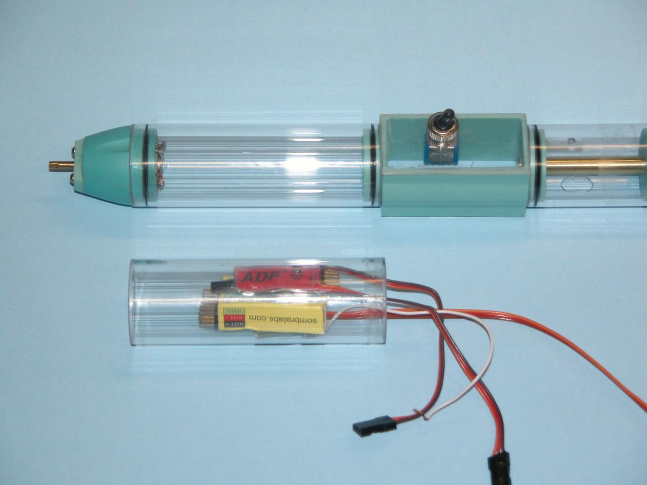

    Looks like there's plenty of room for the small SubDriver to fit in here, even with a ballast system.

    Just received two of the 1/144 Revell Type-214 kits. I'm going to convert those things to r/c. The usual treatment: A fittings kit to augment the Revell kit, and a dedicated 1.25" SD for the thing WITH a ballast sub-system!
    Stay tuned, sports fans.

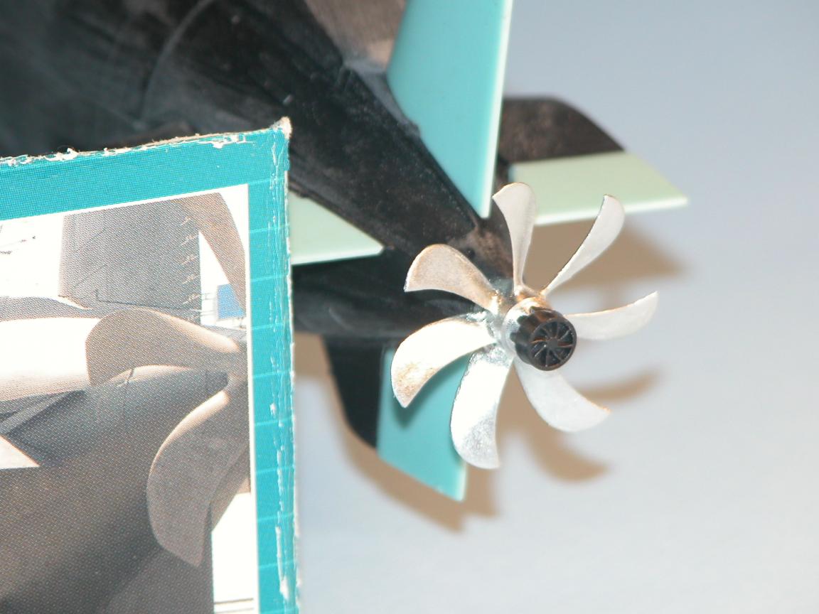

                            All this reminds me to finish a long overdue build-up of a 1/114 Type 214
