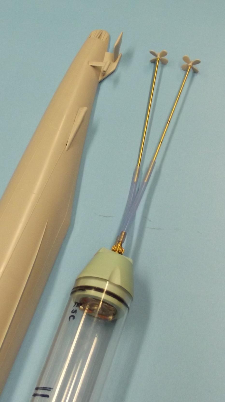

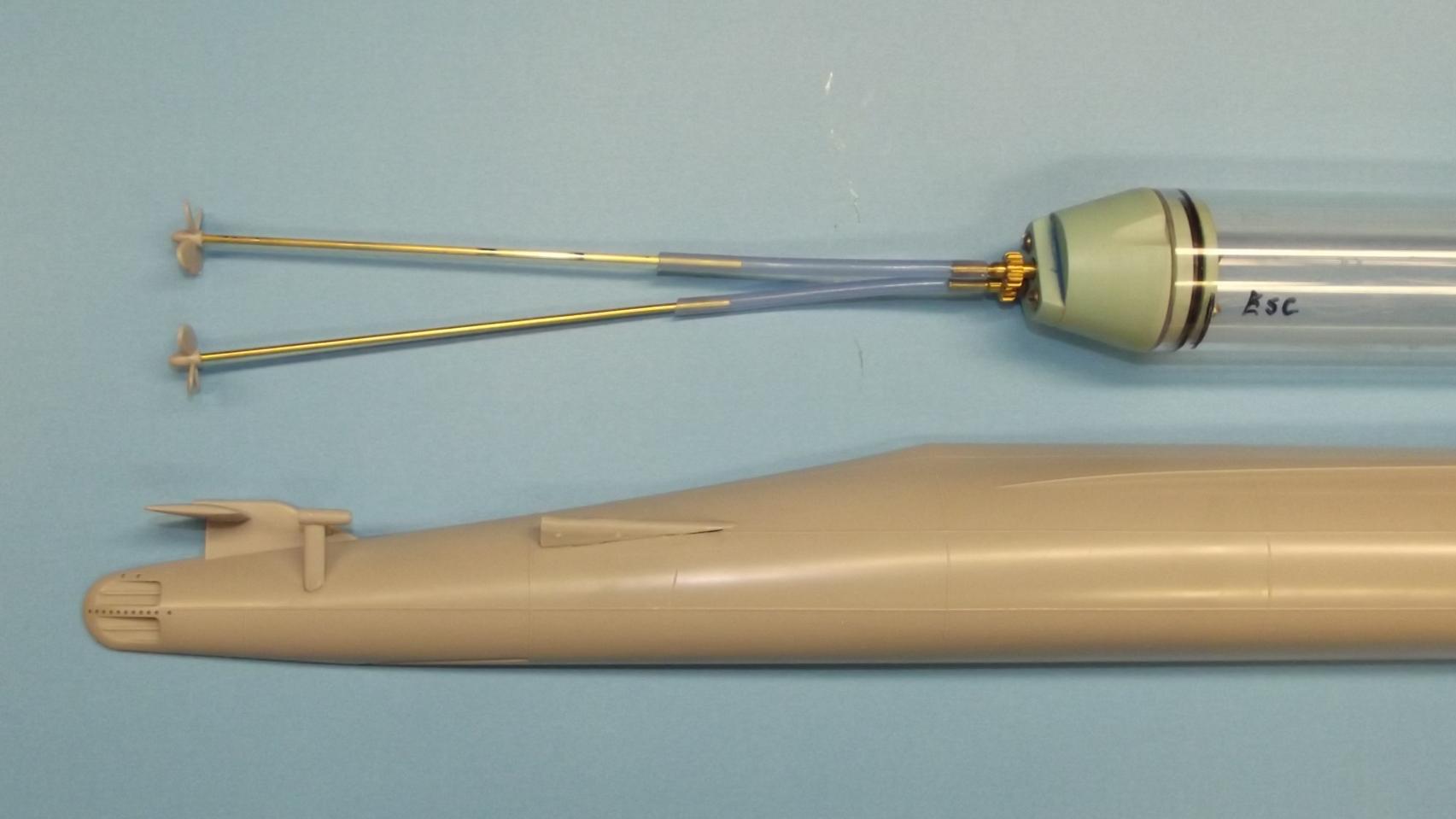

    All this reminds me to finish a long overdue build-up of a 1/144 Type 214
    Looks like it was worth the wait, though. The Sub-Driver looks so much more advanced than the (kit) version originally offered with the mini-Skipjack.
    Photos indicate fixed forward dive planes. Looks hard to rig up with such limited space in the Sub-Driver, so I'd assume the only way you'd bother trying is if the aft planes were insufficient.
    Any expected or proven issues with ballast/foam?
    Looking forward to sea trials!
      • 2547
      Mea culpa- I forgot to allow for the thickness of the plastic moulding. Sounds like a candidate for a dry hull conversion.
        • 13824
        Me too!

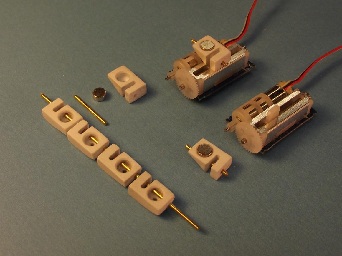

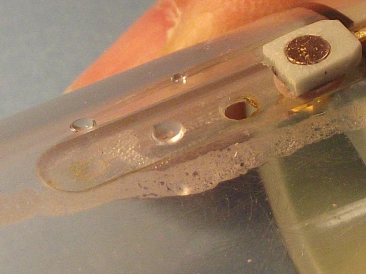

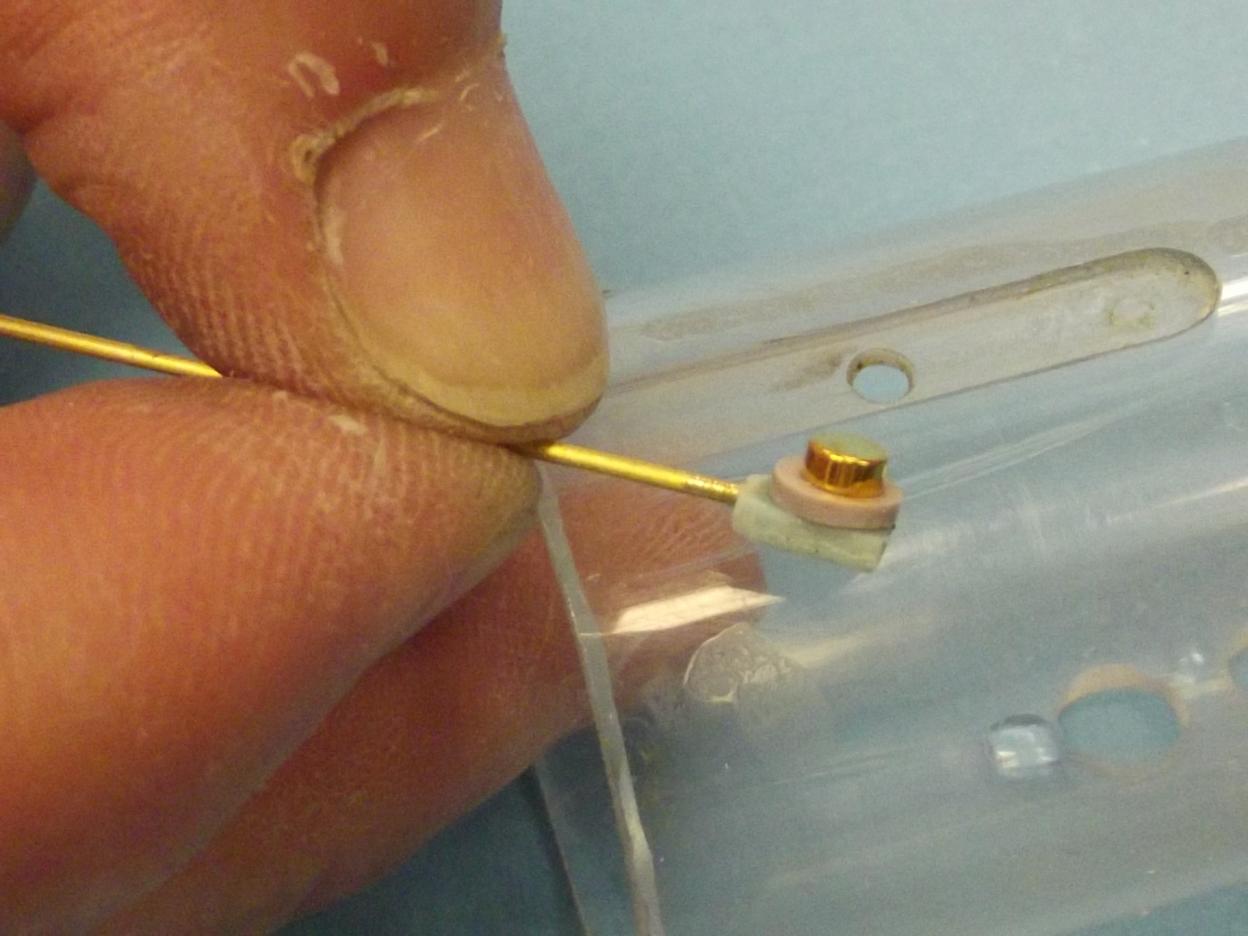

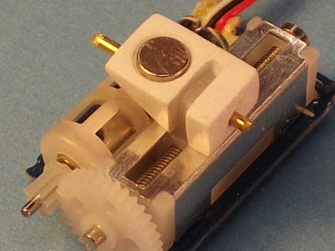

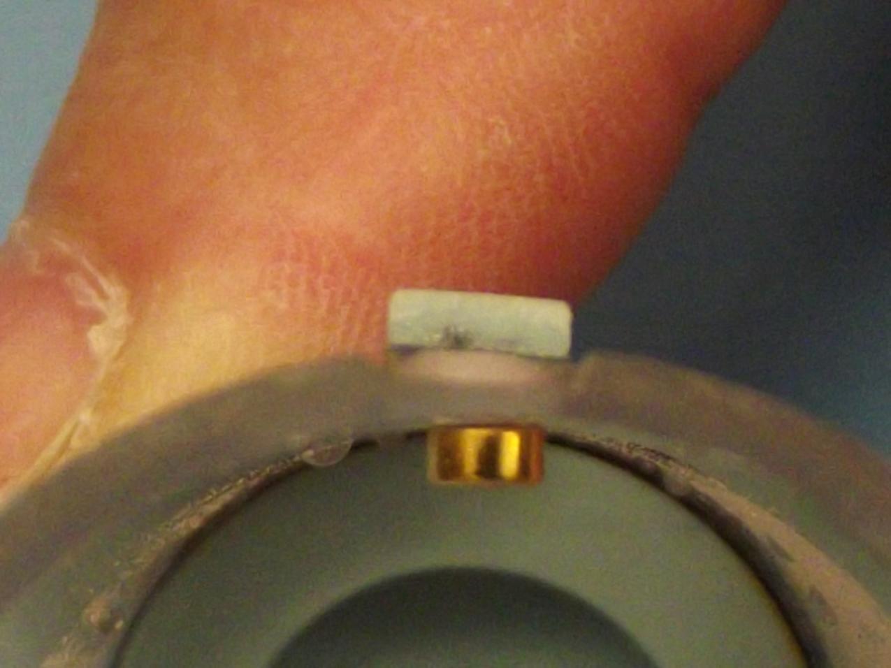

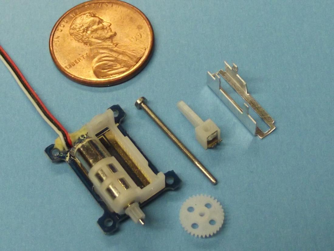

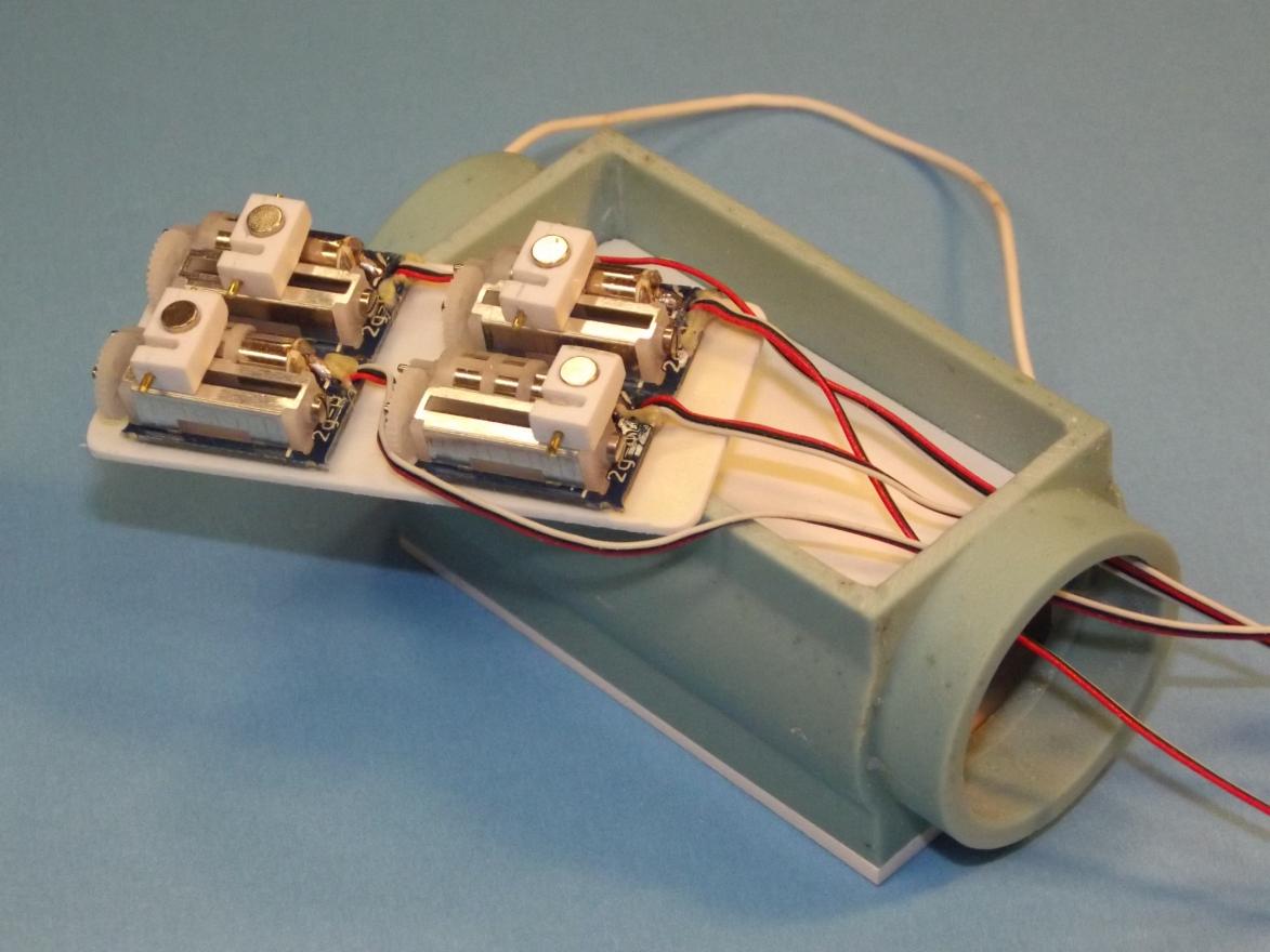

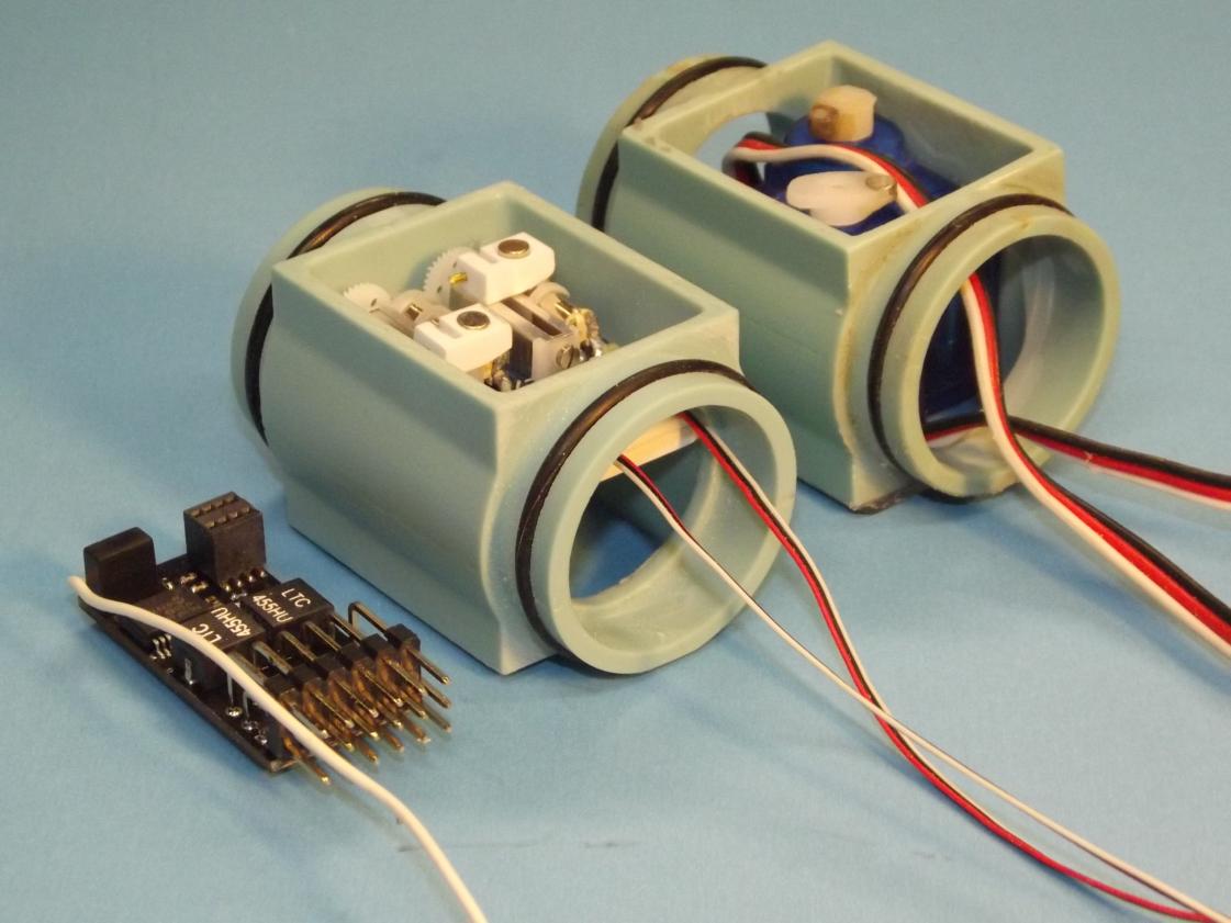

        Two very big 'enabling technologies' (I promised myself to use that phrase at least once before I died!) occurred since the initial effort to get the Type-214 to work as a practical r/c model submarine:
        1. perfection of a reliable, easy to manufacture ballast tank vent and
        2. identification and incorporation of the extremely powerful and small linear servos.

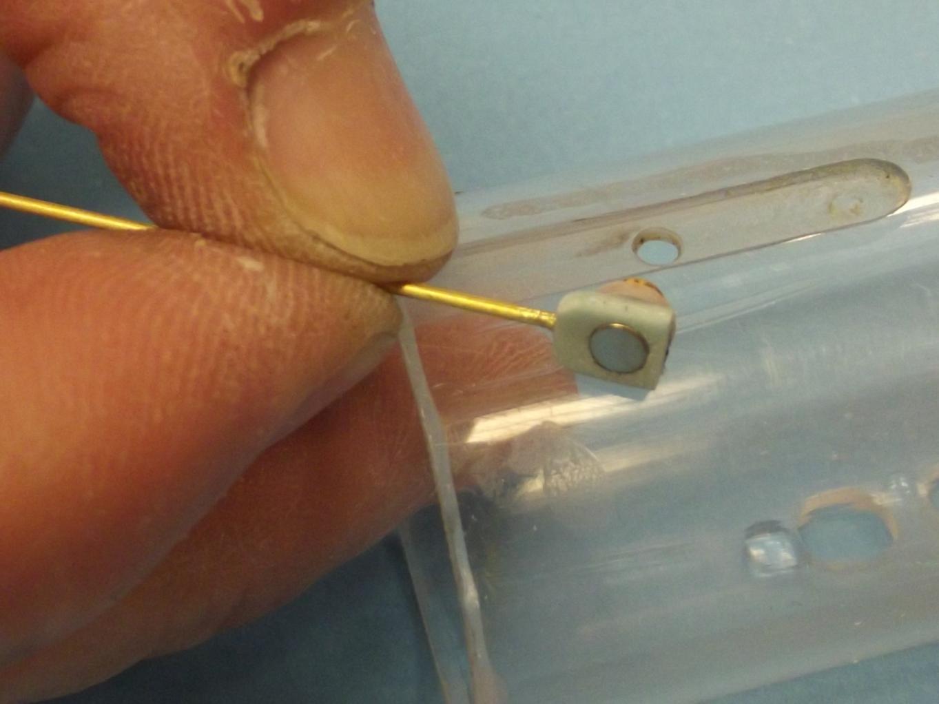

        What killed by initial attempts was the failure of the vent to seal properly each and every time -- the initial design was good, a guillotine type valve. But, what was needed was a means to hold the vent valve rubber element down tight on the vent hole when in the closed position. I found that by placing a magnet atop the rubber element, and a magnet within the ballast tank -- that follows the upper magnet -- they're mutual attraction working to compress the rubber element down tight on the vent hole.
        And with the little microbe sized servos I could now mount most of the devices under them in the servo box, freeing up space within the cylinder sections for ballast tank and batteries.
        Trimming should not be an issue.

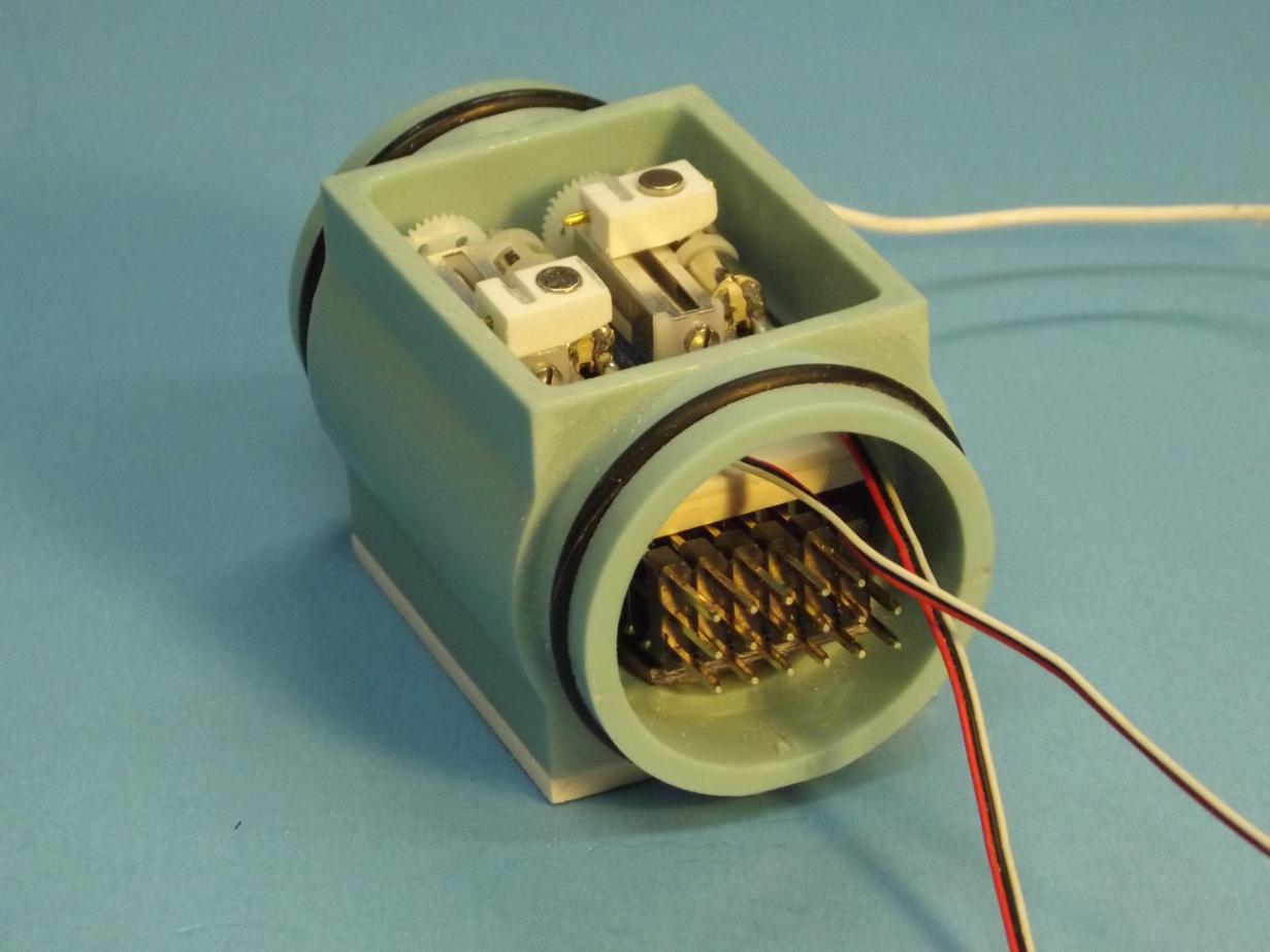

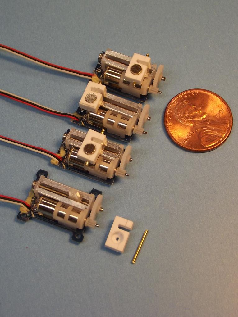

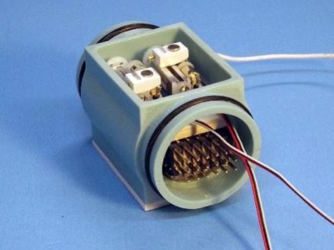

                • 3704
                Gary,

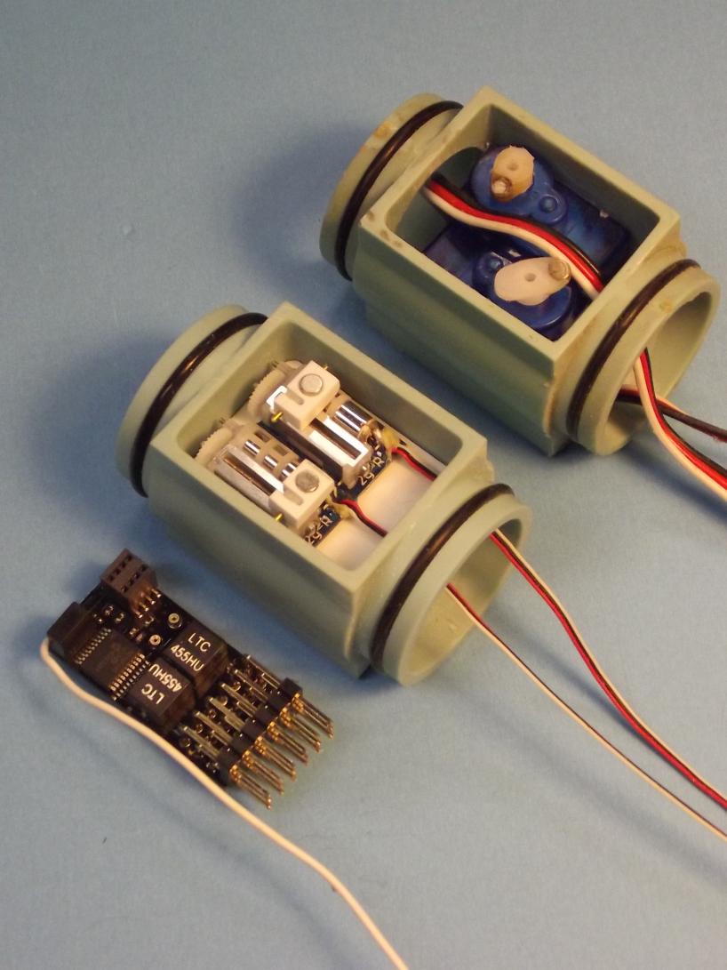

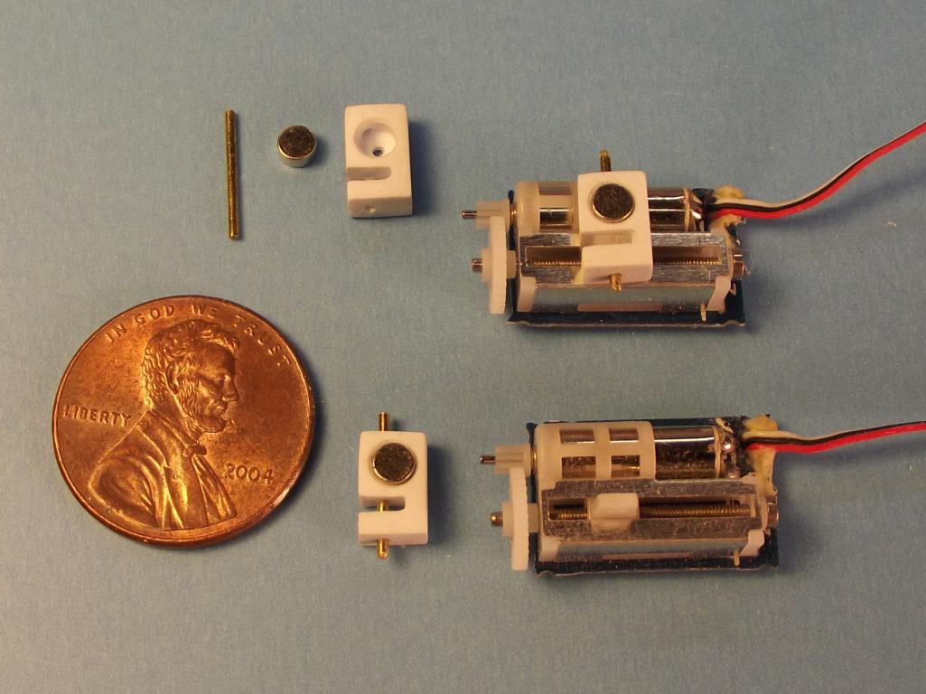

                Here are two photos of the type of servo used in the sub-driver.
Name:	one and quarter inch sub-driver servos 2.jpg
ID:	75243Click image for larger version
Name:	one and quarter inch sub-driver servos 1.jpg
                The most recent servos added to the 1.25" sub-driver is the linear servos. I think that is what David was referring to.
                  • 2547

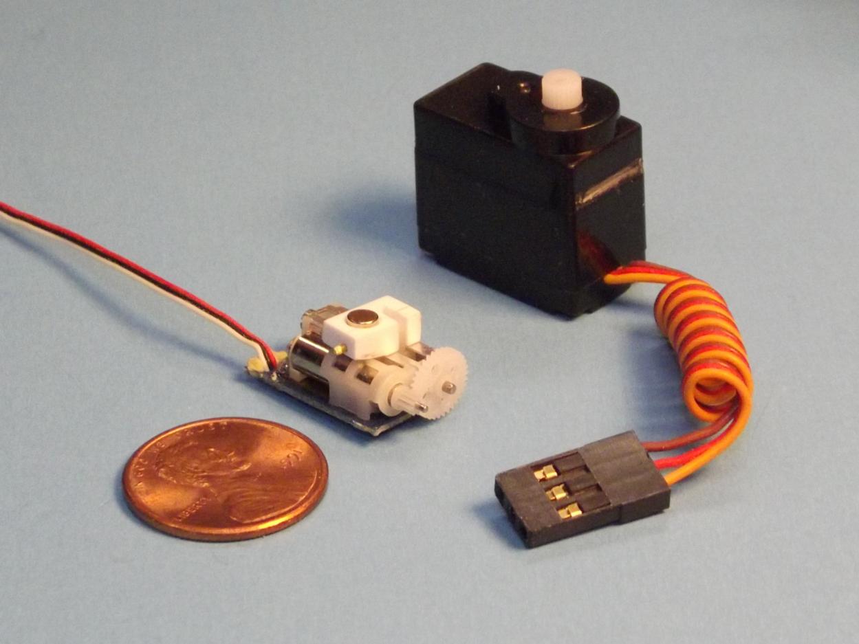

                  Couple of other micro servos I like are the little rotary orange servo pictured next to a pair of the linear servos for size comparison. Torque is about equal to that of the linear servos, and the weight is also about the same.
                  Also the Falcon servos, which will be less well known in the States, escept amongst micro/indoor flyers, are superb. These have an advantage over other makes in that they use magnetic feedback device, so no micro pots to wear out. They are much more expensive though, as these are made in the UK not China!

                    ...The most recent servos added to the 1.25" sub-driver is the linear servos. I think that is what David was referring to.
                    I share that hunch, though the photos David posted a few days ago in this thread had blue cases and angular actuators. (See below.) My guess is that David will use whatever fits best in a particular application. I don't know if there is any significant difference in the service life (MTBF) of the servos in question or in their cost. If either or both are factors, that would affect what goes into the SubDriver.

                      • 13824
                      Gary,
                      [ATTACH=CONFIG]17732[/ATTACH][ATTACH=CONFIG]17733[/ATTACH]
                      Tom! Thanks you so much! I couldnot find those shots to save my life. Thanks for bailing me out, buddy.

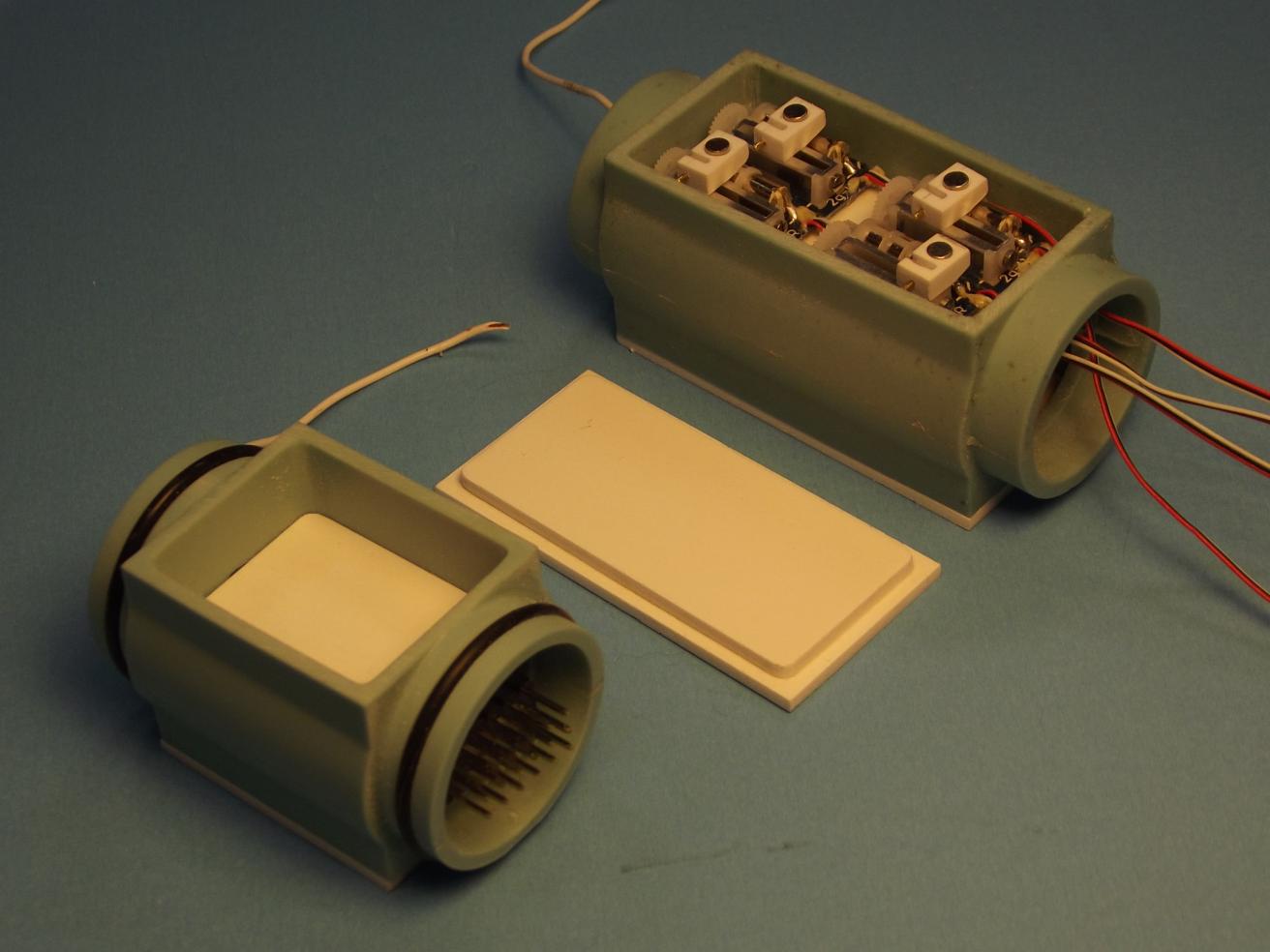

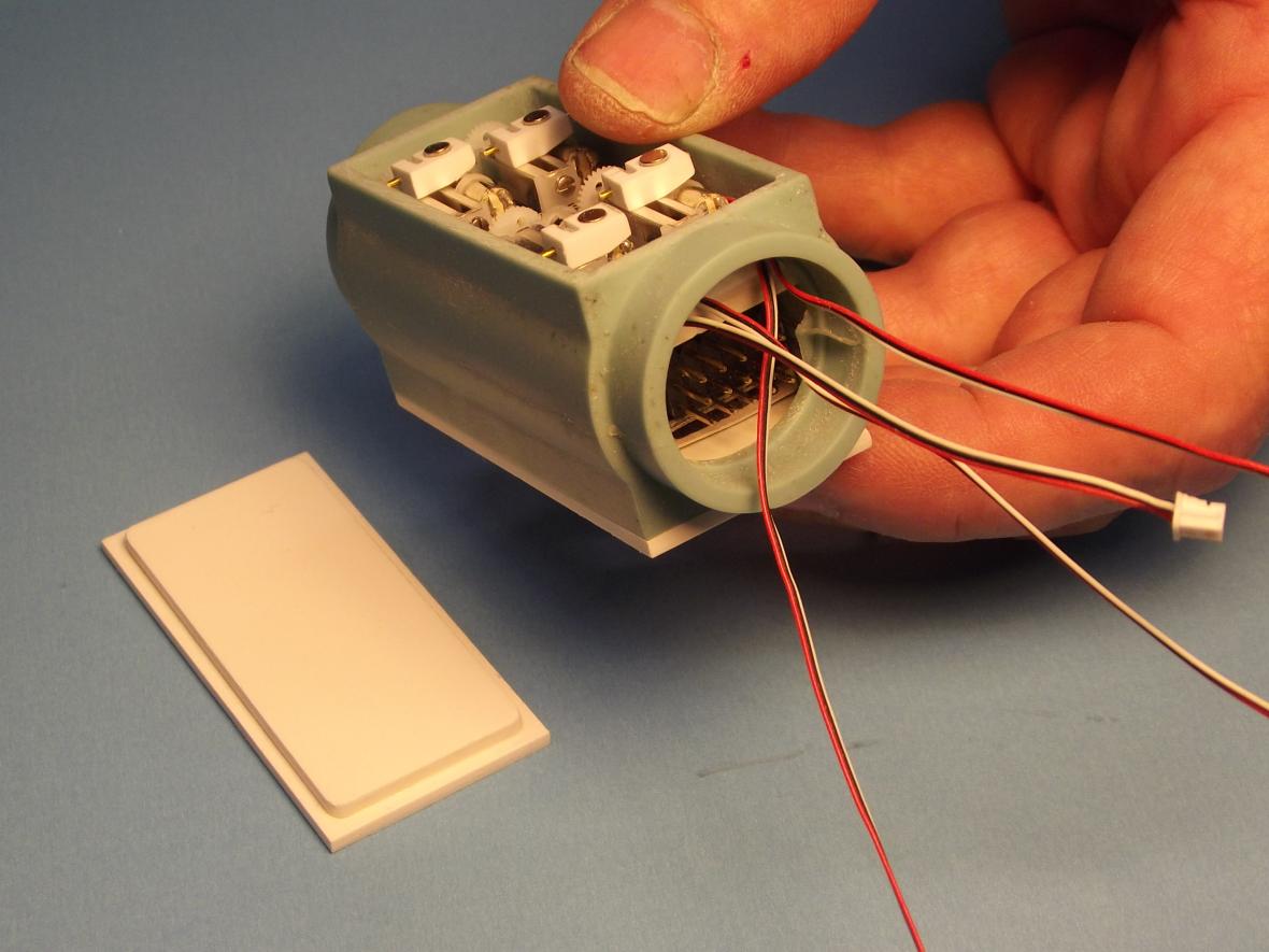

                        Just as soon as I dig myself out I'm gonna use Jim's 214 as a test-mule for the new ballast vent, equip it with the new servos and get it off to him. At this time Caswell-Merriman has no intention of providing servos with our SD's. We're going to produce two 1.25" SD 'kits' One for static diving sub, and one for dynamic diving subs.
                        Jim has waited way, way too long. Then there is Mamas to attend too ... I've made promises, time to keep them.
                          • 13824
                          Andy, those are so neat looking! You Brit's have all the swell toys!
                          • Outrider
                            • 304

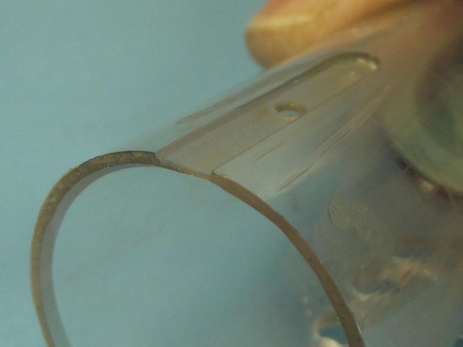

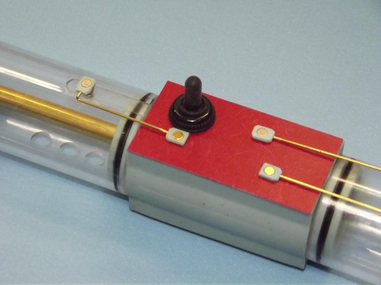

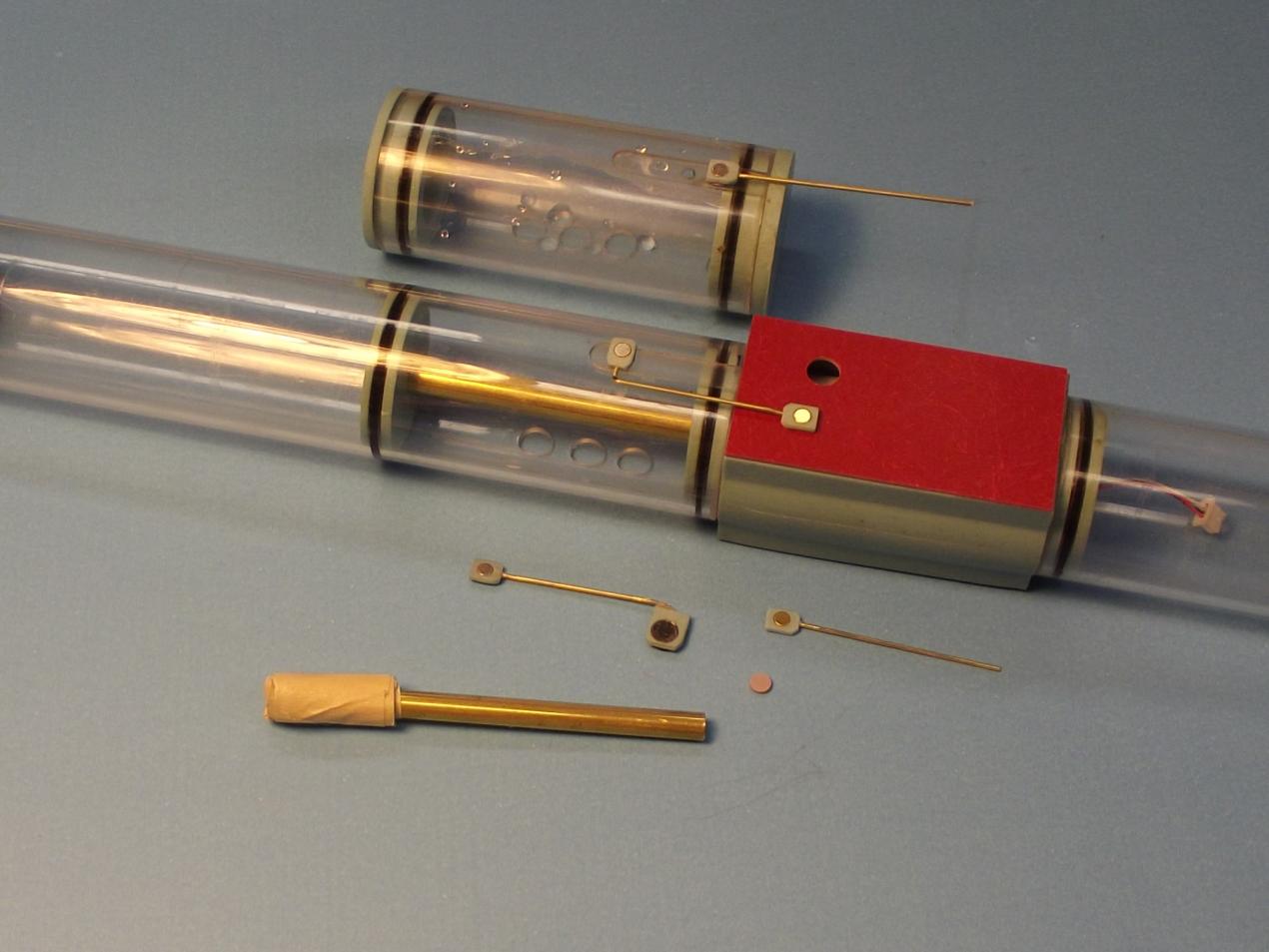

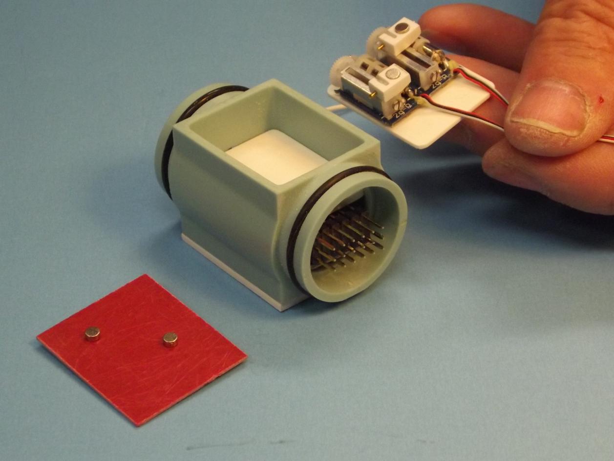

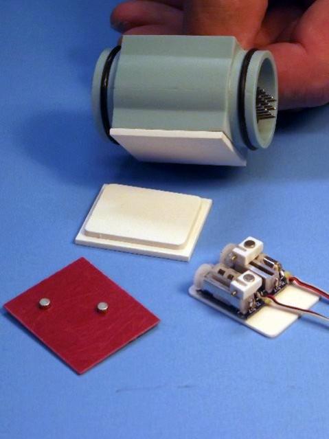

                            Looks like the "lid" is no longer clear... Any reason? I like being able to see what's going on inside the servo compartment...
                              • 13824
                              The clear Lexan was about .080" thick. The G-10 comes in at around .30" The inverse square law rules here (the magnets), so I went with the thinner, stronger lid, Jim. Sorry.
                              Oh, and CrazyGary: I found those shots you asked for. Sorry, I've been in a fog that last week. See the small kits we can now r/c!?....
