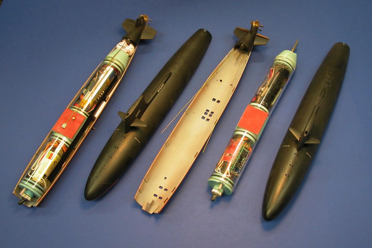

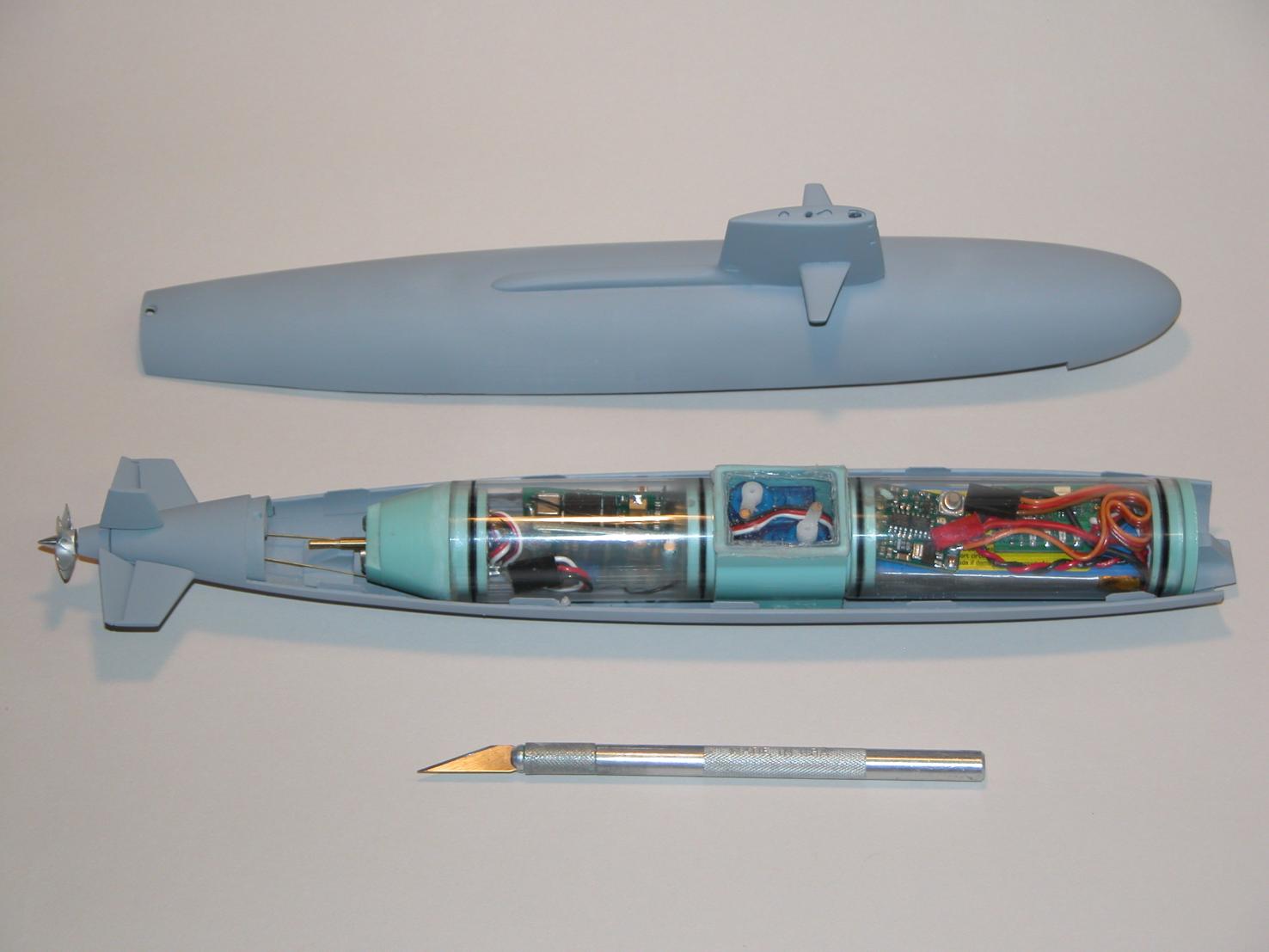

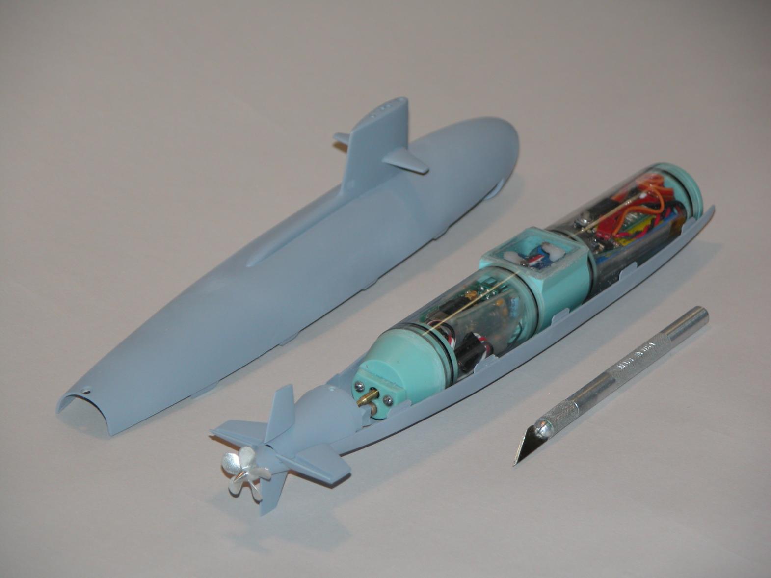

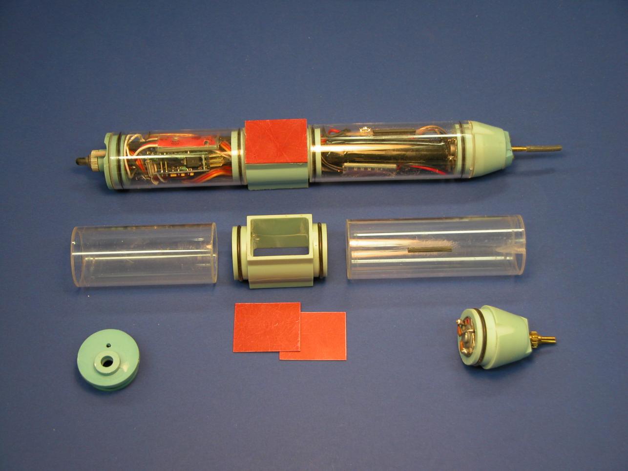

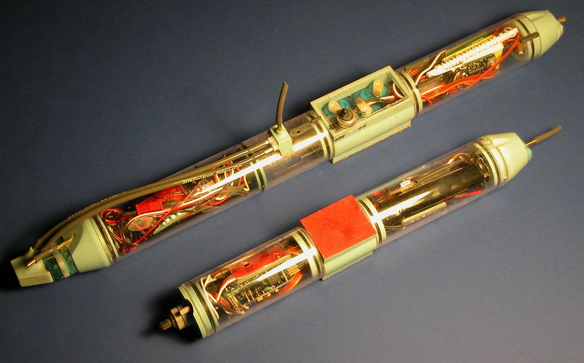

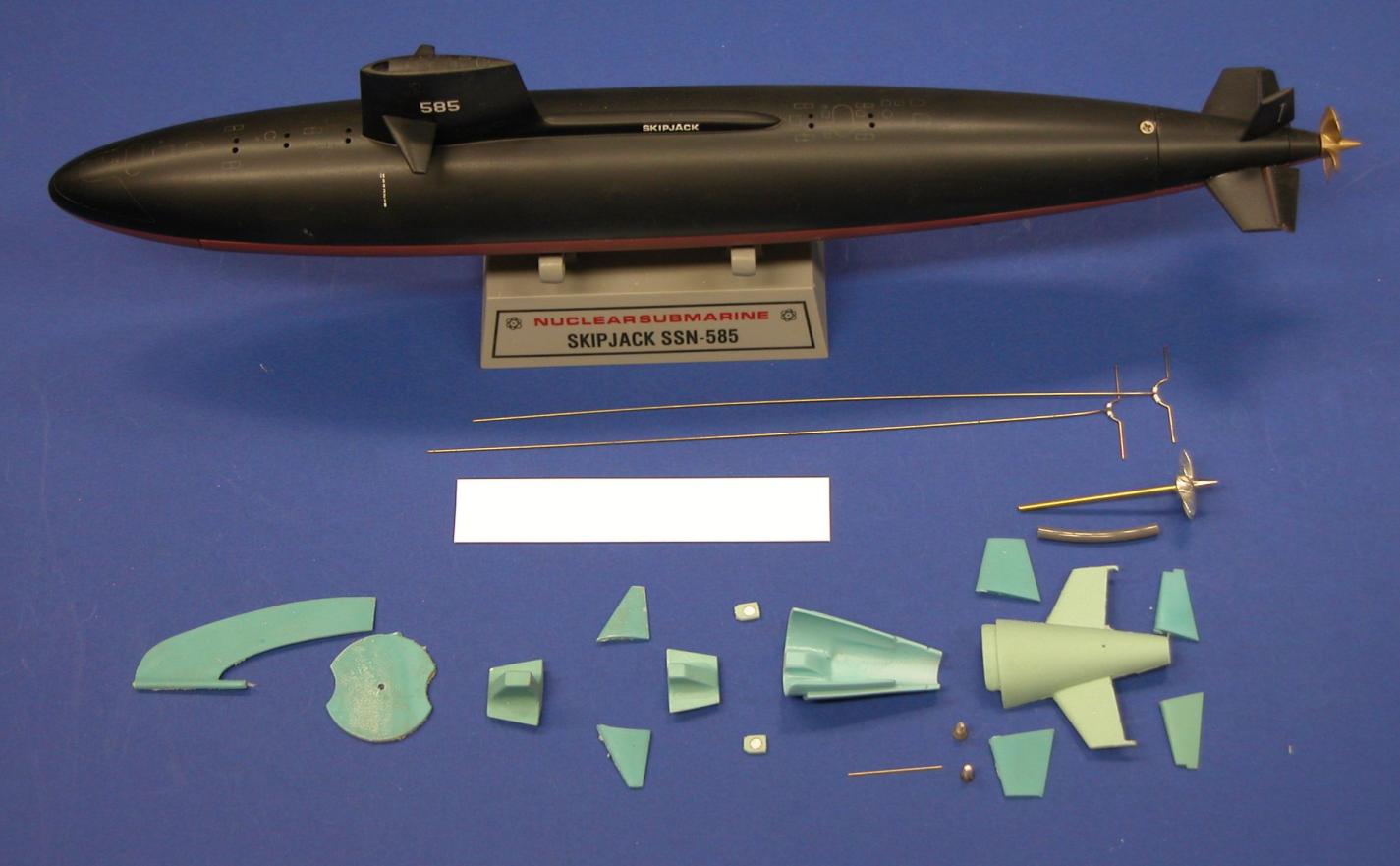

                          With regard to the photos you posted in post #29, which I thank you much for, the last 6, or so, are showing that you milled a slot on top of the wtc tube to guide some sliders of some sort. What exactly are they all about?? They appear to have something to do with rudder and dive plane actuation??? Yes, no?? Or maybe something to do with the ballast system?? Whatever they're all about, it definitely looks pretty danged "official"!! Hah!
                          Please 4-1-1 when you have a chance!
                          crazygary
                            • 13987
                            #58
                            The slot atop the motor bulkhead was to clear the pushrods in the little SKIPJACK -- it's that tight back there.
                            The milled slot over the ballast tank guides the guillotine type valve that vents the tank. A holding fixture permits quick production work on the overhead milling machine.

                              So, what I'm "seeing" is that the pushrods are moved linearly via some
                              sort of magnetic assiciation between the internal servos and external rod "carriers"??
                              Gotta be some really serious magnets!!
                              Thanks again for your indulgence, David!! Way cool stuff!
                              crazygary
                                • 13987
                                #60
                                Very cool, David!!
                                Being an old machinist, things like this can really get your juices flowing!!
                                Thanks for sharing your ideas! Much appreciated!
                                crazygary
                                And thank you, Gary.
                                In the Navy I was thrown out of more SIMA and tender machine-carpentry-rubber-foundry-sheet metal shops than I care to remember -- I would just march in there, grab what I needed off the rack and chuck up/rip/join/lay-out/cast/or bang together whatever I needed; acting like I owned the place.
                                We Diver's were arrogant ****s.
                                However, it never lasted for long, as eventually a Repair Officer or work-space supervisor would post a picture of me in the work centers office with a cryptic note attached, reading something like this: 'Keep this jive-ass Torpedoman in Greens out of our workspaces!'
                                I'm Self taught, and have nine and-three-quarters fingers to prove it. I learned spindle speed and feed rates by how many minutes I could turn or mill something without it flying across the compartment.
                                The magnets are those little discs you get from http://www.gaussboys.com/ As magnetic force is ruled by the inverse-square law, you strive to keep the servo box top as thin as possible, G-10 of about .025" works well in this application, Gary.
