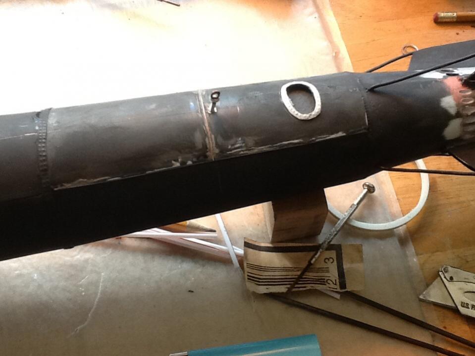

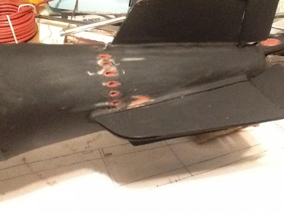

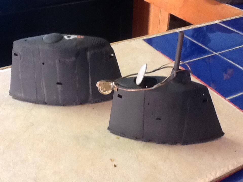

    Update on my Ko Hyo Teki . Had to make a scale adjustment. Initially was to be 1/16th when I built the first tower. Didn't want a model that big, so decided 1/24 would be ok. That didn't happen. The hull was already a tad large for a true 1/24 so I put a skim coat of bondo on the center section to increase the OD and blew up the tower plans on the computer to keep the overall length under four feet. So, it came out to 1/19th scale. 47.5 inches from bow to stern.Click image for larger version
ID:	98203slightly smaller towerClick image for larger version
ID:	98204still needs a few details, yet.Click image for larger version
ID:	98205l worked on the rudder and planes and cone sectionClick image for larger version
ID:	98207the bolt holes where the actual boat is separated were drilled and filed then lined with some wire insulation, stripped off 16 gauge wire, then glued and clipped and trimmed.Click image for larger version
