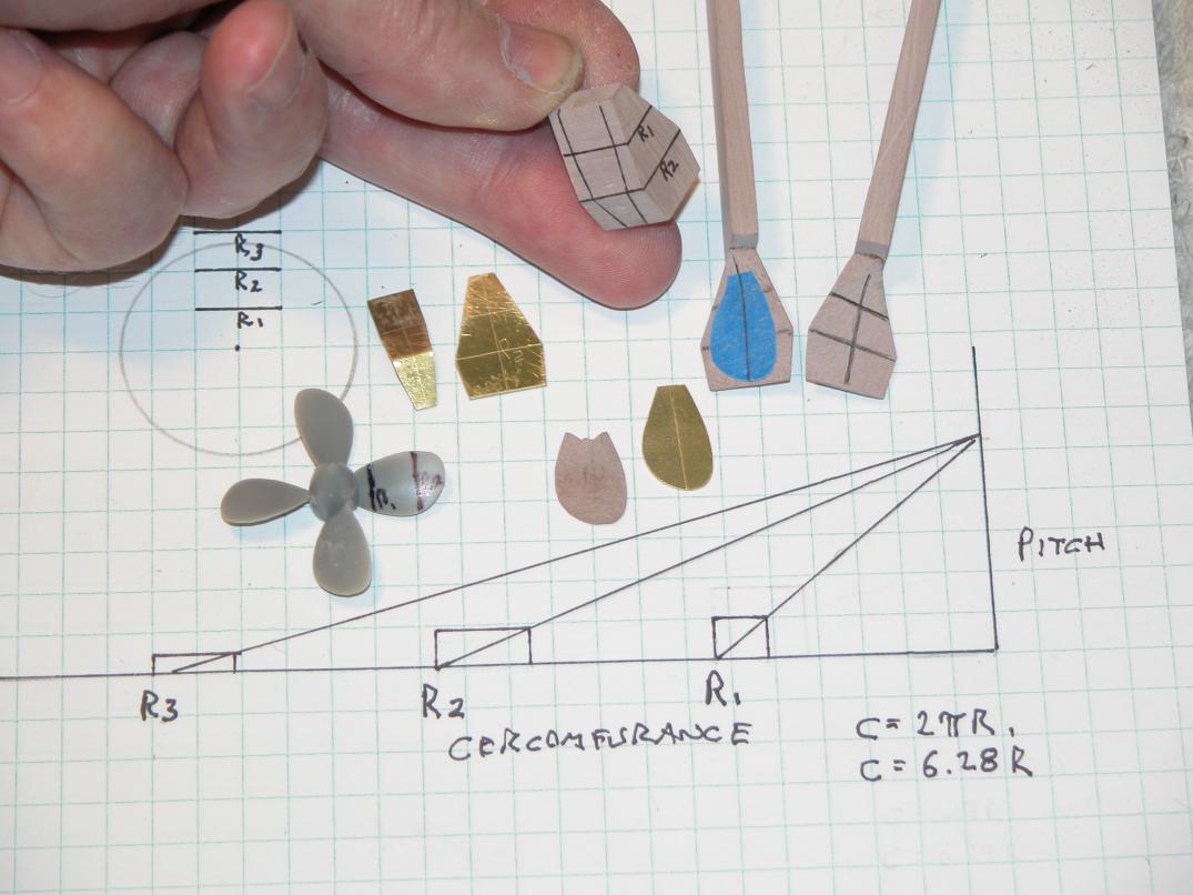

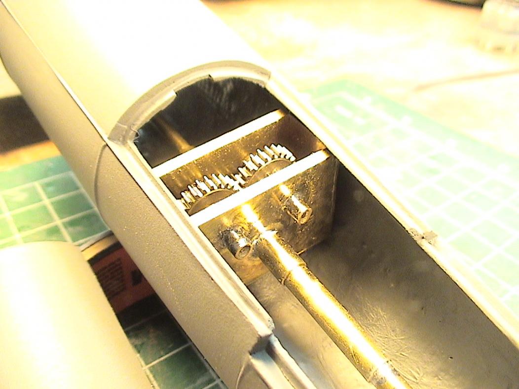

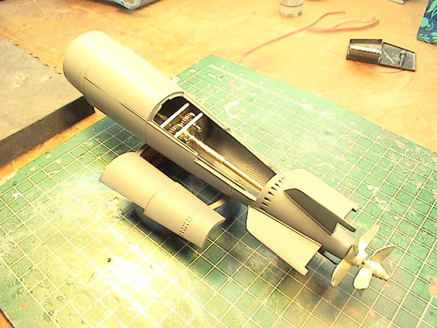

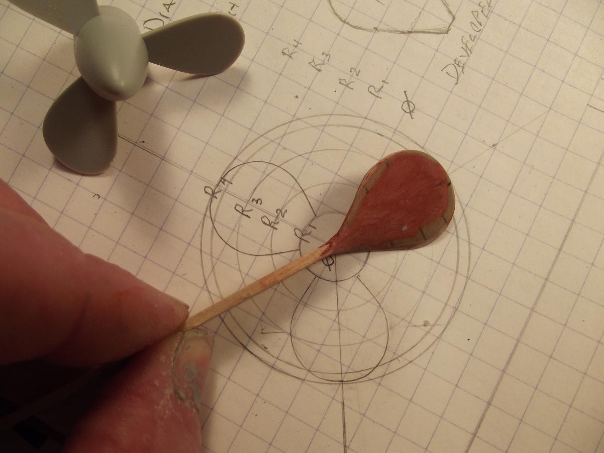

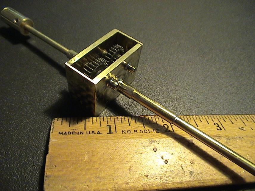

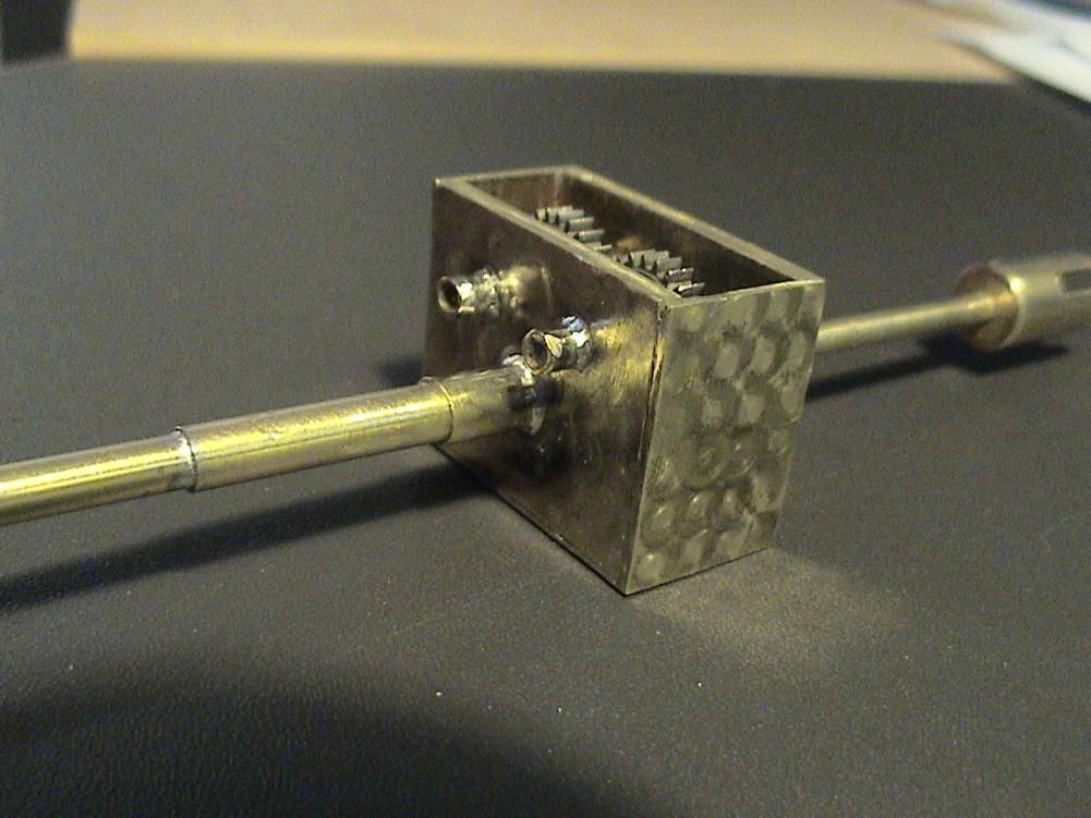

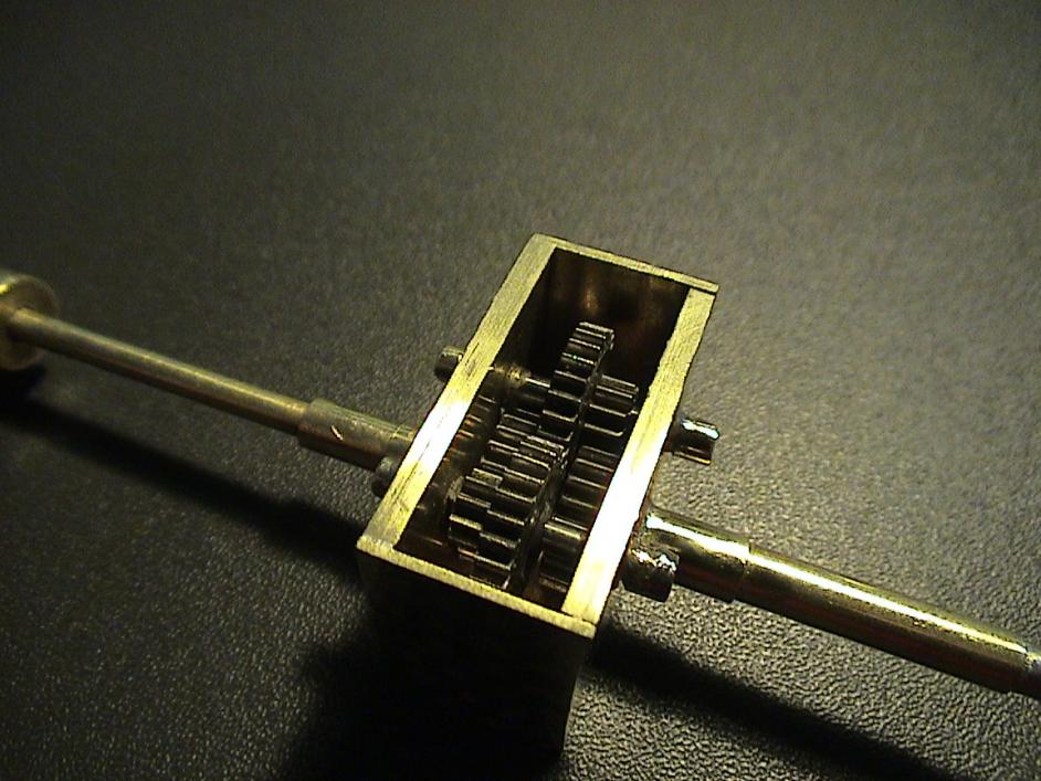

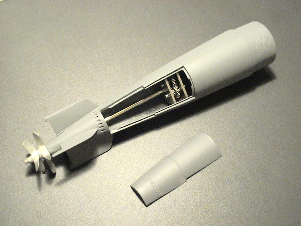

        Some more detailed pics about Gene's propellorspinning wonderbox used on his sub, got to know!!!
        How exactly do you determen the shape of the propellorblades, i mean the angle and the curve?

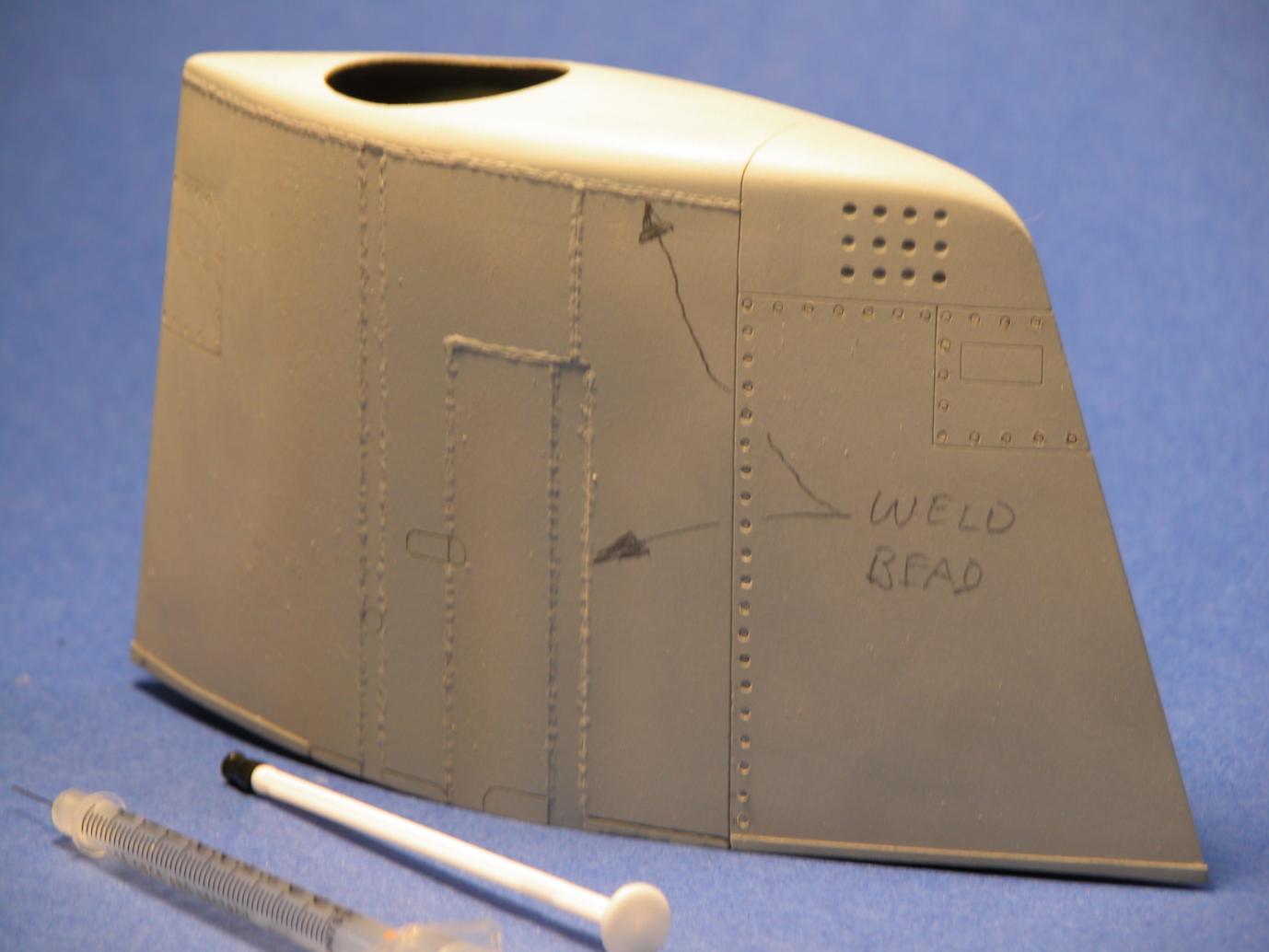

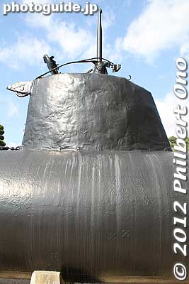

        And more pics about the tower of the japanese sub (you know why), wether Original from real live or models, i don't mind, the more the better.

ID:	97557 Here are all the shots I have of Gene's incredible counter-rotating shaft gear-box.

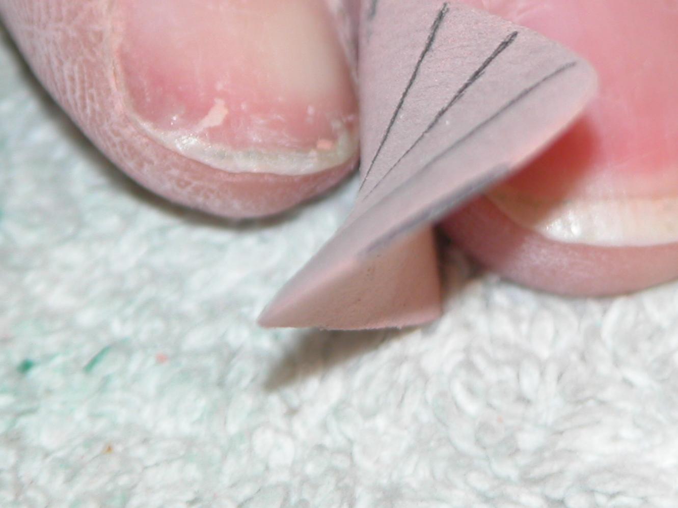

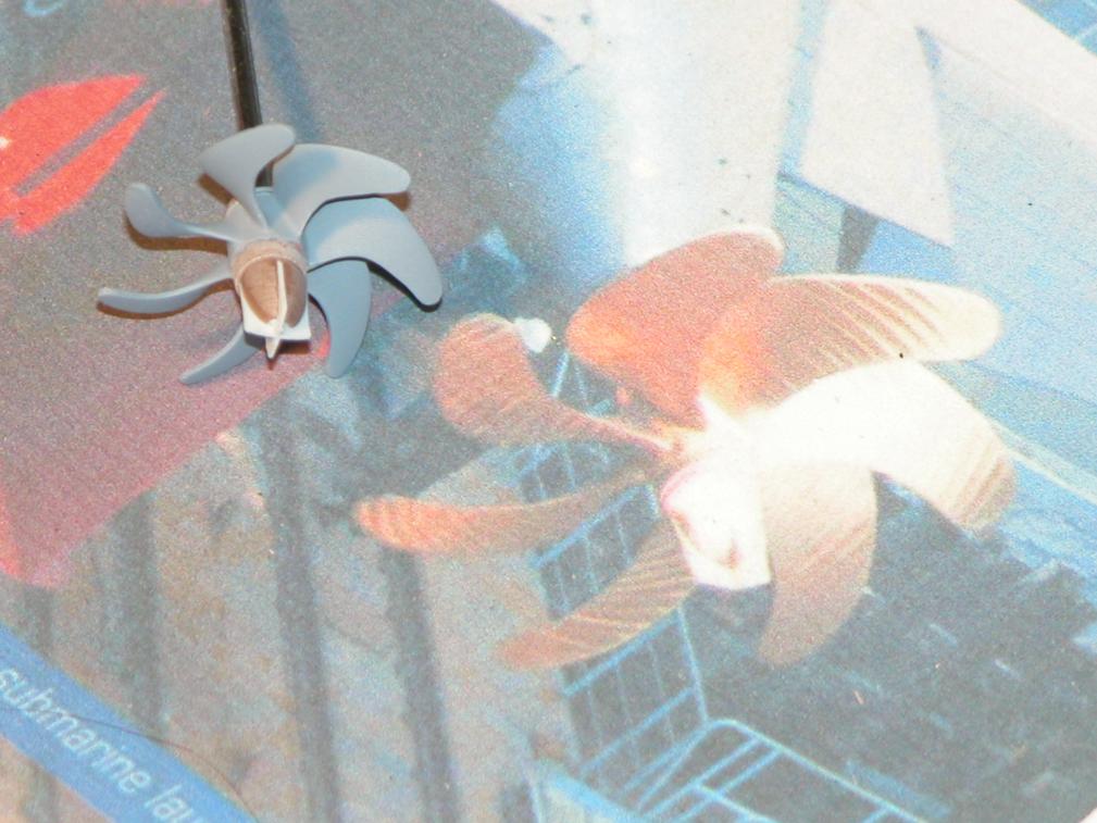

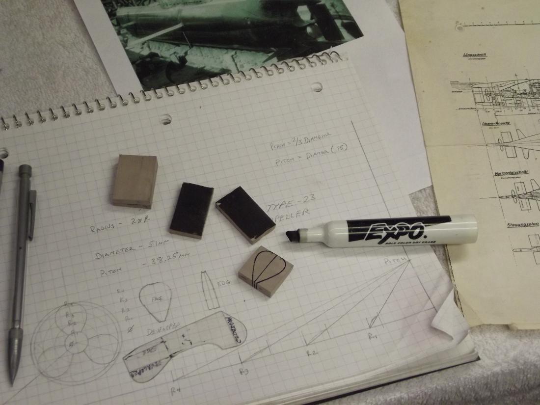

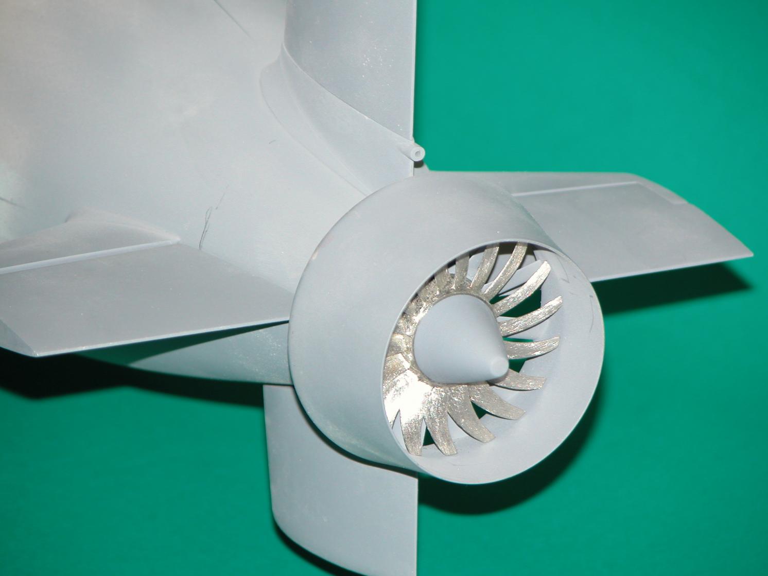

        Propeller blade shape is dictated by design -- as most of my r/c submarines are scale models (representing a prototype), propeller shape, pitch, and blade area are already worked out for me. 'Angle' is variable along the span of the blade. As each radius point along the span of the blade travels at an ever increasing speed as you move outboard along the blade, the blade is given a helical twist that insures each radius point travels the same distance along the axis with each revolution in respect to the other points along the blades span.
ID:	97558 Click image for larger version
ID:	97559 Click image for larger version

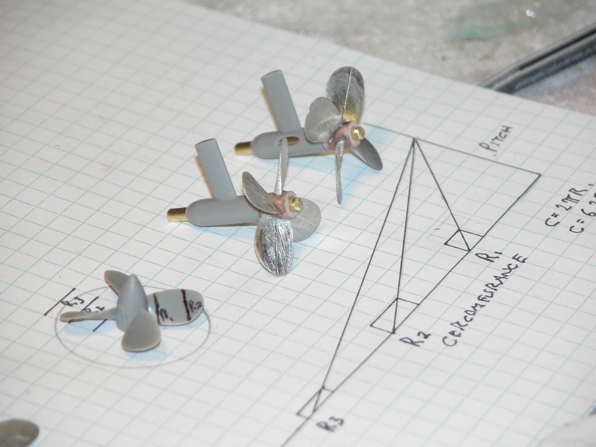

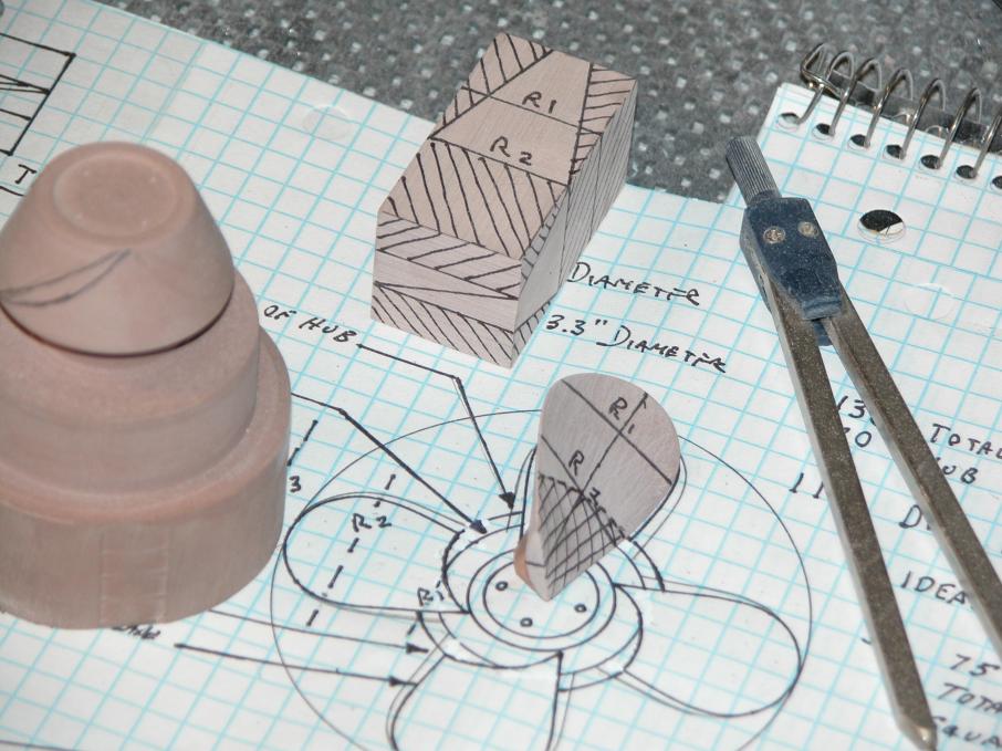

ID:	97560 This helical twist of the blade is worked out in a simple blade chart.

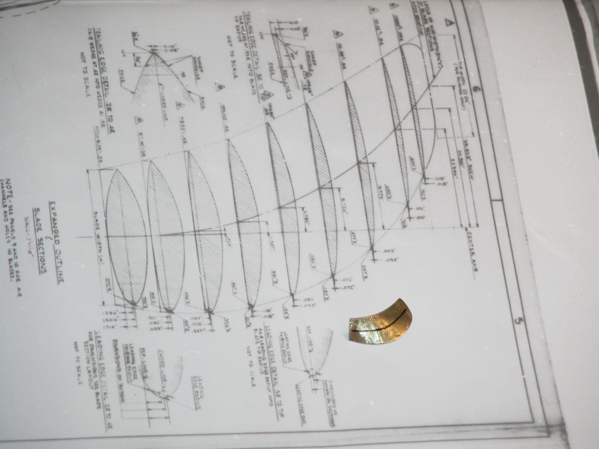

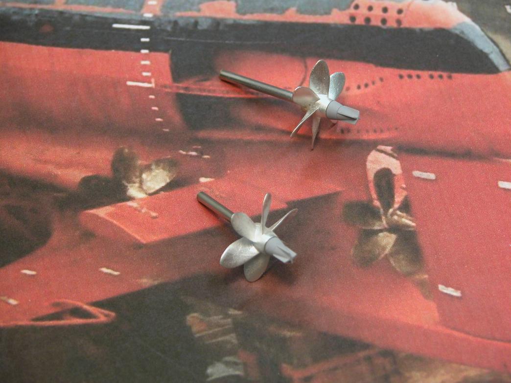

ID:	97562 Not too often the case, but here is a project where I had access to the actual propeller fabrication drawings. What a joy!

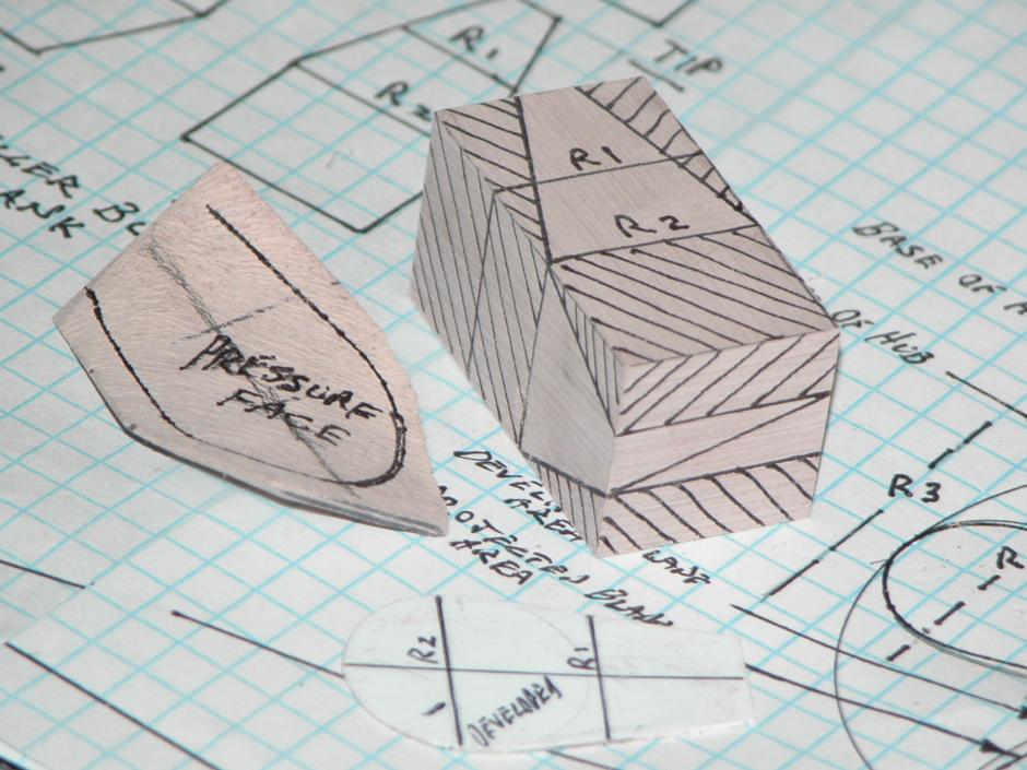

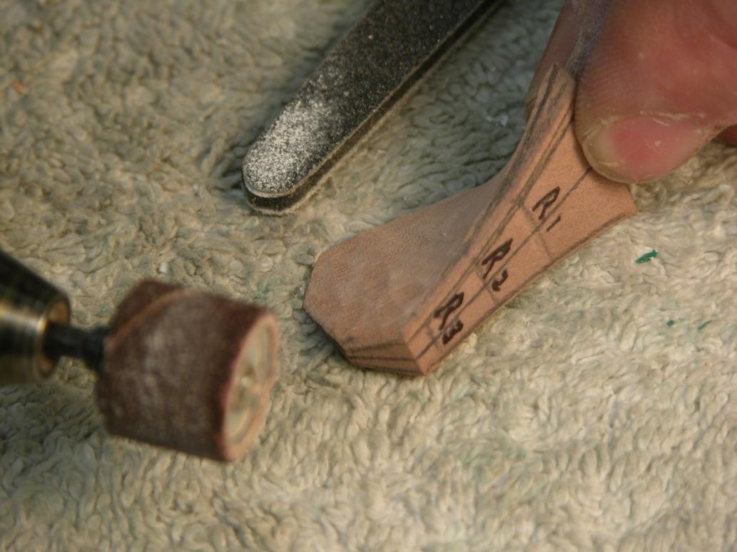

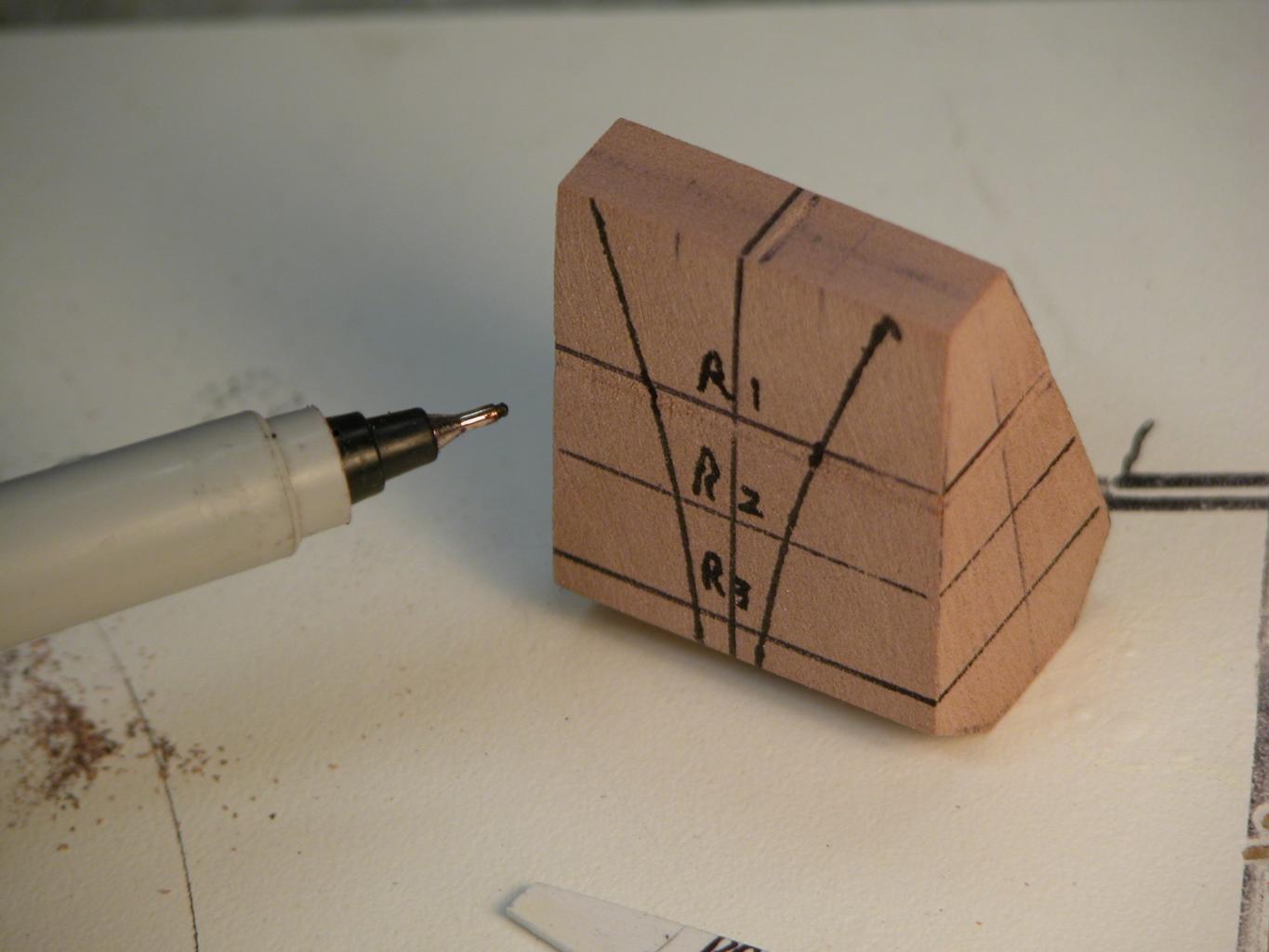

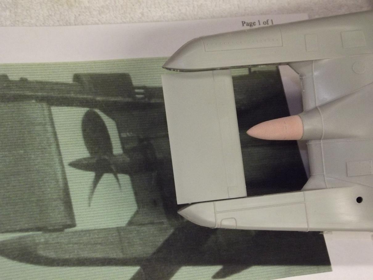

ID:	97577 But, too often the 'shape' of the blade has to be derived from photos and basic two-view drawings -- the tough part is estimating the actual blade cord from the apparent blade cord. In drafting-crafting terms the apparent cord is a projected view and is false to reality (thank you, binocular vision and helical twist!); actual blade cord is the developed view and is the actual two-dimensional representation of the cord at any point along the blades span. Note the two-dimensional drawing I produced here of the projected and developed views of the propellers face.
ID:	97564 Click image for larger version
ID:	97565 Click image for larger version
ID:	97566 Click image for larger version
ID:	97567 Click image for larger version
ID:	97568 Click image for larger version

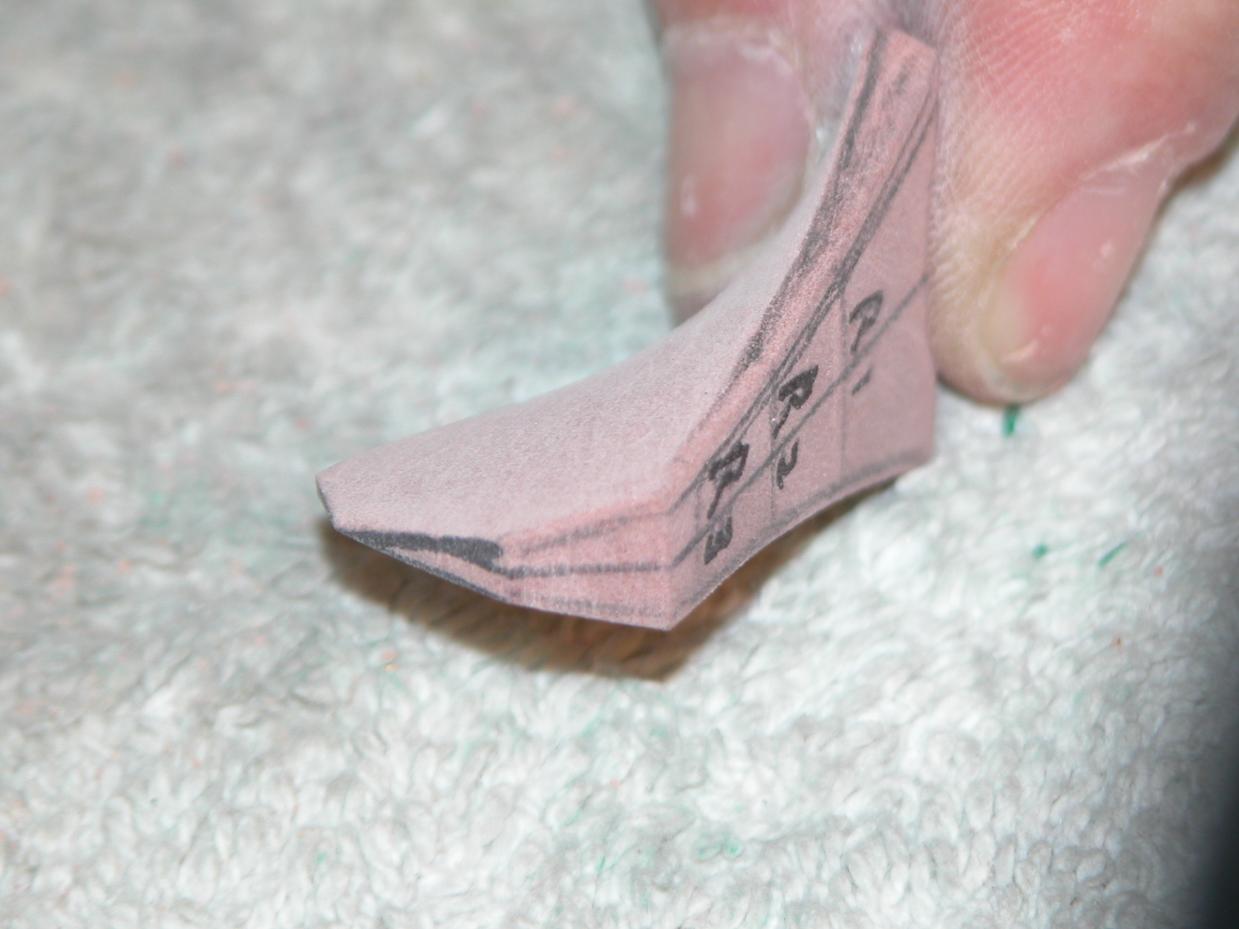

ID:	97569 A propeller blade blank is prepared (my ill-spent youth in competitive free-flight Unlimited Rubber served me well here). The blade chart is used to determine the 'twist' that will be cut into it as the blade takes form under my rotary sander knives and files.
ID:	97570 Click image for larger version
ID:	97571 Click image for larger version

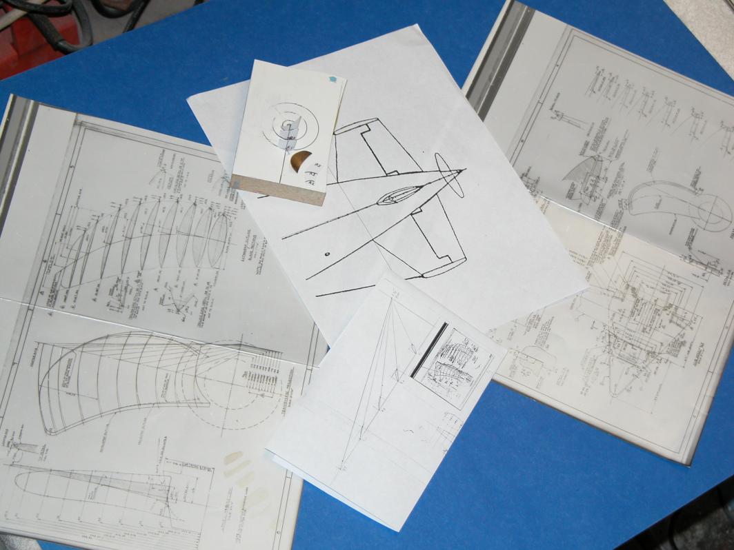

          #49

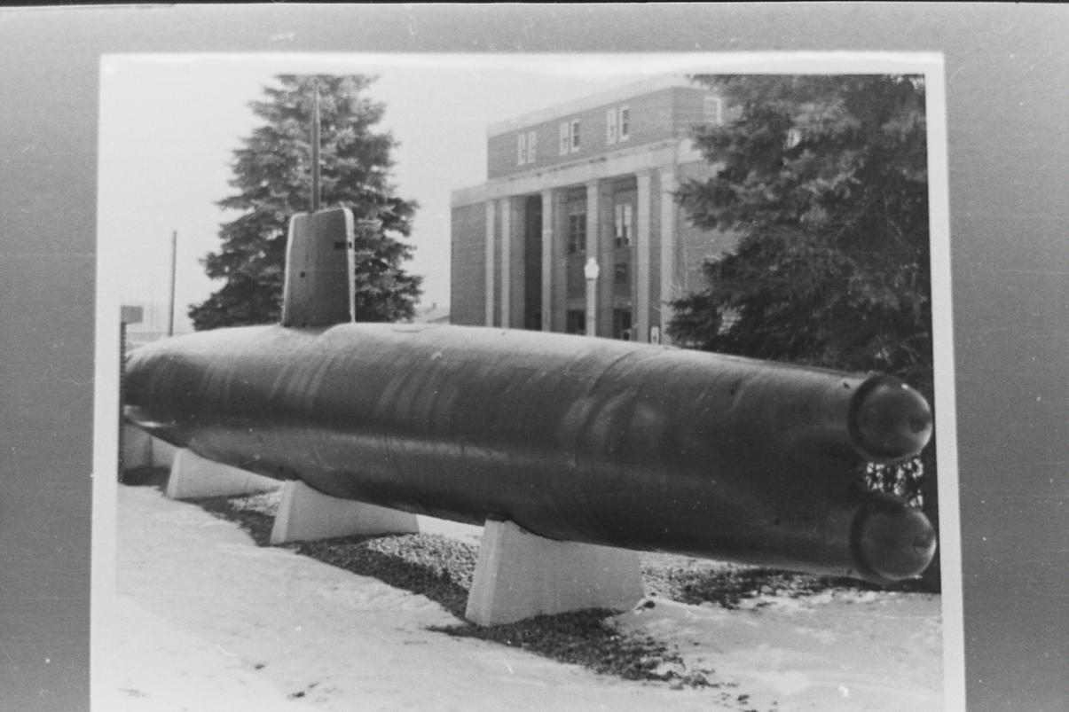

          I received the drawings yesterday. Great stuff Dave, Thanks. I still think the Ha 8 is the most accurate representation of the aft section completly intact, with the entire prop guard cage, of the type A's The designation of Ha 8 is rather foggy since most of the Ha number series carried a designation prefix of the I boats that launched them. The only 3 that were designated with the Ha prefix were 1, and 2 which were the original "Target" boats, under the guise of being a harmless target craft. I think the only reason Ha 19s number was known is because of capture of the skipper alive. The rest of the ones they captured, the numbres went down with the ship and the records went up in smoke during the firebombings of the boat yards and the records thar went poof in the IJN Naval Records in Heroshima. One of the Pearl Harbor boats I-18 tou was raised in 1960 in the Keehi lagoon at the entrance to the harbor, where it was sank after depth charging on the morning of Dec 7th. They found the crew remains and 2 unfired torpedos. The bow section was immediately removed with the live ordinance intact and resank for safety sake and then used as landfill for the runway, The remains and the rest of the sub was returned to Japan. It sits in the Japanese Naval Acadamy on Eta shima , near Nagasaki. Its a little rough around the edges for good details.Click image for larger version
Name:	I 18 tou aft.jpg
ID:	97582Click image for larger version
Name:	I 18 tou tower.jpg
ID:	97583Click image for larger version
Name:	I 18 tou replaced bow.jpg
ID:	97584hefty looking net cutters, possiblly fabbed post 1960 from old drawings.Click image for larger version

            #50
            Thanks David,
            Those pics from Gene are archived for the future, one day i have to build such a box for myself.
            Like i expected, building propellors is a craft which i don't master, but it's still very interesting to see how it works, especially how the fysics work.
            You know i want to build that tower, detailnut i'm, all the info is welcome, like Von you send me the drawing, next weekend it's copyshop time.

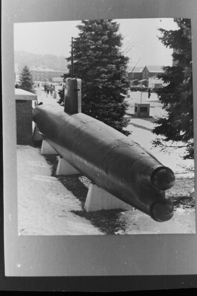

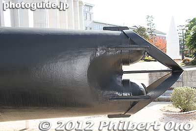

                    #54

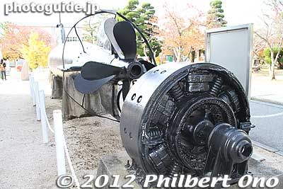

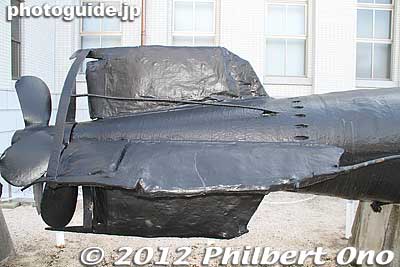

                    Manfred, there are several fotos of the I-18tou at the Naval Acadamy at Eta jima in Japan. The electric dynamo is very impressiveClick image for larger version
Name:	I 19 tou dyno.jpg
ID:	97589one thing I have noticed is that several pictures of that type of propulsion on the migets have the forward prop a greater circumfrance than the aft
