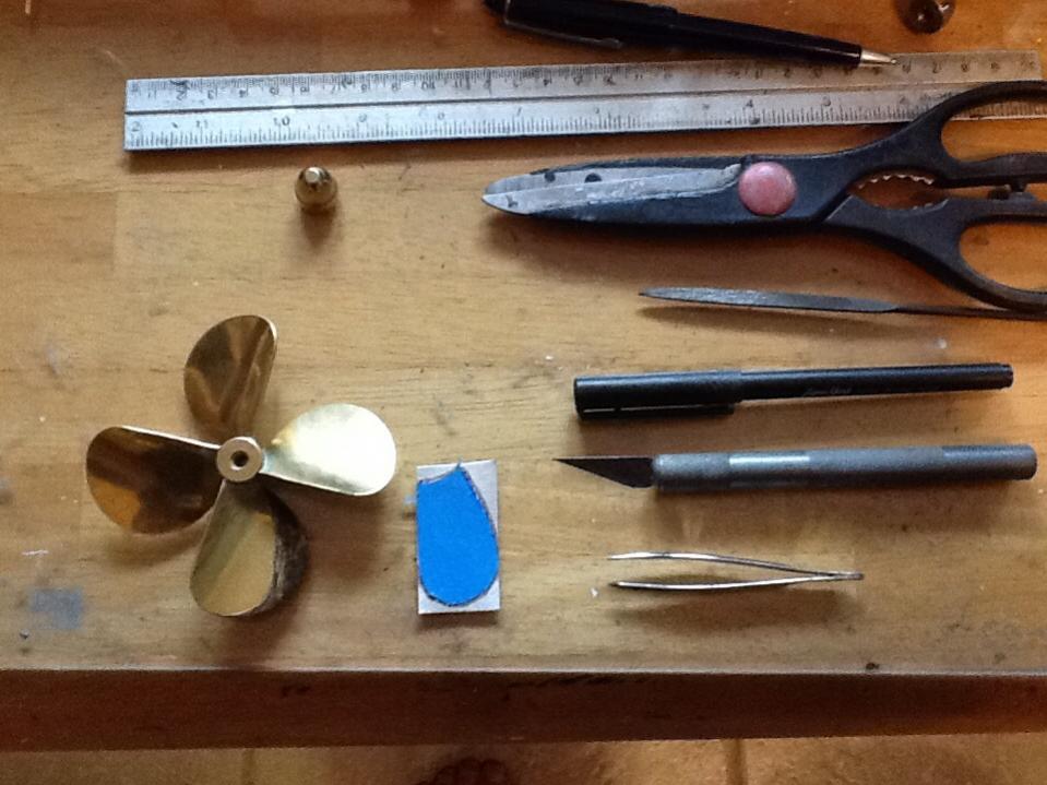

    Since, whatever size props I get they will still have to be trimmed to represent the actual ones, because I am using tug boat or utility props. The pitch is about the same but the bite overlaps when installed in line. I used a photo of the ha 18 an held the corrisponding prop in front and used a marker to draw the contour outline and shaded in the metal to be removed. Then masking tape to transfer to an aluminium template to mark the other blades uniformly. Same procedure using the reverse side of the template to mark the counter prop.Click image for larger version

ID:	98363basiclly some of the blade face has to be removed from tip to root. and about mm of tip to conform to the clearance of the cage. Ill end up with an 80mm prop from the 90.Ballancing the final trim is not so dificult they are low rpm to start with and not as tempromental as race props which I have some experience with in, full scale boats. They are going to have some beafy shafts but I will fill the OEM 5mm threaded shaft holes and re drill new sized holes individually. Just picked up a big Chicago drill press, so now I can play around with stuff like that better with more precission. Dont know where I will set it up yet, but I will find the room.Click image for larger version
