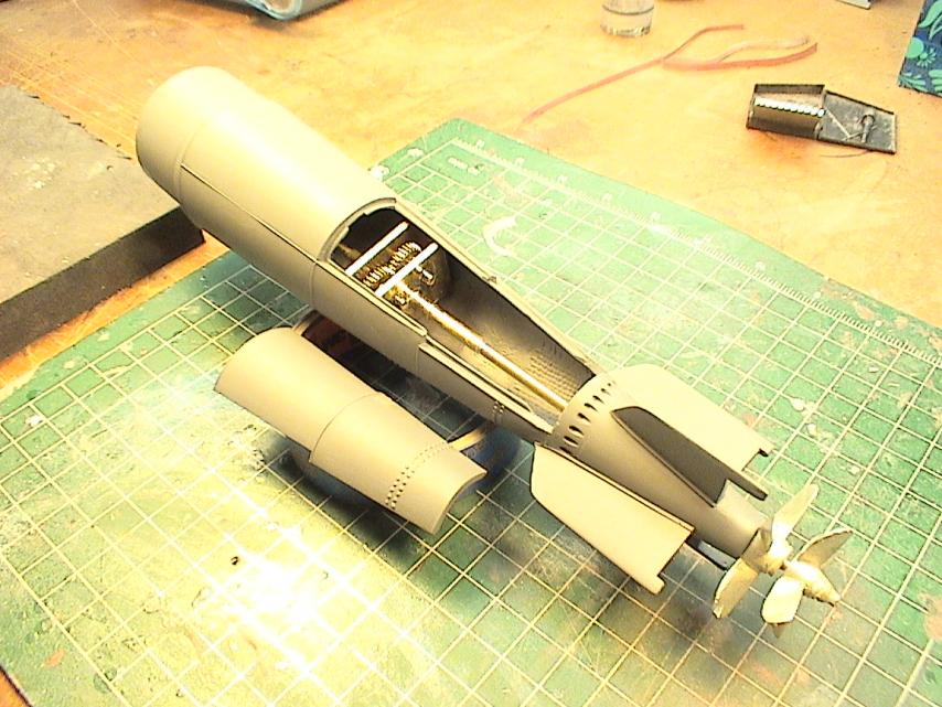

Japanese 1/16 scale A Class midget submarine build.
    • 13998
    Thanks to HNSBN I shoud have a copy of Gene Berger,s drawings in my possession in a few days. As soon as I get my EZ driver in my type IX project and dialed in, I will be getting my ducks together for an EZ powered 1/24th Ha 19. One of the first things is the counter rotation gear box, that seems to be the key component in the boat. M (like the guy in the Bond movies) should be on board with his input with that situation. I can't wait to get started on this one!
    Yes, I received Gene's permission to pass out copies of his Type-A drawings last night. Gene is one of the best model-builders I know ... let's see if I can get this hard-drive to spit out some of his stuff:

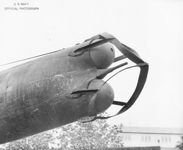

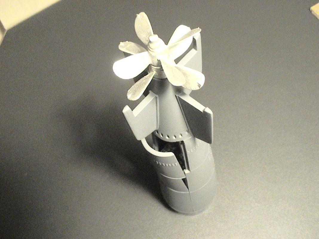

          Digged in on my digital archive, and found some nice pics, the search for more is on.

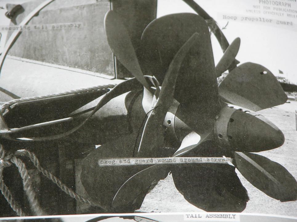

            Those are all of the Ha 19 at Mare Island the day they put it on the flatbed truck. Everybody that worked on it, at the yard came out to sign their names on the hull with chalk. Ended up getting a few thousand signatures, most washed of on the trip from San Francisco to Los Angles to the UCLA football stadium in 42. Thas where the bond tour had the Hollywood celebraty send off. There lots of pictures of it from all the cities that it visited thruout the war. Including Fredricksberg Texas. Ironiclly that is where it ended up in 91. I have searched, but havent found out how much they sold in bonds for that tour. I'll bet there were quite a few. There are rusting hulls in the Allutian Islands still left from where they were destroyed near their bunkers. I wonder why nobody ever tried to remove them for postarity sake.

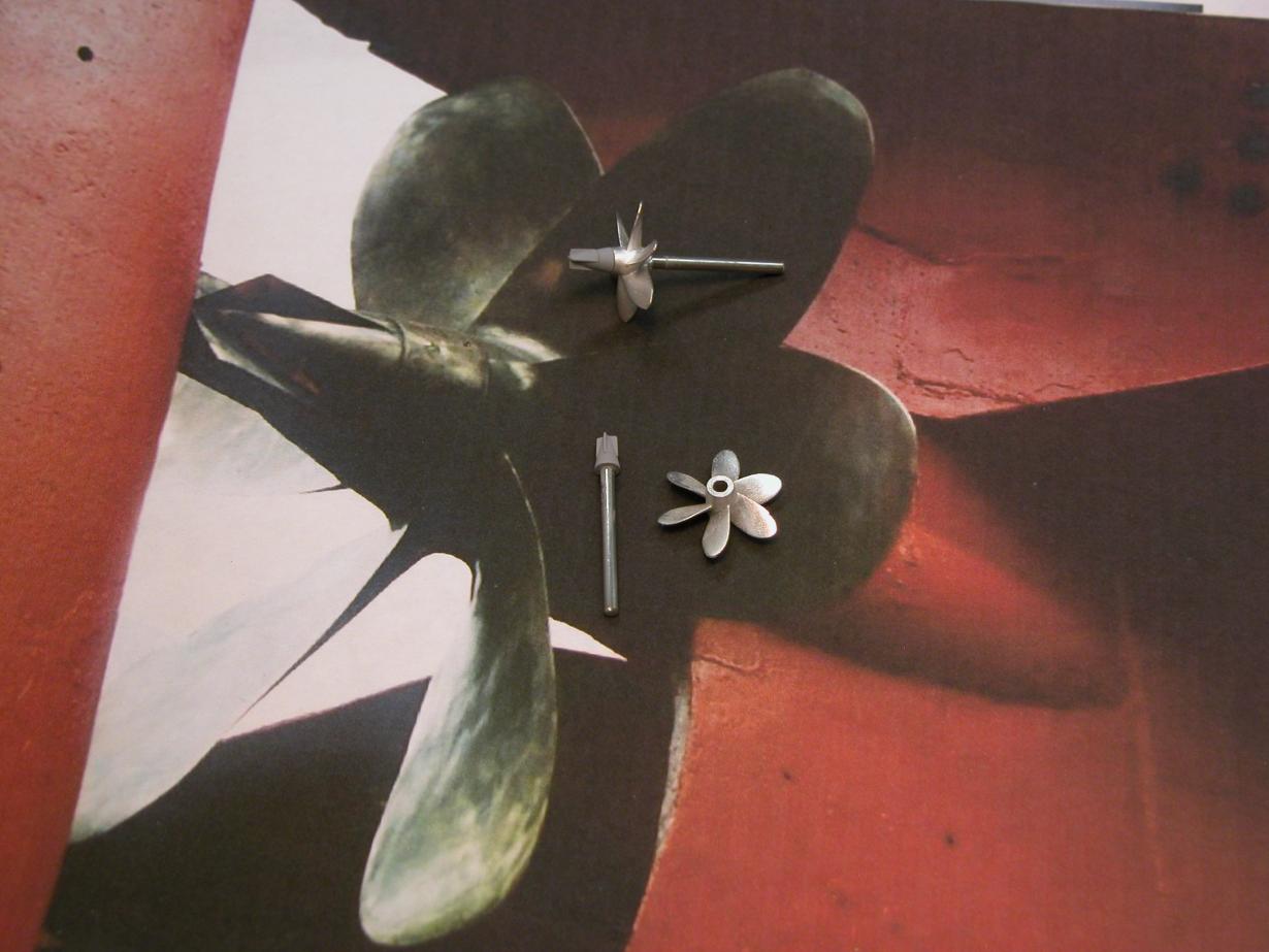

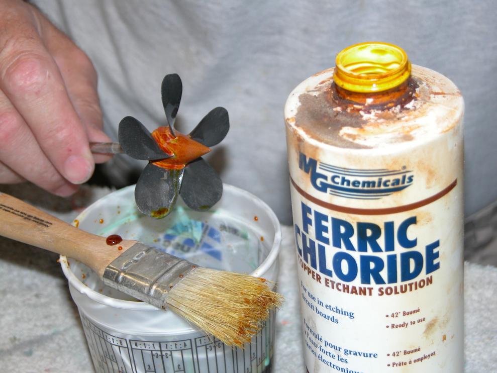

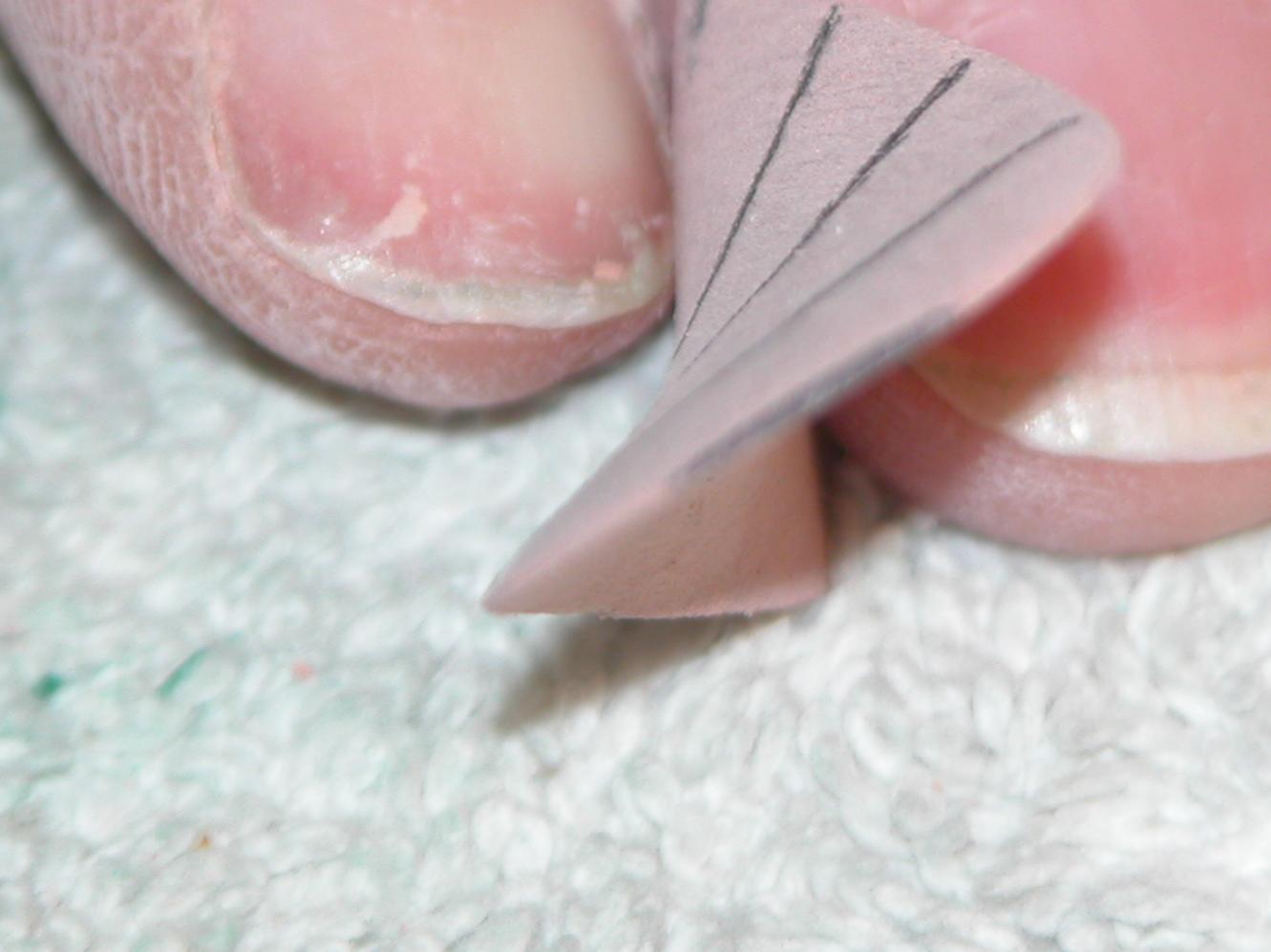

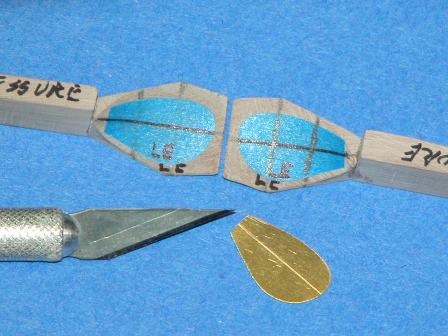

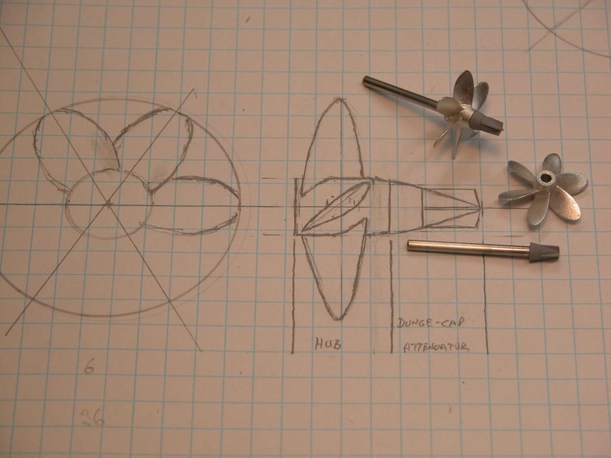

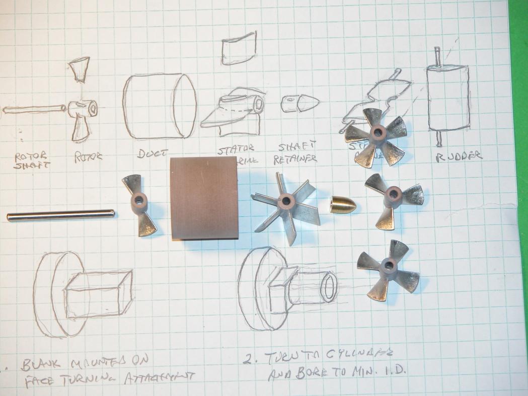

              Hello Dave,
              this is thread has been great but it seems to have run out of steam. Yes I know I'm the one asking for HWSNBN to do all the work posting, however I would still love to see heaps more pics of the build process. Even if they're not annotated, just dump heaps of pics and we can make our own conclusions.

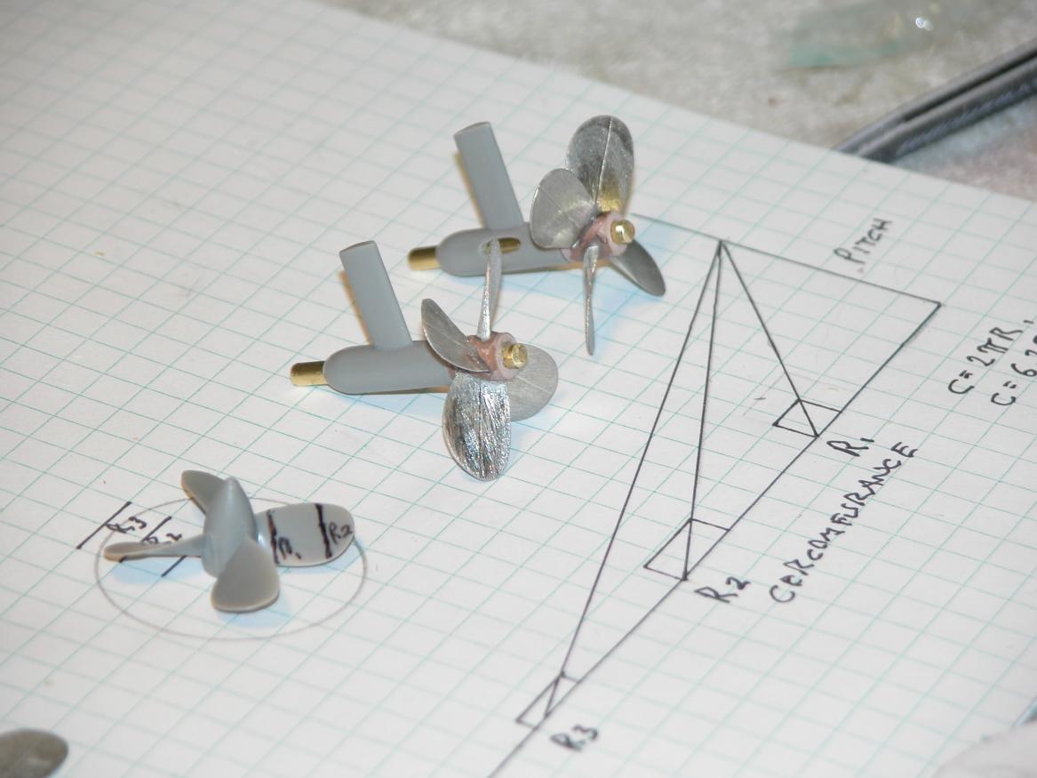

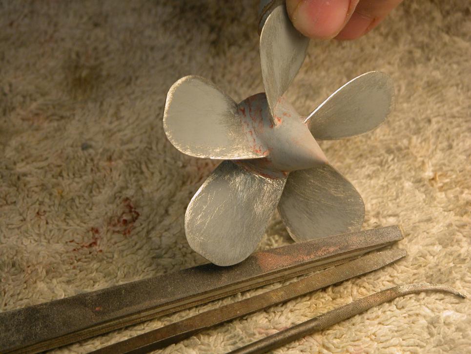

              On a slightly different topic I would love to see some pics of propeller making with silicon moulds. I would love to learn the whole process.
              thanks for putting up what you have so far put up, dave
              dave h

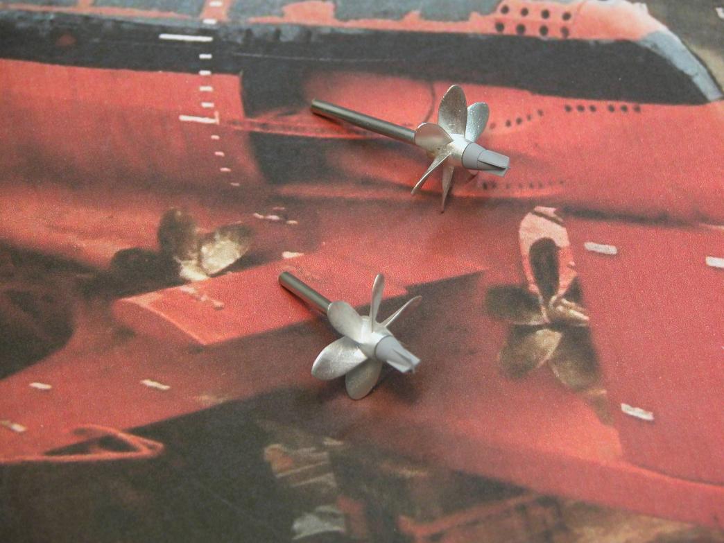

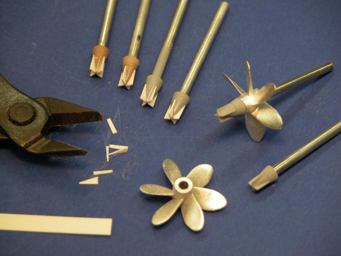

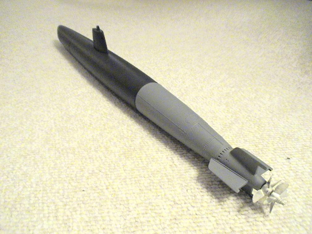

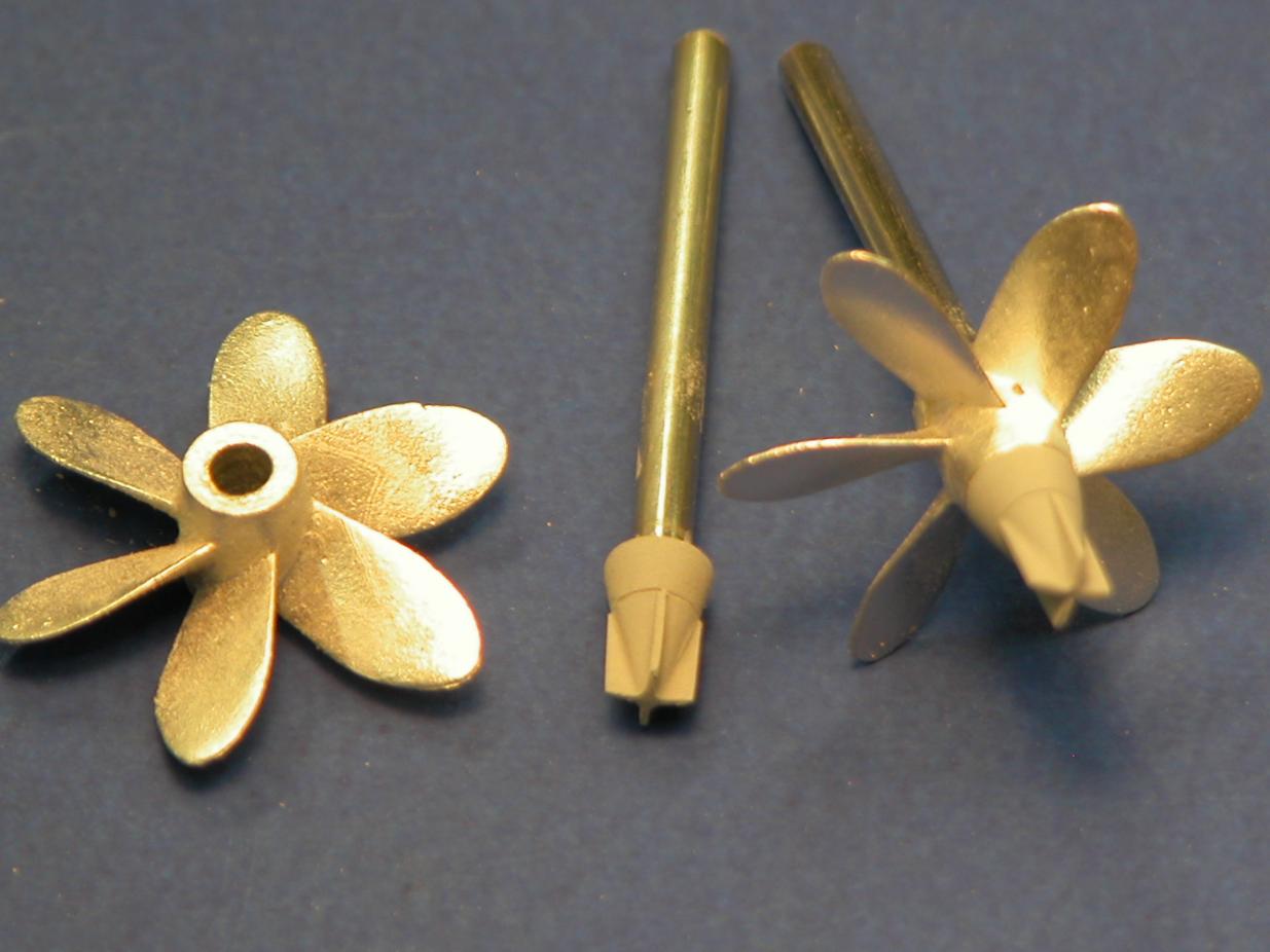

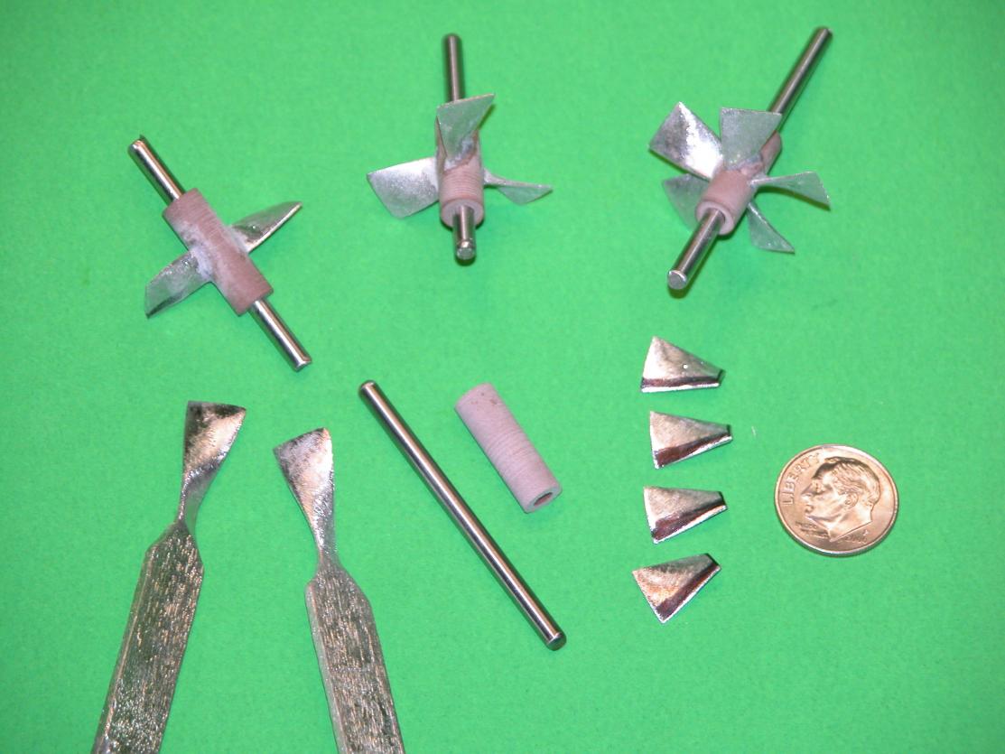

                1/72 FOXTROT propellers Click image for larger version
ID:	97477 Click image for larger version
ID:	97478 Click image for larger version
ID:	97479 Click image for larger version
ID:	97480 Click image for larger version
ID:	97481 Click image for larger version
ID:	97482 Click image for larger version
ID:	97483 Click image for larger version
ID:	97484 Click image for larger version
ID:	97485 Click image for larger version

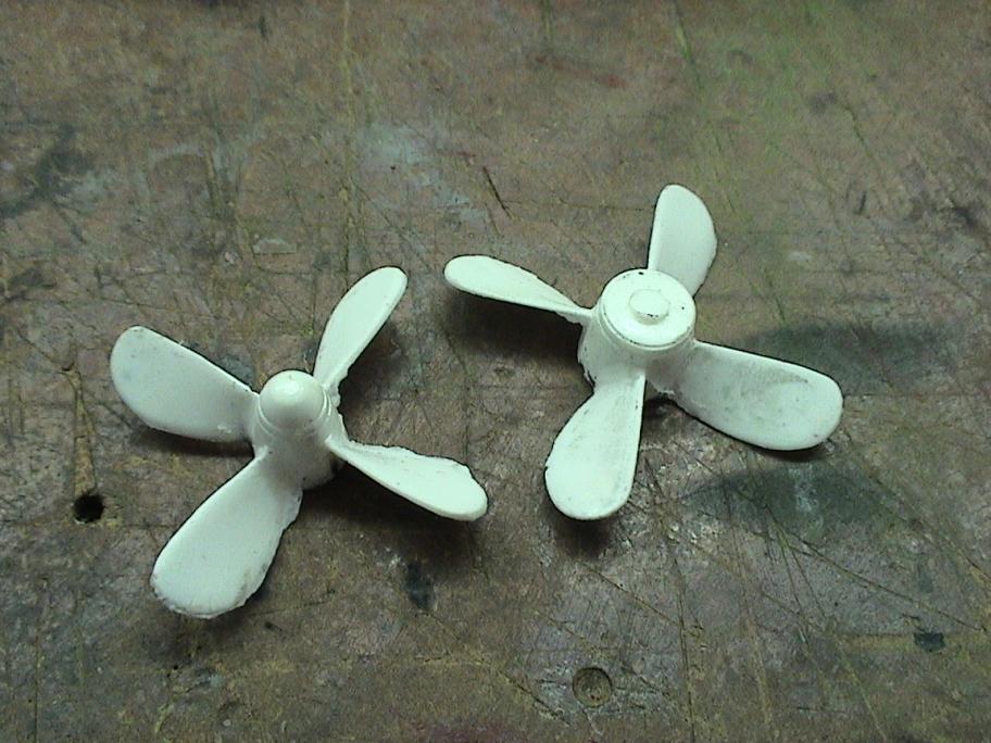

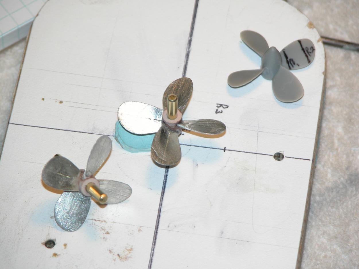

                1/72 GATO propellers Click image for larger version
ID:	97487 Click image for larger version
ID:	97488 Click image for larger version
ID:	97489 Click image for larger version
ID:	97490 Click image for larger version
ID:	97491 Click image for larger version
ID:	97492 Click image for larger version
ID:	97493 Click image for larger version
ID:	97494 Click image for larger version
ID:	97495 Click image for larger version
                1/72 SKIPJACK propeller Click image for larger version
ID:	97497 Click image for larger version
ID:	97498Click image for larger version
ID:	97499 Click image for larger version
ID:	97500 Click image for larger version
ID:	97501 Click image for larger version
ID:	97502 Click image for larger version
ID:	97503 Click image for larger version
ID:	97504 Click image for larger version
ID:	97505 Click image for larger version
ID:	97506 Click image for larger version
ID:	97507 Click image for larger version
ID:	97508 Click image for larger version
ID:	97509 Click image for larger version
ID:	97510 Click image for larger version

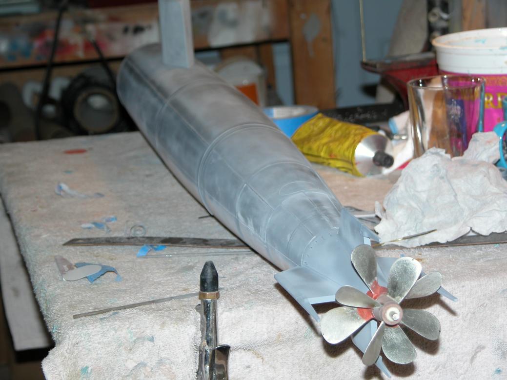

                  • 13998

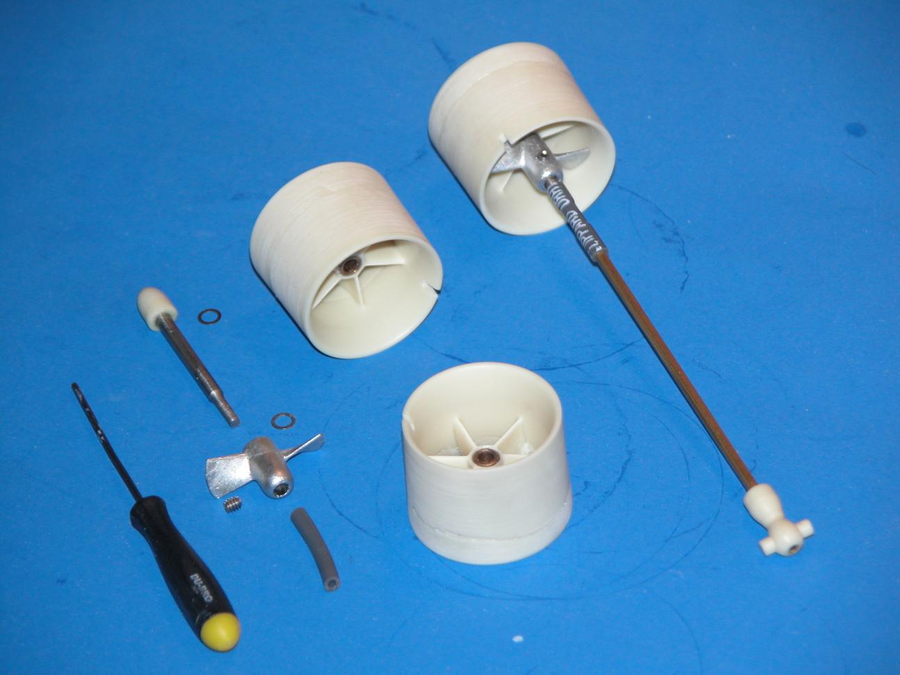

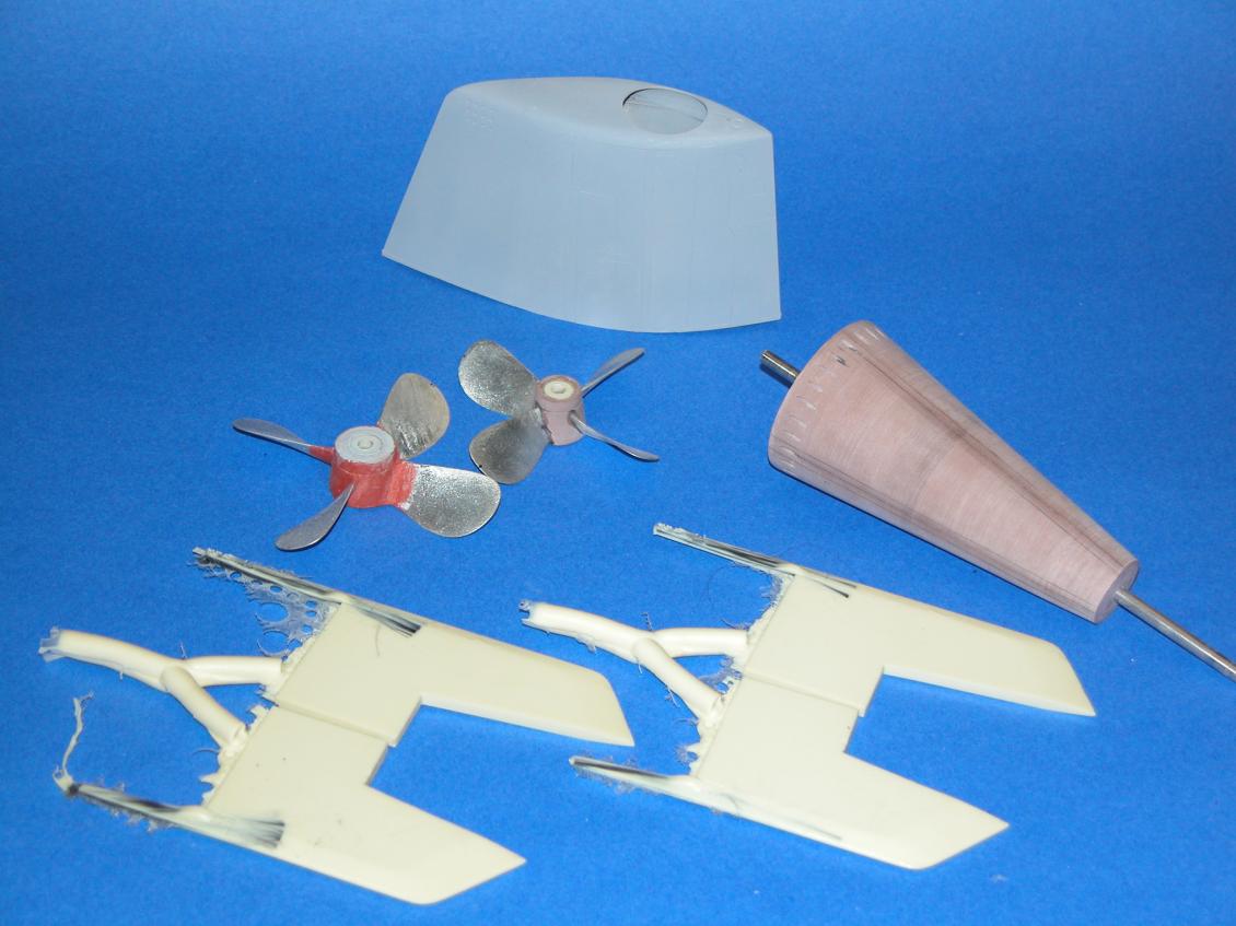

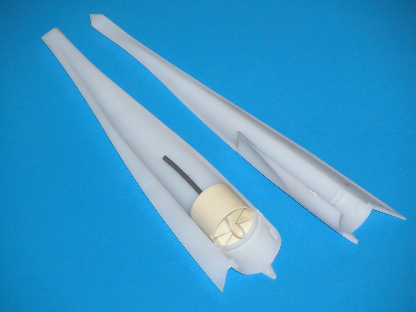

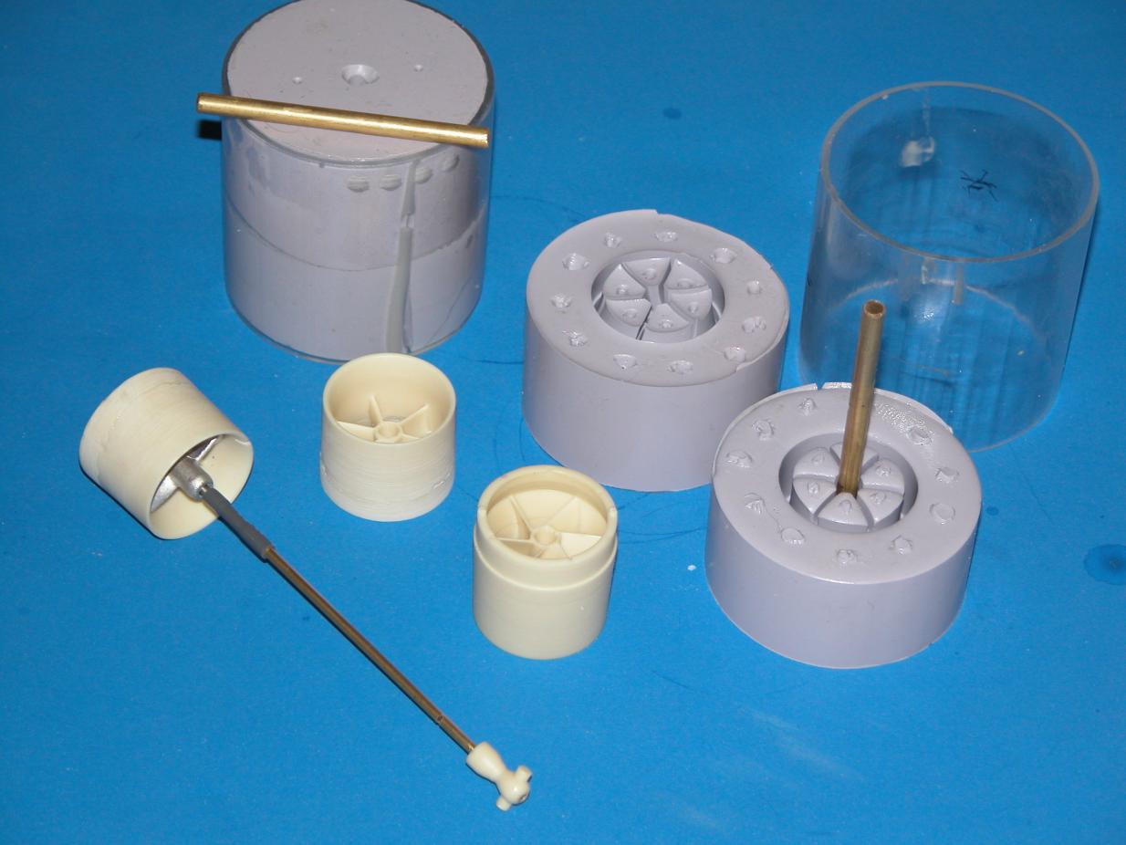

                  Moebius SEAVIEW pump-jet Click image for larger version
ID:	97512 Click image for larger version
ID:	97513 Click image for larger version
ID:	97514 Click image for larger version
ID:	97515 Click image for larger version
ID:	97516 Click image for larger version
ID:	97517 Click image for larger version
ID:	97518 Click image for larger version
ID:	97519 Click image for larger version
ID:	97520 Click image for larger version
ID:	97521 Click image for larger version

                    I don't mind posting stuff. But I do mind wasting my time. I'll post when you state a NEED. You want something? Say so! And I will produce.
                    You don't squeeze the tit, you don't get the milk.

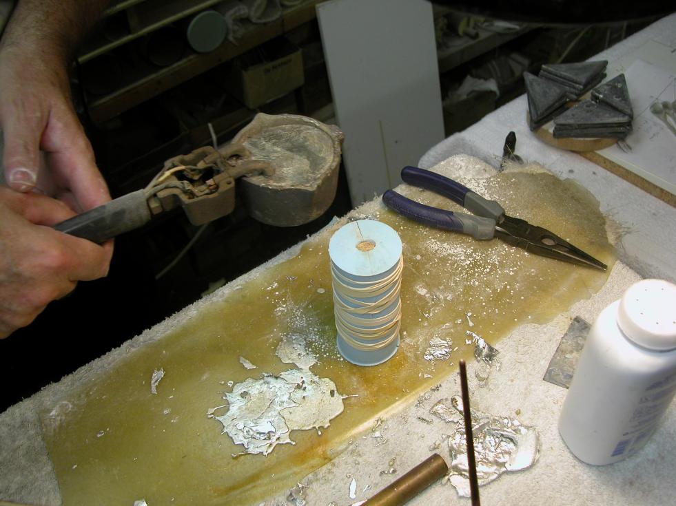

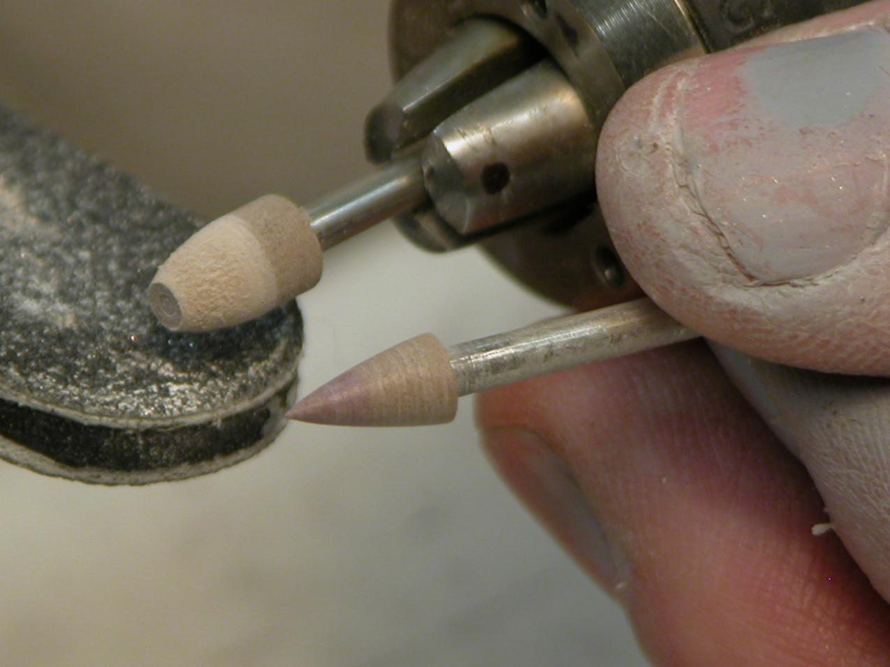

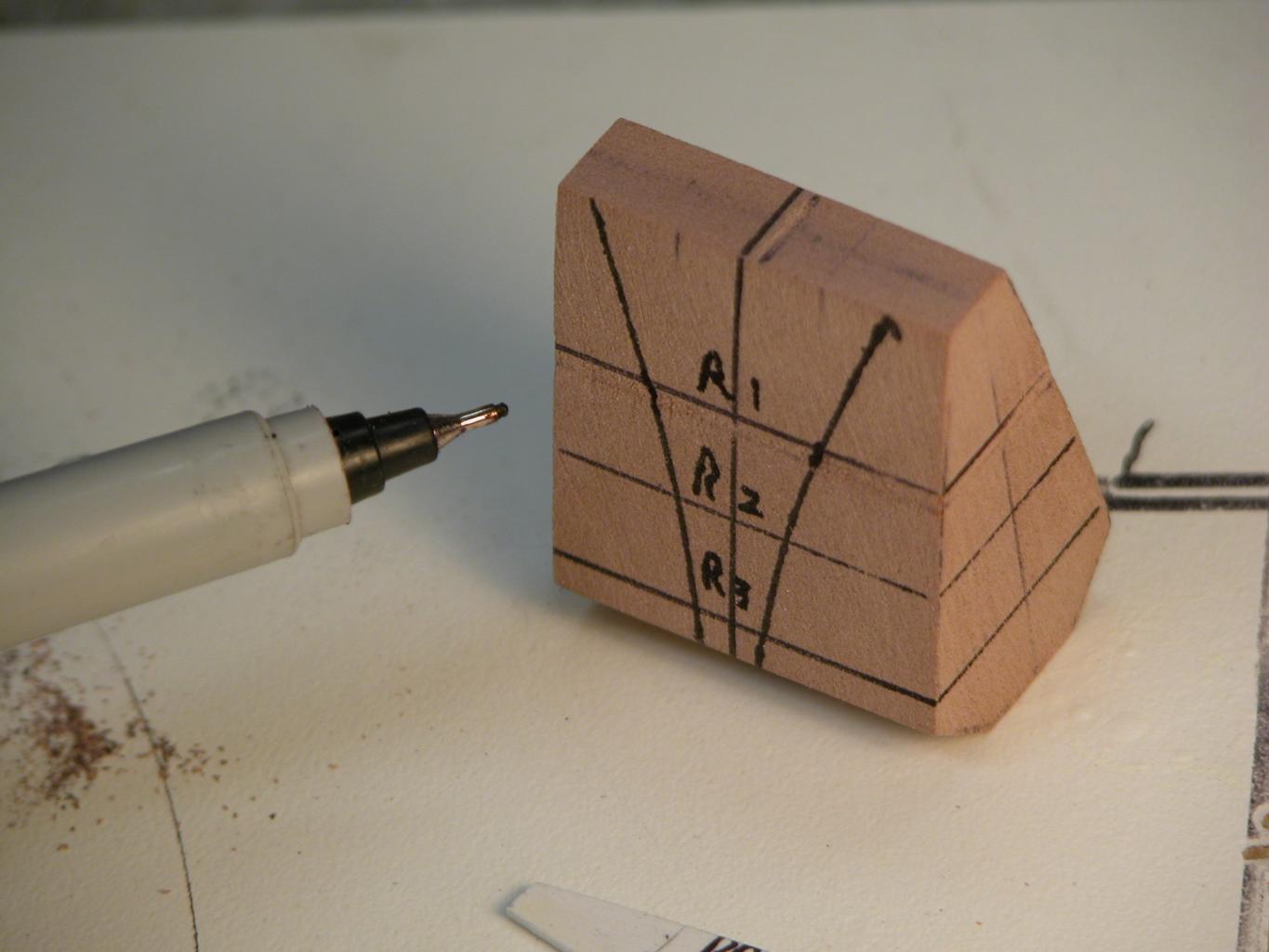

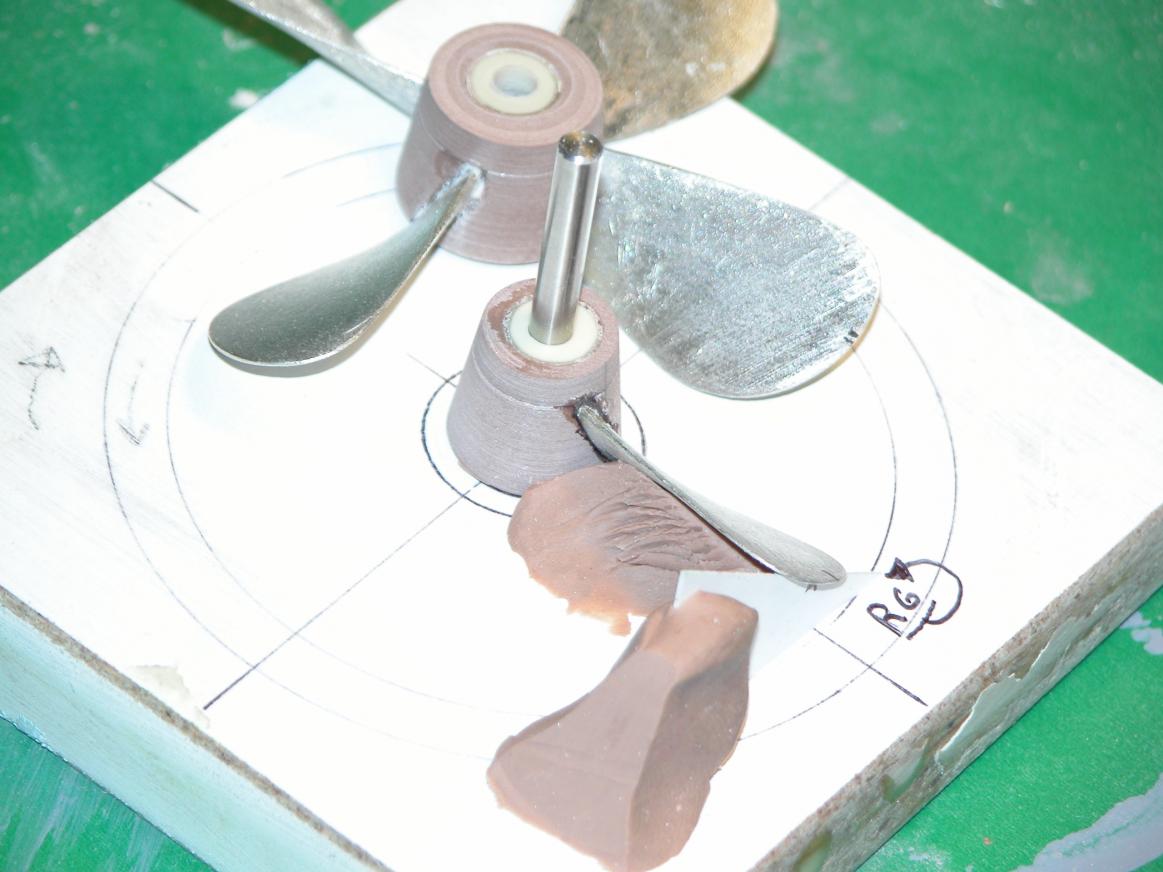

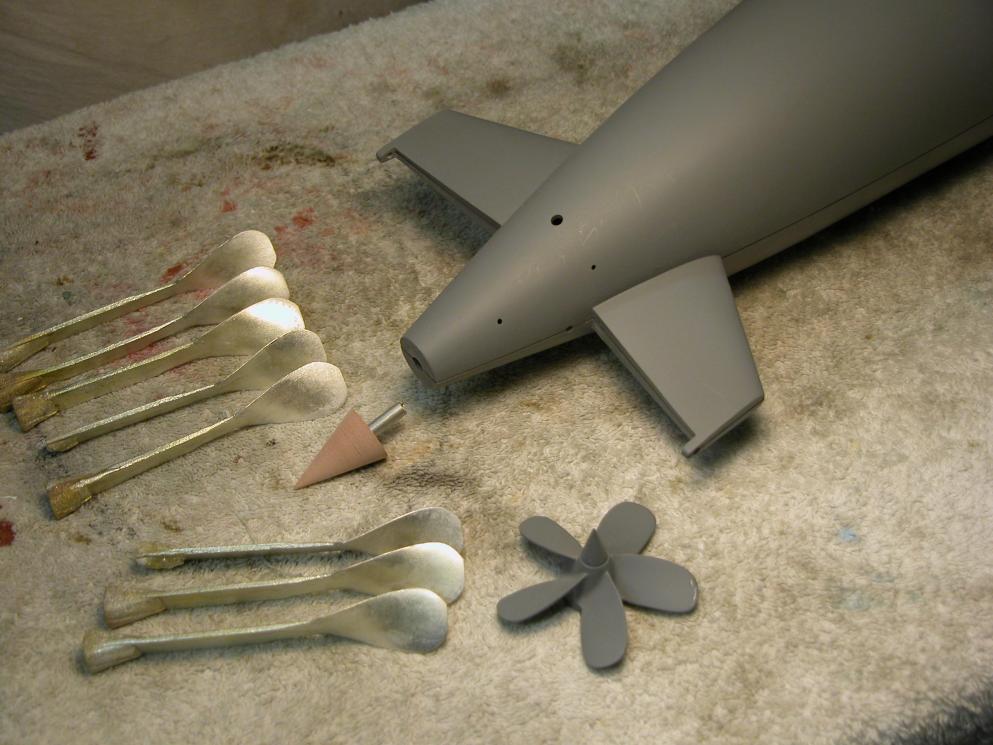

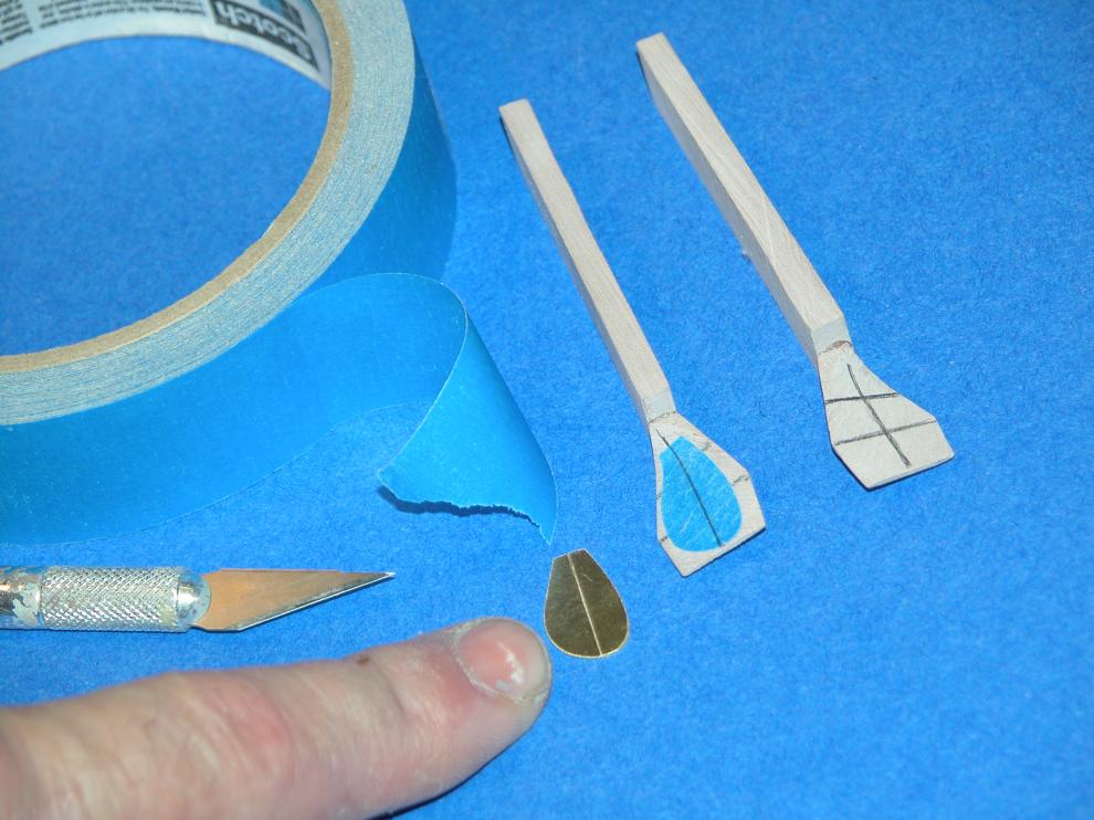

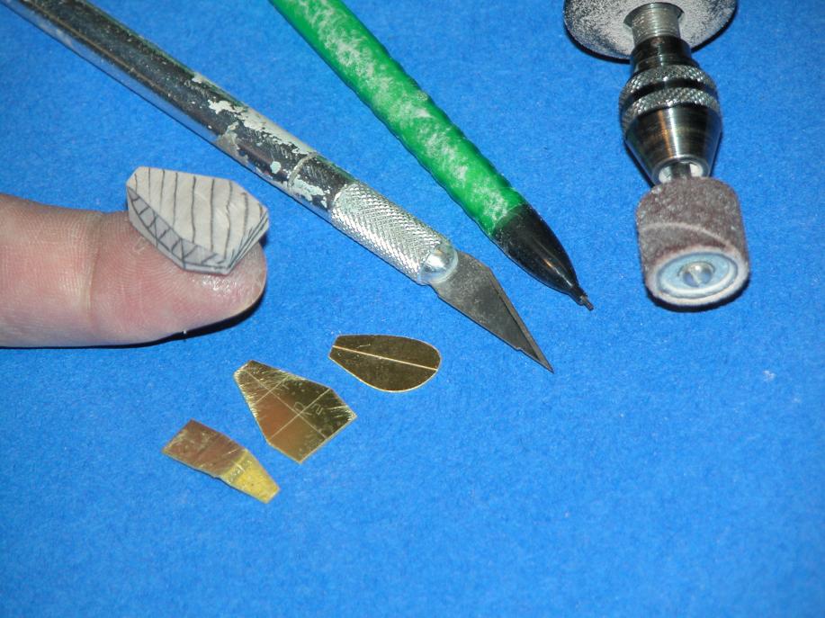

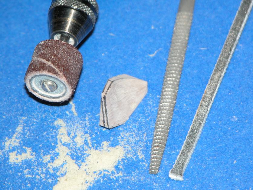

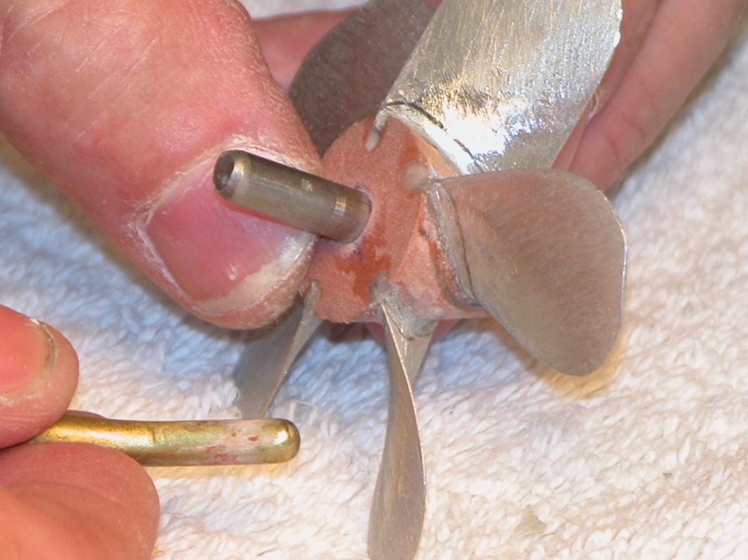

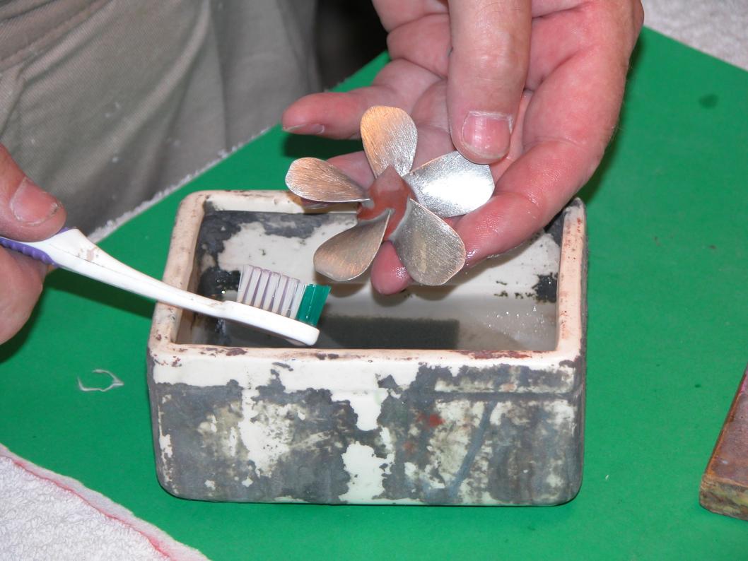

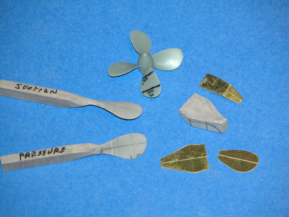

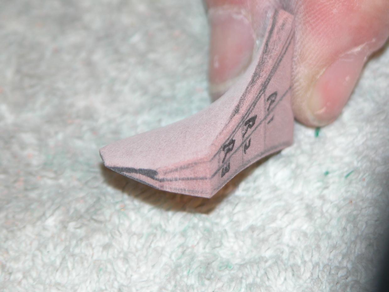

                      The prop making process for that model woud be a nice thing to learn, for sure, but if the mold is still available, perhps, already made would be available. That would be Genes Ko Hyo Teki, I am referring to. Did he get the pitch specs off the New London boat for his props.
                        • 13998
ID:	97528 Click image for larger version
ID:	97529 Click image for larger version
ID:	97530 Click image for larger version
ID:	97531 Click image for larger version
ID:	97532 Click image for larger version
ID:	97533 Click image for larger version
ID:	97534 Click image for larger version
ID:	97535 Click image for larger version
ID:	97536 Click image for larger version

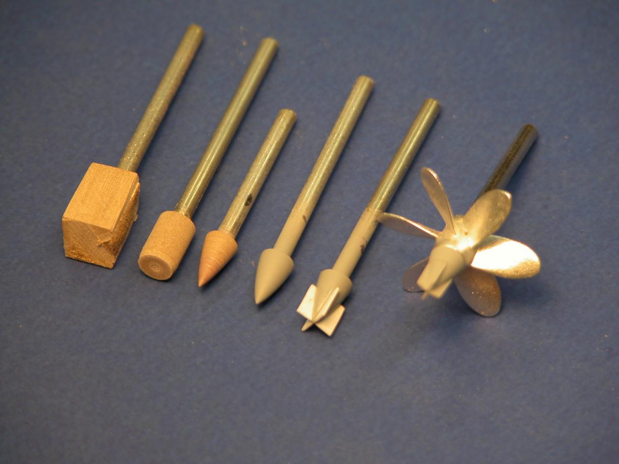

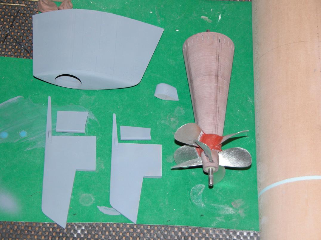

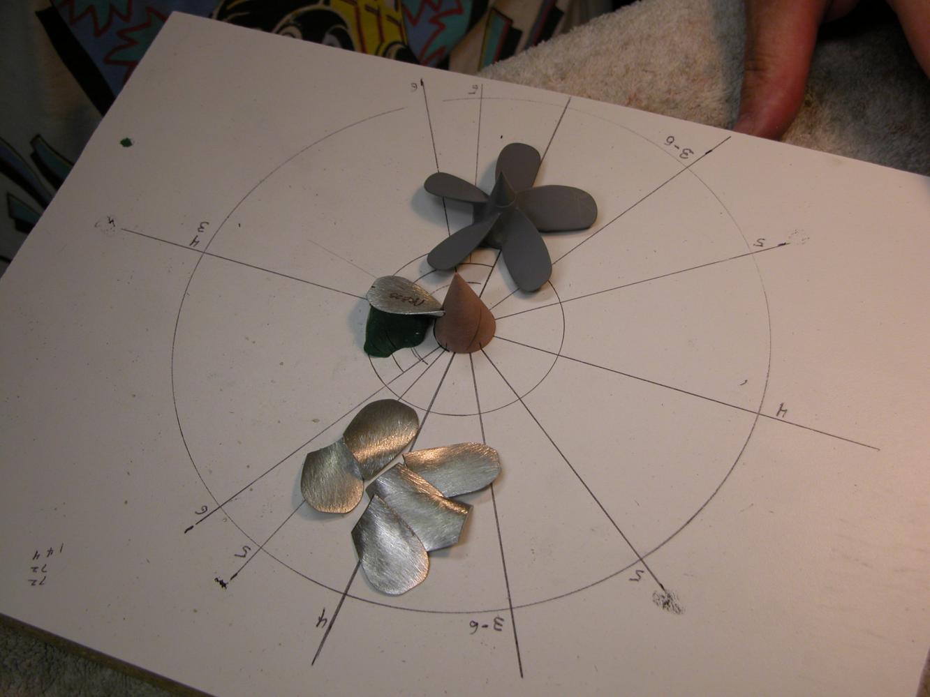

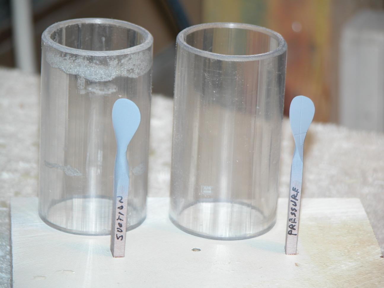

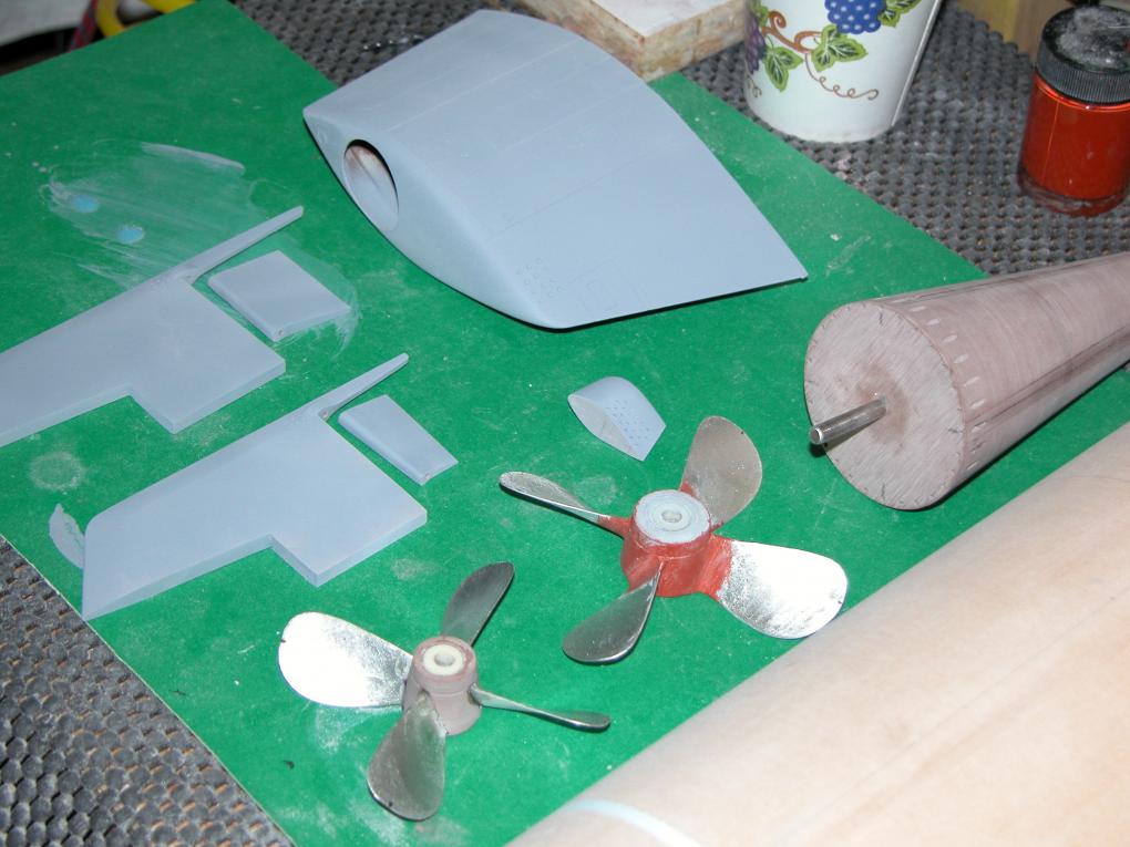

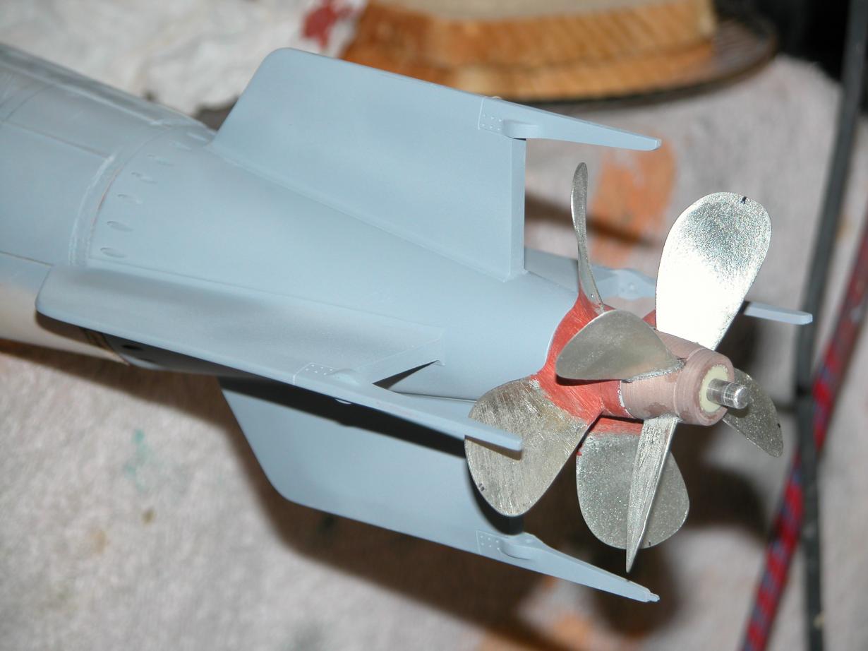

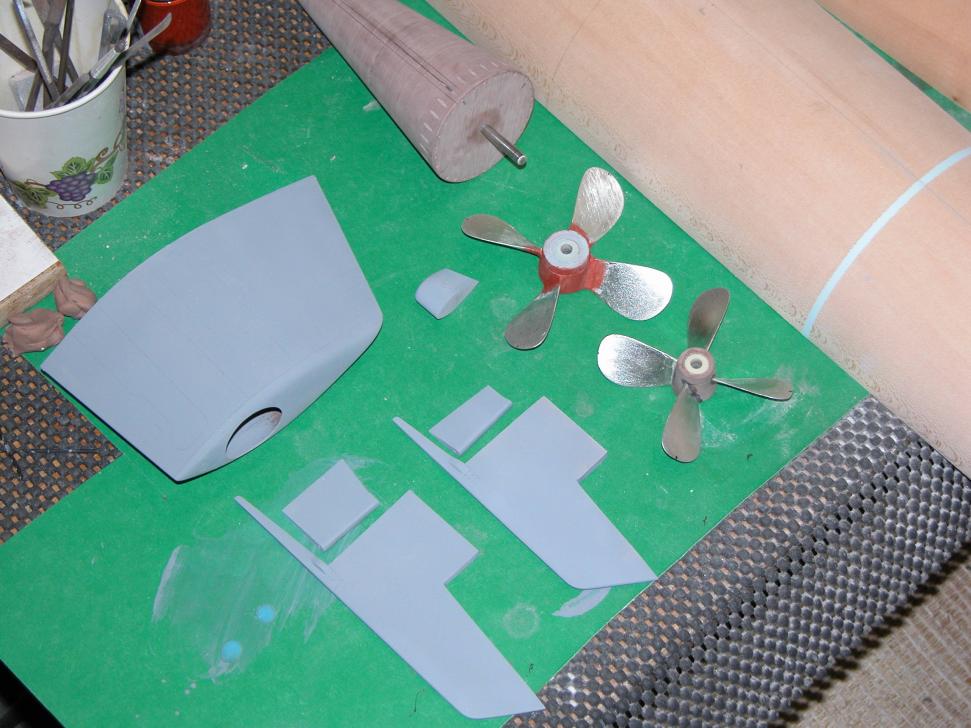

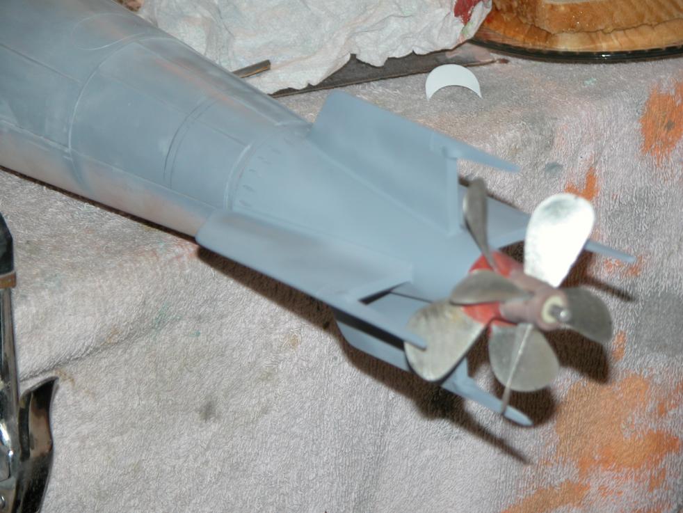

ID:	97537 I got as far as building the two propeller masters, no production tools put together yet, Dave.
                        Yes, Gene was ALL OVER those wheels while we were at the NAUTILUS museum display of that craft.
                          Oh ... hell! I showed off Adam's 1/16th Type-A propeller work, not Gene's as you requested.

                            • 1655
                            Damned Tease!!!,suck, suck, more,suck,suck, more!!!!!!!!!!!!!!!!

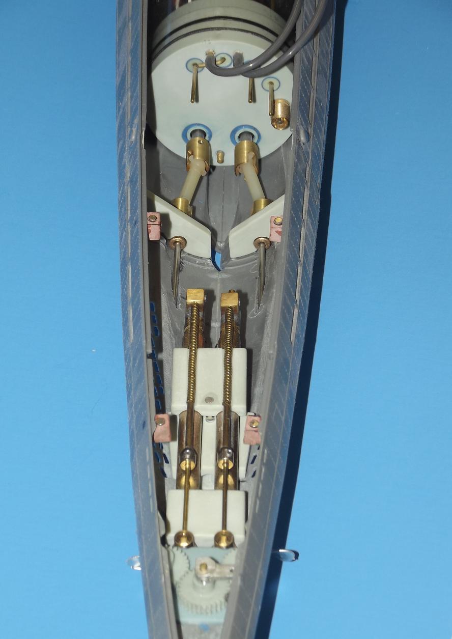

                            Gene, did a excellent job on that sub, have to suck his brains about the counter-rotating box

                              Ha! Now, there's a complement: Manfred asking me for some pointers. I'll try to be worthy of the request. What, specifically, do you want to see, pal?

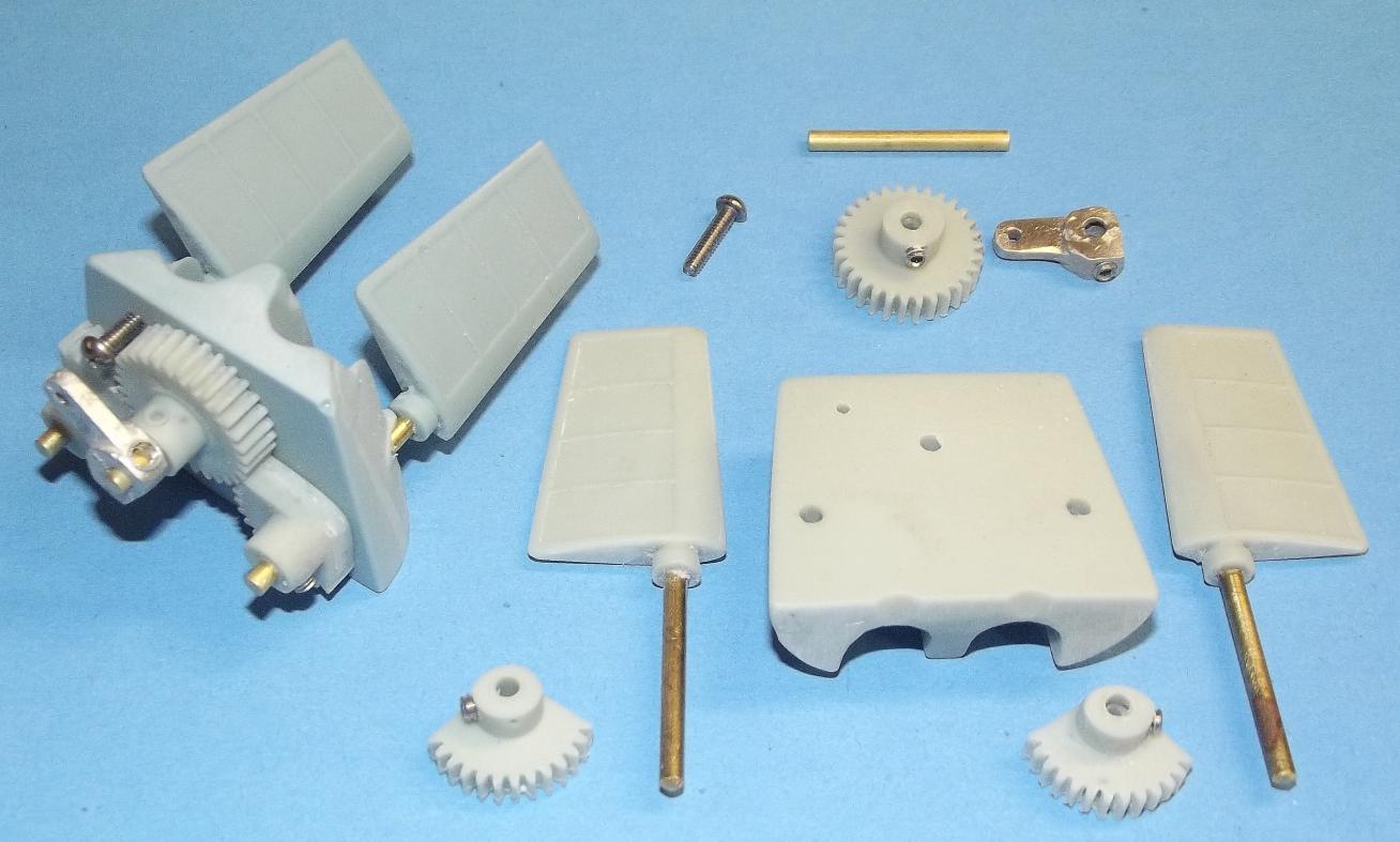

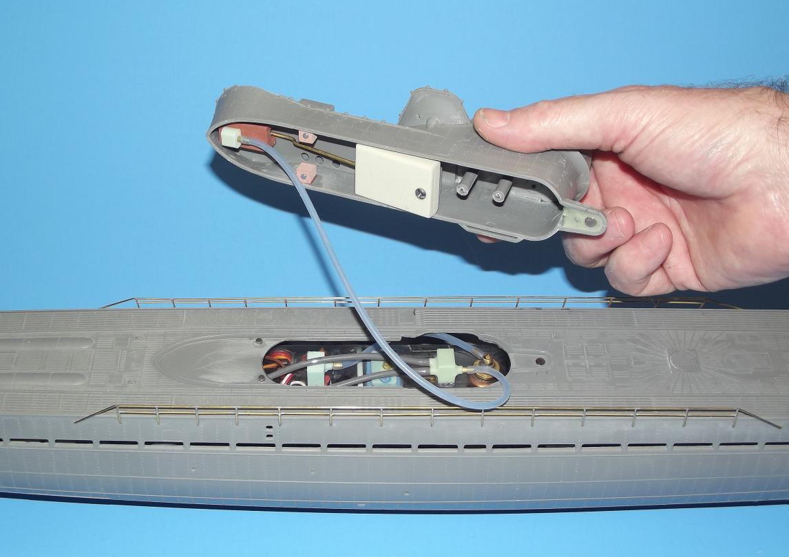

                                I try to keep it japanese, otherwise this thread will be fauled with other stuff.

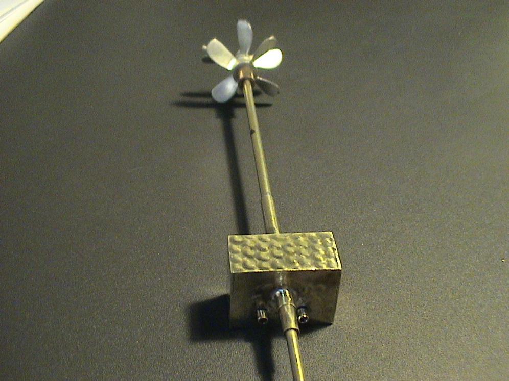

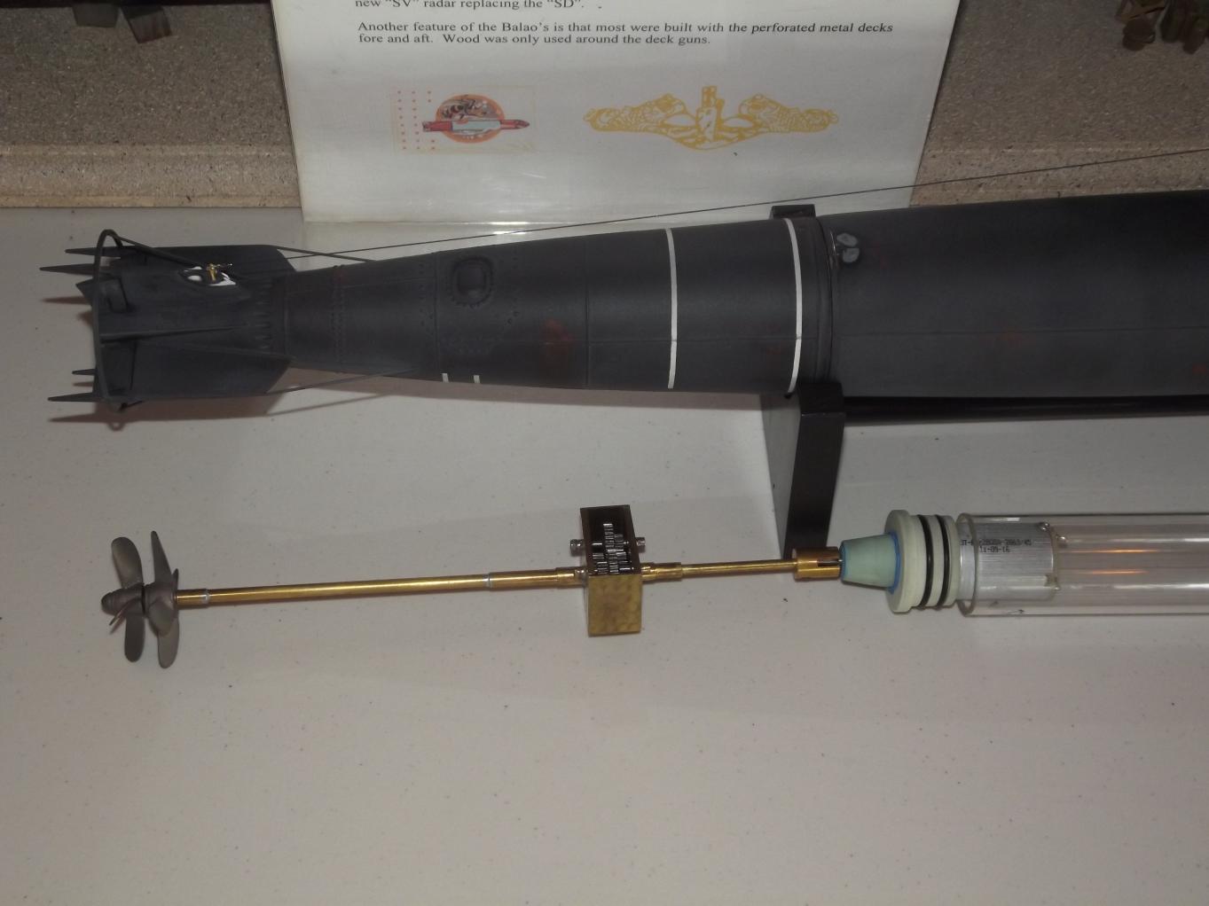

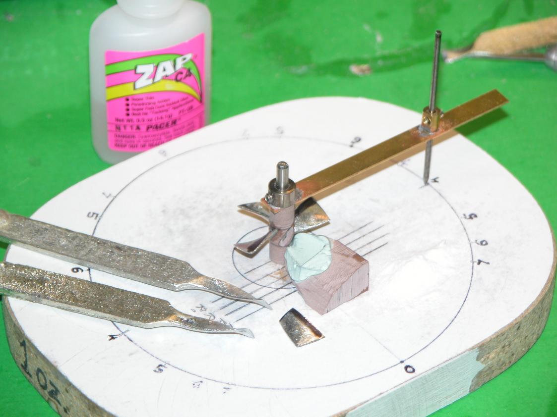

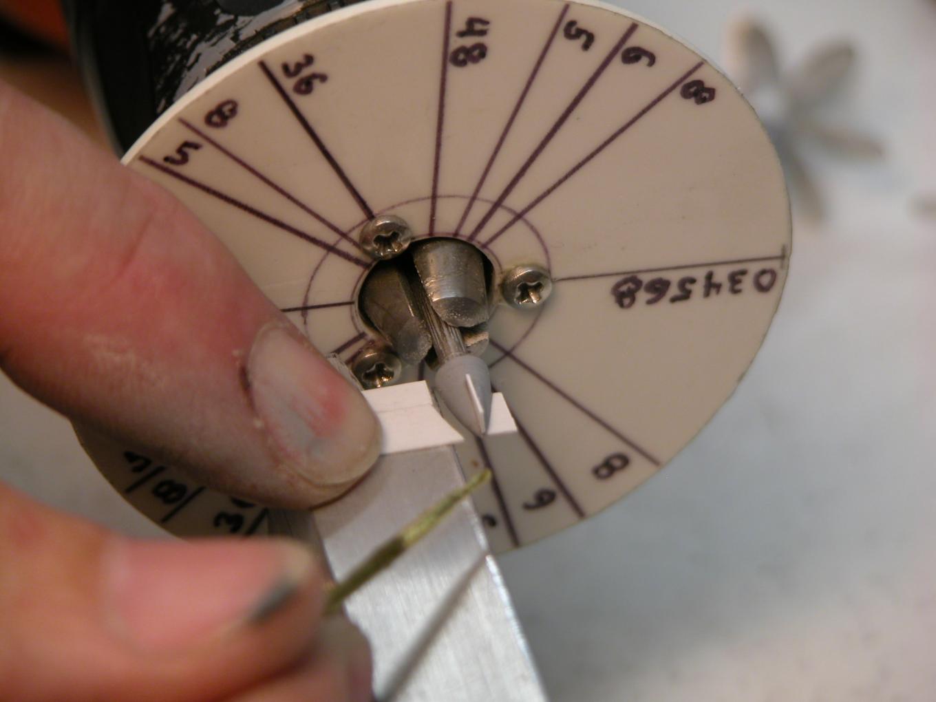

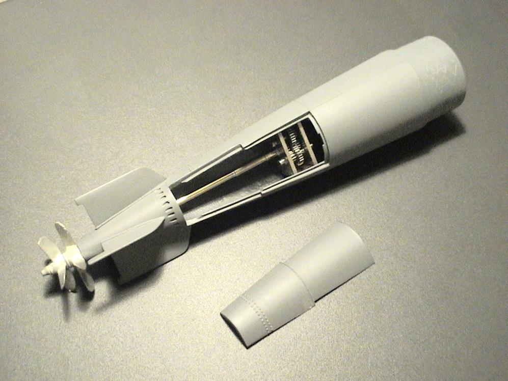

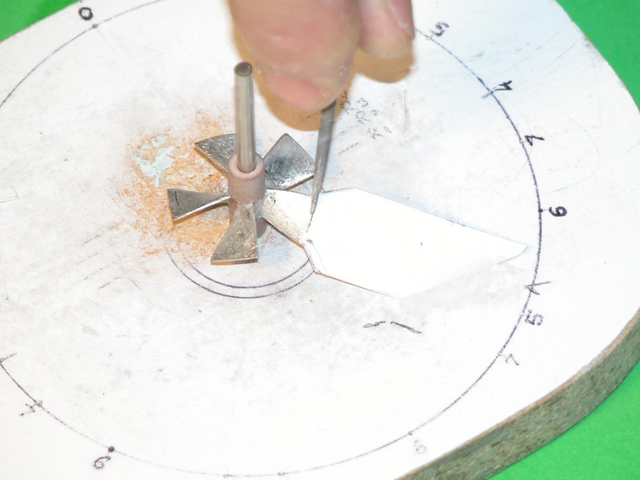

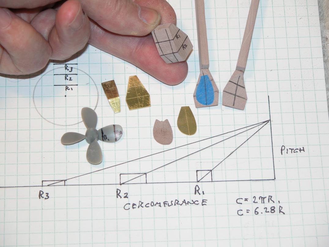

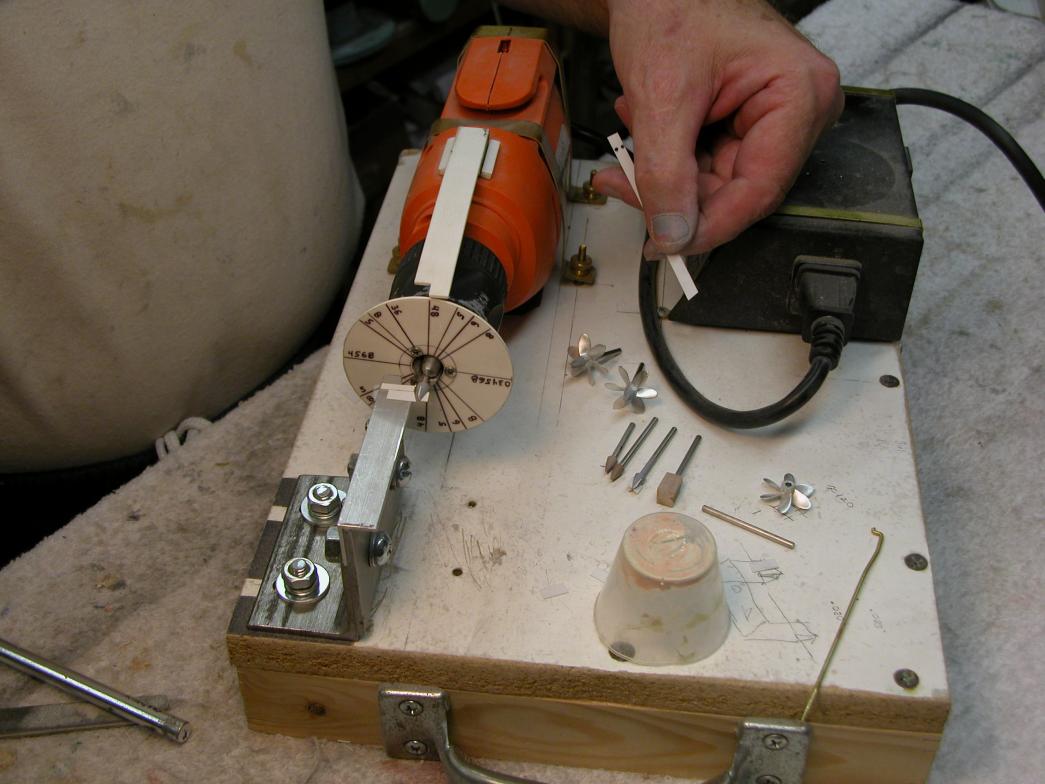

                                Some more detailed pics about Gene's propellorspinning wonderbox used on his sub, got to know!!!

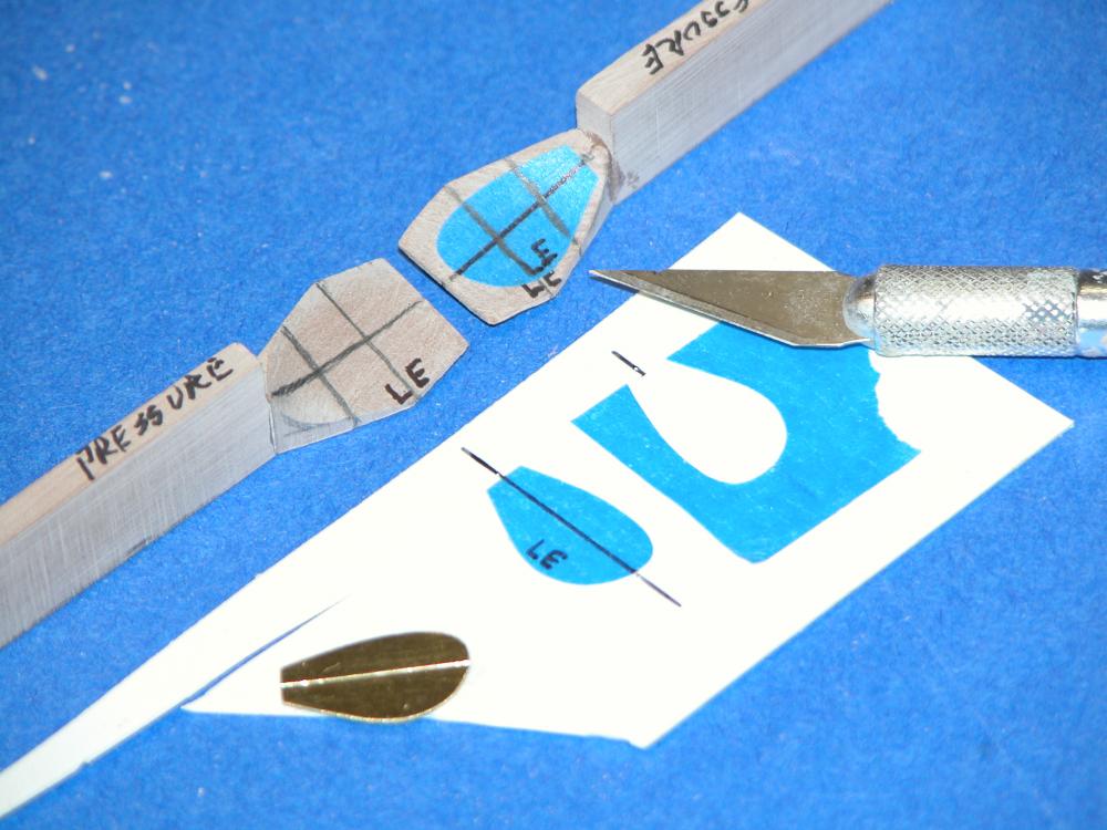

                                How exactly do you determen the shape of the propellorblades, i mean the angle and the curve?

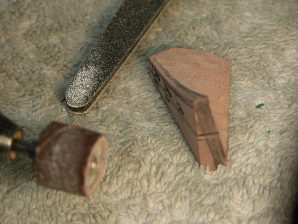

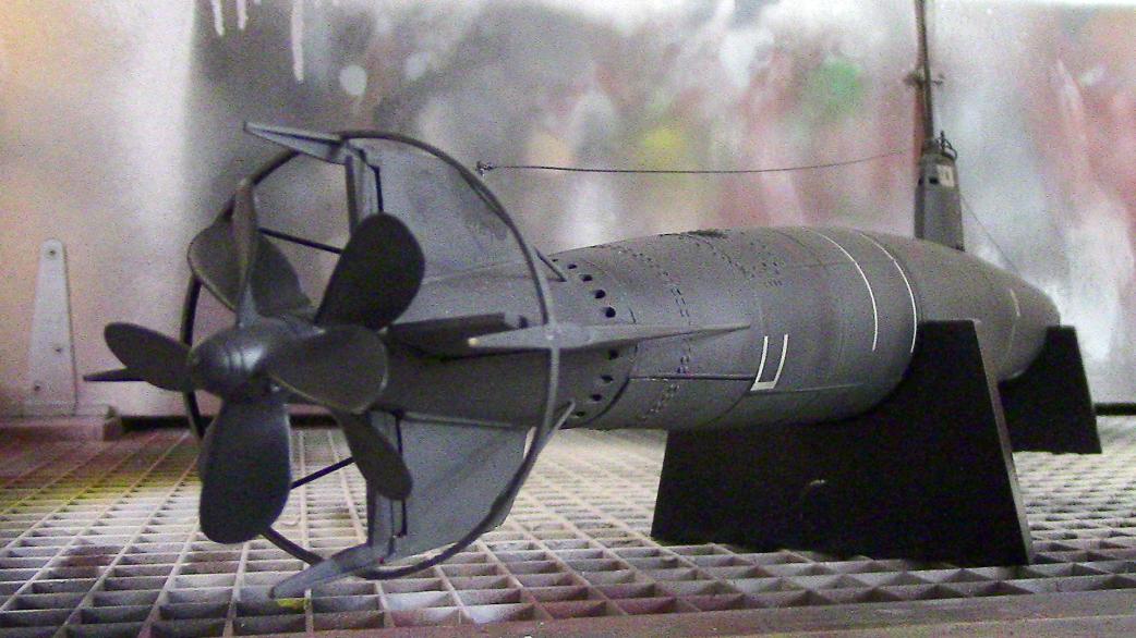

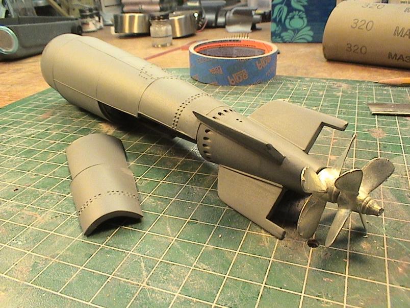

                                And more pics about the tower of the japanese sub (you know why), wether Original from real live or models, i don't mind, the more the better.
