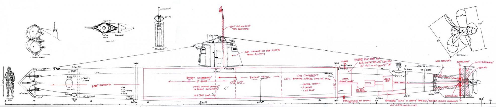

          George. There are no plans, so to speek. The drawings, are just drawings with a 1 foot scale line below. If you want a particular scale, you have to do the math and have the picture enlarged to suit your application. I used this and blew it up with all the original notes included as a plan sheet. As for actual detatils you have to interpilate from your photo searching. My self, have been researching this particular boat H-19 since 1962, and theres still stuff I'm learning about it.Click image for larger version

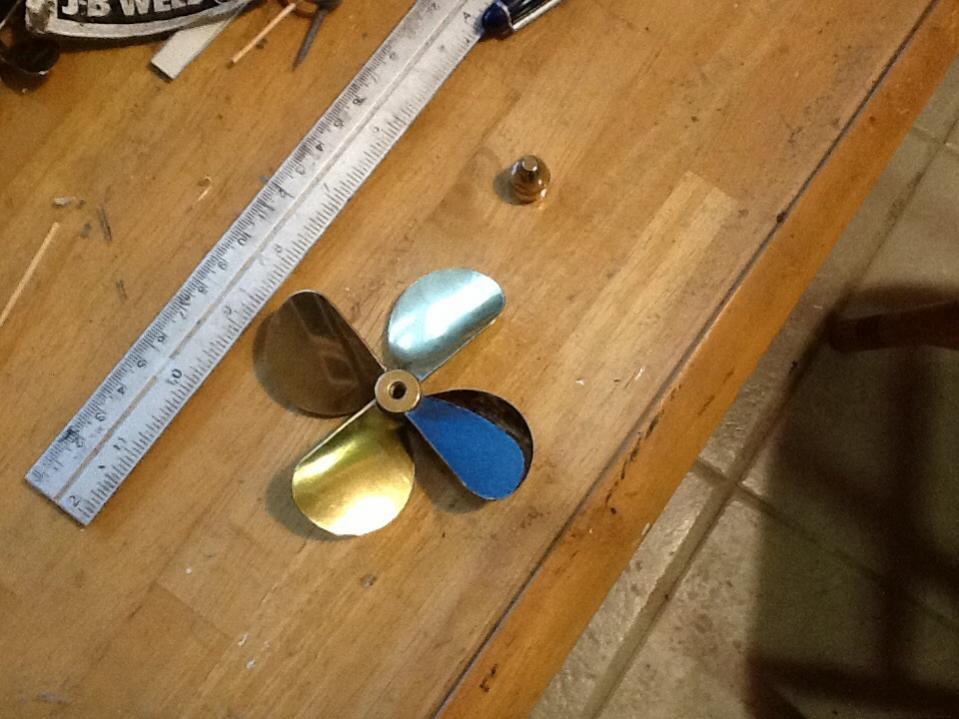

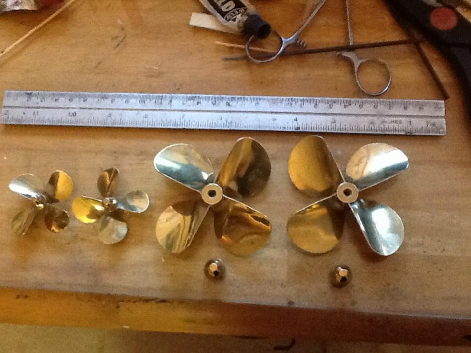

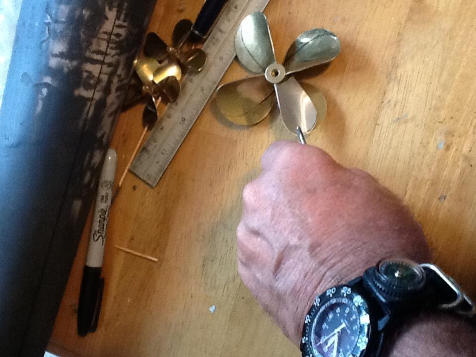

            Havent been paying much attention to this project for a week or so. Some more props came in the mail that I had ordered awhile ago. Before I had even setteled on the scale. I just made a quick guess for the 1/24th and ordered a set of Raboesch 25mm 4 blade counter rotation from Westbourne models in GB. Shortly after I ordered a pair of 90mm Rivabo for the 1/16th scale. They both are beautiful, but I cant use them. I just re ordered some 75mm, that I will use on the 1/19th scale that it turned out to be.Click image for larger version

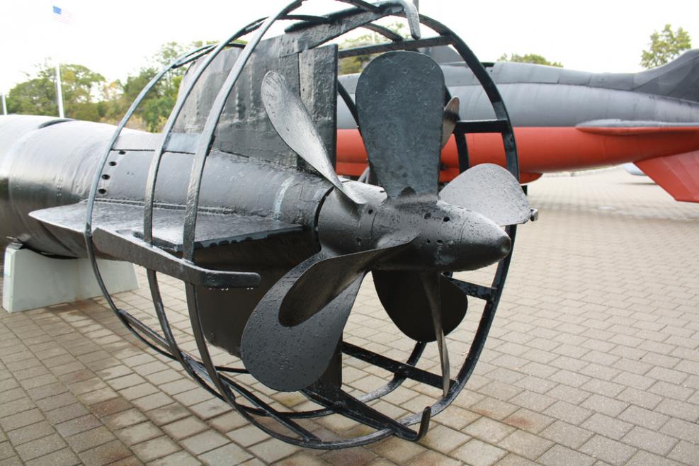

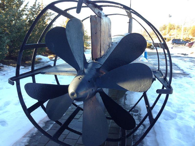

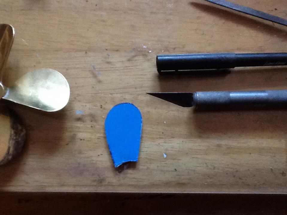

              Since, whatever size props I get they will still have to be trimmed to represent the actual ones, because I am using tug boat or utility props. The pitch is about the same but the bite overlaps when installed in line. I used a photo of the ha 18 an held the corrisponding prop in front and used a marker to draw the contour outline and shaded in the metal to be removed. Then masking tape to transfer to an aluminium template to mark the other blades uniformly. Same procedure using the reverse side of the template to mark the counter prop.Click image for larger version
ID:	98361Click image for larger version
Name:	Ha8 props and cage.jpg
ID:	98362Click image for larger version
Name:	Ha8 props.jpg
ID:	98363basiclly some of the blade face has to be removed from tip to root. and about mm of tip to conform to the clearance of the cage. Ill end up with an 80mm prop from the 90.Ballancing the final trim is not so dificult they are low rpm to start with and not as tempromental as race props which I have some experience with in, full scale boats. They are going to have some beafy shafts but I will fill the OEM 5mm threaded shaft holes and re drill new sized holes individually. Just picked up a big Chicago drill press, so now I can play around with stuff like that better with more precission. Dont know where I will set it up yet, but I will find the room.Click image for larger version
