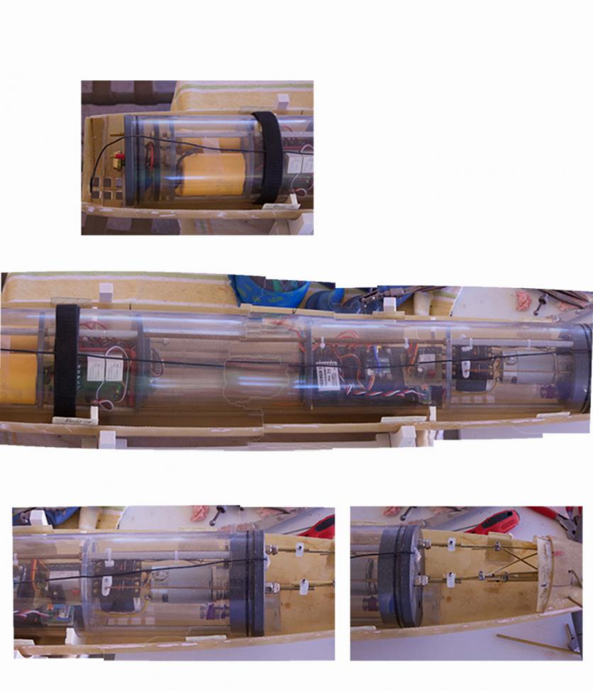

              It was time to prepare some subs for SubFest and I thought the easiest one to work on is my Thunder Tiger Neptune SB-1. It is a fun sub. My batteries would charge, but not seem to hold a charge for long. Well heck, that needs to be replaced. I also needed to add some additional weight from the time when I did change out from lead acid to NiMh. So, this is the time to make adjustments. In removing the sides, there were a lot of cracks in the cylinder.

              OK, so that needs to be replaced. I texted with David Ruiz about the cylinder and he pointed me in the right direction. The cylinder is 120mm ID and 130mm OD length is about 357mm. I also noted that the cylinder was glued in with (I thought) a silicon rubber. I asked David about the gasket or o-rings used. He said the later models had an o-ring and not the gasket mine or most SB-1 used. Since those gaskets were of course no longer made, I am working to see what size o-ring I need.

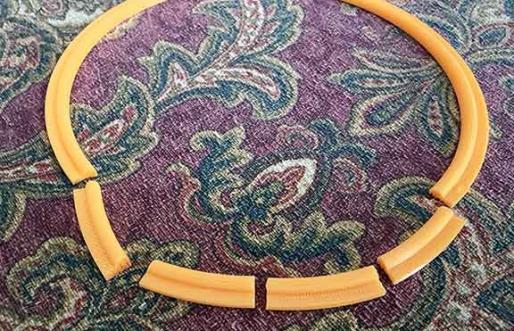

              It turns out that it is not silicon that was used, more likely a hot glue of some type. What a pain to get the cylinder off the end pieces. I destroyed the existing gasket, but took measurements and I had a thought. After drawing it up, I 3D printed new ones in TPU. TPU is said to have great properties for resisting oils and petroleum products.

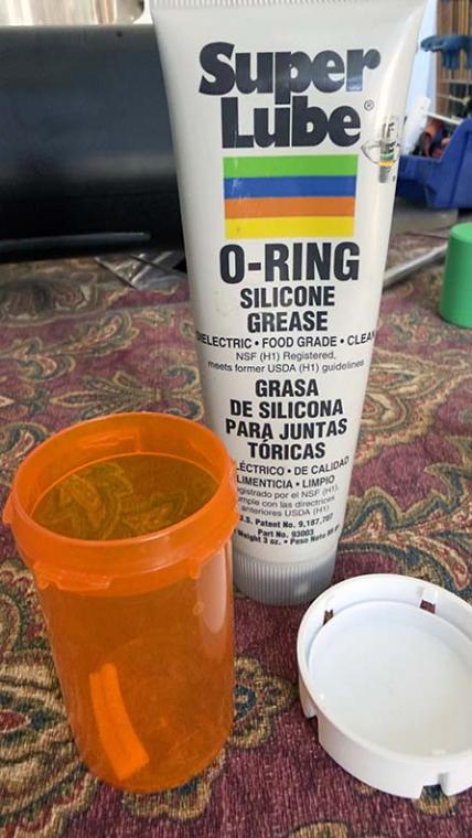

                    A spare gasket was cut up for testing.

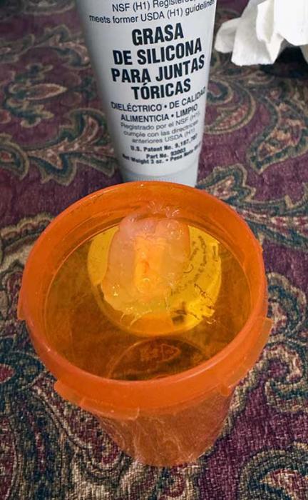

                    Then put one in silicon grease.
ID:	195833 Click image for larger version
                    It looks like an alien egg sack on the side of the pill container. It is completely covered.

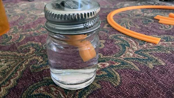

                    Then as a for interest, I put another piece in water.
