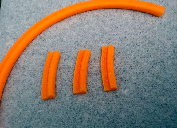

                  It is time to see what effect water, silicone, and Vaseline has on TPU.
                  I compared to the original each of the pieces. It is hard to measure TPU because it gives, so I did the best I could. Is there room for error sure, but you do the test to verify.
                  Water - Started test on 06/19 and finished today (07/12) so about 3 weeks.
                  I saw 0 change - I measured the original piece to this one and not a bit of swelling. Flex was the same and surface feel was the same too. Original was 2.05 mm and this measured the same.
                  O.K. let’s move to silicon.
                  Silicon - Started test on 06/19 and finished today (07/12). Also about 3 weeks.
                  After wiping all the silicon off it appears it is the same as the original, if any swelling occurred it was .01 mm (2.06 mm). That is in the margin of error I think. The physical properties seemed to remain, the flex, squishiness, and surface feel. Impressed.
                  Vaseline - Started test on 06/21 and finished today (07/12). A little short of 3 weeks.
                  Wiped off the vaseline and measured. This did show a slight expansion or swelling, about .03 mm (2.08 mm). Still in the overall scheme of things minimal. No change in physical properties from the non-scientific lab tests.
                  With that, I feel safe using silicon or vaseline for lubing the seal/gasket. I do need to work on printing the piece so that there is better merging of the layers. The first one was printed with 3 walls which I could flex the lip enough to get separation of the layers. I printed it with one wall and it came out better. There are so many variables in 3D printing and I certainly have not played enough especially TPU.

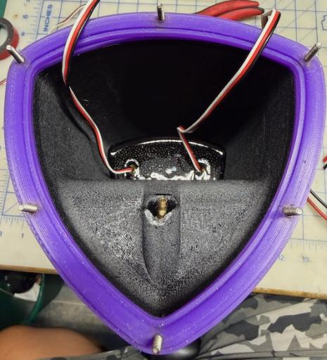

                        #56
                        Have you thought of 3D printing a mold (inverse of the seal) and then casting it in molding silicone. I was having a hard time with o-rings, never thought of using TPU - too hard - use it for bushings vs. seals.
                        The purple is a molded seal.

                          • 3736
                          #57
                          No, I did not consider making a mold from a 3d printer for this. However the old seals were very much like Buna O-rings. So kinda tough. The TPU I reset was significantly softer than the originals. The new stuff arrived, but will not be able to test it until this weekend or next week.
                          making a mold is an interesting idea. Thank you both for your input!
