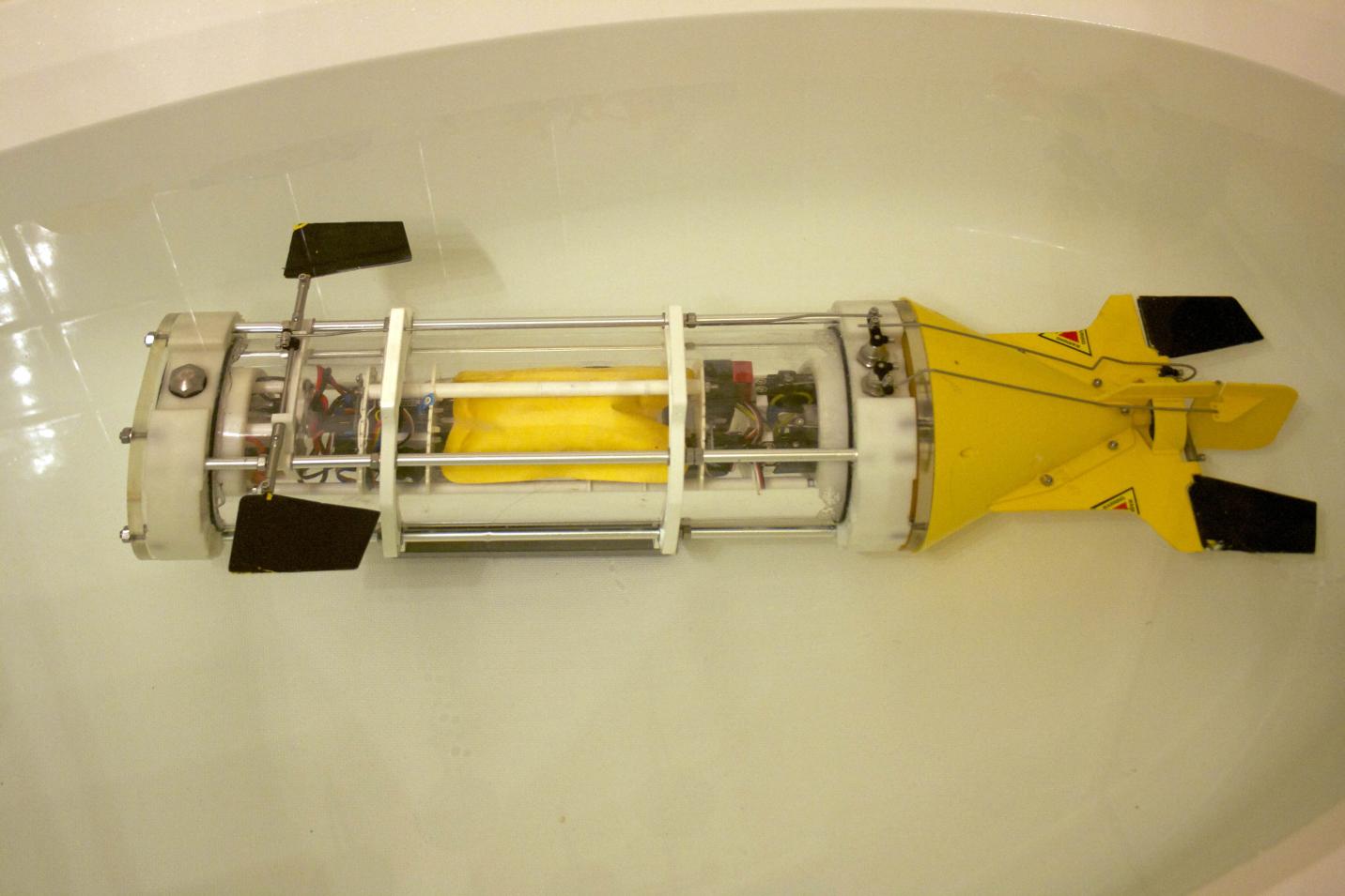

    Tonight we water tested it.
    Sam and I let it sit at the bottom of the tub (which was killing Sam). Finally let him play with it surfacing and diving. Everything checked out all systems worked and we were leak free.
    Next we will put the full hull on and trim (sits slightly aft heavy)
    The tail cone drains so slowly, might need to open the vent and drain hole up a bit.

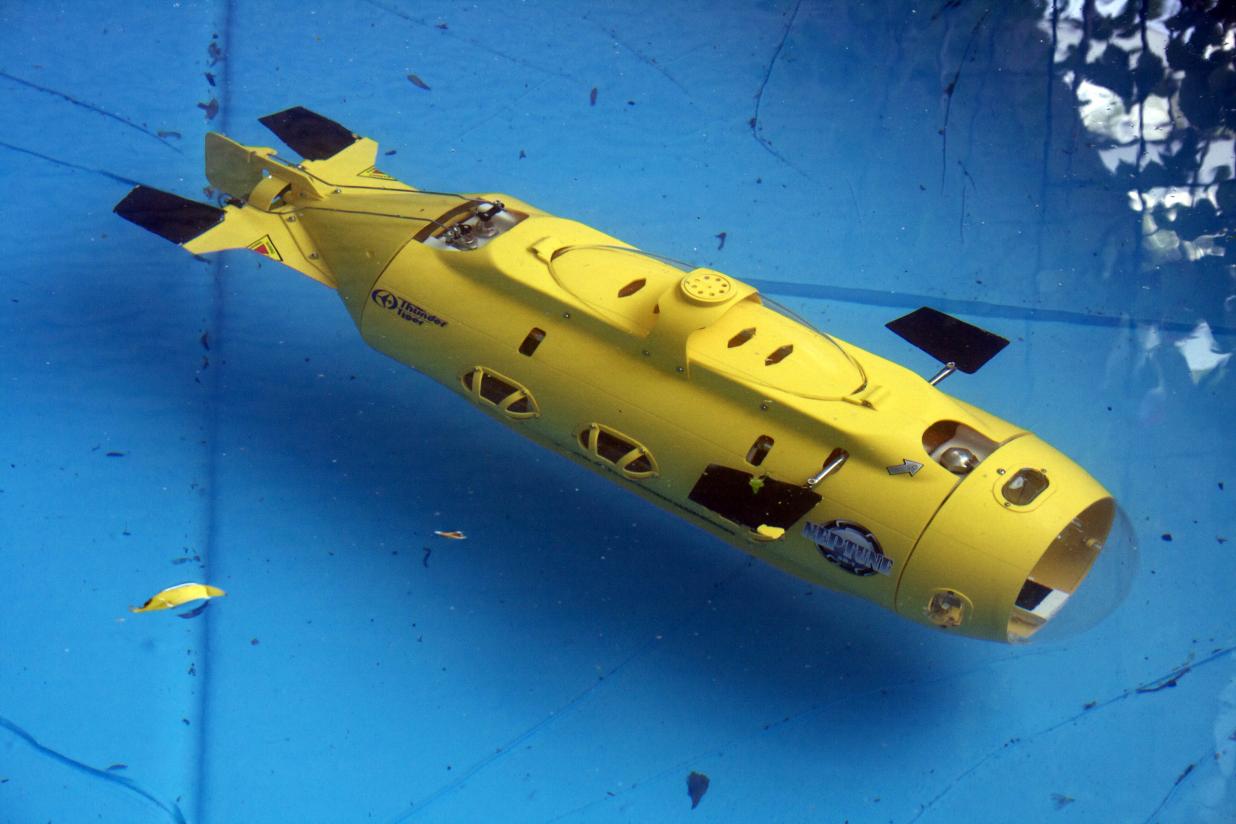

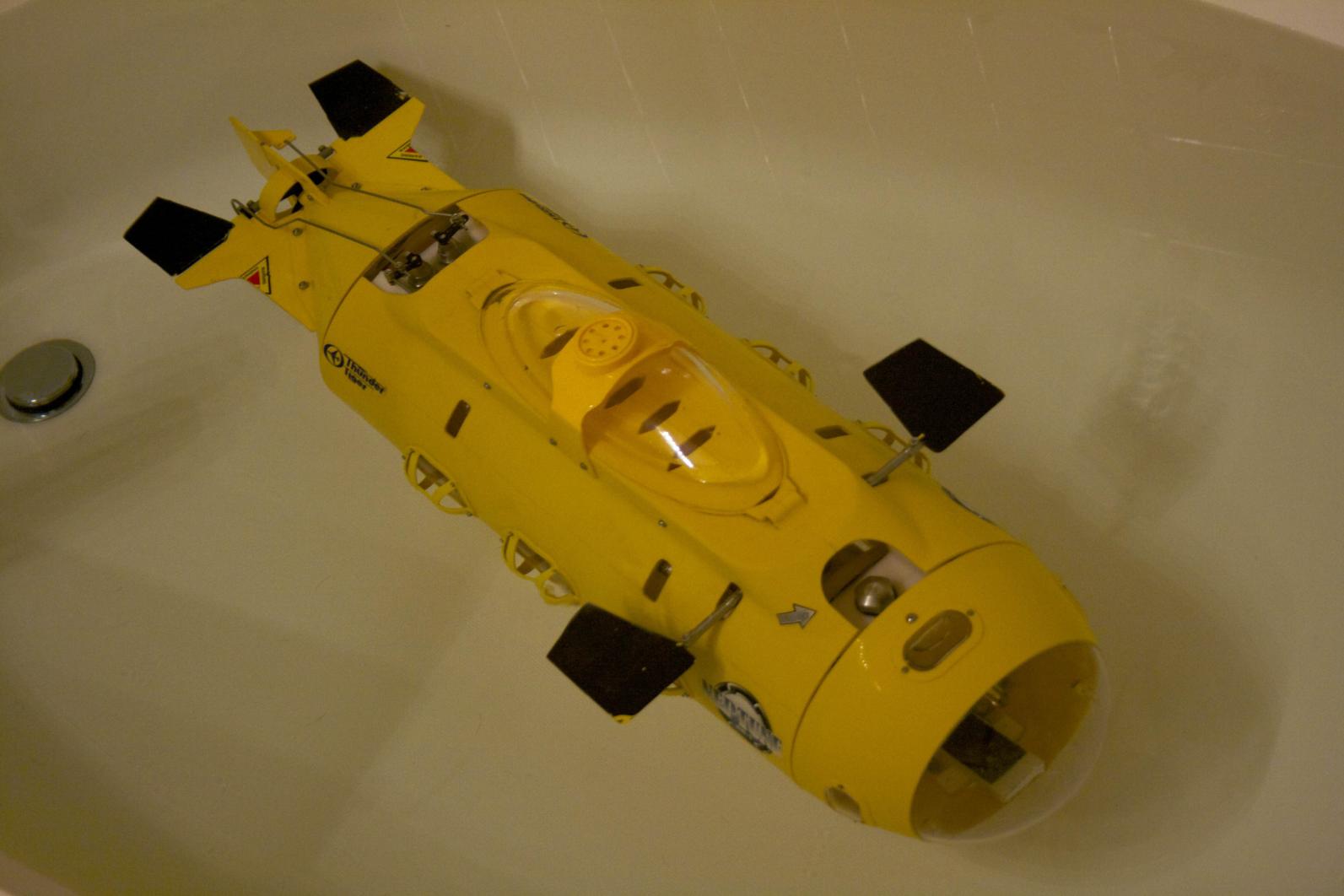

            • 3752
            It leveled off perfectly with the entire shell placed on. The tub was not deep enough for a complete submerge, so we will need to go to the pool.

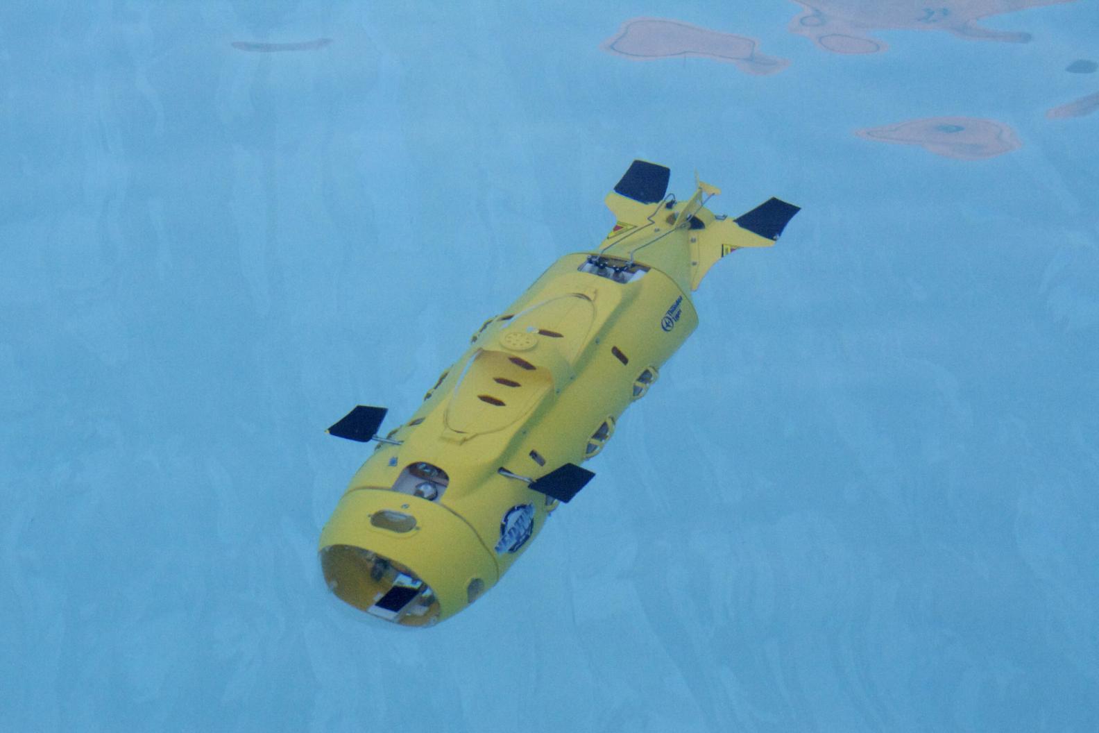

                  Got a small window to go and test the Neptune this evening.
                  I did the initial test, but then gave it to Sam to play.
                  He dove it in the deep end, made it turn tight circles, surface, dive, and got good at finding a semi neutral balance.
