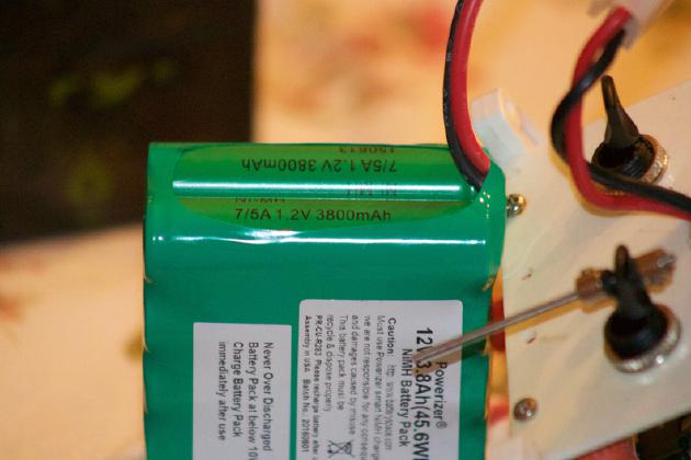

        I took to finding a supplier that would customize a pack. A online company had a 4/3 A 12v 3800 mA battery for ~$40. That fit the budget. I ordered it and when it came in it was sent as 7/5 A.
        Unfortunately, 7/5 is a little too large. The vendor when I tried to call would not hear of it claiming it is the same as 4/3. After I explained the web and my receipt said 4/3, he changed his web page and added it is the same as 7/5. I did not want to pay for the return and frankly, did not want another pack from this guy. I chose to make what I had in hand work.

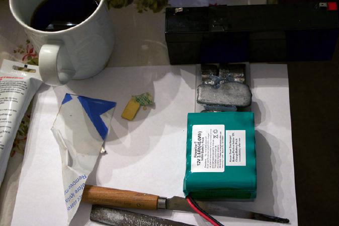

          I attempted to disassemble the end, but silicon was used to help seal the end. It was not budging. So to make the opening larger for the new pack to fit, I used a old trick that I did as a kid. When I made some WWII airplanes, I had to have the enemy shot up. I would take a needle or straight pin and heat it over a candle. Once the needle got hot enough, I would pierce holes to represent damage of bullets (including gruesome blood splatters from the pilot). Anyways, I got a spatula with a wood handle and heated the end up. I was not sure it it was styrene or nylon for the bulkheads in the Neptune, but there is only one way to find out. They acted like styrene. It cut like butter for the most part.
          Now there is enough room to slide the battery in.
          So weighed the old battery.
          Now the new. Added enough lead to closely approximate the original battery.
          Placed it on a tray, it is drying overnight. The adventure will continue.

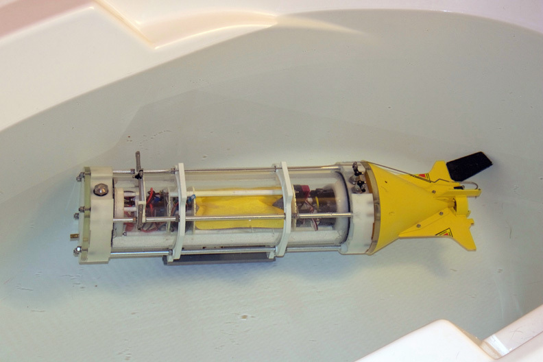

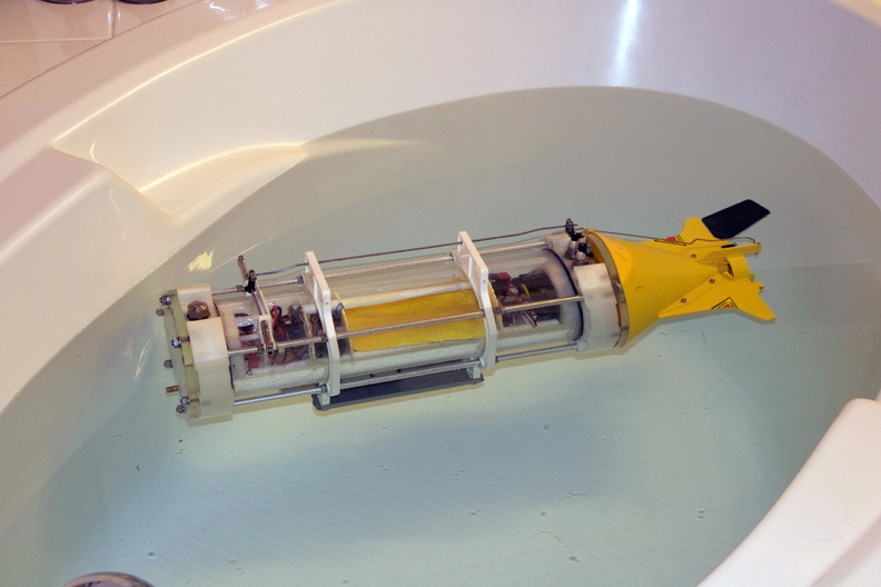

              Battery is charged and the hull sealed up just enough to test in the tub.
ID:	115540 Click image for larger version
              Let it sit in there for a good half an hour. Did some more filling and expelling the bladder played with thrust. I am thrilled to report, the cylinder is dry.
              Before I put on all the parts, I will hopefully have the new prop in. I will report more later.

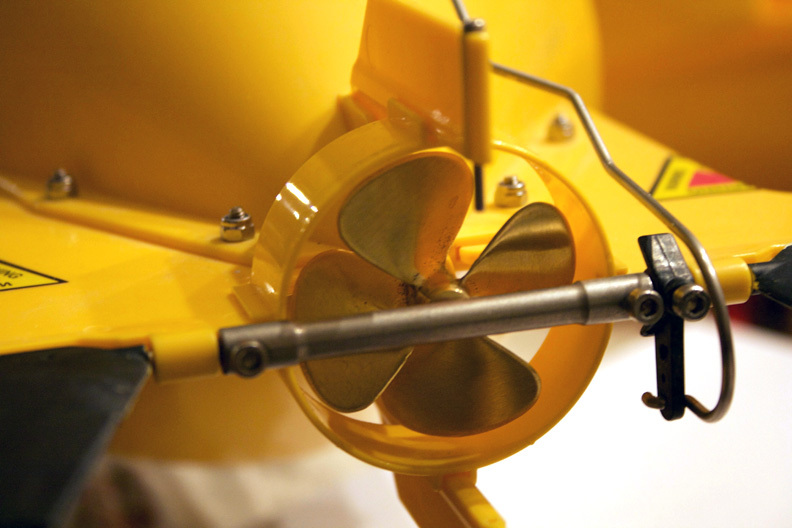

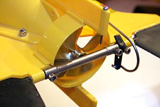

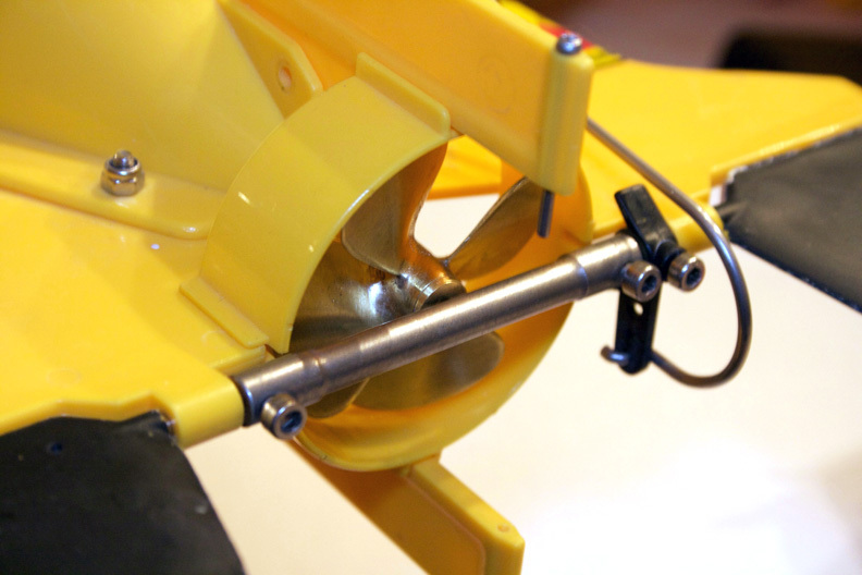

                        At a site called War Ships Underway (http://www.wmunderway.8m.com/cgi/yabb2/YaBB.pl) I met this gentleman Keith. He makes props on the side. I heard of others ordering a Raboesch prop, but it seemed small for the shroud. I asked for one made 3 mm larger or 38mm in diameter. Here is what he made:
                        Next to it is the Scimitar prop you can get for the Neptune. Big difference, huh?
                        I should have ordered it better because Keith was willing to make it exactly the way I wanted.

                        Now that it is installed, I will now assemble it back together and test.
