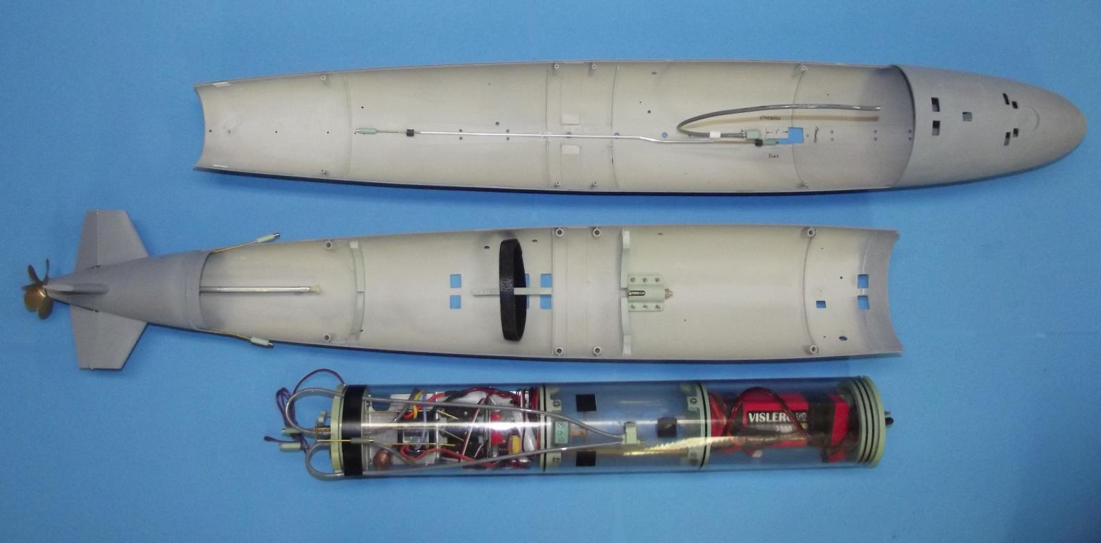

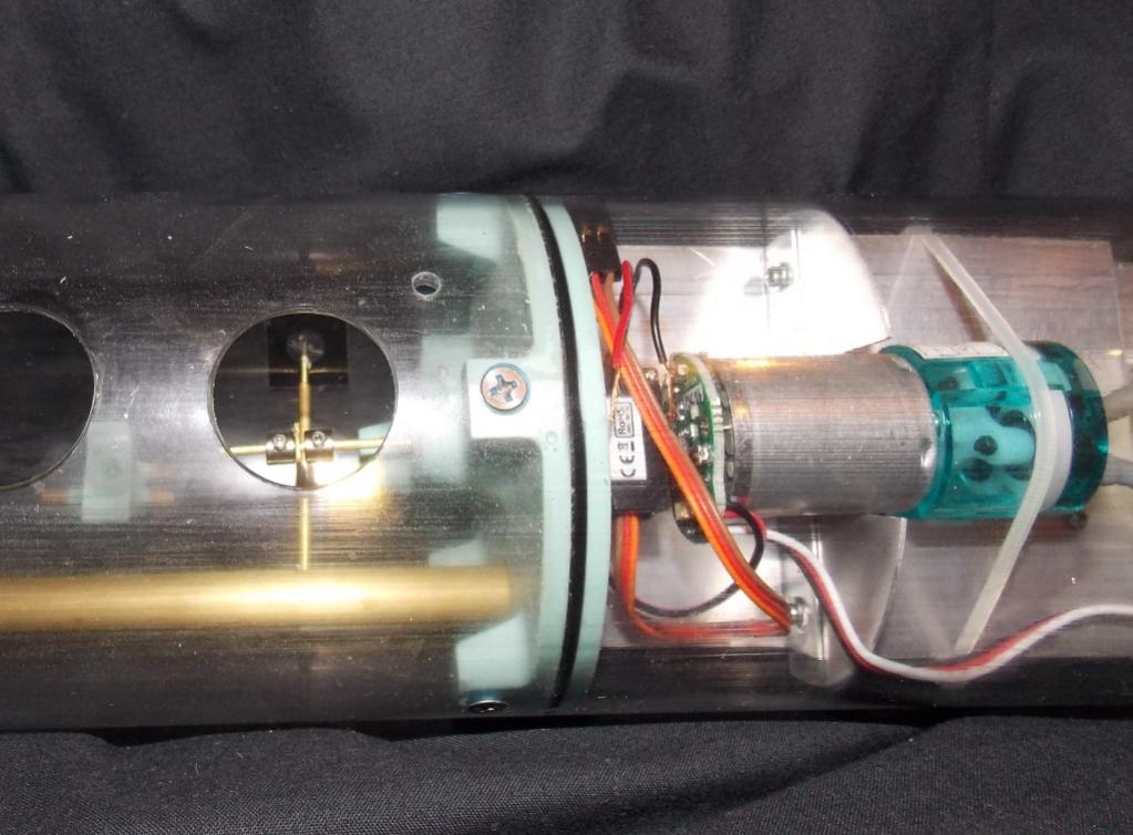

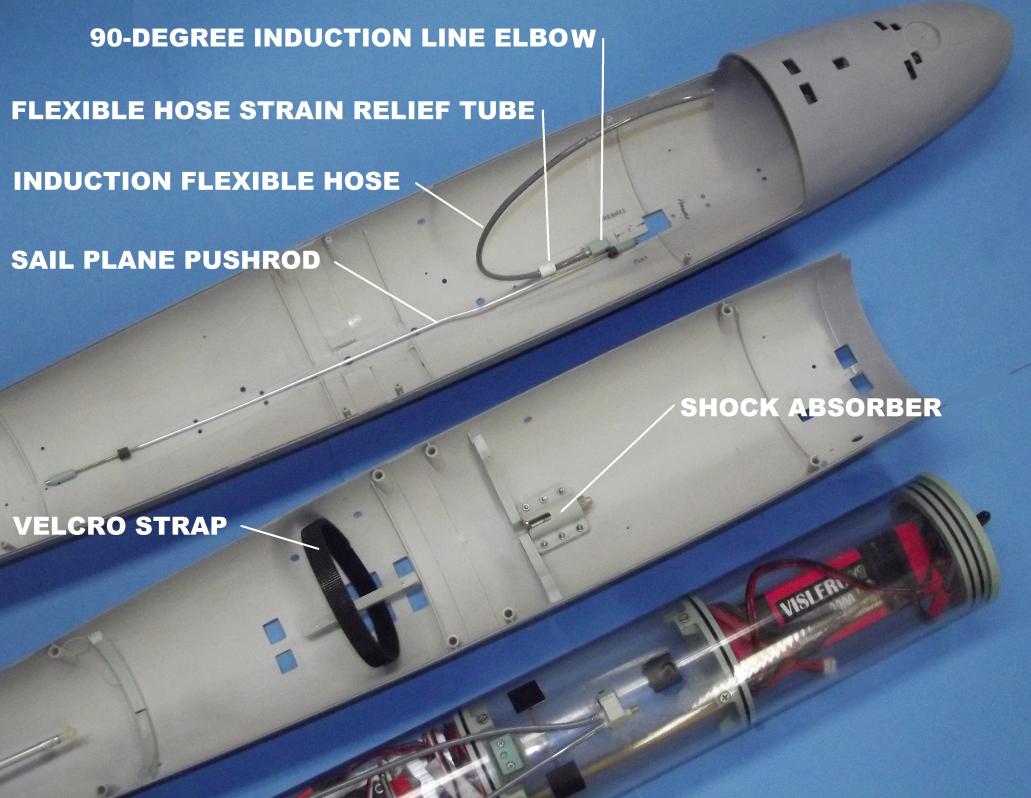

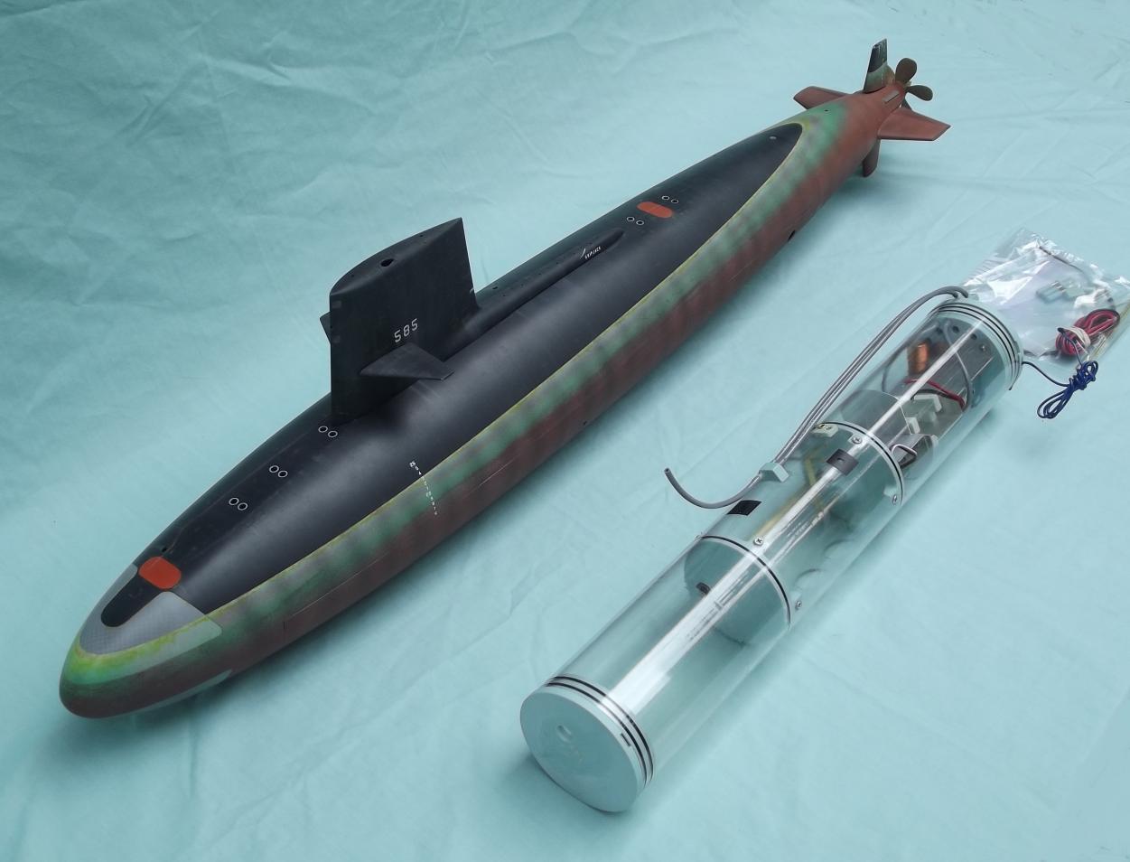

      • 13980
      Yeah ... it's a shock absorber, what's it to ya!?
ID:	90677Click image for larger version
ID:	90678Click image for larger version
ID:	90679Click image for larger version
      Yes, it both indexes the SD within the fragile plastic hull; and provides the means to spread a velocity induced load over time in the event the idiot Driver runs his styrene plastic model submarine into something hard.
      Yes, it's that 'springy' thing.

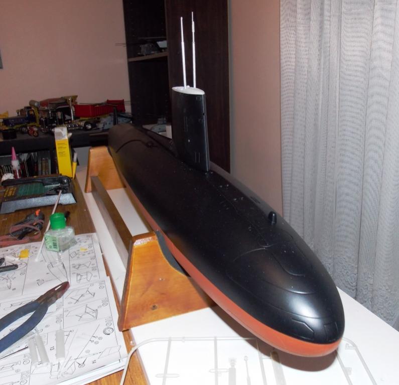

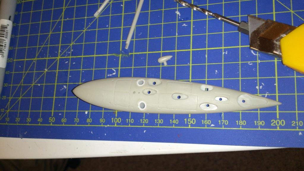

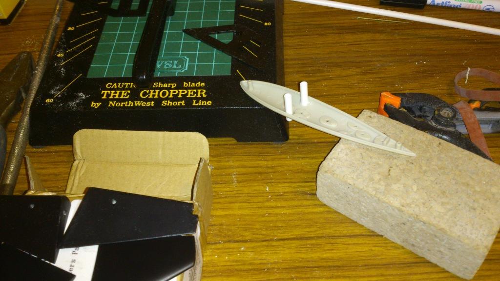

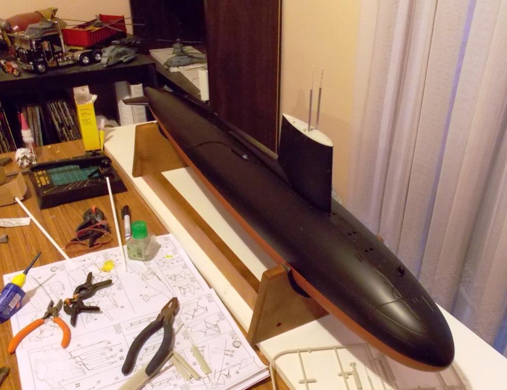

          Since the last post I have been plugging away working on the sail
          (and some foam parts (Armoured conning tower, fwd tower/funnel and aft funnel) for my club mates BB63 I flowcoated em' on the 23rd...didn't put enough catalyst in! Still tacky on 30th! I wiped off the unset goo and tried again all fixed!!.....insert sigh of relief!!)
          Anyhoo... the sail is assembled and painted, except for the top which is still to be painted as I could not decide how many mast to have up! I will have the two periscopes on some sort of float.....drilled out the two holes and inserted some evergreen tube. Using some aluminum 1/8 tube for the scopes the kit part was chopped down then got my house mate to heat the ally tube with his lighter and pushed the top part of the scope into the heated tube. Have fillered the stuff that wont be fitted.
          here are some pix....
ID:	90944Click image for larger version
ID:	90940 Click image for larger version
ID:	90942 Click image for larger version

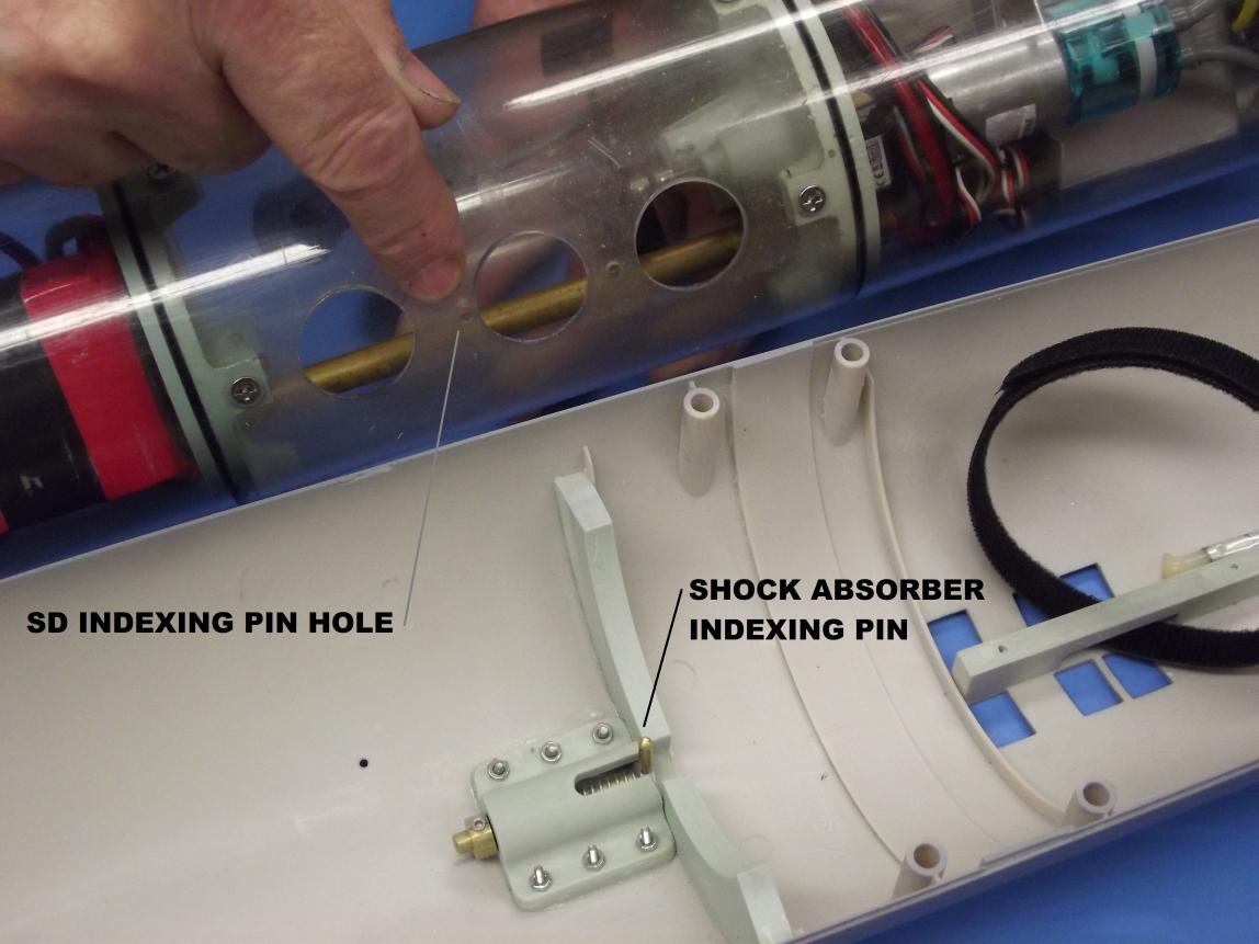

            PS : was looking at the SD and noticed this hole in ballast tank next to the main ballast flood holes....?? Is it supposed to be there??
            Cheers Bruce
              • 13980
              Access for the Allen wrench should you wish to retro-fit a gas type ballast sub-system.
                • 3753
                Yes. That is a hole for your tool to get to a set screw I believe.
                (David beat me to the punch)
                    Thx mate!! It had me baffled as to its purpose!!
