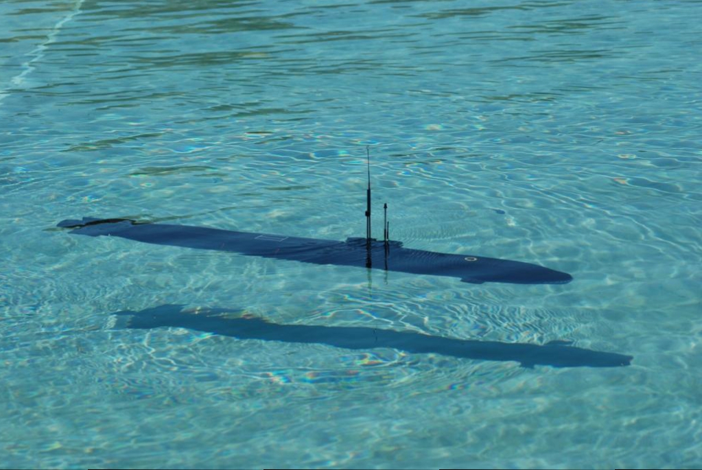

                                Phil's USS Cheyenne SSN773

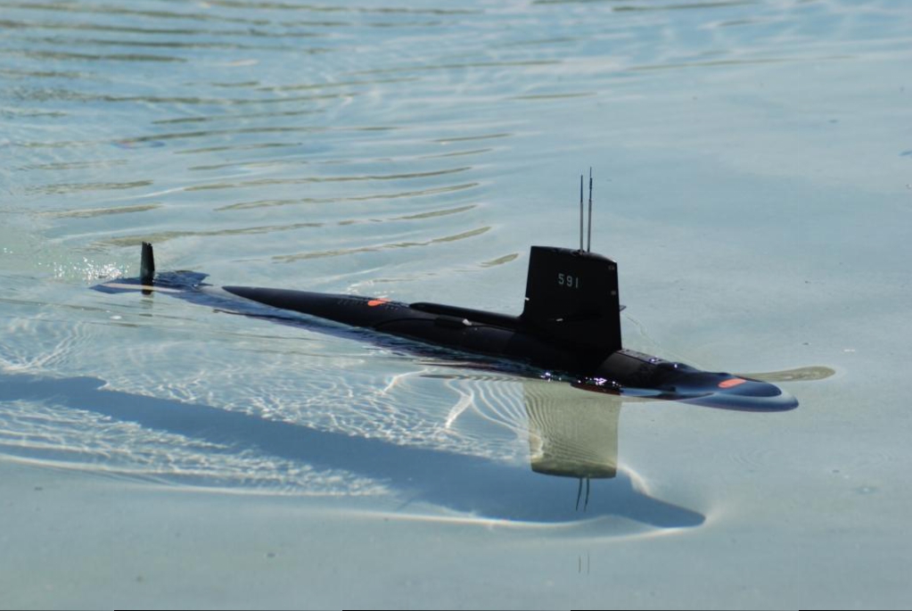

                                Got all my surface fleet setup then got Shark ready for a cruise with Cheyenne sent her off and she just did not want to stay under kept porpoising. So I brought her back in for a check and seem ok.....sent her back out finally got her to dive.....then started to have motor cutting in and out (still had signal cause I could see rudders moving when I tweaked controls), then she decided the bottom looked nice and comfy, refusing to come back up!! It was at this point that I had enuff and switched the Tx off....and waited to see if the failsafe would kick in!! After about 30secs the boat began to slowly come up....and I mean very slowly!! When it surfaced I switched Tx back on and steered her straight back to me for drydocking.
                                USS Shark SSN591 shortly before troubles began...

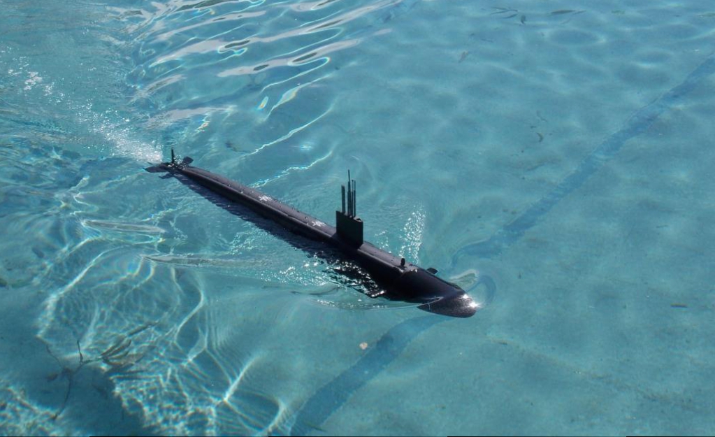

                                Haig's HMS Trafalgar

                                Back on the table opened her up to find motor compartment with water 3/4up the motor!! popped her open to dry out, and there she sat for rest of the day. Now that everything is dried out it looks like the either the airpump or the circuit on airpump is non functional.
                                Had a look on the new webstore but can't seem to find the circuit that goes on the airpump?? Who make that??
                                Cheers Bruce
