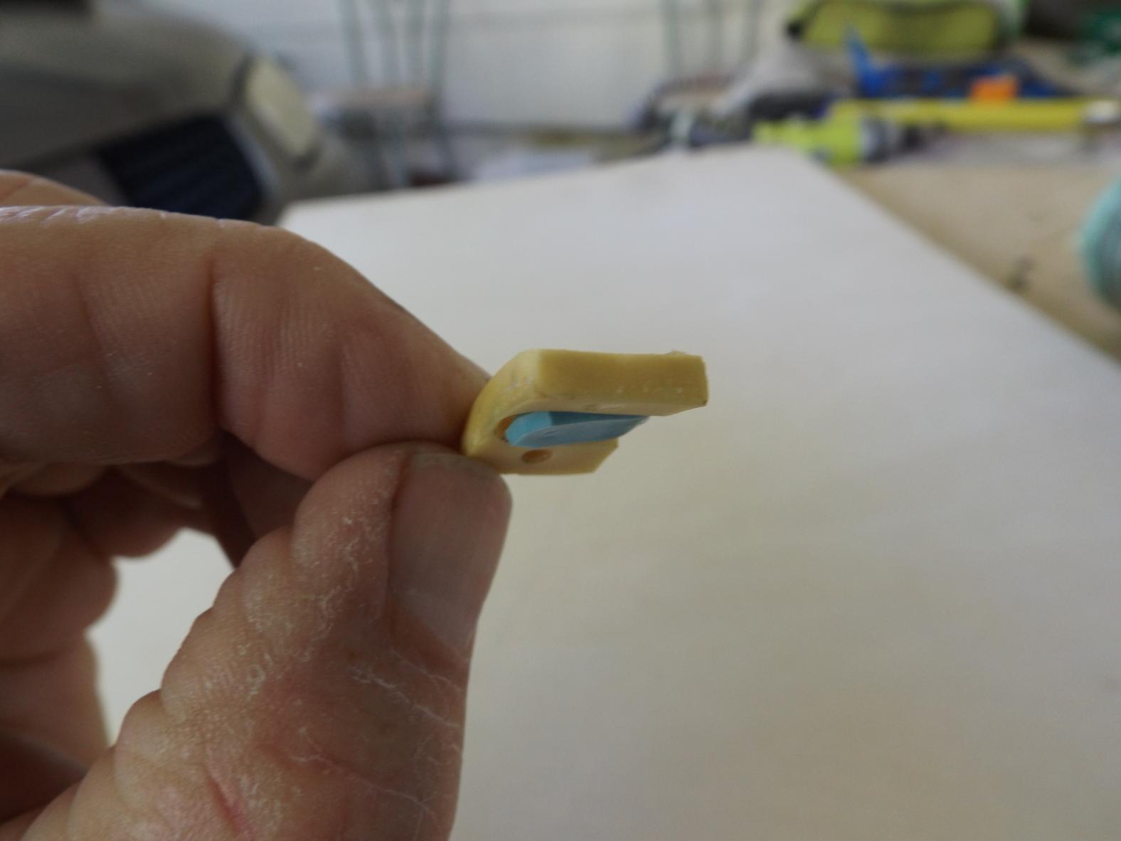

                    Bruce, is the screw that acts on the vent valve in the exact center of the valve or is it off to the side? If its off it wont provide consistent closure. When adjusting that screw, you dont need to worry about siliconing around it till its all dialed in. Even if it leaks around the outside of the perimeter of the valve block, your only interested in the valve itself leaking at this point. You can take it off and make your adjustments and put it on and stick it in the water for a test. You only care about the bubbles coming from the valve center, and you should be able to see that with your eye with the Subdriver in the bathtub, by itself. If its not right take it off and try again, till you get it right. Try drilling it out to the next size bigger, then try it again. Also the male part of the rubber valve must hit exactly in the center of the female part to seal well and continuously. If its not in the center, take it off, reglue it so that its straight and leave some droop in it so that it will naturally open.Click image for larger version

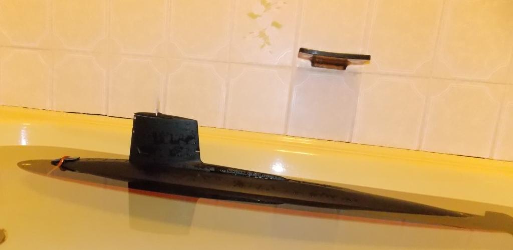

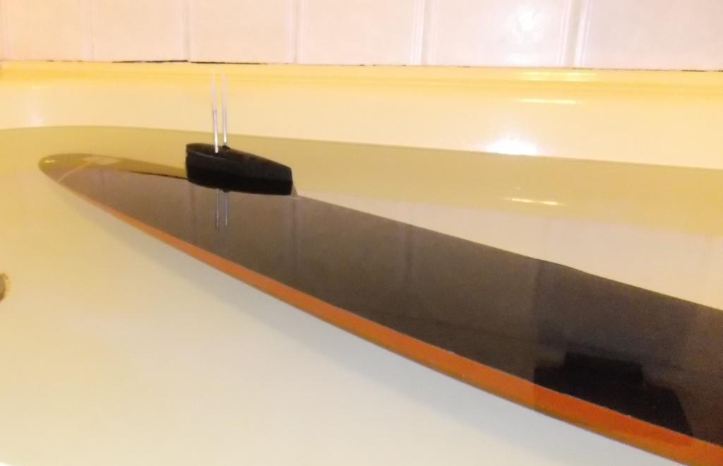

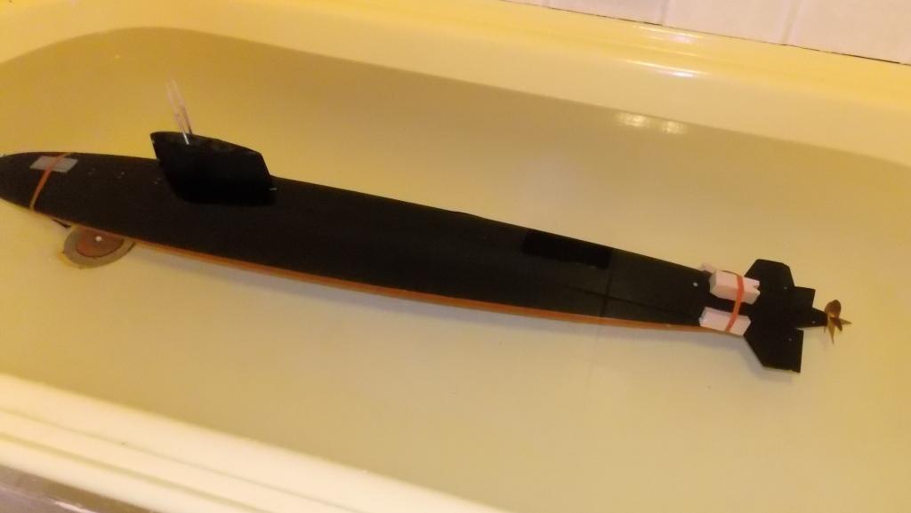

                          Got the valve issue sorted out today! And got the submerged trimming done,But there was a fair bit of water in the drive end of the SD, checking it for leaks shortly...

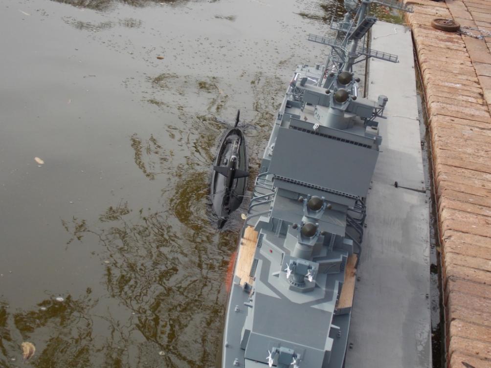

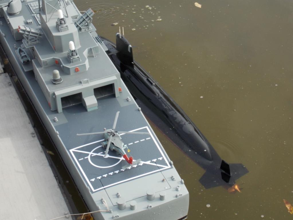

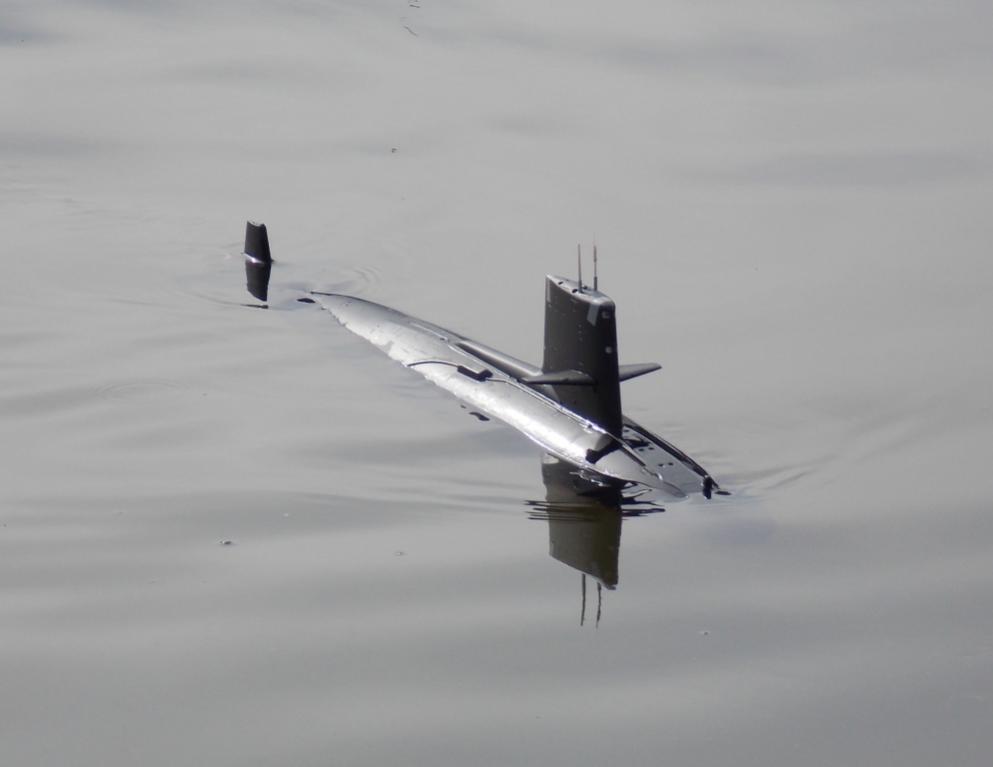

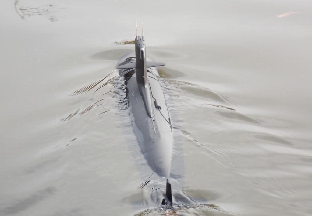

                            Shark had first proper pond test today it was a mixed bag....on one hand no water in SD and ran well on surface, on the other hand couldn't achieve PD (pond must be denser water than the bath and I forgot to bring spare ballast!) was bow up when tank fully blown, but the worst thing was when I got home and was cleaning boat noticed bottom rudder is GONE!! must of detached during second run just before I packed up (grub screw was as tight as possible without stripping too.....grrrrr) going back to pond later (hopefully wind will shift around so the layer of scum obscuring surface will move to other side of pond!!

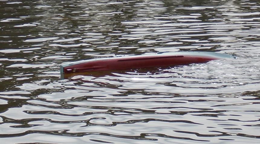

                            But I didn't have the worst day at the Pond !! Clubmate Jim's Daring class HMAS Vampire and Brenton's River class HMAS Parramatta had an "Incident" resulting in Vampire being rolled over on her side and Vince wading out for recovery!! SEE PIX!!

                            Shark alongside Long Beach

                            Shark on surface test run...

                            HMAS Vampire having some "difficulties"......
