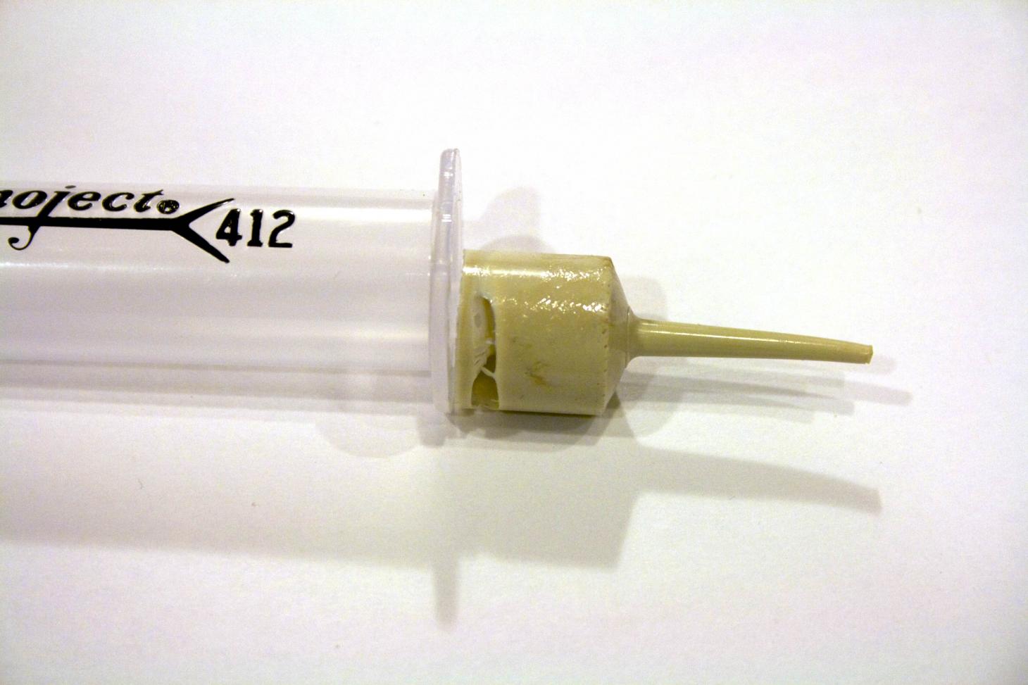

    To hold the aluminum tubes I modified the holder used on the Gato to support only one tube. Then made a mold. I will have one tube on each side of the sub-driver (providing it will fit).
    To fill the mold made from the master, I used a syringe. Then I thought what if I left the extra resin in there (since I made too much). The resin does not seem to permanently stick to the plastic in the syringe.
    The plug did come out. Now, I could turn this, add an o-ring, and have a piston.....hmmm, things rattling in my brain.
