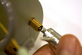

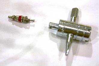

    First I will try using a vacuum.
    The schrader valve's stem is removed by unscrewing it using this tool available at any auto store or department that sells auto, bike, or tires.

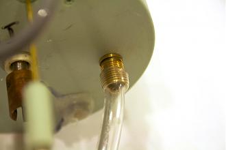

    Attach a vinyl tube (This tube is 1/4" OD x .17" ID) This will serve as the port to suck the air out or push air in as needed.

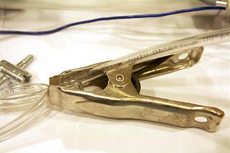

    Then something to seal the vinyl hose after suction or pressure has been applied.
    In this case I was surprised.
    The battery compartment was leaking pretty bad. It is the o-rings. I had not replaced the one that was nicked and the second one was allowing water to stream in. The amount coming in was at a rate that I could not continue. After I got the unit out of the water, there was some water in the engined room too. So once I get some o-ring replacements, I will do this again.

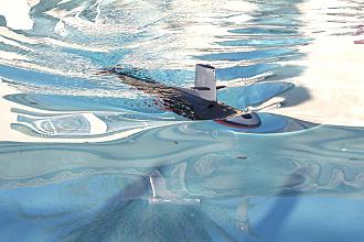

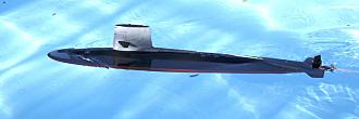

    The Scamp was fun to drive, again.
    Rudder respond'ed' very well with the new magnets. (Had to put the ed in single quotes because apparently if the letters d e d are put together you get this ded )

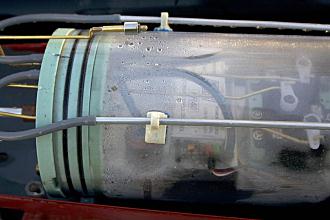

    Playing around for 10 to 15 minutes, I noticed it was tough to keep level.

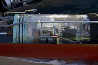

    Brought it out of the water. There was a fine mist on the cylinder. The issue for running funny was the connector to the leveler disconnected when I did a quick reverse.
    After about 45 minutes, the sub was running with the aft end down. This time the cylinder condensation/spray was noticeably greater with a small amount of water at the bottom. The reservoir was drained by blocking the air intake forcing. Some water came out (it did work), but not a tremendous amount of water came out. Indicating to me that the water was not entirely from the SAS.
    The battery compartment had just a small amount of water - a couple of drops. There was a noise in the drive train. I will open it up after everything dries out.
    Took some video from above, below and while attached. Will edit that later. Sam got a chance to drive, he liked it.
    Last edited by trout; 11-18-2013, 03:24 PM. Reason: some smiley face thing was in posting....
