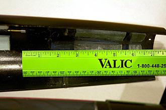

    Amazing what a good night of sleep does. I was about to cut open an access hatch, then it came to me to measure from a fixed point to the end of the magnet. I used the aft seam as my point of reference.

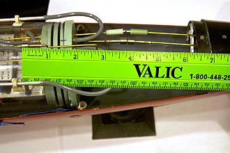

    It was 6 7/8" then when I measured the top section, it was 1/4" too long. So the magnets were connecting on the back side and would work for awhile then slip off. The next picture was the rod already shortened.
    Reassembled the sub and it connected! I then used the End Point to adjust the throw. Down 87% and up 50% seemed to give me plenty of play. What a relief. I will have to sail it in the pool this weekend.
